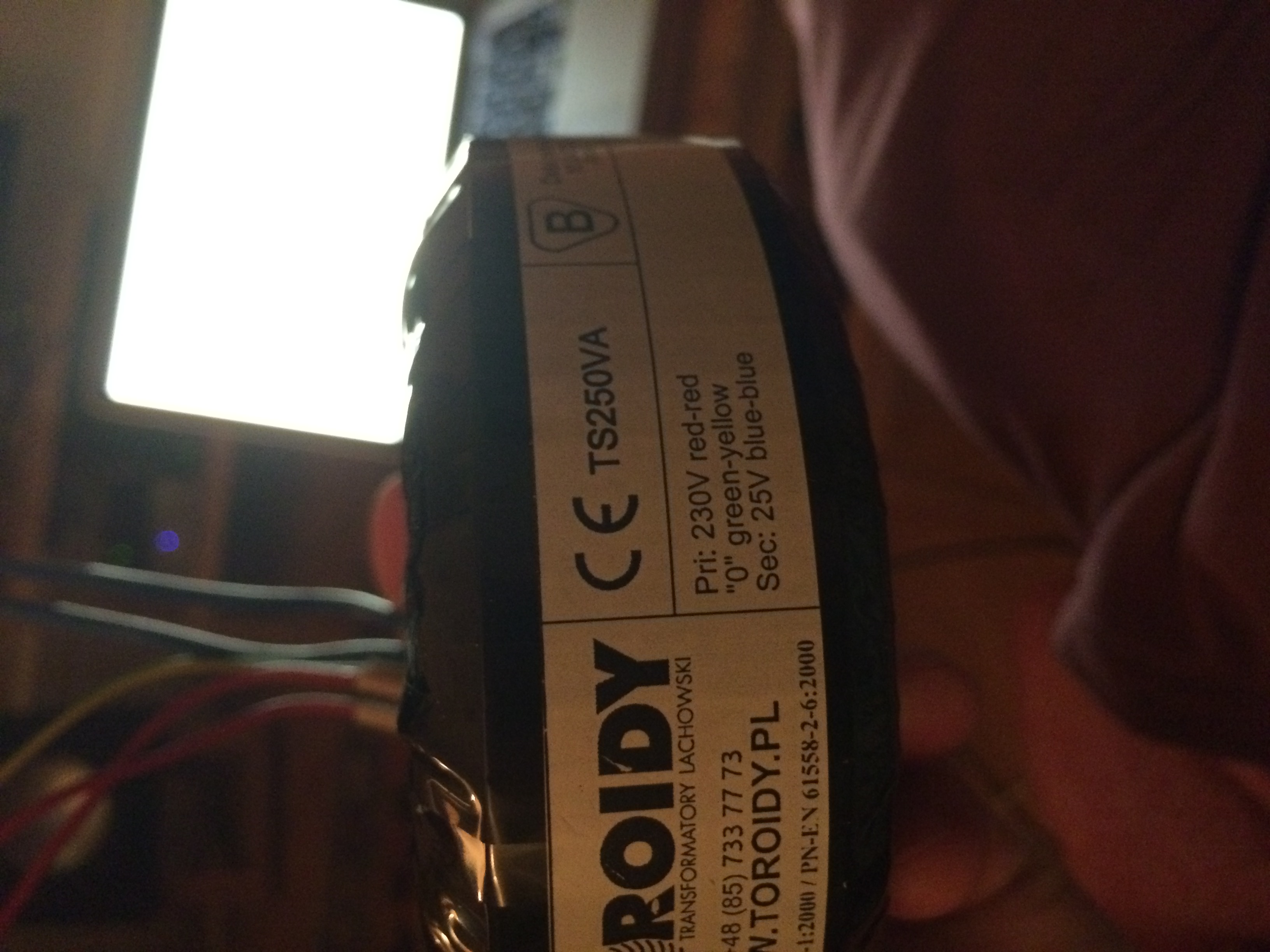

Yes, they are beautiful, smooth heavy and polish. And they have one secondary....
Hehe, I just had to zoom the picture and yes, the label is Toroidy! That's what I always buy for my builds. You never hear them hum, always totally silent! Good purchase!
Do
But don't I need dual secondaries..? Or is the flimsy little green and yellow the centertap..?
Hmmm... Yeah, the green/yellow is the shield. They're really single secondary, or at least it looks like it. If it is the case, you will need two of these for a single PSU since you require dual polarity and 0V.
Can you post a picture of the label that shows the connection diagram?
Do
Yeah... Guess I'll send them back for the cost of one transformer and wait another 6 weeks for new ones... Feeling a little stupid and fairly annoyed with myself right now...
This is it:
Yeah, it's better to have dual secondary but these two would still work in a single PSU arrangement but at more chassis space.
Do
Yeah... But Toroidy were really cool about it and answered really quickly. Guess I'll have to wait a little longer. Luckily it's fishing season, so I'll be able to pass the time...😀😀
