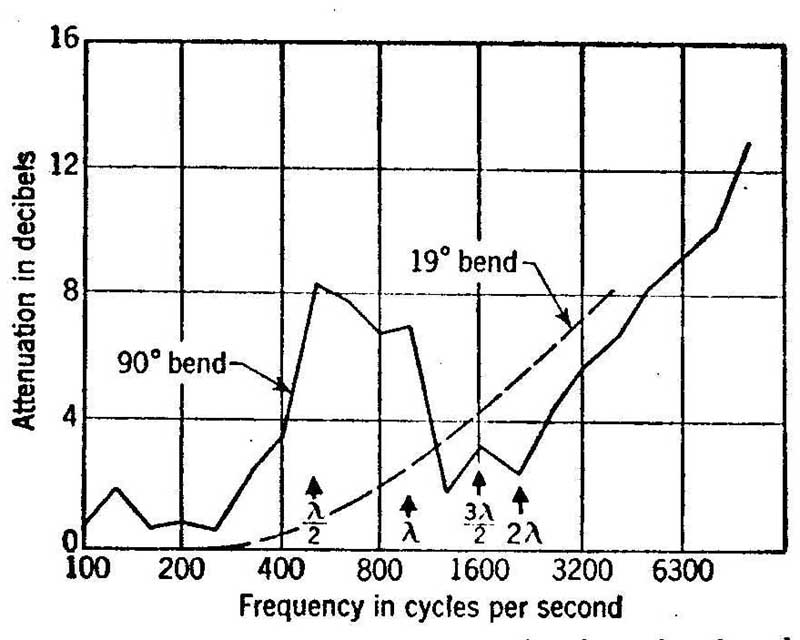

This would be a repeat of the same picture posted elsewhere
to what amounts to the same question. It is Beranek's plot
of attentuation vs frequency for a bent duct having a 1 foot
diameter (or its equivalent). My point being that a 45 degree
strike plate would show some sort of difference.
Setting questions of effect on line length etc. aside, I've always figured that it was nearly mandatory in order to break up standing waves in the section of pipe in question. I once did a four-fold transmission line and regarded the flat, parallel ends of each section of the line as resonances waiting to happen. Given that there were four pairs of opposing surfaces, all the same distance apart, any standing waves would have been reinforced beyond tolerance. Putting diagonals in each corner was an easy solution.
Though I know the math is different, I am just as suspicious of sudden changes in tube cross section in transmission lines as I would be in horns. You're setting up a non-linearity in the impedance. Putting a diagonal plate in the corner helps ease the transition.
