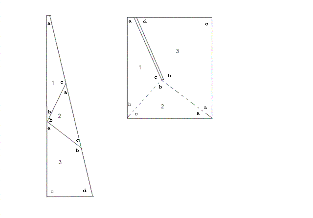

Hey A-M:
I haven't had time to do too much with this, and you haven't stated your performance goals so I just did two sims, one a max flat reverse taper where Fb = Fs, and a reverse tapered EBS alignment tuned to 18Hz. With no Xmax specs or room info, I don't have a clue how much SPL can be generated with either. Also, who knows how accurate the published specs are, and tapered pipes being what they are, if the specs are off much then the alignment goes to '**** in a handbasket' and all you can do at that point is tune it aperiodically or with a vent.
WRT your folding scheme, if drawn to scale it won't work as predicted due to the discontinuity of the flare rate through the bends.
Anyway, here's some numbers to punch into mathcad to view:
max flat reverse taper:
L = 64.43"
So = 247.6"^2
SL = 24.76"^2
Xo = 0.3544
density = 0.5lbs/ft^3
reverse tapered EBS:
L = 91"
So = 247.6"^2
SL = 24.76"^2
Xo = 0.3251

Thanks guys
I expect that the TL's will have a character altogether different to a bass reflex design. As for what they will sound like when done, there is only one way to find out. I was attracted to the design by the idea that a TQWT design can extend low bass by manipulating the rear wave such that it is in phase with the front wave at Fs. Various articles I read indicated that even with a less than ideal pipe configuration, Fs can be somewhat manipulated with stuffing, or even mass loading ie., using a port. One or two articles suggested that large TQWT cabinets in subwoofer applications can be more forgiving of inferior drivers. I think I have to agree with Sreten's comment that many of these suggestions may be somewhat controversial and suggestive.
All that being said, I have heard some amazing bass (isn't that a song? ) coming from small drivers in TL cabinets. So, given that I have invested very little in the driver, and that the cabinet I already had was almost exactly the right configuration, port length and diameter, as called for by the manufacturer, and it performs reasonably well, it can't hurt more than a weekend's work and a sheet or two of plywood to try a TL!
I plan to build the box from 5/8" construction grade plywood. I'll leave one side removable for tweaking. I'll then test the system, and if I can get satisfactory performance through tweaking with stuffing at various densities, then I'll finnish the cabinet by laminating 1/2" MDF panels and hardwood corner inlays and a harwood top to the outside of the plywood box. Pipe pannels will be braced with oval oak dowels I salvaged from an old bannester and I'll laminate asphault shingles, and close pile carpeting to minimize cabinet resonances. I expect only approximatel .25lb/ft2 of stuffing throughout the pipe would be necessary (works well in MathCad).
One concern I have is Port Noise at Terminus. The best configurtion I could get with MathCad was with a small end XS of .5 of the driver area. That works out to approximately 2.3"X16" effectively slot loading the driver. The Xmax is only 7.5 mm, so I don't think I'll get much air moving to create turbulence, even with an underdamped driver!
But I might be in for a surprise.

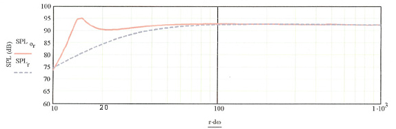

Rethinking
Hi GM,
My last post was composed before your post. Thanks so much for the info. I punched those figures in except for X0, what does that represent and where does it get plugged in to MathCad?
The SPL graphs look quite good, even with the shorter pipe. The 91" pipe though had a troublesome peak at 75 to 100 hz. I have quite a strong room gain at 80hz, so much so that I have my sub 180* out of phase with my mains to tame it by creating a null at the xo point. I fooled around with the pipe length and found that 80" gave me the best response. The peak was pushed up above 80hz, and low end roll off was just 6db down from 20 to 80hz. 80" will certainly fit much easier into my cabinet volume constraints than 144"!

Evening!
>Hi GM,
You're welcome!
Some (many?) of us use the original version of the worksheet. Xo is the driver location WRT the top as a percentage. For the later worksheet it would be 64.43*0.3544 = ~22.83" and 91*0.3251 = ~29.58" down from the top.
Not really. This design is preferred if there's more room and/or corner gain that boosts the lower BW more. Possibly where you placed the driver makes more of a rising response than my locations.
How does it look with the driver at my recommended point?
OK, I didn't realize you'd mapped your room. This info would have been helpful. At this length, the driver's optimum location is at ~26.85" down from the top.
This is a truism, and you've learned a bit more about how to design them. I just hope the specs are close enough.
Anyway, looking forward to your thoughts on its performance.

Corner deflectors
Hy guys. I'm missing something too because I'm not certain the connection between the above posts, and my last entry, but then again, this thread is about my original question and not so much about my project isn't it?
I have a question which may reveal some confusion I have about the process of maintaining the taper. Much of the reading I've done indicates that corner deflectors have minimal impact on the behaviour of a TL. I've been led to believe that the most important thing is to maintain the taper cross section.
Now, I have explained earlier in this thread that I don't do math well, hence my need to ask for help in designing this cabinet. Thanks again GM for your assistance. When you provided me with some alternative parameters for folding the pipe down to the size I was constrained to by my room, I used some simple geometry to arrive at the cabinet configuration. I simply manually drew out a scaled down representation of the pipe and divided it into three slices that could then be rotated and pieced back together within a square. I've attached a JPG graphical representation of my methodology, though it is far from proportionally correct. Perhaps there is a fatal flaw in my thinking on this, but anyway I "slice" it, the cabinet has the same volume and maintains the appropriate taper. If my assumptions are correct, then placing corner deflectors in this configuration will result in compromising the taper.
So am I gravely mistaken?

GM said:Anyway, your designs imply you already know all this so I guess I miss your point. GM
My point would be that 45 degree corner reflectors might
only make a subtle difference, but they do so on several
fronts. They do stiffen the enclosure, they do allow a more
accurate taper with a folded pipe, and they do provide some
reflective/diffusive effects which reduce unwant internal
resonance. Having tried it both ways, I find that I prefer
the sound, what else can I say?

>I suspect this is where the 15hz peak in the MathCAD curve may have been excited.
All in all I am very happy with this simple project. It is quite literally, the best sub I've ever heard in a home installation, and it isn't even finnished yet. Not bad for less than $100.00 total investment (not including the $60.00 Sanyo Amp that powers it)!
If it performs as the plot indicates, it 'rings' way too much in the audible BW, so I recommend damping it somehow. At a glance, I'm not sure what you finally built, so how about a recap of the sub's cab specs/construction?
Correct, as has been discussed already. I guess in retrospect, NP was saying to use corner deflectors to help maintain the flare, but as I noted, in the typical simple bi-fold as shown on MJK's doc they have no audible impact until quite high in the BW. If you want to see measured proof, I believe BB posted some on his site: http://www.geocities.com/rbrines1/
Now if you design the folds using corner deflectors and make the cab whatever size this dictates, then of course they properly maintain the flare rate. The LABhorn is a good example. Doing it this way also preserves most/all of the HF BW, though this isn't necessarily desirable for its intended BW, so some means of attenuation is required.
>If my assumptions are correct, then placing corner deflectors in this configuration will result in compromising the taper. So am I gravely mistaken?
Not based on my experience.
GM

Hi GM
In response to my comment: ".....but then again, this thread is about my original question and not so much about my project isn't it?"
GM asked:
"I thought it was covered rather thoroughly already, so what's still not clear?"
There's nothing contentious GM. The only confusion I have is that this thread has been inactive since my last posts in Dec 03, so the two posts following my recent update seem somewhat out of context, like a conversation carried over from another thread.
As far as the cabinet dimensions, I will be taking it apart and stuffing it this weekend so I will take some measurements and photos to post.
Could you explain to me how you can tell that the cabinet is ringing from the plot I posted. I punched in a number of different stuffing densities, up to 2 lbs/ft and it only nominally changed the curve. Perhaps I'm missing something.
