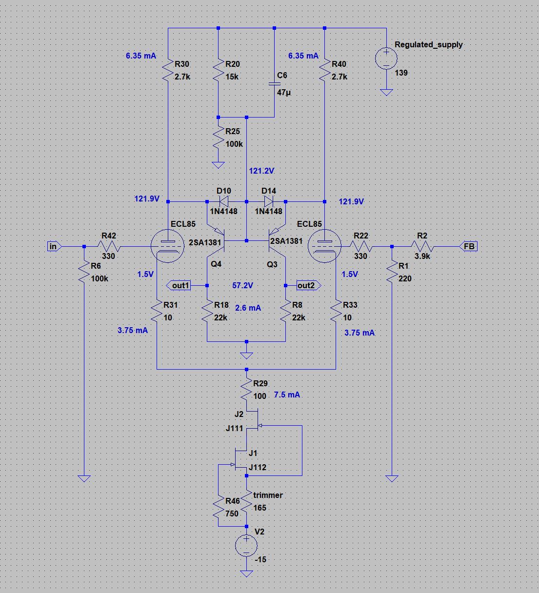

I just built and tested a folded cascode differential based on PRR's post #5 in this thread, intended for use as a phase splitter. I needed something with decent gain that could run off the low supply voltage available (only 155V, output stage is hybrid). Triodes had to be from an ECL85 as I'm using the pentode in the output stage.
See attached. Supply is from a simple Maida regulator, voltage source for the PNP bases is a resistor divider bypassed to B+ (helps with PSRR), anode current sources are just resistors. Gain is about 45 (~90 each side, halved due to grounding the second input). No issues with oscillation or instability, can swing >100V peak to peak, and perfect balance. On start-up the outputs sit at ~124V until the tubes warm up, then falls to the normal operating point with some undershoot.
All in all a very useful building block for the right circumstances.

Finally in the testing stages:
I'm troubleshooting at the moment. Without the tube I can set the voltage reference and output level no problem. With the tube installed, the reference ends up around 50V (target 150V) and the output at 0V (target 75V).
I'm playing with the tail CCS to see if that's an issue. I'm thinking I probably killed the ZTXs though. At one point I accidentally cranked the anode CCSs the wrong way and was alerted by a dropping resistor heating up.
It's possible something is dead, but if the tube eats the whole CCS output, and is still hungry, the output will fall even if the reference circuit is good. I would say this is the most likely problem.
Don't worry about having a little too much current - if the output resistors are correctly chosen, the power dissipation is limited.
