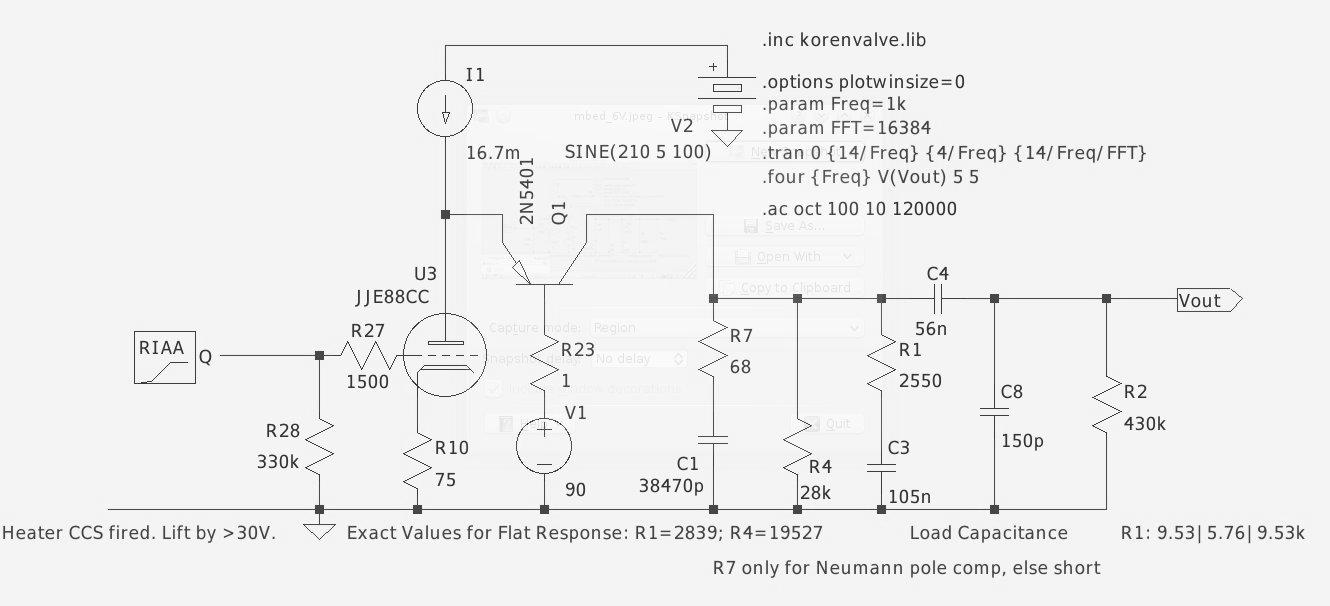

I'd like to make a couple of boards for a basic folded cascode to use in future projects. Does anyone have any comments on the below two options? The MOSFET CCS is certainly simpler, but the BJT ring of two might be more widely available.
Also interested to hear whether this use of LR8 makes sense. I haven't played with these before but it looks like it could make a pretty simple voltage reference here.
This will also be my first time creating boards so any helpful tips would be very appreciated.
edit: not sure if I'd keep the trim pots, btw. probably add a way to bypass them or replace after adjustment in circuit.

My thoughts - some changes are needed:
1. The Q1 PNP base-protection diode is mandatory;
2. Anode stopper, noted above, highly recommended, to avoid need to chase instabilities in this high-gain stage;
3. Bipolar current source degrades the power supply isolation, and will oscillate on its own, as drawn. The MJE350 C-E is drawn reversed. The DN2540 cascode is easy to use, and is well-worth the inclusion.
4. LR8 uses a band-gap reference, and is not intended for low-noise applications. This kind of regulator is relatively noisy, and the noise increases with output voltage, so beware excessive noise, especially in RIAA applications, where I suspect it will not be quiet enough.
5. Layout: short trace lengths, especially around Q1. Leave reasonable gaps from B and E of Q1 to low-voltage nodes, to avoid leakage risk.
My current version includes a discrete low-noise shunt regulator for the base, for use in driver or RIAA stages. DN2540 cascode is included. The rest of the boards in the lot are available - Rod Coleman Shunt Cascode - Power Tube Driver
Rod,
Thank you so much for the feedback!
1. I will add this; thank you.
2. I was thinking this would be off the board, but maybe I'm misunderstanding. This is a stopper b/w tube anode and the BJT/CCS junction?
3. Doh on the MJE350 c-e. I'm leaning now towards a depletion MOSFET anyways to keep things simple. I've used 10M45S more in the past but have nothing against DN2540 other than I don't think I have any atm.
4. I'll research LR8 noise a bit more and/or other options. Seems a shunt arrangement (like you mentioned) is a good option. Initially I was thinking a 0D3 would make a very 'pretty' voltage reference, but it doesn't jive well with the board and keeping connections short.
5. Noted, thank you again. I'm planning to cut my teeth on a CCS board or two and then trying a folded cascode board. I have not done boards in the past but I'm starting to enjoy the layout process.
When you mentioned your board earlier, I Googled it to see if you were making it available for purchase. Not finding anything, I started down this road. I hope you don't take my project as any kind of comment on what you've already done! Apparently I'm just not good enough at Google. Now that I've built up some thought inertia in this direction, I'll try to see the board project through.

Should be worth some tests and measurements, at least! Measure the base when running large swings - getting the tightest grip on the base is important for the measured performance, and the sound. But it should be low enough noise.
One thing needs a correction: diode D1 is reversed. It needs to protect the PNP from violations of VEBO, which is usually only -5V or so. The circuit may well start up with more voltage on the base, and exceeding this rating has the annoying outcome of leaving the PNP functional, but with degraded noise and gain.

Here's a pass at a board. I have not made boards before, but once I started it was kind of intuitive (like virtual p2p). It it a little tight around Q6, the follower for the voltage reference. The emitter trace crosses under the base trace, but they are roughly the same voltage.
Dimensions are 3.75" x 2". Big cap spacing is 27.5mm and most of the resistors are 1/2W (except v-ref, led dropper, output). Room for a large heatsink (based on Aavid/Ohmite datasheet dimens).
Looks good! As I said the LND150 tempo is poor even when run at 500uA) so best to change it for a J112 and run it at 1mA. It will provide a more stable voltage. Otherwise will drift when hot
Also the anode DN2540 on its own is not the best CCS when running hot. Again, best is to have a cascode pair. The device on the top will take the heavy load and the below device will set the current and run cooler, hence more stable with temperature
I’d rather use an IXTP08n100d at the top, will allow the lower device to operate in better conditions.

One more practical suggestion:
Instead of using the raw TO-92 PCB footprint, which places the base and collector much too close for easy soldering without shorts, let alone the high-voltage swing across them (case of the cascode PNP): use an "ammo-pack" TO-92 pattern. These put the pads on a 0.1" [2.54mm] pitch, and make life much easier. Form the leads to suit when stuffing. Many transistors are available on cut strips of ammo tape, ready to go right into those holes.
