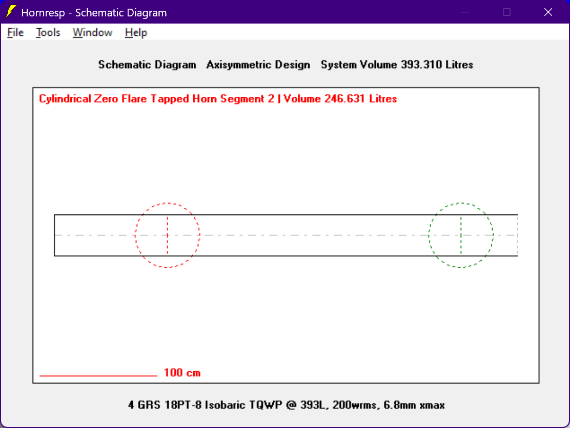

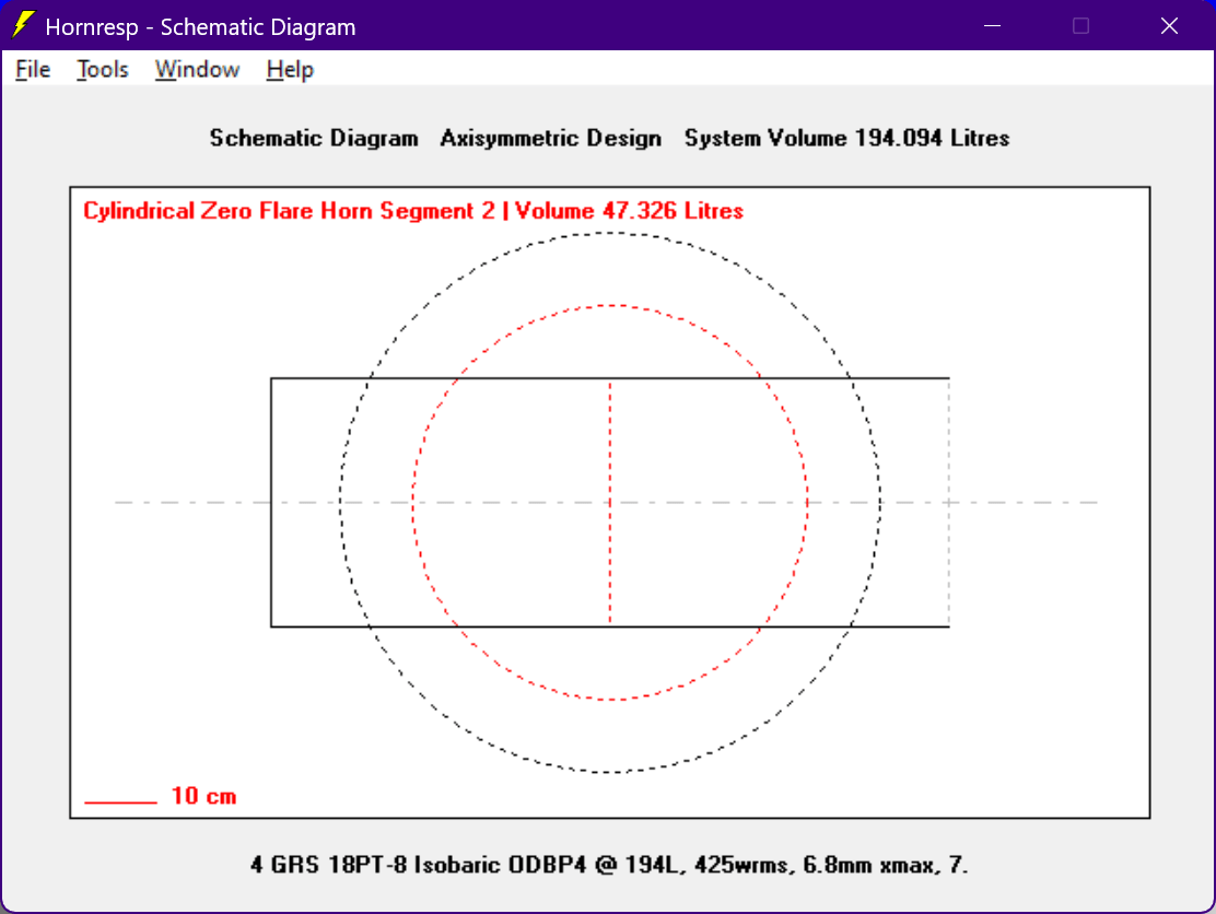

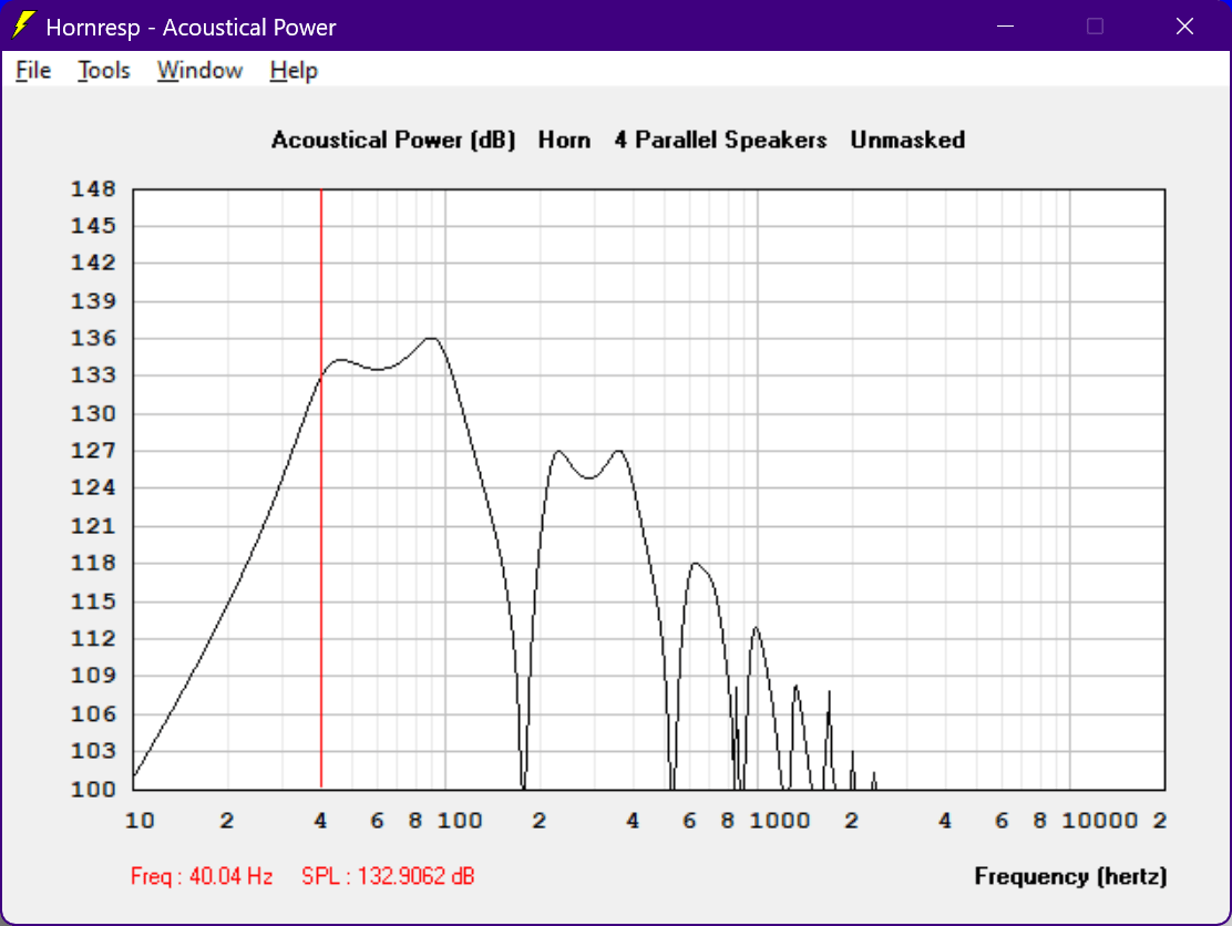

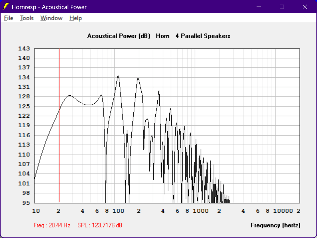

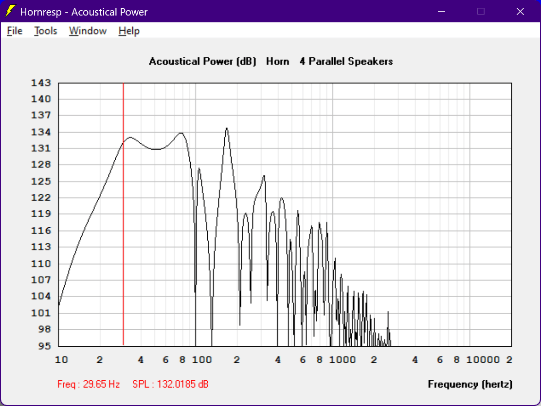

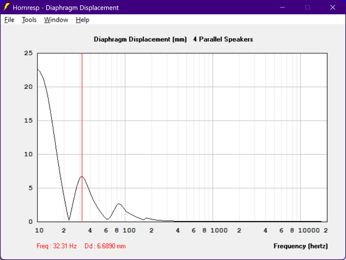

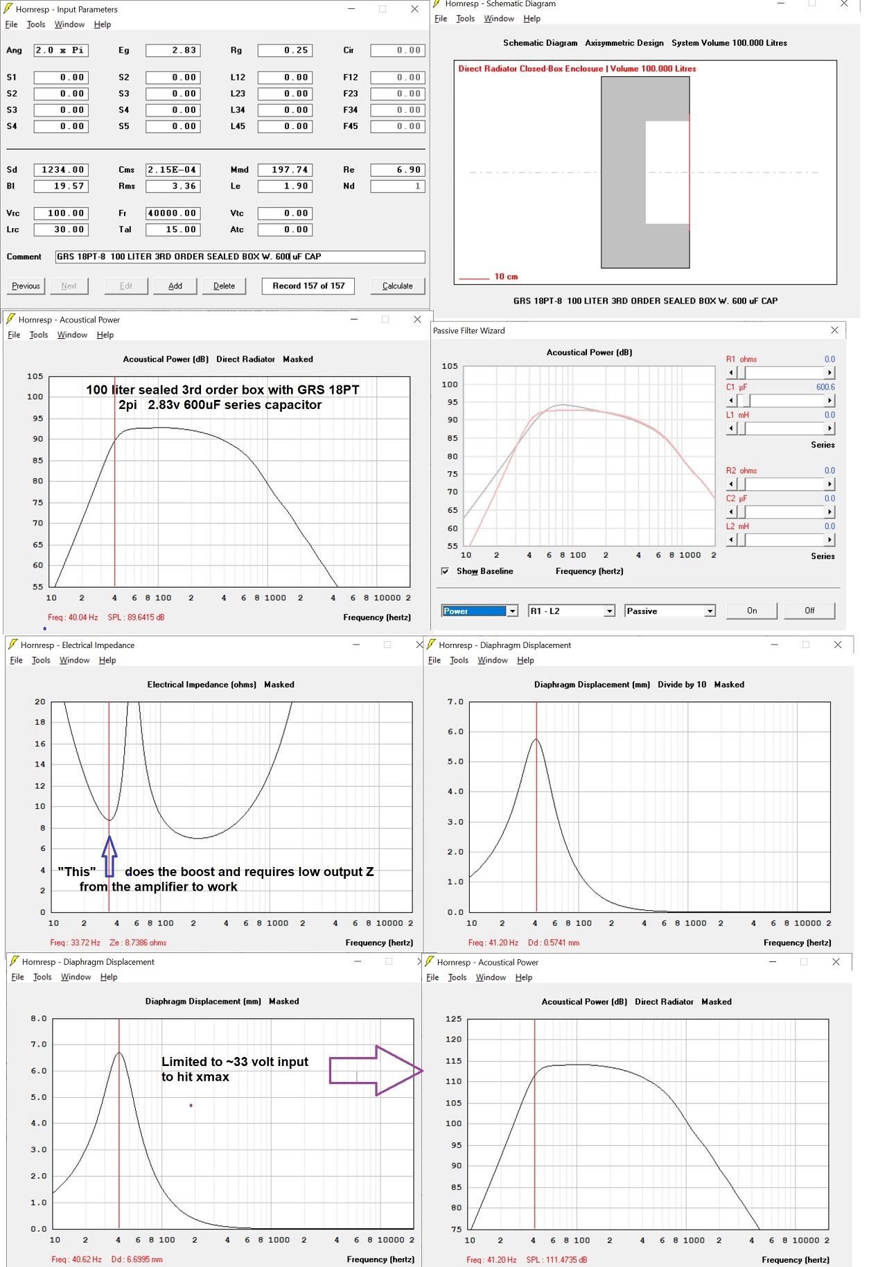

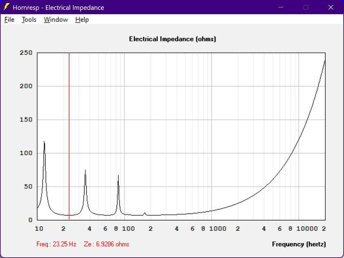

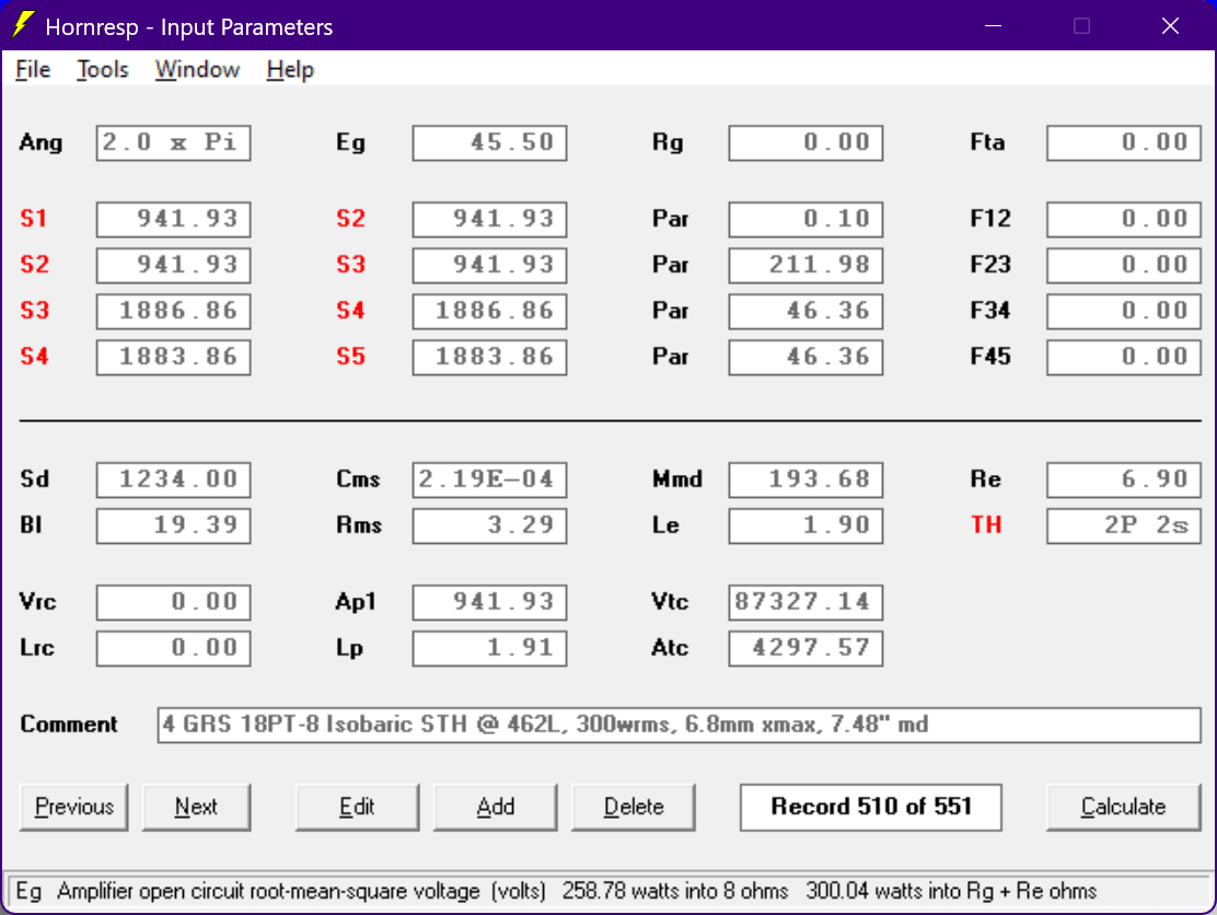

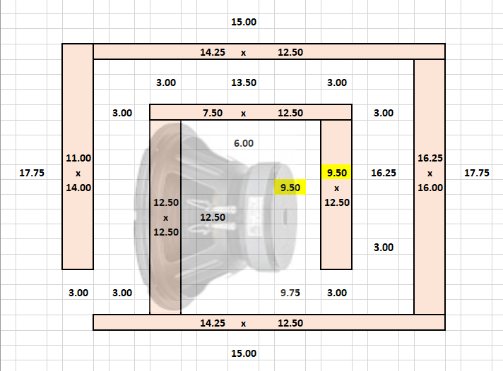

True on the 18 - but my spot for a 4 foot tall sub is only about 15" wide at best nnd hen blocking over half of a DVD rack. I can't see well with my monitor - which of the designs that is not isobarik goes low enough to have some fun with 18PT?
Years back I ran 4-18" Eminence vented boxes - one pair 6.4CF (picture below) and slightly taller pair on the bottom at 8.2CF. They R-J- vented in style seen iin an early 1950's Radio and TV News magazine where the builder made hic cabinet of asbestos board and de-Q-ed the whole system with an array of holes going straight through the front panel- then through the baffle.
This was the top / 6.4CF vented box- it was cool to be able to poke a mic into the aperture and see the summed response - plus it played very nice with a 103g (IIRC) Eminence 18. The box below had mms ~130g Eminence with fs 23Hz. I still with I had gone with K18 just for kicks.

yah - a 3-way PA sounds like a good idea for GRS 18PT. How about this nice $31 or so compression driver ?:

This is a recipe for a cheap 18" version of a Heresy I - ha

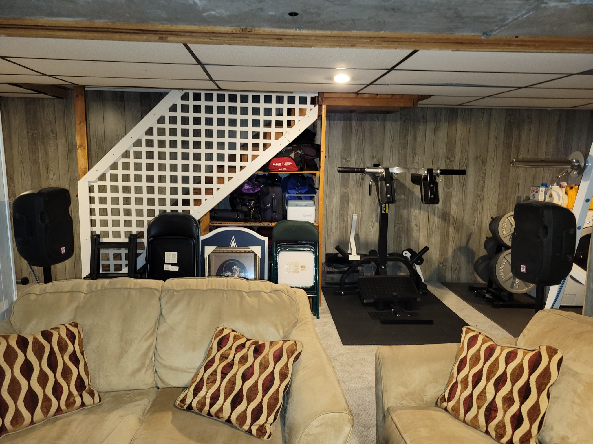

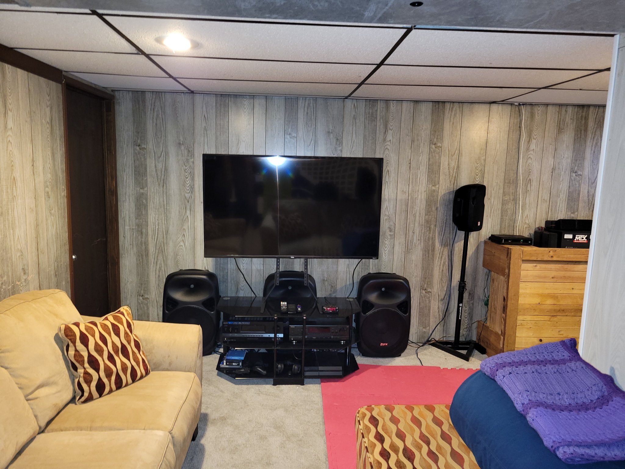

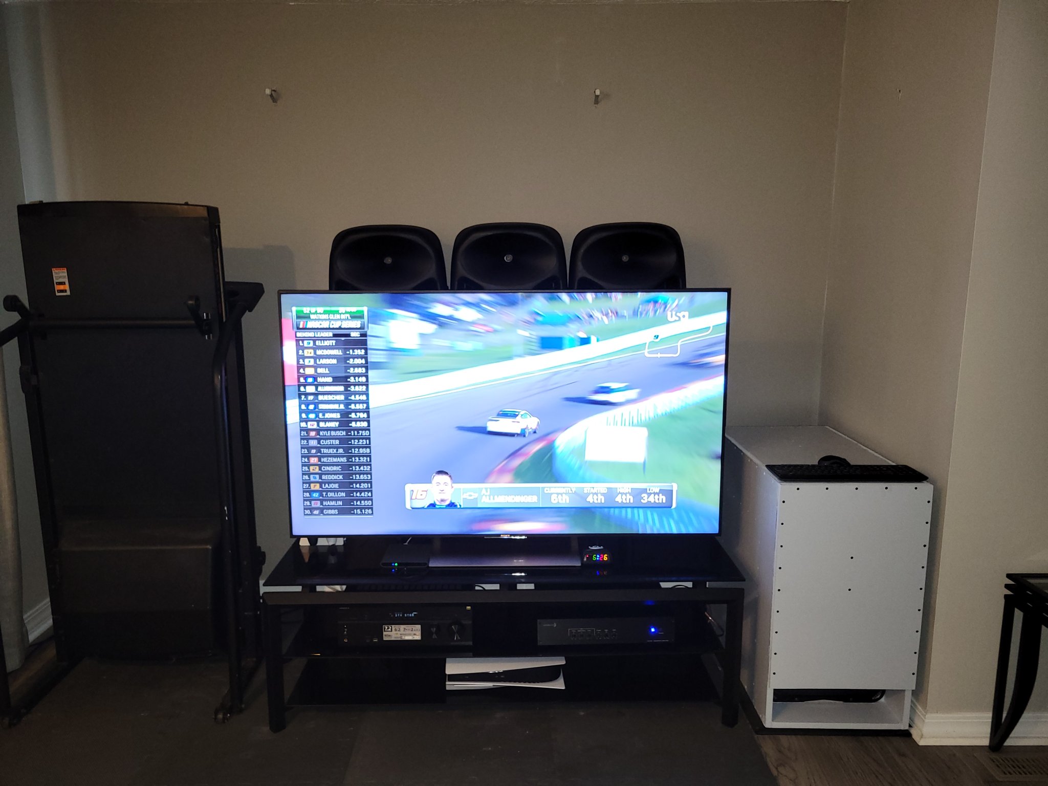

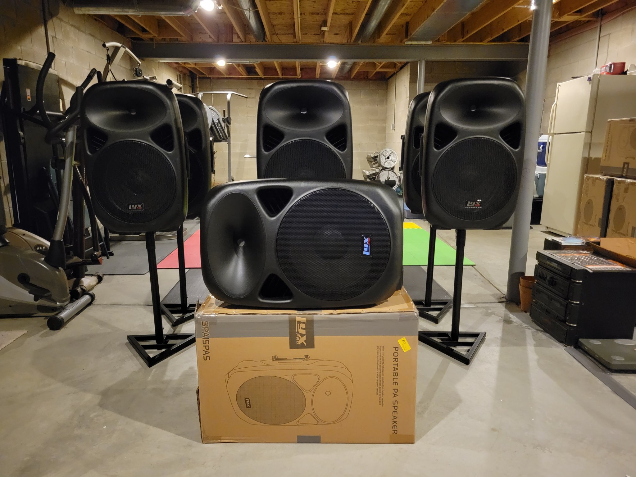

I went from 5.1.2 Dolby Atmos with the 8's and 7.1 with the 15's at the previous house to three 5.1 systems at the current house.
Basement work from home office:
15" center channel.
4 x 8" LR & rear surrounds.
18" Road Yamaha BR bin.
Basement chill spot:
3 x 15" LCR.
2 x 8" rear surrounds.
2 x 12" BP4 coffee table.

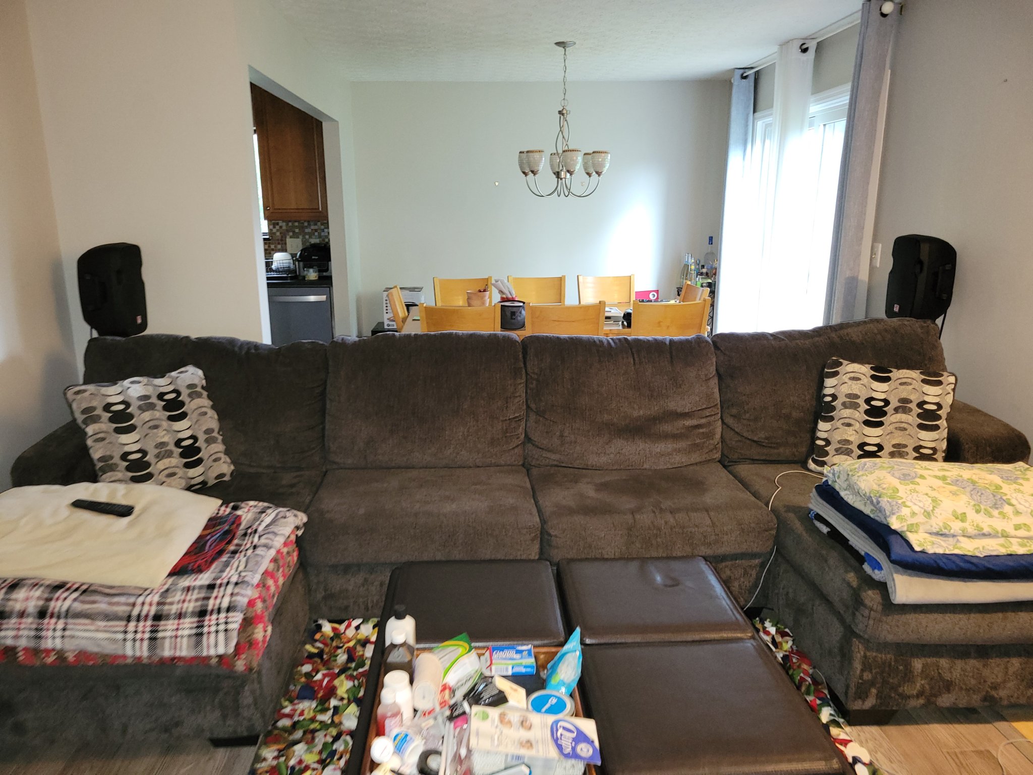

Living Room:
3 x 15" LCR.
15" T-TQWT (negative flare tapped horn).
