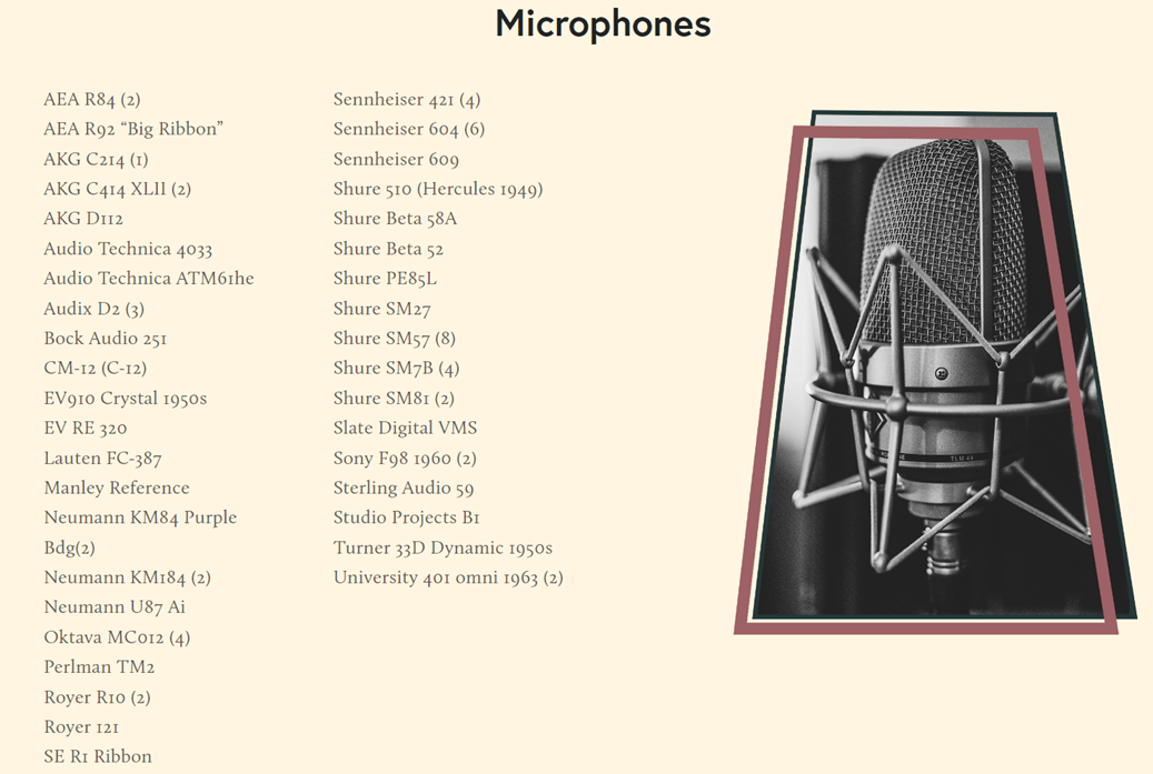

Art - microphone list from Round Table Recording Company. I have another session booked for 3-22. I will get specific mics used and distance...stay tuned!
