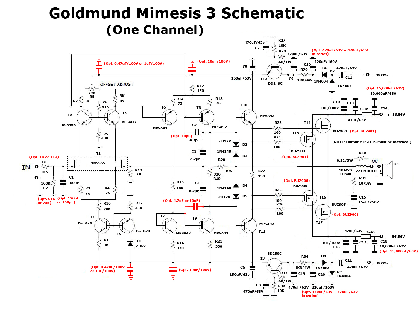

Hi steveu
Please see what I have in mind
I suspect that C11 and C21 are bigger than they should be and that will mean you get a full 112VDC on C10 and C20, which is unnecessary and wasteful. Using a cap as a deliberate (AC) voltage drop is a means to avoid wasting power. Note that Crown used 22uF.
C10 and C20 can return to +56V and -56V instead of to ground, which means a 63V cap is enough.
Another 1n4004 from +56V to C9 and -56V to C19, guarantees the IPS voltage is at least as high as the OPS voltage.
