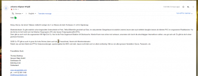

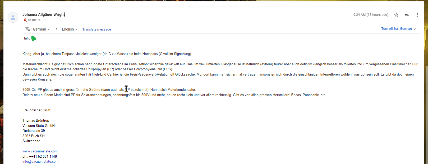

So I wrote an Email to Steve from Decware and to Allen Wright's Vacuum State, asking for their opinions regarding electrolytic caps vs foil.
Vacuum State are actually in my country only 3 hours by car away from me. They replied to me in german, I will do my best to translate it but will attach a screenshot of the original email.
I've asked Decware this question ""Are there any circumstances where electrolytic capacitors are preferable to film capacitors in valve amplifier circuits?"
Steve from Decware replied: "Many will say the foil caps perform better, but despite the size and cost -- either one would be a detriment, the sound is also different. Sometimes things sound better with electrolytics."
I asked Vacuum State a more detailled questiion "Does the capacitor in an rc-filter have a great impact on the sound?
Does the price of a foil capacitor in this function influence the sound quality or is it irrelevant?
What capacitors do you use for the power supply of your 300B PP amp?"
Thomas Brüntrup, long term partner of Allen Wright and technician replied:
"Sound: yes, in a low-pass filter, maybe less than in a high-pass filter (signal path).
Materials: Naturally, there are justified differences in price. Glass wrapped in Teflon or silver foil in a vacuumed glass case, is naturally (extremely) expensive but definitely sonically better than PVC in a castplastic case.
But without overdoing it, polypropylene foil (PP) or even better, polyphenylene sulphide (PPS), is good enough for starters.
Then there are the so called HiFi High-End Caps. Here, the price/performance is often a matter of luck; Mundorf can surely be trusted. Otherwise, dig through the relevant internet forums to find what could be good. However, there is a certain common consensus.
300B Cs: PP capacitors also exist for higher currents (motor capacitors - MP). Relatively new on the market are PP for solar applications. Rated for up to 800VDC, they are relatively small and square-shaped. They exist from all the big manufacturers (Panasonic, Epcos, etc.). "

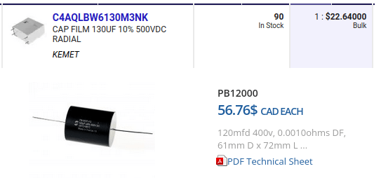

Incorrect. 130uF 500V Digikey price top, 120uF 400V Solen price bottom.
The Kemet's tighter lead spacing and smaller form factor help keep circuit layouts tighter, beneficial attributes for high impedance tube circuits.

There is a noticeable difference in size and it's not that the space is unused, the Solen has probably more material inside providing better dielectric and better insulation. Again, here we are going into debate "BUT DO THEY AFFECT SOUND?????" but considering you said that they sound good, I am just gonna assume that you indeed believe that different foil capacitors can sound different.
