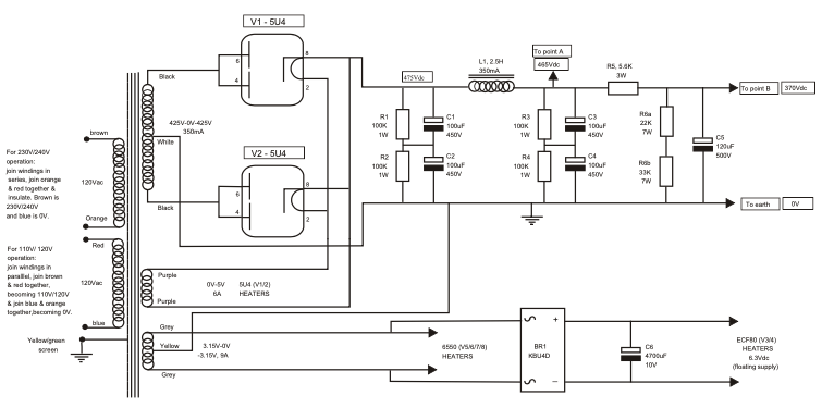

Still interesting. My WAD6550 push pull was designed by Andy Grove. It uses two U54 rectifiers and feeds into 50uf/2.5L/50uF filter. I wonder if using 2x5U4 allows a input bigger cap?Nothing, that was just an example. EZ81, 5Y3 etc etc are similar but the GZ34 can stand a higher capacitance on the cathode than say a 5Y3 or GZ37 or U54 as the latter can only use a 4uF tank capacitor. Have a look at the valve data sheets.
Your schematic shows 5U4. The maximum capacitance is 32 uF for one. So the 50 uF for 2 x 5U4 in this amplifier seems in line with this maximum (2 x 32 uF = 64 uF).
This datasheet for the U54 doesn't state a maximum value for capacitance. It only states 4 uF as "typical operation".

For the OPs 220uf cap requirement, there would imho be no benefit related to ripple current or hum/esr. In reality an e-cap may have tangibly better total equipment hum performance due to smaller charging circuit loop layout.

The point of power supply caps is to maintain a low power supply output impedance across the range of frequencies in which the amplifier is used. This is the same as for the power supply of any amplifier.
The solution which is commonly seen is to parallel several different caps. Electrolytics are almost a necessity for maintaining a low output impedance at low frequencies, since you need quite a lot of stored energy in this frequency range.
Electrolytics do tend to be less ideal at higher frequencies, and some are better than others. This can be compensated for by paralleling a smaller-value film cap. That smaller value film cap should ideally be located quite close to the output devices.
For those who will inevitably ask, regulation doesn't really solve the problem, because most regulator circuits don't have a flat output impedance across a very wide range of frequencies. Take a $5,000 Keysight power supply and hit it with a fast, pulsed load and you'll see what I'm talking about. The regulator takes some time to compensate for the change in load (that time varies based on the type of power supply and how it's compensated).
For tube amps that I build, I typically use some pretty chunky electrolytics for the bulk filtering. I usually oversize these a bit, since it allows one to get away with a somewhat squishier plate transformer without any real impact on sonics. I then usually put a few smaller value film caps (say 10 uF) right by the output tubes.
The effectiveness of this is easy enough to test by hitting the power supply with a pulsed current and watching how it affects the rail voltage with a scope.
