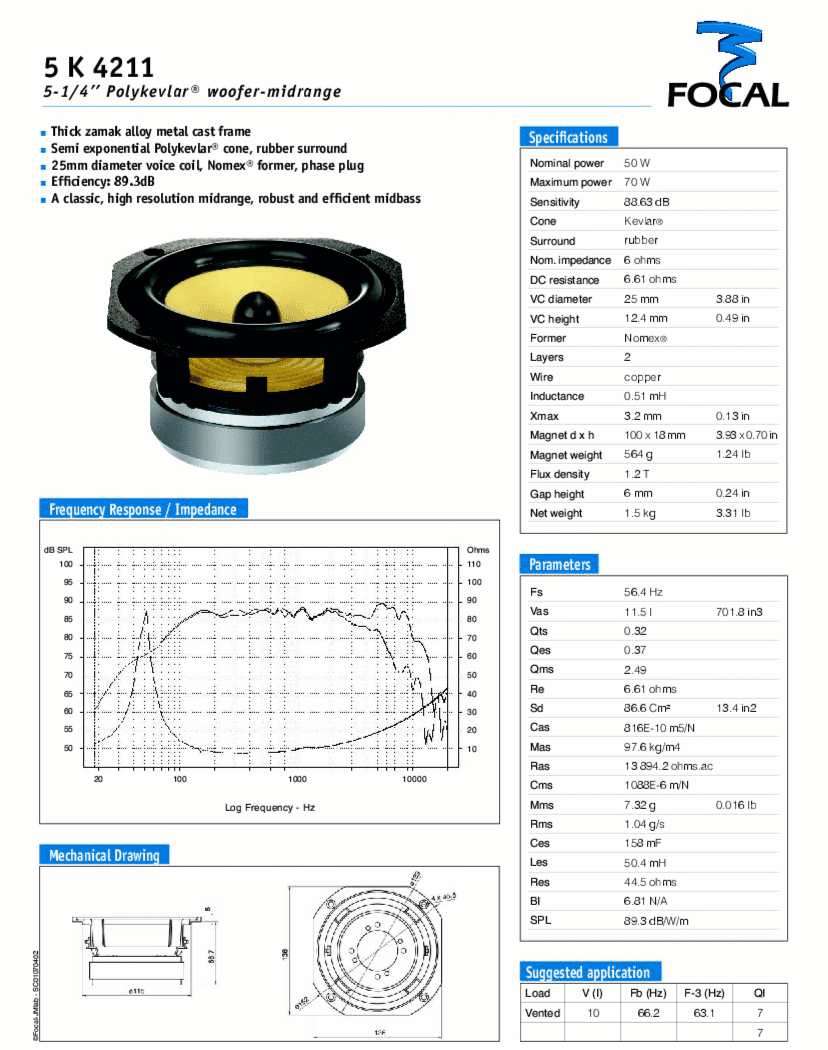

There is tools to trace the curves from manufacturer datasheet which will create frd's and zma's to be used in sim software. Both of the driver datasheet available online.
Thanks for your quick reply. I have the data sheets and will try to find the .frd and .zma tools

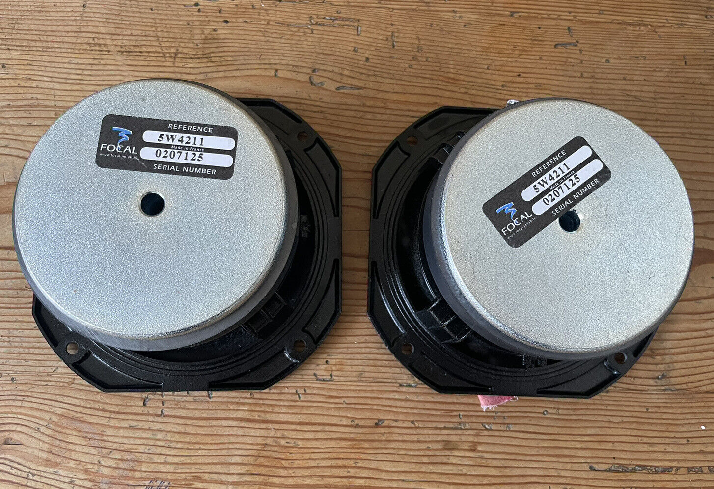

The 5W4211 could be also a good replacement - go to
https://www.lautsprechershop.de/hifi/dappo.htm
and the attached pdf and jpg files
Main difference is according the datasheets the magnet size/weight and thus different force factor B x l and Qes

In the meantime I know, that both electrical and audible differences of the mentioned driver models from headline are negligible.

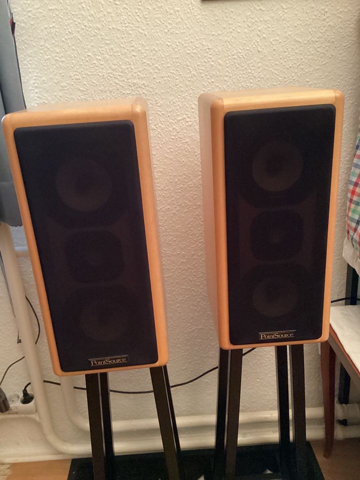

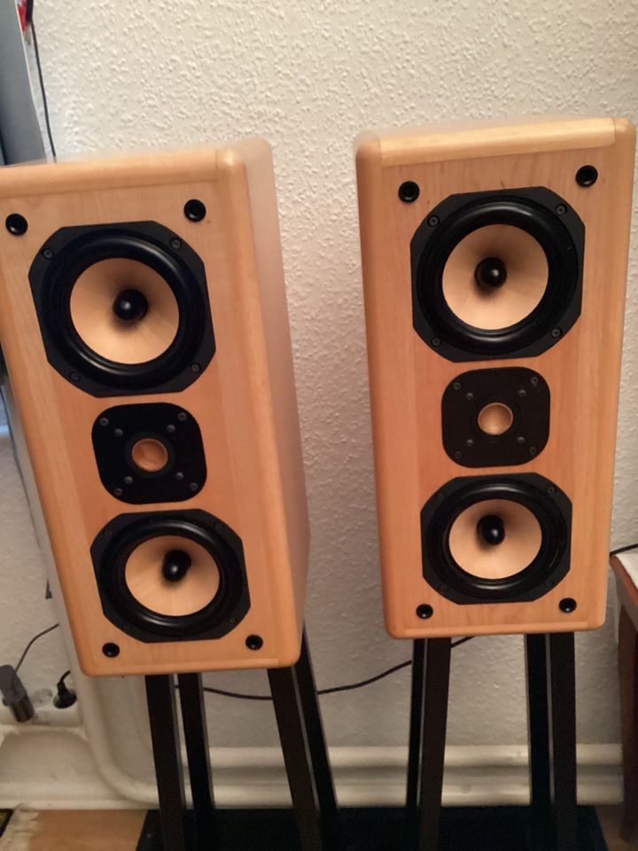

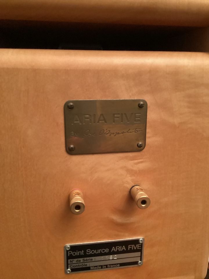

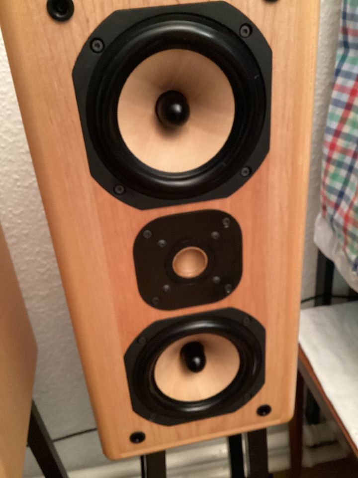

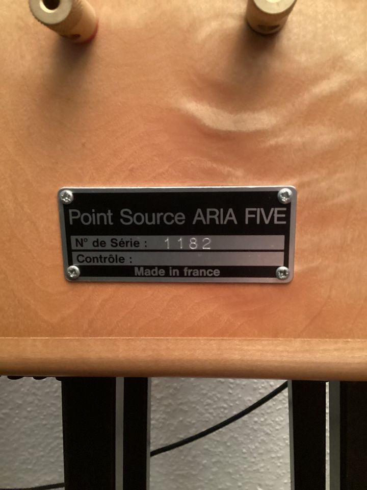

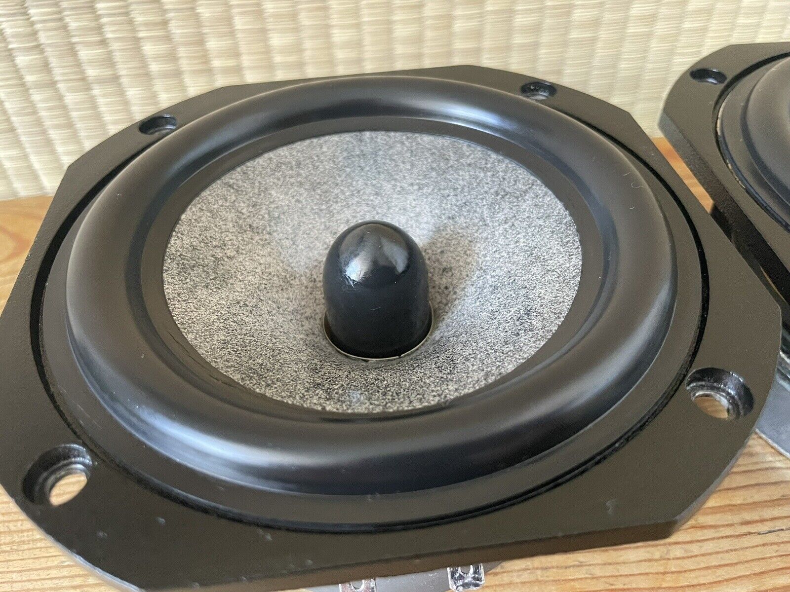

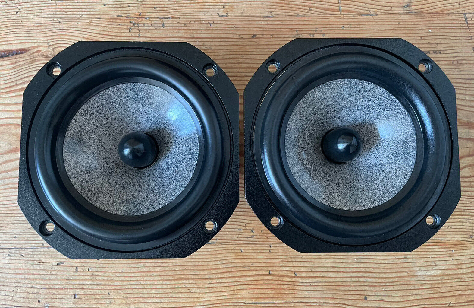

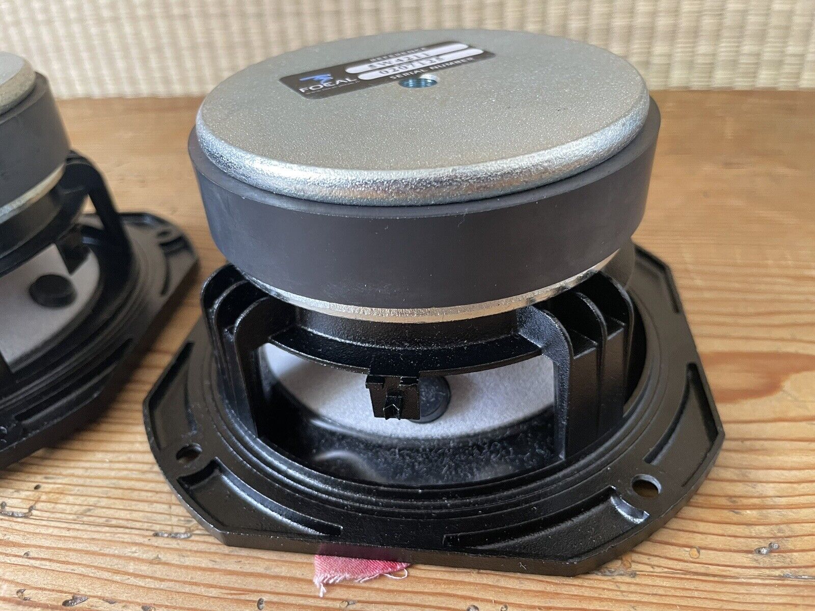

Now I have a similar problem with the same model from FOCAL, "ARIA 5" (from "POINT SOURCE" series, released sometime between 1988 and 1990 - go to the attached images of other devices from the same model) concerning damage voice coils of this kevlar drivers (unfortunately an old NAP250 without DC protection was in use).
One possibility is a voice coil repair (I already ask therefore via e-mal under info@focal-naim.de)
Another possibility is a replacement of new driver with similar sonic character.
Who know, which currently available drivers have similar parameters and sound properties than this old kevlar versions ?
Thank you very much for an information.

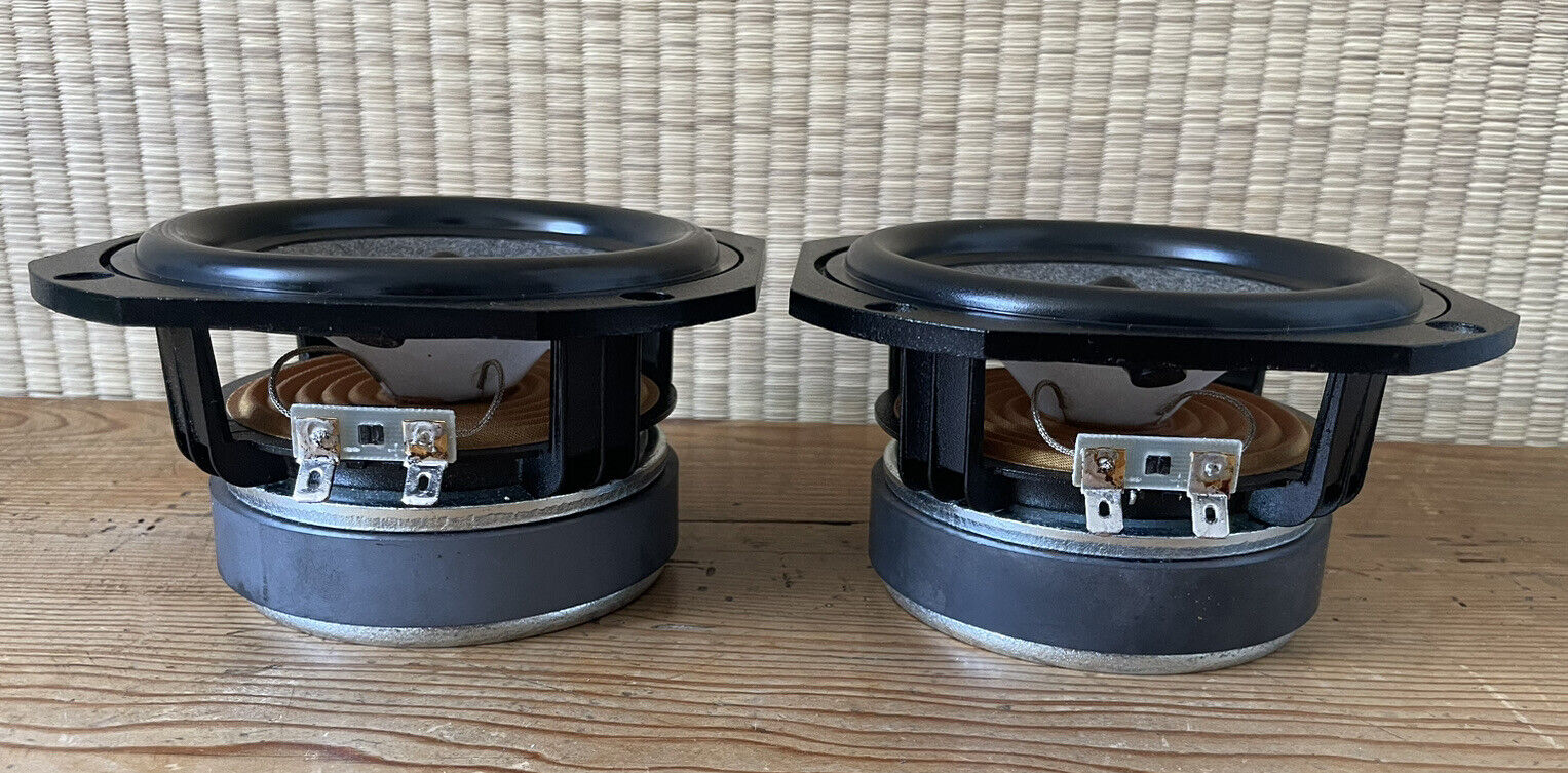

The problem is the form factor of the chassis.
See Audax HM130C0 , seems to be a drop in replacement, not the same colour and sound.
Audax proposes other cone paper and aerogel.
If the form factor is not a problem, you redraw the front, you don't miss choices in new drivers.
Note a friend of mine who likes this kevlar sound bougth in this new line the 936 and he is happy :

BTW: Foam surrounds are much more easy to replace than a restoration/refurbishing of a burned voice coil - go to
The HM130C0 from Audax could be a replacement. In the attachment the overview of the old ones and alternatives.
I am waiting first to the reply from Naim Audio before start with replacement types.
For longer time I have heard from a friend, that anywhere (where the old Focal production facilities were located) burned voice coils will be restored using the old production equipment.
I will certainly find out in the NA reply whether this service was only offered temporarily a few years ago or is currently still offered.
