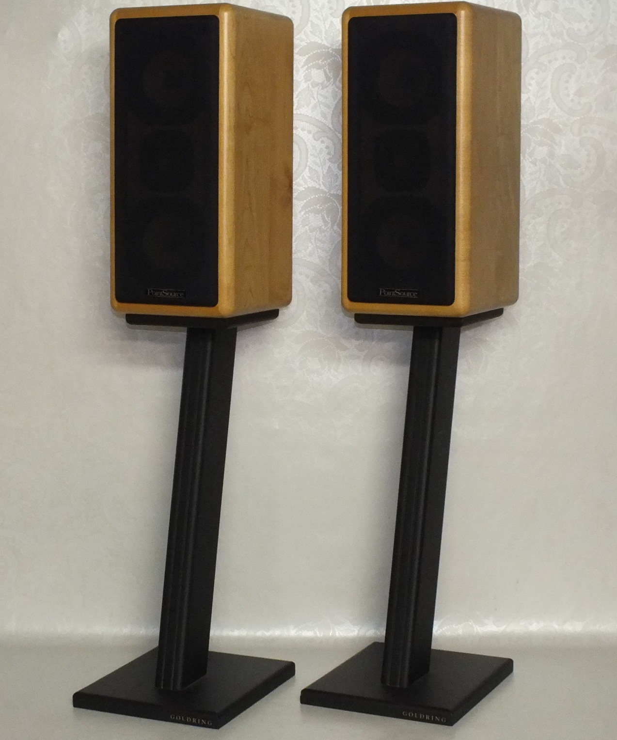

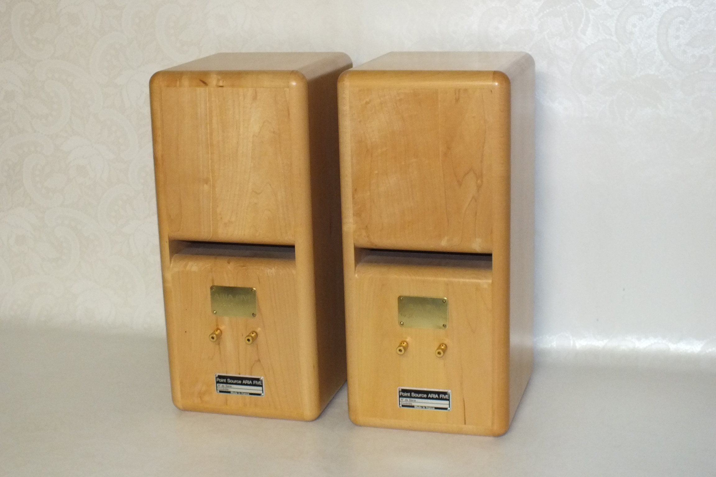

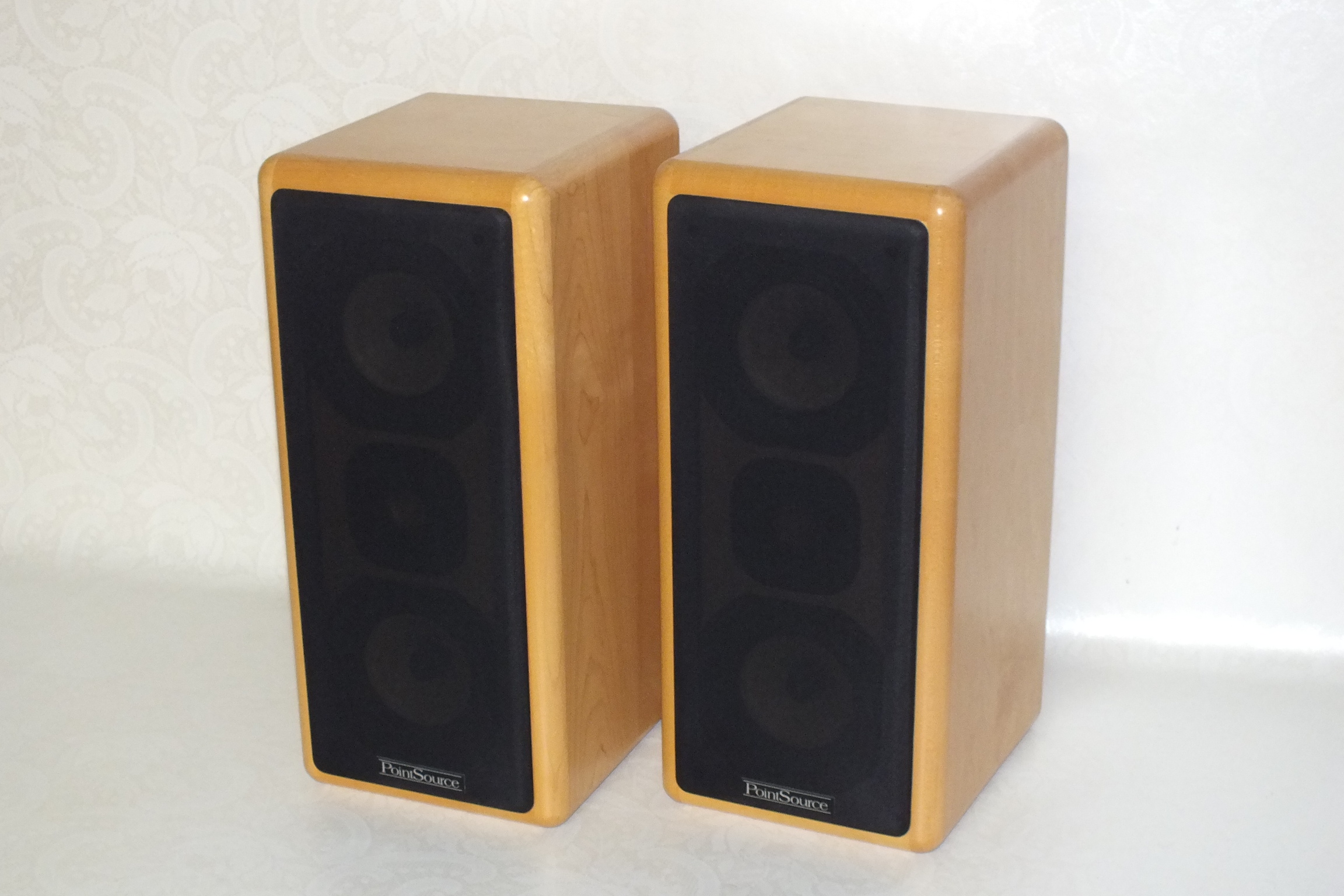

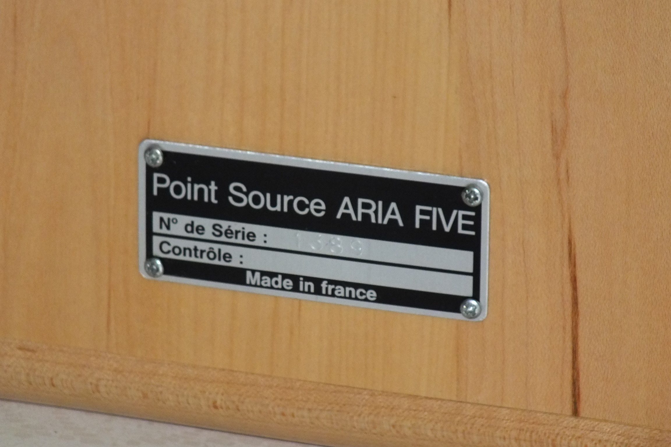

For repair of an old Focal Point Source Aria Five (from 1993, Manfred Zoller HiFi Design)
I want to know the difference between this two chassis models.

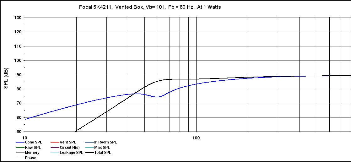

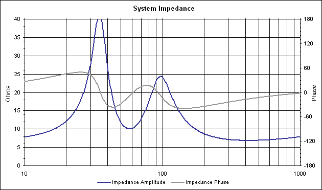

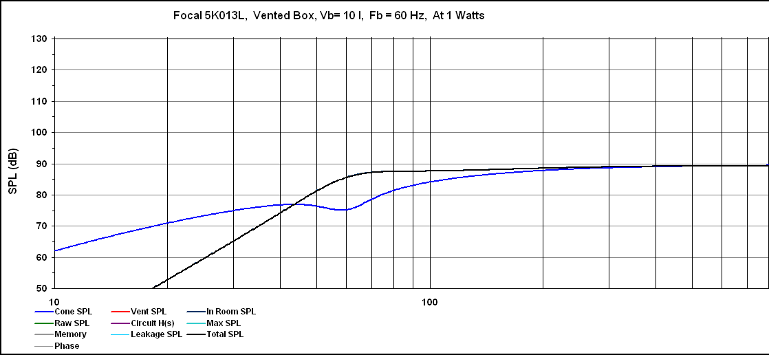

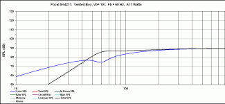

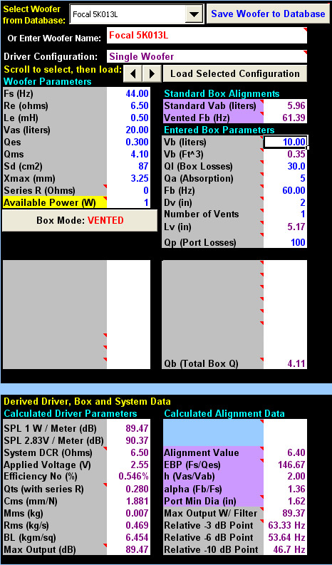

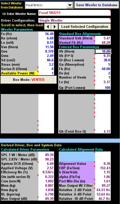

5K4211 vs. 5K013L
Both of the chassis have exact same measures of 136x136 mm,
so the probability that the screw holes are exactly the same, is
very high. Regarding TS parameters, these units seem to be
interchangable without further worries.

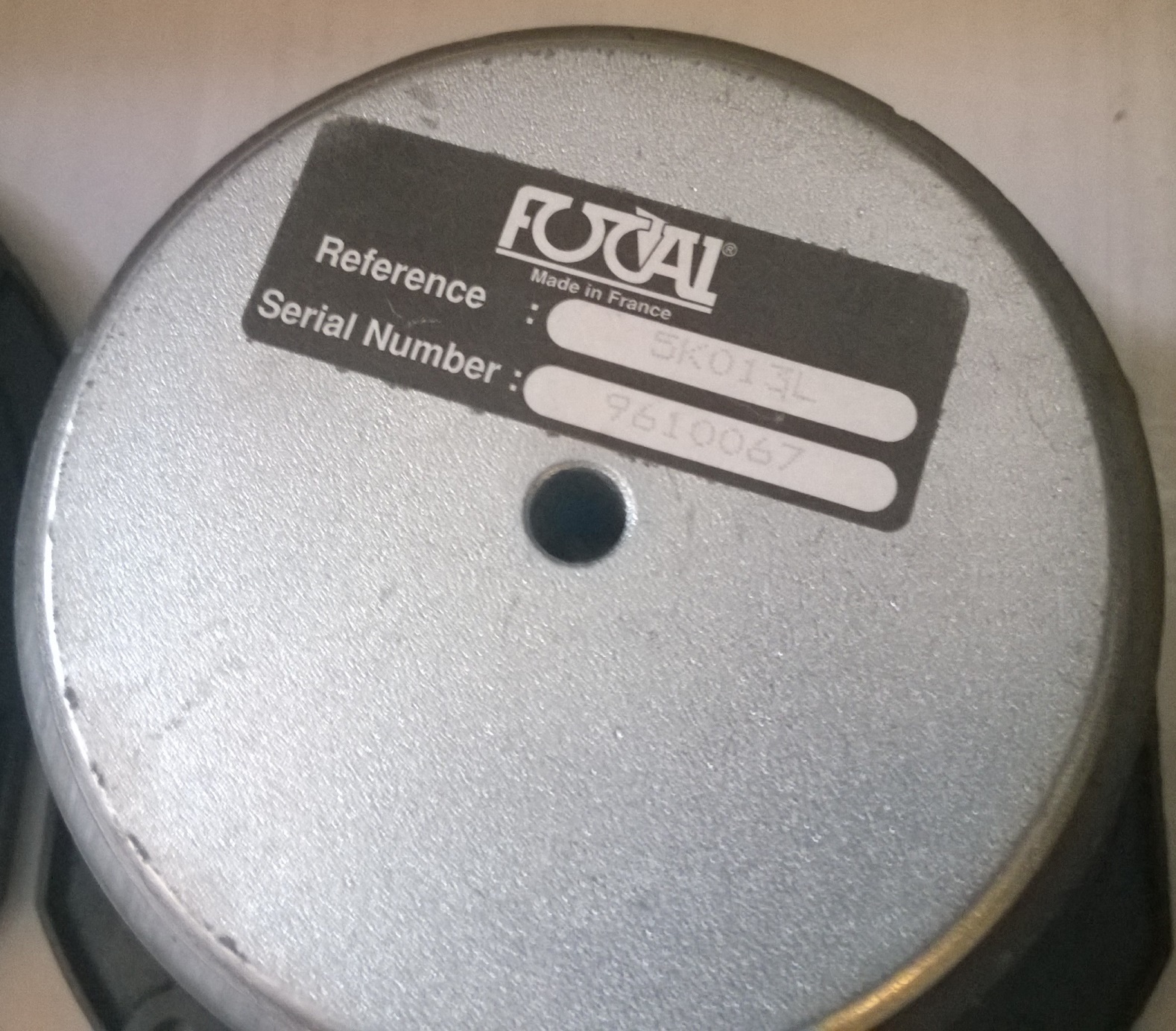

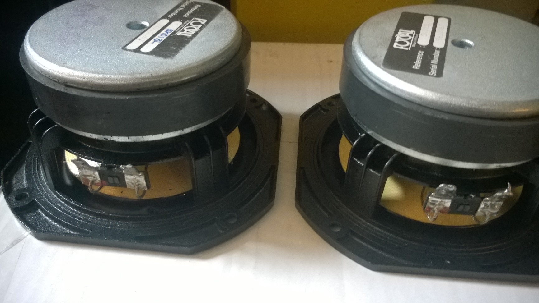

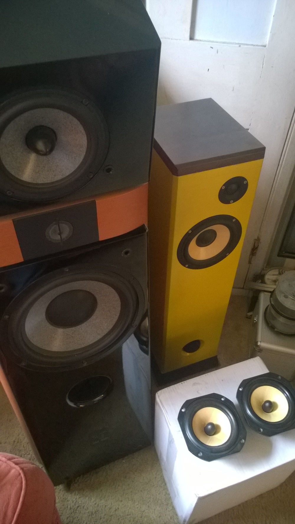

Happy to say that I've found the drivers, they are the 5k013L they seem in very good condition. Measure 6.3 Ohm and 6.1 Ohm.
I will post pics later today.
I must say that I don't think that the original poster has been vague at all, I do on the other hand find some of the replies, less than helpful.
These older Kevlar drivers are the precursor to the Utopia range, (They use cheaper fiberglass mat)I have used a number over the years and other than PHL's find them great.

Pictures as promised.
As for price, just out to help a fellow enthusiast. Please suggest a figure.
I have a few other drivers that I will also be listing later.
