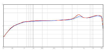

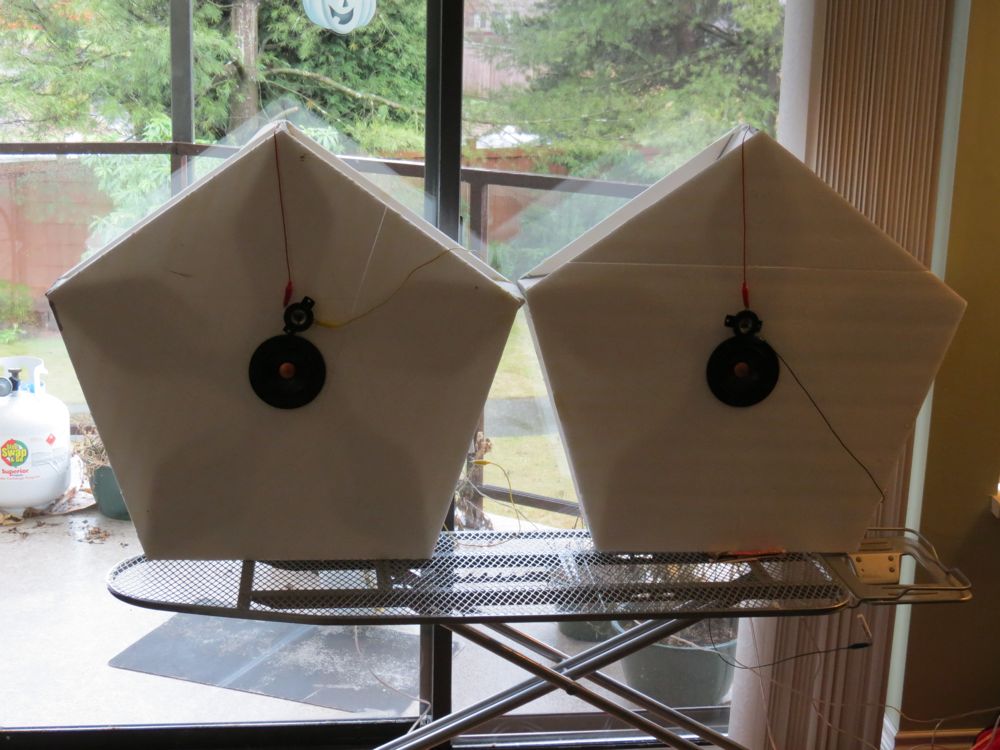

Played with the stuffing and tweeters. I have a feeling the tiny little domes are going to win the HF contest. The others need so much padding that you suck the life right out of them. As of now they sound semi-ok with 4Ω series and a 2.2 µfd cap but there's to much overlap overlap so I will reduce the resistor size and use a lower value cap.
The bass is as much as a Cornu, but is much better defined, as in 'apparent transient response' [ more punchy, if you like that term]. Still, the mid bass is a little bloated like the Cornu but when I added stuffing to the throats, it cut it off all together so I am still experimenting. Back in a while.

Nice work! I like the see thru effect. 🙂 The expansion is almost a tractrix. Might be why it sounds good.

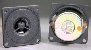

I posted on these earlier but Apexjr has a great deal on some really special tiny tweeters. $0.89
ApexJr Tweeters (scroll down the page)
I got several from Madisound years ago. They sound very good

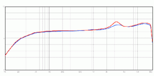

Impedence curve courtesy of Dave Dulgos planet_10 hifi

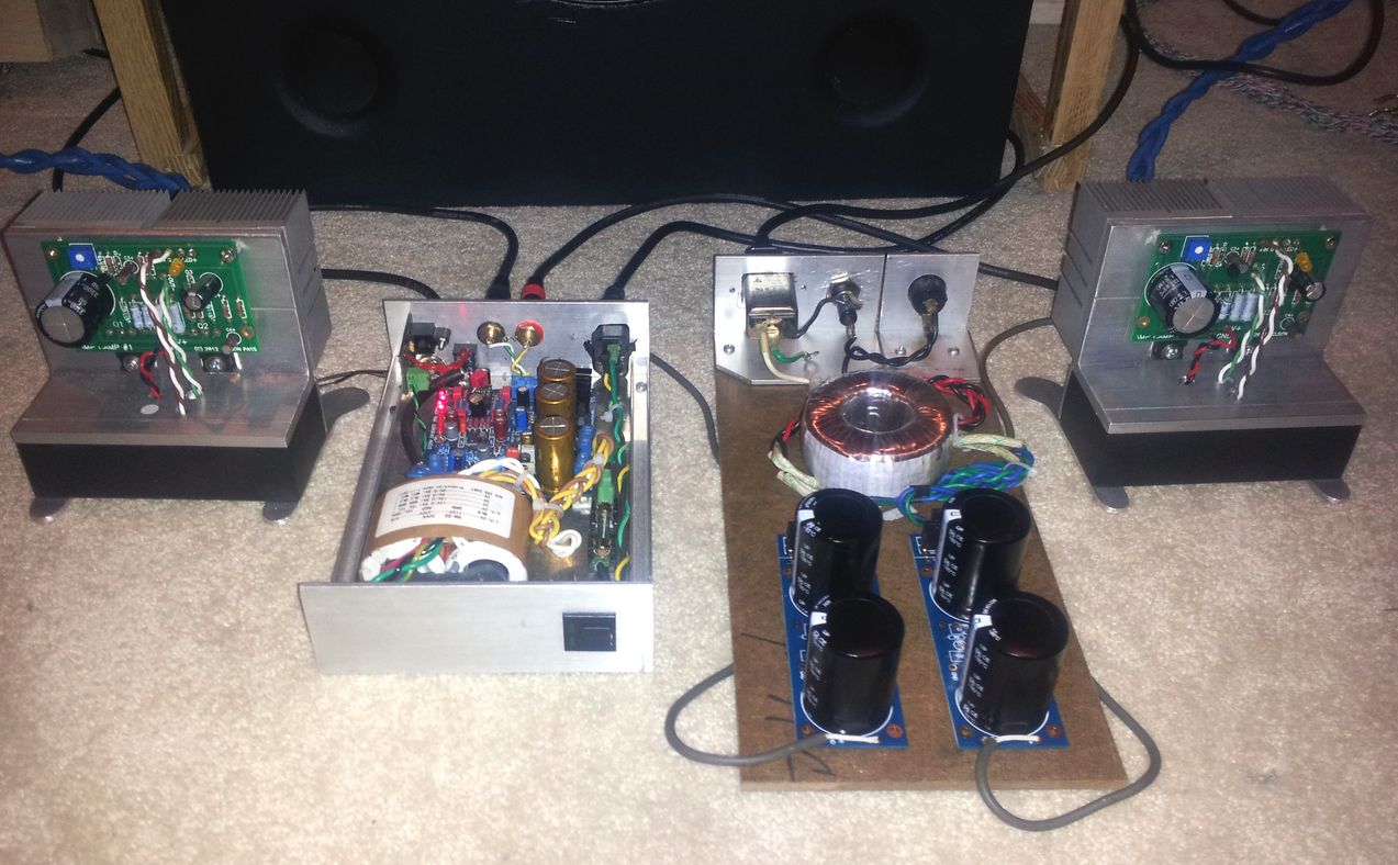

I have been wrapped up in the LM3886 chip world for the past few years. Decided to check out the Pass/discrete side for comparison.
Nelson devised the Amp Camp #1 as a simple intro for youth and other nu-bees to get started with a Class A discrete. They are a nice match for the Cornus as you get excellent sound at super low cost ~ $34
I'm doing a power supply mod in an attempt to eliminate the external bricks. Will eventually combine into one chassis.
ACA Power Supply Project.
And just like foam core speakers, one just isn't enough 😀, I went for a full blown discrete mostly because there are so many raves on so many threads I could no longer resist. It isn't a bonafied/approved Pass item but it got me in the ballpark. There is a lot of heat produced by discrete amps so I trying to incorporate PC cooling techniques with amp building. The jury is still out.🙄
BLAT 2 Discrete Project.
As there is no SWMBO or other adult supervision in the castle it's anyone's guess where it all will lead.😕

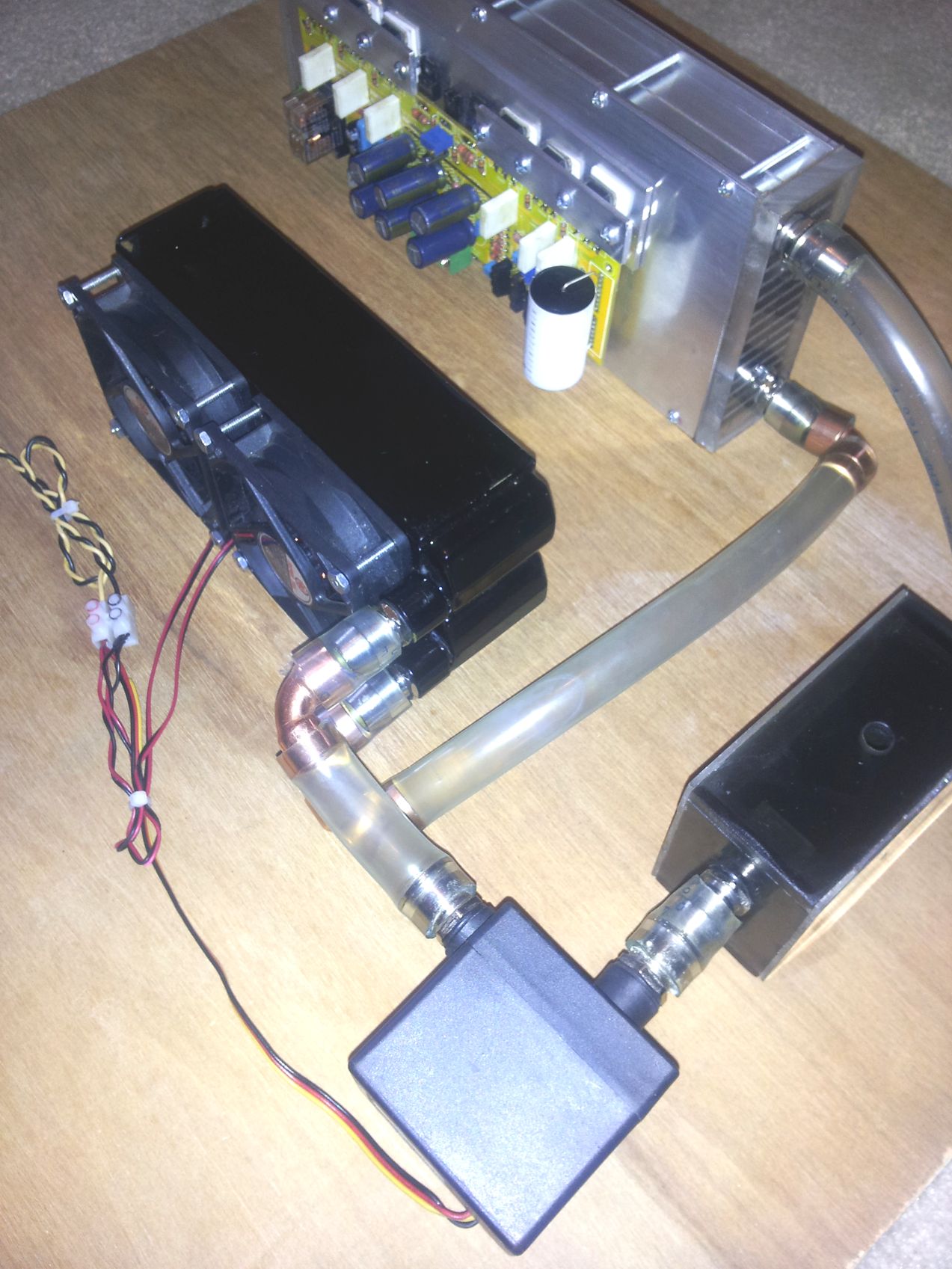

Looks really interesting and like a lot of fun. I see aquarium pumps and air to water heat xchangers. Is that from your pc stuff? The problem with class a is the heat and you are dealing with it the most compact way known. Does it really sound better than a good class D amp? So all the parts are $34 (not including heat xchanger)? I am working on a 25 watt amp that puts out 2.5watts excess only when driven to full load with continuous sine wave. In fact, I may solder a copper penny to chip as heat sink for normal music loads. You have gotten me interested in a Pass design though - looks easy enough to build.
Correct me if I am wrong but are you mixing two of us up? 🙂
X is the only one talking Vifa's and FH Mk-lll.
I guess we must look alike!? 😉
We are gonna get slammed for being too far off topic, but...
"....... I see aquarium pumps and air to water heat xchangers."
I started water cooling PCs about eight years ago. Got tired of paying $50 to $80 for good pumps so I modified an aquarium pump ($9) and combined it with the reservoir. It's been perfect cooling dual Core II CPUs and two Quadro workstation graphic cards.
