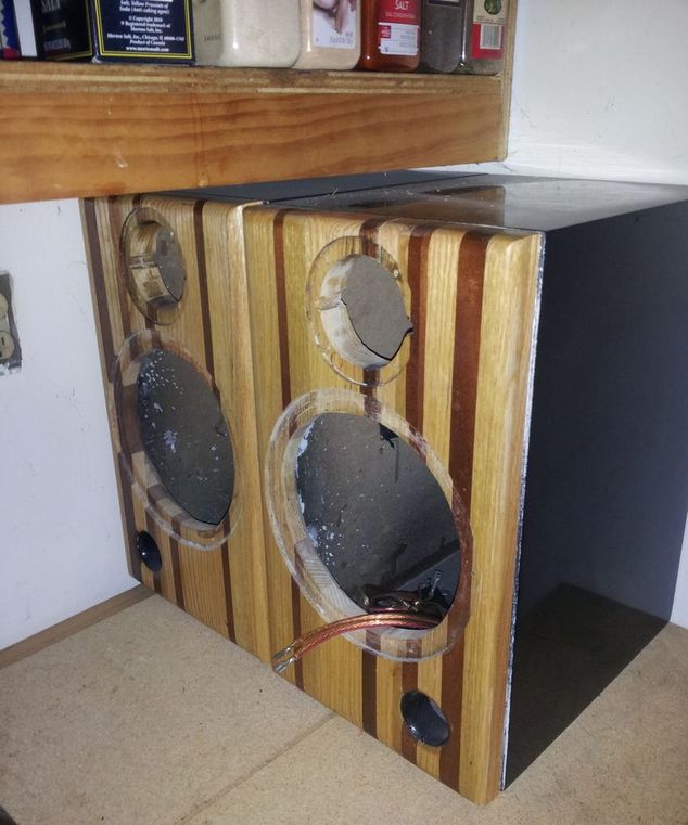

Cement is good !!! Made these last summer for a pair of 8" monitors from the PE forum. Have all the components - just need Spring to come to get them unstuck, thawed, cleaned up and painted

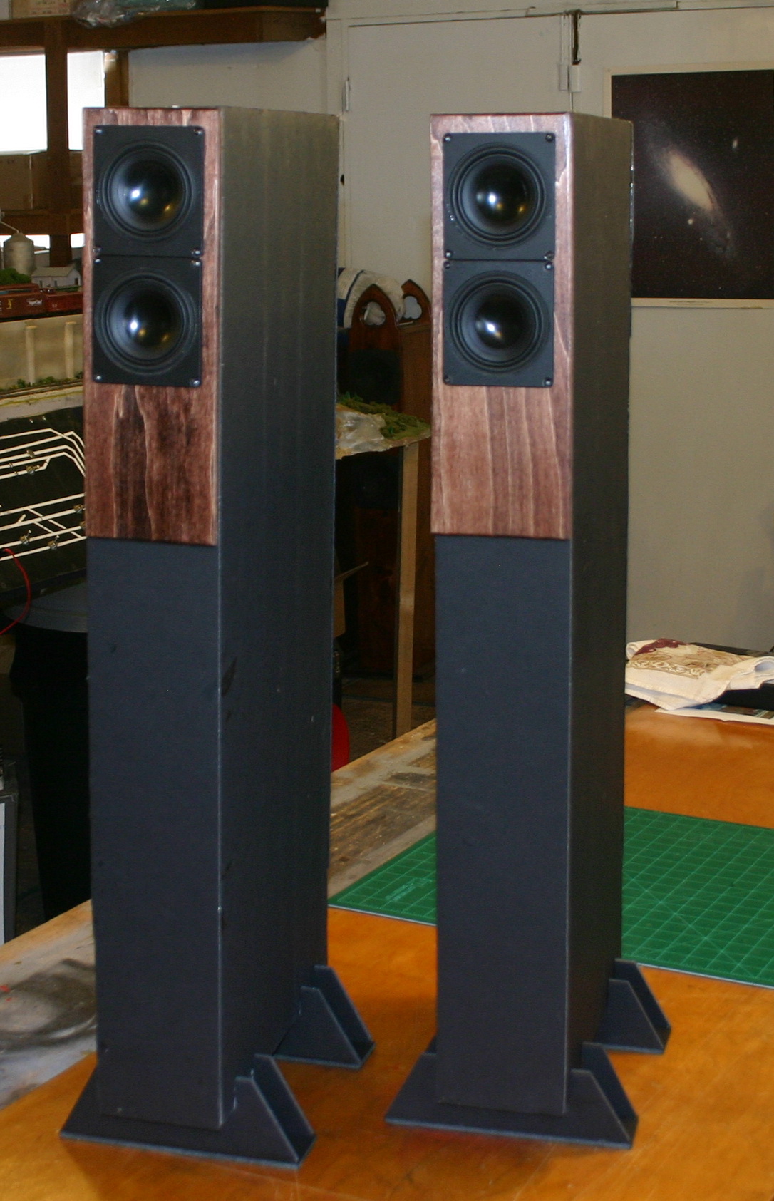

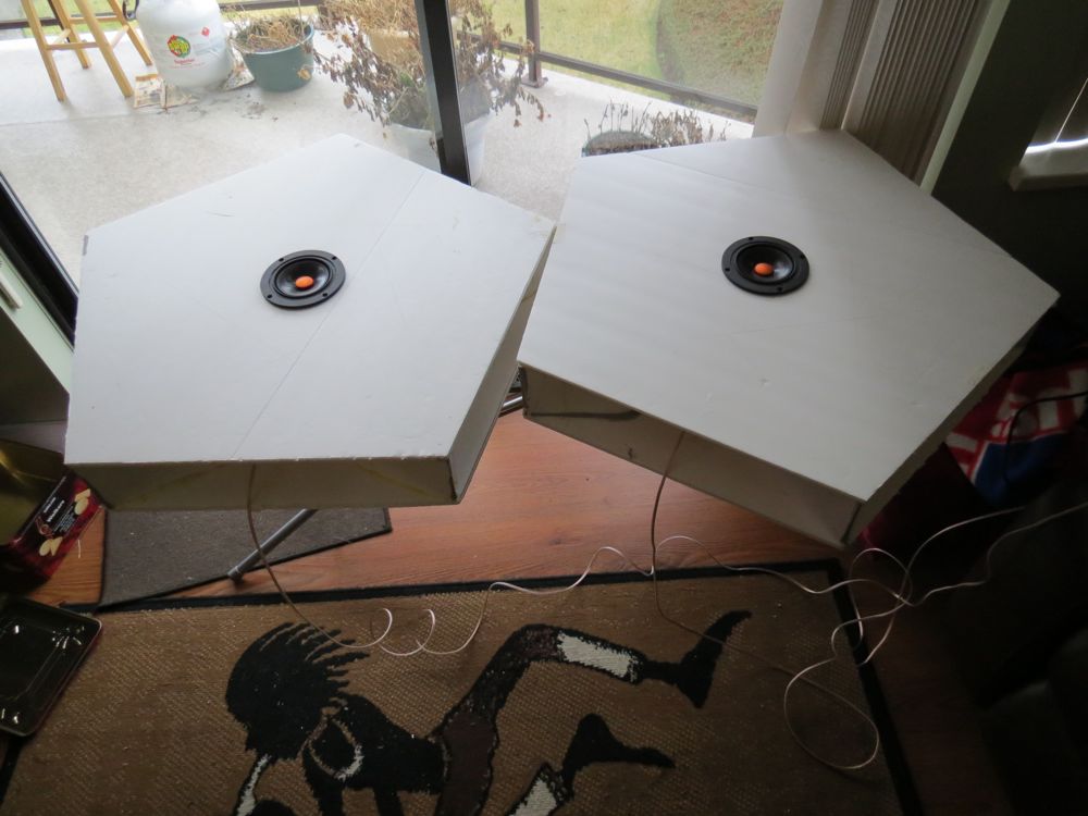

Here is another iteration of foam board construction with foam stands. Two Audience A3 Full range speakers per side in a traditional full SD, 1/4 wave at 40Hz. No tweeters needed here and the bass is that typical warm type that only TL can provide. The imaging is also stunning. Still need to do some measurements. Foam is a cheap prototyping material and these enclosures could be fabricated with 1/4" or 1/2" plywood and still maintain the narrow profile.
I would think they would work fine. The Audience was designed for use in their line array systems and was overpriced as a DIY speaker. They are relatively flat from 40hz to 20Khz, an amazing bit of engineering. The Audience specs are 70Hz fs, Qts .33, Vas .11 Ft cu,
with an Xmax OF 12 mm. I'm not familiar with any Vifa driver that comes close to the Audience specs.
