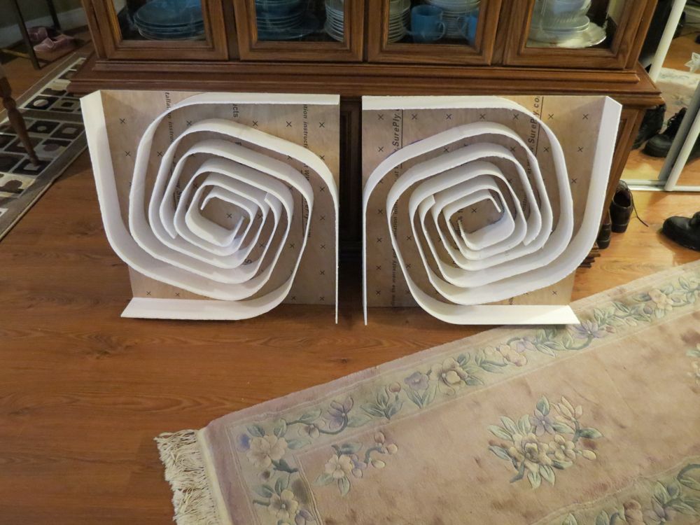

Second spiral done.
I've been thinking of the rough edge on the foam. It was easy to deal with it with the hot glue but not so easy when add the fronts so I have an experiment I am trying. I am gluing the top edge with yellow glue then adding a thin strip of regular writing paper over that to act as a surface tensioner to hold the glue. Then I turn the whole thing over on a flat surface and weight it. I am hoping this will give me a flat surface to glue to. I am trying the same experiment with masking tape in place of paper. I realize this sets me back a day but what the heck, a week ago I wasn't going to be doing a build until the new year so...
So you are building a glue fillet on paper, then gluing that to the front once the fillet dries? Sounds like it should work. Maybe hand cutting the channels with razor is the way to go? It takes about 30 minutes to make all the strips.
Ya, the two minutes it took to do it on the saw is going to be more like the same time it takes to cut them by hand when all is said and done.

Second spiral done.

Changed my mind again. While I was counting sheep, I got distracted. I am thinking if lay a bead of glue on the foam, place the baffle over that and then remove, I will have an outline of the glue on the baffle. I can turn that face up, lay a heavy bead right on the baffle and place the spiral face down into it. That way I may end up gap free.So you are building a glue fillet on paper
That is a good idea, saves you time too. This got me to thinking why not use some really thick glue to really seal those gaps - would industrial floor board cement from big caulk guns, etc. work (ideal since you are using floorboards for the faces)? What about RTV?
I read somewhere that there is a pre-scored masonite or MDF sheeting that allows bends called 'Bendyboard'. It may work well too but doesn't look so nice with all those slots. Yes, it is counter-intuitive which side to put the cuts on. It would work of course on the other side but you would expose the foam cracks rather than compress the foam where you need it and keep everything tight.
