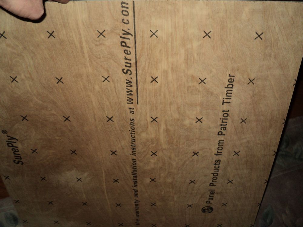

Templates made. I increased the size of Sebastien's drawing, took a screen shot and took it to the repro store. 5 minutes later I had 2 copies exact size.

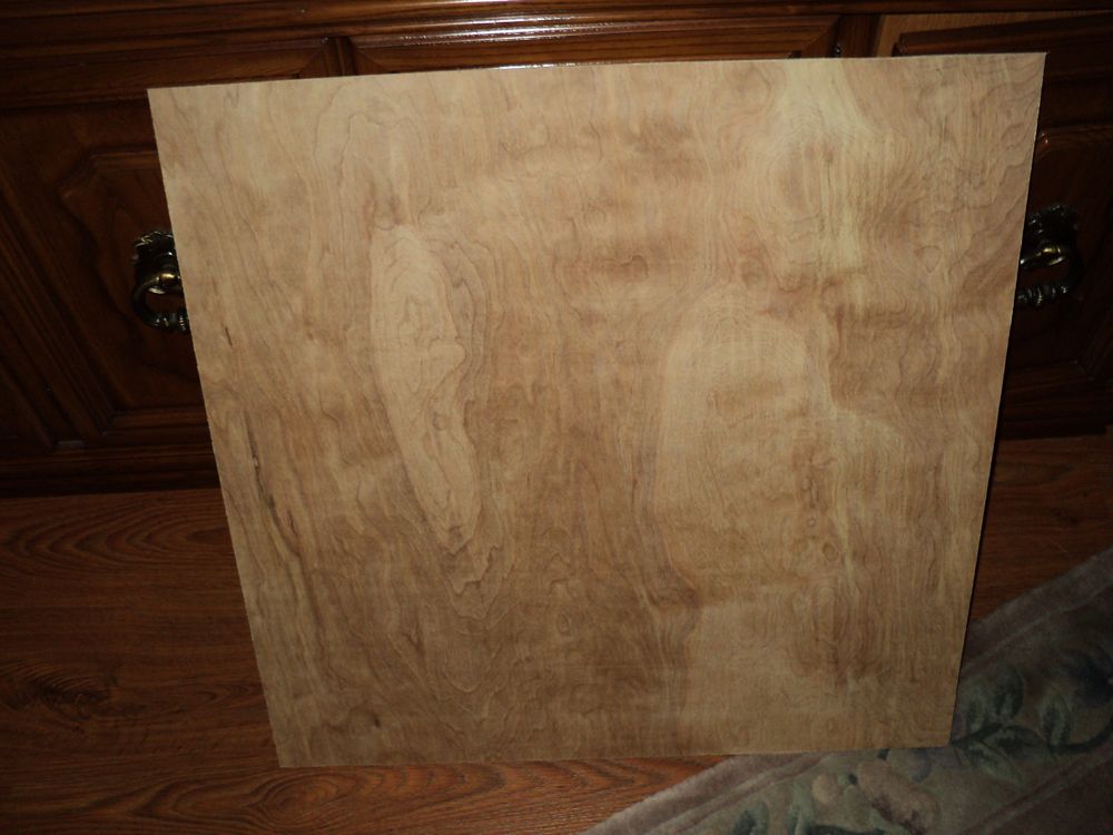

Facers bought [Sure-Ply 1/4" underlay] and cut to size. 70X70

That plywood looks really nice for underlayment that no one sees! What does the quarter inch sureply cost? It looks like it is Birch plywood?

To answer your question, The underlay, and I'm not sure why they call it that cause it is nicely veneered, was $11 dollar per 4X4 board so I had to buy 4. Still cheaper than buying finished ply where I would need more than 1 sheet.

I have to try this plywood, a 4 x 4 sheet is exactly enough for two of my 20 inch speakers. Speakerwidow ha ha - good one. 😉

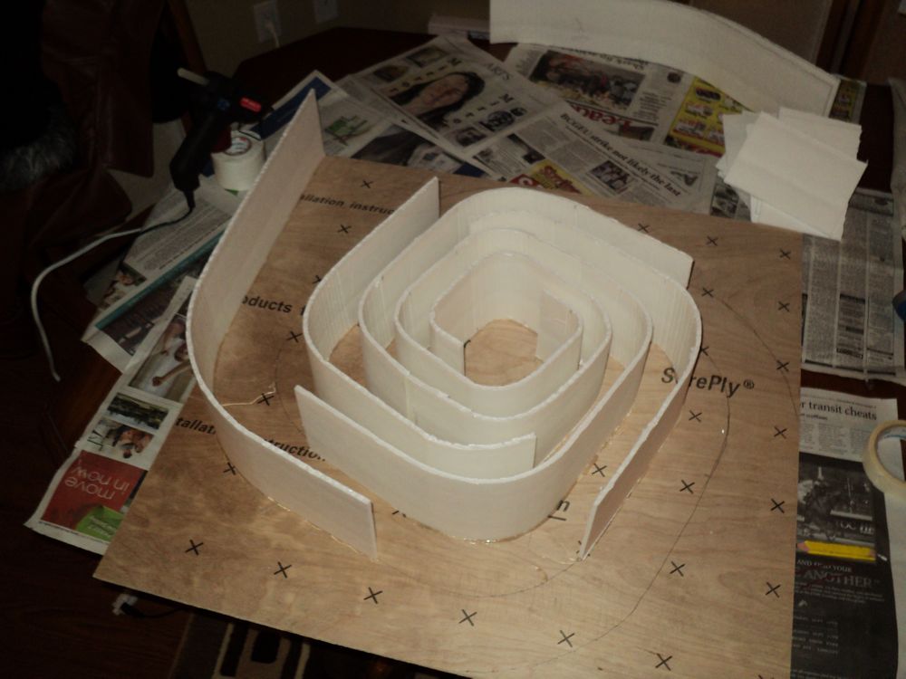

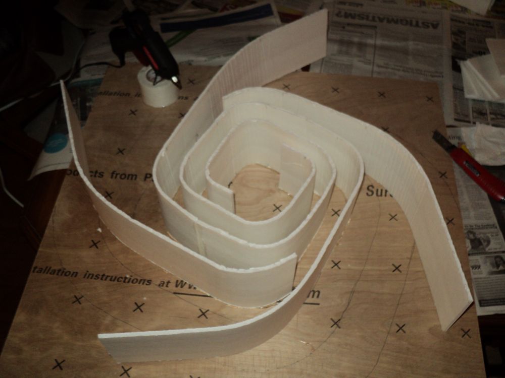

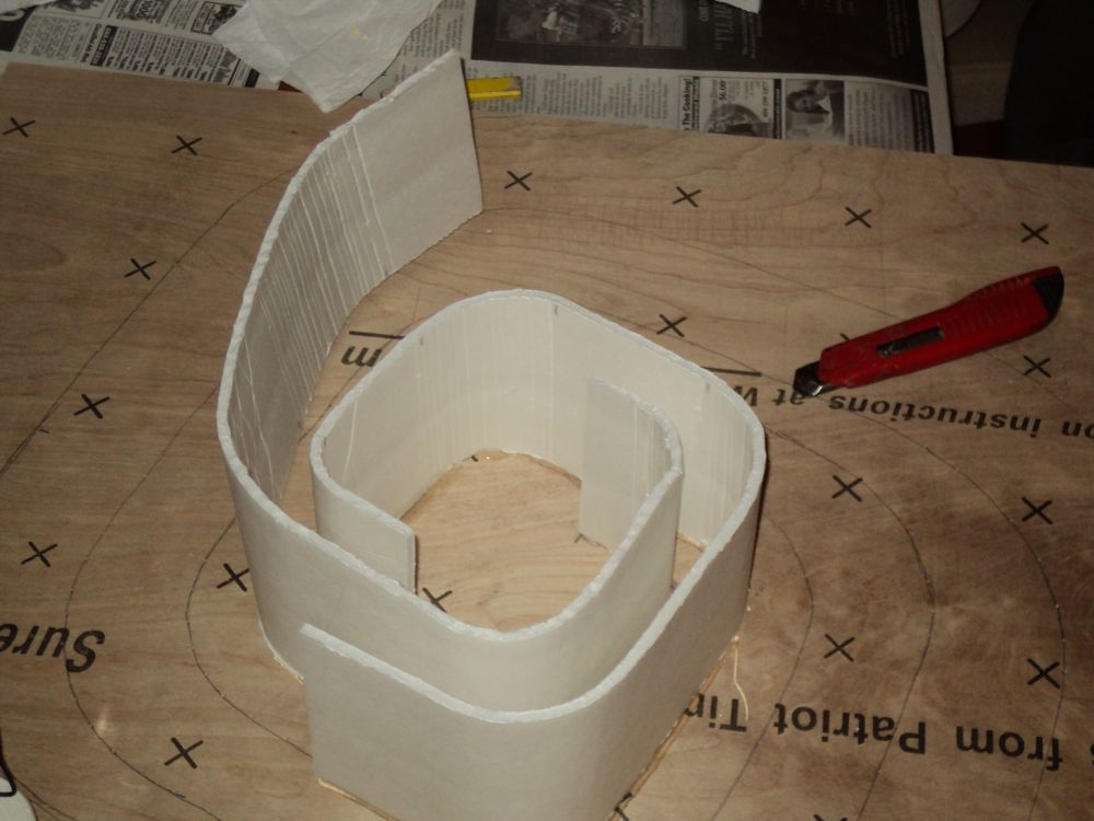

Speaker widow was in a good mood so I got a start. I found it easier to begin on the inside and spiral out, making sure I waited at each corner to catch up with the next piece so as to give my working room but I made sure I used a full piece at the mouth to cut down on visible seams.
Nice job! That was a good idea to start from inside, I started from outside to make sure the mouth had a 30 in long piece. Looks awesome! Congratulations on getting the channels completed.
I forgot to mention that I also double up on the glue by liberally applying white, or in your case, yellow glue on top of the hot melt just in case there are any cracks that need to be sealed, plus it ensures that if hot melt ever gives you have a backup bond. I assume you are waiting for cap to bond right now. You are right about getting the approval of the OWMBO prior to starting new campaigns.... 😱 This particular speaker has a very high WAF though.
Goodness no. WYSIWYG, I will try and do the other spiral today. We'll see about doing the caps. Yes, I used some hot glue where there are gaps but I'm not too worried, there is a similar SPL on either side of the channels inside the the horn isn't there?
It's not about SPL (as there is very little pressure build-up in horns in general since they are so open) but I worry about small air leaks which can cause the low frequencies to have a hard time in establishing a standing wave. If you have played a flute or any other woodwind instrument you know that a tiny leak on the finger seal above the low note you are trying to play causes the note to collapse. I am just being careful and using plain hot melt is fine as long as there are no obvious leaks.
I tried to be careful and added extra where I saw gaps as I went along so I'm hoping I have done it well enough.
