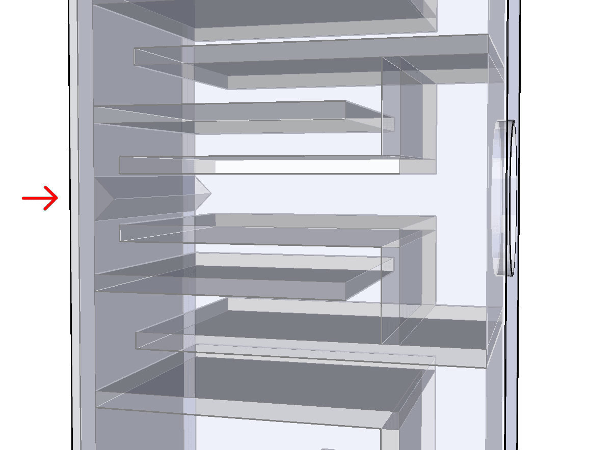

I'd like to bring the discussion back to the design of the cornucopya. On page 3 of the patent in paragraph 0021 it describes the cone (5) from Fig. 1 roughly as an outward deflector of the sound waves. Perhaps that's actually important. I wonder if we could add the cone to the simulation model?
I can say that all of Scott's double-mouth horns and BVRs have a similar bit in them at the bifurcation of the horn, see attachment.

In the spirit of this thread... If I take an arc shaped strip of foam core and score it radially outwards from the inner edge of the arc to the outer edge of the arc, the carefully bend it and close it on itself, then fasten it with hot melt... I might be able to build a cone. Hot melt that into place and check it out. Another idea is to use the plastic nose cone from a model airplane propeller. Any other ideas where to find an easy cone to try? My problem is that my Cornu is rather shallow and may not allow much room compared to the 4.5 to 5 in deep ones that seem to come with the full size ones.

Iko, are you well versed with Akabak? I believe the cone will improve efficiency, but I don't think it will have much of an effect on the horn resonances, peaks and dips, that Don Hills pointed out in his sims. Interesting to see how it works though. How do you plan to implement the cone in the script?
The horn of a rear-loaded horn speaker is mostly for bass reinforcement - you don't want HF coming out of the horn. The cone-shaped deflector will tend to make the HF problem worse by reflecting more HF into the horn mouths. It won't help the bass at all because the wavelengths are too long compared to the dimensions of the cone. Also, the cone will reduce the volume of the back chamber. This will have to be factored into the rear chamber dimensions.
No, I've never seen akabak before in my life. That's probably why the simulation results don't make sense to me. The script uses conical horn elements. I don't know if in akabak a cone is a real cone, meaning that it is a circle in cross section. The real horn of the cornu is not a real cone. It's a pyramid. I can't really comment until I learn akabak.
That cone at the back of the driver, if it's not there, you can obviously see that the sound waves hit the opposite wall and some will come straight back to the driver, no? To me it makes common sense to have that cone in there. Is my common sense so far off?
"Conical" in AkAbak means that the area increases as the square of the length. It doesn't matter if the cross-section shape is circular, elliptical, square, rectangular, octagonal etc, provided that the longest dimension across the cross-section is significantly less than 1/4 wavelength at the frequencies of interest.
Flat-walled horn with 4 straight walls, all diverging = conical profile.
Flat-walled horn with 4 straight walls, 2 diverging, 2 parallel = parabolic profile.
For horns with small rates of divergence (taper), such as the Cornu near its centre, the profiles are almost identical. They differ more at the mouth, where the divergence increases rapidly.
Actually, a true Cornu / Euler spiral curve horn built as a spiral between 2 parallel plates more closely follows a conical area rule than a parabolic area rule. If you imagine it "unrolled" into a straight horn, the walls are not straight - they curve away from each other.
Regarding the cone behind the driver, if common sense was (common), the world wouldn't be in the mess it is. 🙂 Look at it this way: Most of the HF reflection through the cone occurs from the driver frame/magnet and spider. A cone behind the driver would only be useful if there was nothing between the back of the driver's diaphragm and the cone. Because of the shadowing effect of the driver's rear parts, the cone would also have to be significantly larger diameter at its base than the driver in order to have any effect. Finally, if you did have a cone, the reflected energy would just bounce off the chamber walls, back off the cone and up through the driver. Replacing the cone with an equivalent volume of stuffing would be more effective.
All of this make sense. I am am glad someone in the know said it.
