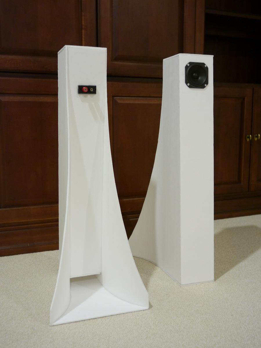

I would expect foamboard to excel in the karlson application as that front cavity looks like all kinds of trouble that poorly damped wood might exacerbate. Still, I am an old carpenter so be nice to someone who can't generate a lot of respect for hot "glue."
Is there anywhere a description of what would be the best practices to work with these foam core boards? Like how to cut, fold and glue them. I am new to the game and I haven’t read yet everything in this thread. I have bought thé recommended boards and glues and I want to start doing things!
Read the first 10 pages or so. Basics are to use a sharp utility blade razor or Xacto and metal sharp edge. Cut in multiple strokes to go deeper each time. Use hot melt glue to tack in spots if piece is too large and seal with hot melt like caulking making a nice fillet. To bend curves score partial cuts in the concave side and roll board on round object of similar radius to prebend. To glue the second side panel, use PVA as hot melt sets too quickly for you to apply a leak free joint more than 20 to 24 linear inches at a time. Use lots of bracing every 3 to 4 in of span to reduce drumhead vibration from panels.

FH3-inspired Foam Core Mini Build
Curved cabinets:
Viva la Vifa! Curvy Cabinet DCR with TC9FD
Tractrix horns:
Presenting the Trynergy - a full range tractrix synergy.

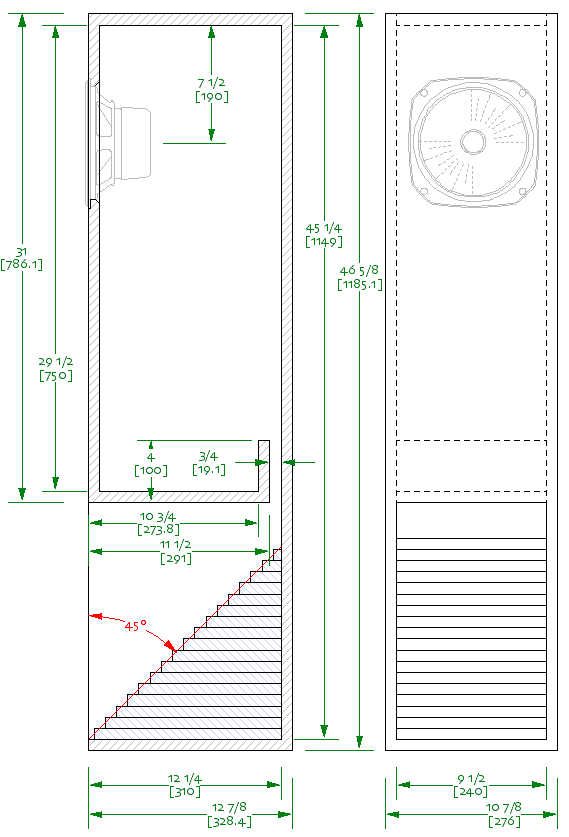

Hey X, do you think something like a scaled-down Chang could be done with foamcore? Using a pair of the "usual" ~3" class drivers that are popular in these foamcore shenanigans, such as the TC9FD, 3FE25, or a single PA130-8, or even those cheap MCM drivers from Newark/Element 14?
I've attached the plans for the half chang that is meant for the FE206E. There's also the smaller Suzy Chang that's meant for the 4" FE103 and I think 107?

This is a horn augmented reflex box and can't be scaled like BLH. It is easy enough to do a sim on Akabak though. What are you trying to achieve, what is max size of cabinet, are you looking for a cheap and fun experiment, or something more likely to sound great?
Certainly foam core or XPS can be used to make this.
For the driver list you gave, go with a 0.53x Karlsonator with PA130-8.
Or if you want fun with a horn, make an FHL-lite with TC9FD or 3FE25. Or go with my scaled version of FH3 (earlier in this thread).
https://www.diyaudio.com/forums/ful...pired-foam-core-mini-build-3.html#post3339779
Probably a fun project to see how I like the style, and then eventual build of larger version? Max size of cabinet depends on what is reasonable- I personally have no problem going from 36-48" tall if needed, but keeping it down to 30" makes it easier for others that like to stick to a single sheet of foamcore high.
