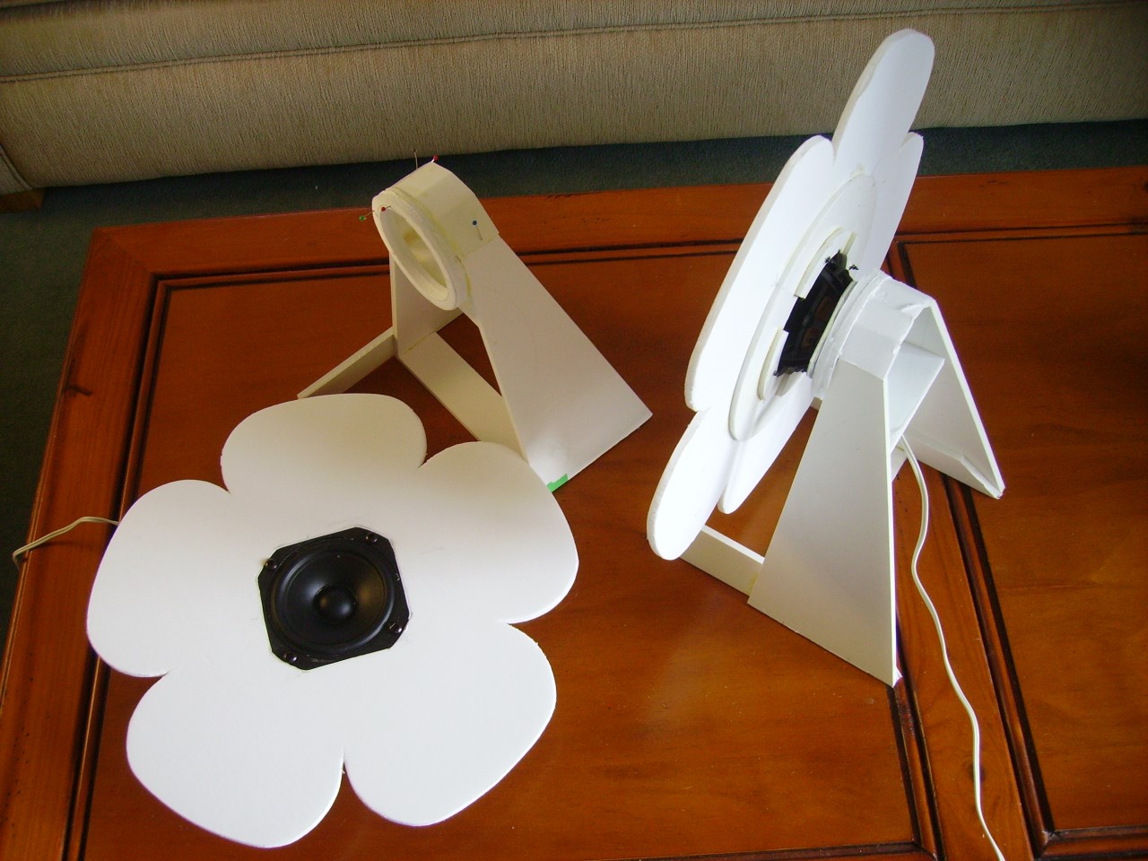

I screwed the driver to the foam and cardboard as a sandwich with the cardboard acting as the “nut” for the screws. The glue was to seal the edges so that they are air tight and don’t vibrate. Yes, to remove would require destroying at least the rear cardboard mounting ring, which is replaceable. The drivers are connected using soldered wires to removeable Arduino style PCB pins and header sockets. So speaker cable is detachable.

Hi Folks,
It’s been a long time since I made a foam core speaker. Had a few hours to make one today and they turned out rather nice sounding. Super easy. Following the idea by Mattes in Jeshi’s thread on EVA speakers. It’s a flower petal shaped open baffle. The flower shape reduces edge diffraction effects. It’s about a 12in diameter 5 petal flower with a support base. Using the FR58EX drivers which have an excellent flat response. Paired with a TPA3116 2.1 amp driving my own XKi sub fitted with dual 5.25in Tang Band sub drivers.
The spatial imaging is great and vocals are nice and clear. There is good top end reach on these too like an aluminum dome tweeter.
Almost any 2.5in to 3.5in full range driver can work here. TC9FD, PS95-8, 3FF25, etc.

Finally Got show 'n tell pix.
Cobbling together stands was far more complex/time consuming than making the Daisies.
Stands are a tight friction fit onto the Driver's magnets, intent being to have them removable and ultimately adjustable.
Sound is amazingly good... using 10$ drivers no less.
