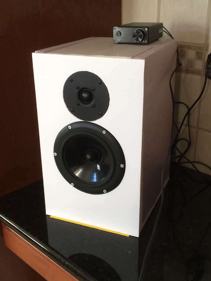

Here is my first pre-designed kit speaker build. It is the X-LS by GR Research. I got it mainly because it is a fantastic deal in drivers and hardware. All high quality stuff (Peerless coated paper cone woofer, all air core inductors, poly film caps, thick PCB for XO, all wires, screws, port tube, terminal cup) for only $110. Anyhow, it went together easily as I had an old foam core enclosure that needed to be cut down to size. The ideal size is 8.5in wide baffle for best XO efficacy but I was lazy as this was lying around.
X-LS Classic kit
I am using it as a kitchen speaker with an SMSL 36A amp and my phone as the source.

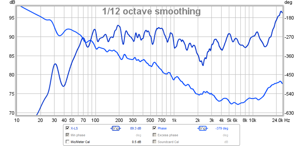

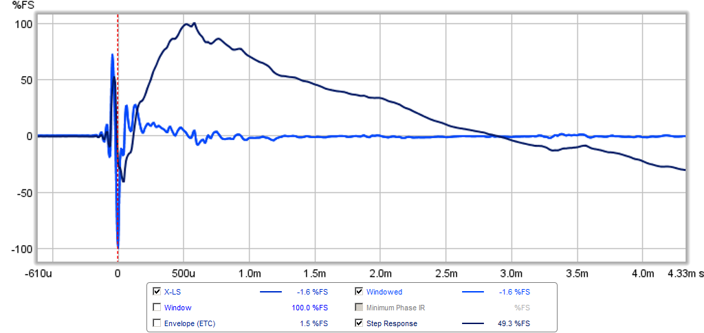

Here are some measurements on a stand at 0.5m:
I think my foam box needs more bracing as the back wall and top are single layer foam core. The baffle is 3 layers with CLD on the last outer layer.

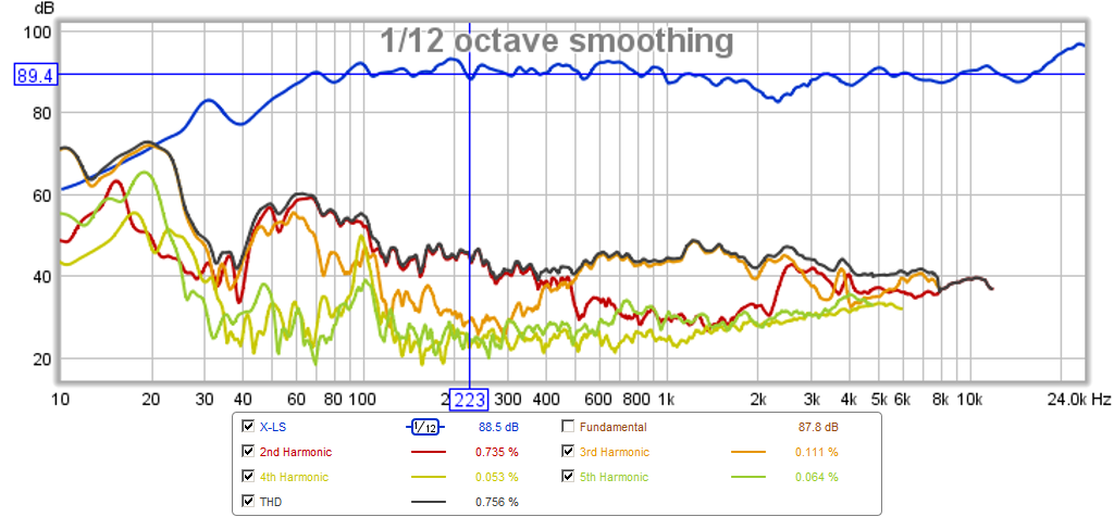

Here are some sound clips in stereo of the TL at my computer desk as monitors. The bass is quite profound - flat to 30Hz. It can handle electronic dance tracks without a hiccup.
http://www.diyaudio.com/forums/multi-way/281778-low-cost-pmc-inspired-tl-monitor-dc130a-dc28f-8.html#post4540130
Here is one driver (with stereo, an average 91dB level is easy with distortion below 2% in the bass region and under 1% everywhere else)

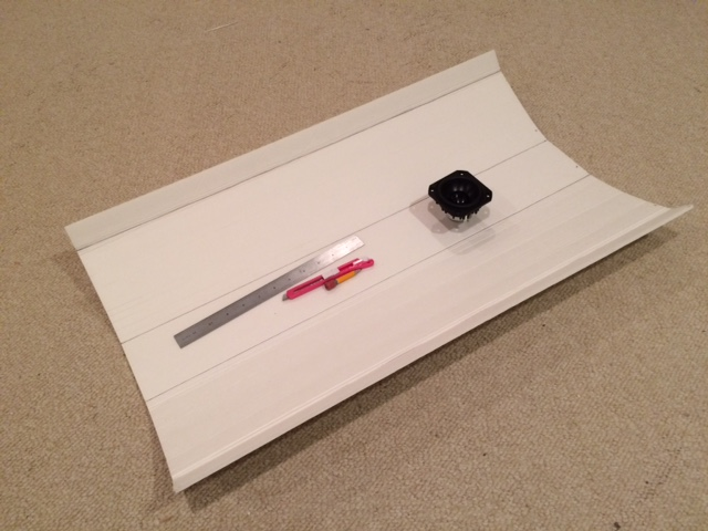

Very interesting, thanks for sharing with us. A question : is the foam core flexible, you see where I want to arrive : is It possible to prototype multi-cell horns for compression drivers ? If yes, what building advises would you give ?

Great question. I have been wanting to build myself a multi cell horn too. The material is stiff but vibrates easily so needs bracing. The nature of multi cell has inherent bracing so that is good. I would build each cell individually then glue them together with latex caulking to provide CLD damping. Alternatively, build it layer by layer with flat sheets where you glue little sections of dividers for each row. The layers can even be curved along the off axis layers. This method is faster and has thinner cell walls but may have more induced vibration distortion. It may be quick to prototype this way for quick and dirty test. Then make individual cell with CLD for more permanent version.
Let me know how it goes.
Good luck.

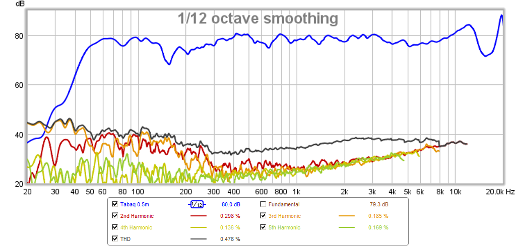

Copy of Curvy wall Tabaq with P830986
This was a fun and easy build using score and fold technique. The Tabaq with a BSC sounds balanced and has surprising bass extension for 3 in driver.
http://www.diyaudio.com/forums/full-range/88787-tabaq-tl-tang-band-119.html#post4556798
