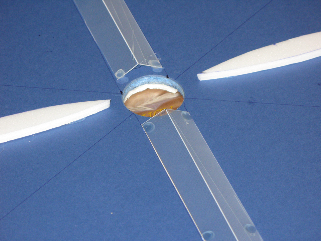

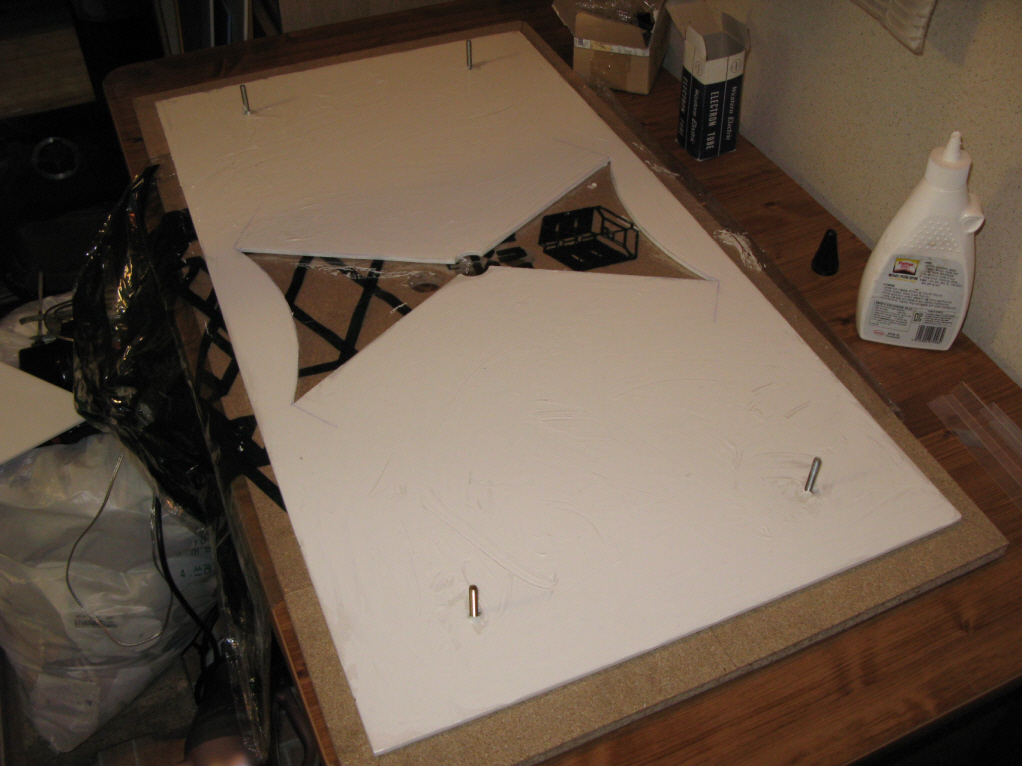

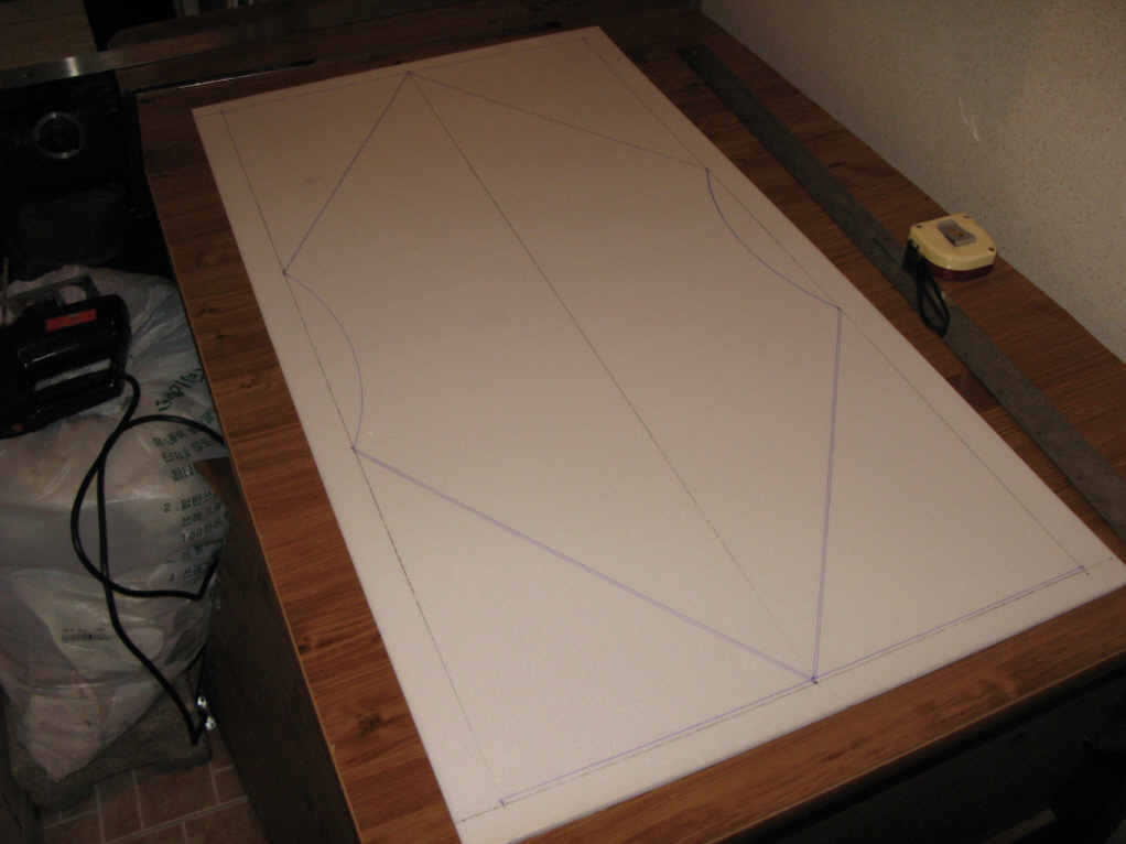

Hi guys,
I was just wondering, would it be possible to make a flattened version of the WE horn with... FC?
I've made couple of Paralines(kenpeter version) out of FC, but also a just a simple flat horn that is folded half in the middle just to keep it short(not really a calculated one - just eyeballed it...).
And it turned out better than I expected, so I'm thinking of making a bigger one... 😀
What will happen if the WE horn's expansion grows on one plane only? Will it screw up the sound? (probably, but... hey, it's fun!
Will this simple method of flattening the horn and just retaining the horizontal flare and folding it with slots no bigger than the width of the material used(derived from paraline patent) work with most horns?
What will the pros and cons be when using this method?
Would it have limited vertical vs wide horizontal dispersion like the paraline?
(or, in this case if the horn is laying flat horizontally, the opposite?) 😕

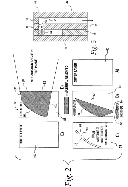

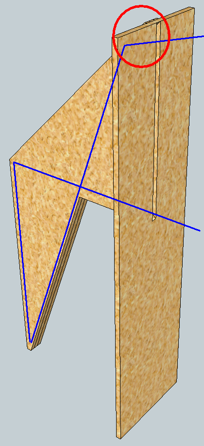

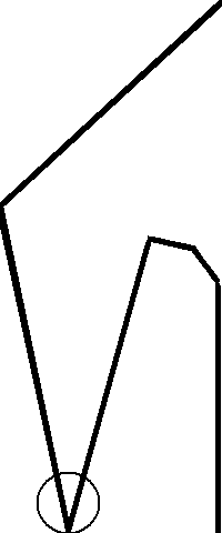

Attached are pics of Kenpeter's sketches of flat folded horn from another thread, and one from the Paraline patent which shows folding a horn in the middle.(I can't get the last pic to turn! LOL)
It would work as a flat channel but you are losing about 1000% of the possible amplitude gain given the difference in the ratio of mouth CSA of the full 3d horn vs the flat land 2d horn. The dispersion perpendicular to the expansion would be like a line source omni paraline though.
My one experiment with paraline resulted in a very ragged response which confirmed the ragged response of the simulation in Akabak. So I think care has to be used to make everything smooth with no diffraction or reflection edges to the extent possible. Also, why limit your self to thickness of FC board? It's easy enough to make it say, 5in wide - in either case bracing pieces will be needed throughout to prevent the two panels from breathing mode vibrations.
You can curl it to keep it compact and you end up with something like a 1 channel Cornu.

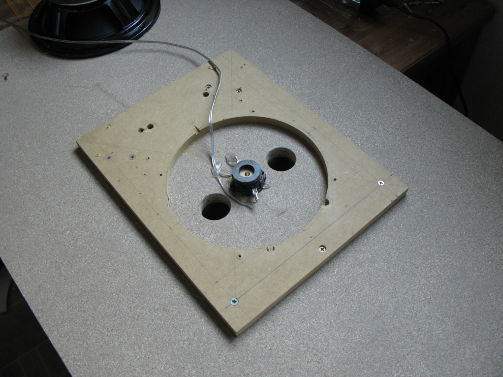

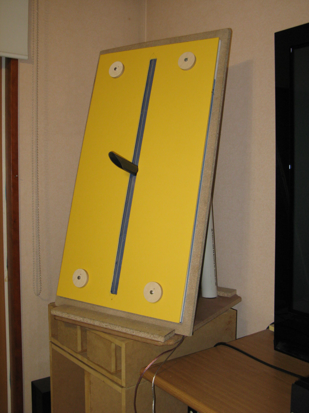

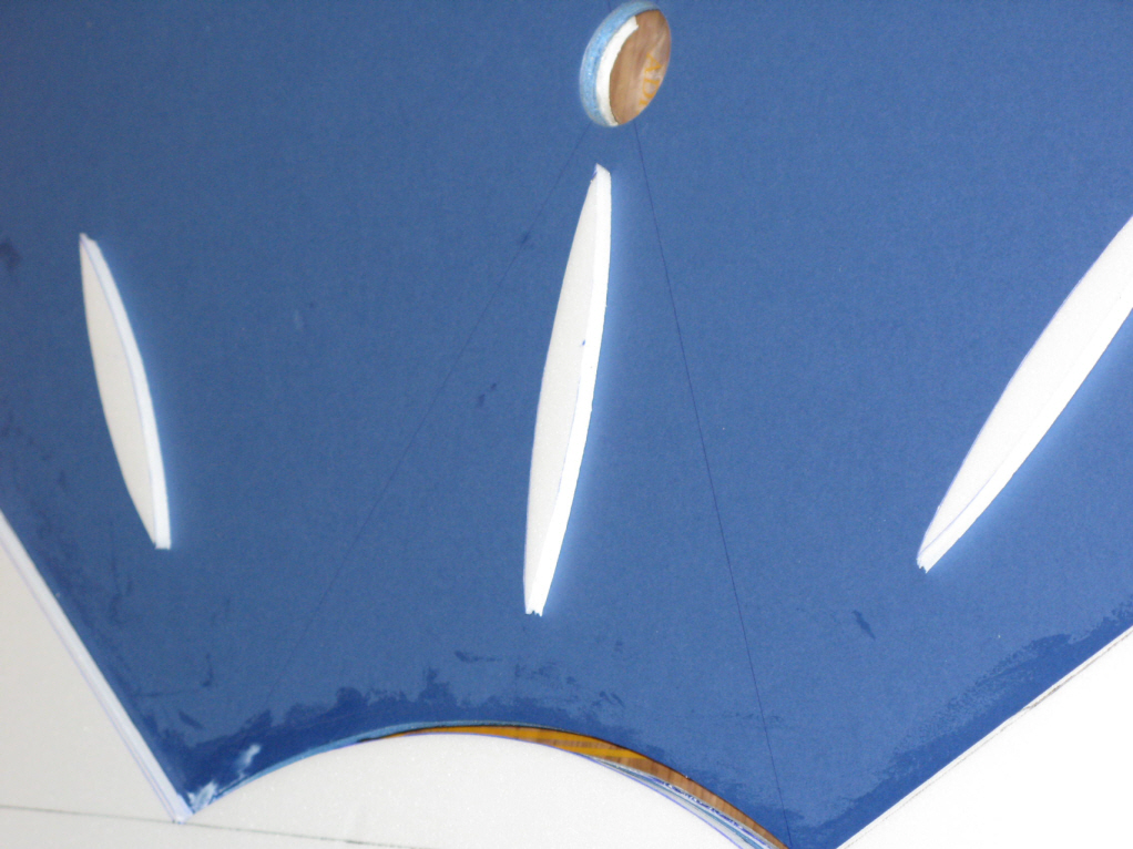

As for the ragged response in the Paraline - what do you think if one were to make the Paraline for just utilizing it as a midrange horn? (Would the ragged response matter that much in a say, 250-1000 range?)
I've made a 19x35 inch paraline with FC few months ago, but couldn't get the sound right.
Later I found out that having the port holes too small(don't know the exact formulas for those either😕) makes the sound somewhat 'shrill(?)'. And when I opened them up, I actually enjoyed the sound more.
On the other hand, when opened up too much, it becomes 'muddy' or 'laid back'. (when it comes to describing qualities of sound, it gets baffling, so please pardon my mistakes...)
Aren't the holes for the port supposed to be quite small? But every time I made them small, the midranges sounded 'harsh'...
I must be doing something wrong... (Unsuitable drivers and whatnot... 😀)

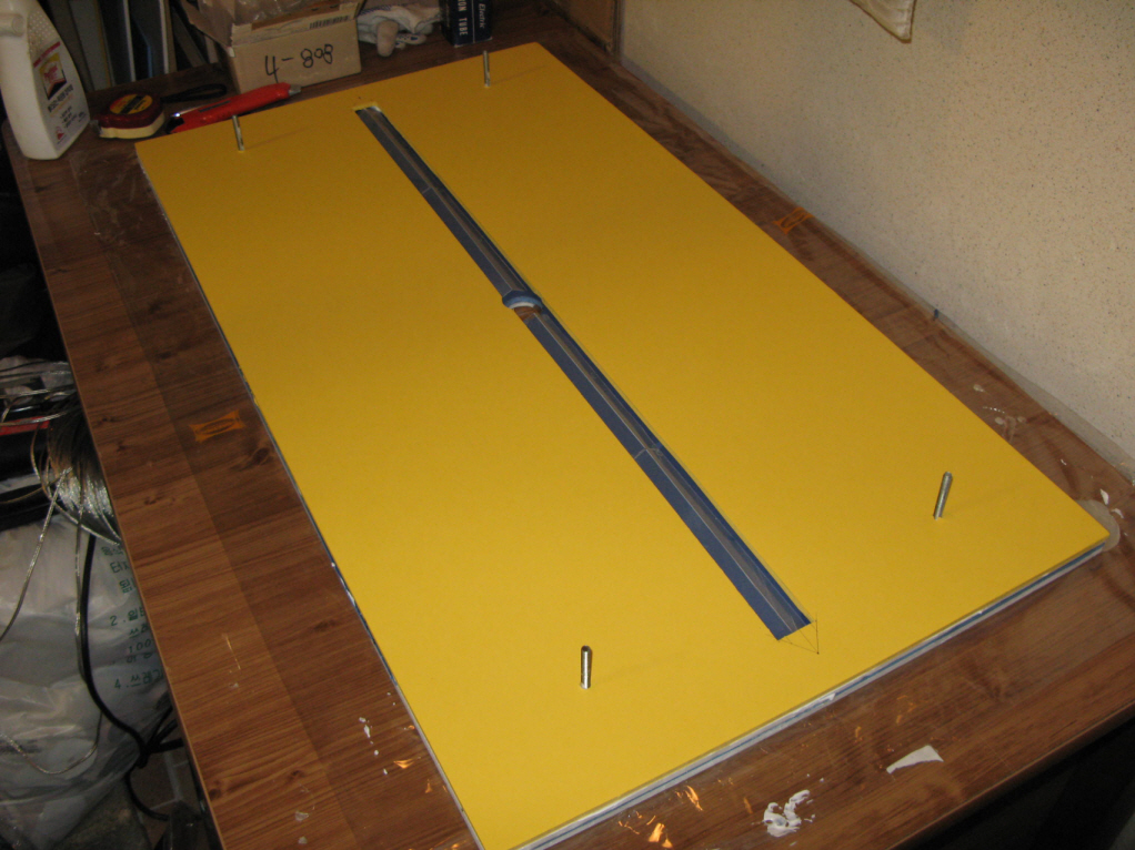

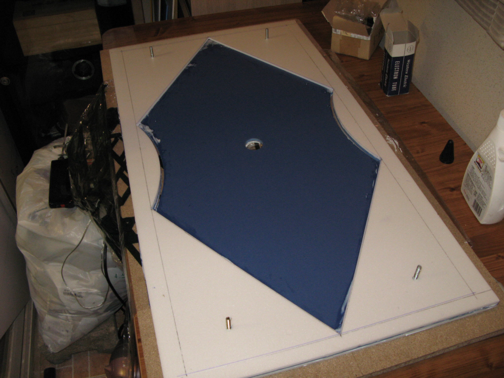

Anyway, attached are pics of my second attempt at building Paralines.
(These are kenpeter's version...)

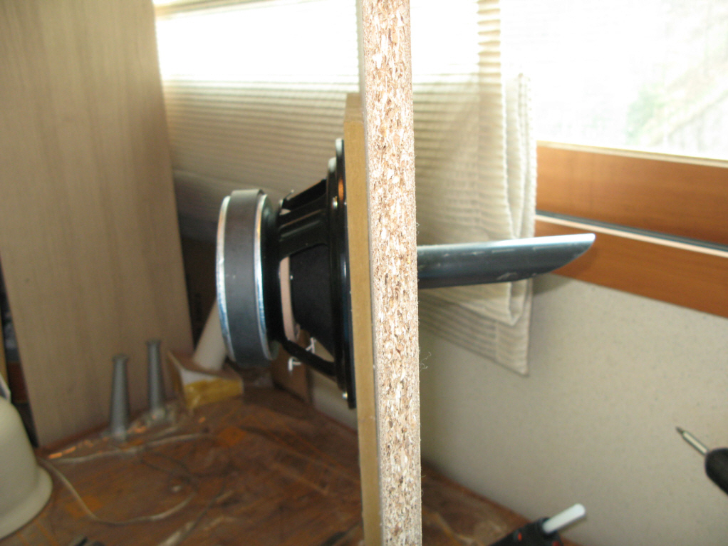

Here is final assembly of second unit.
Here is the pair (note flush mounted drivers to minimize diffraction - critical step):
