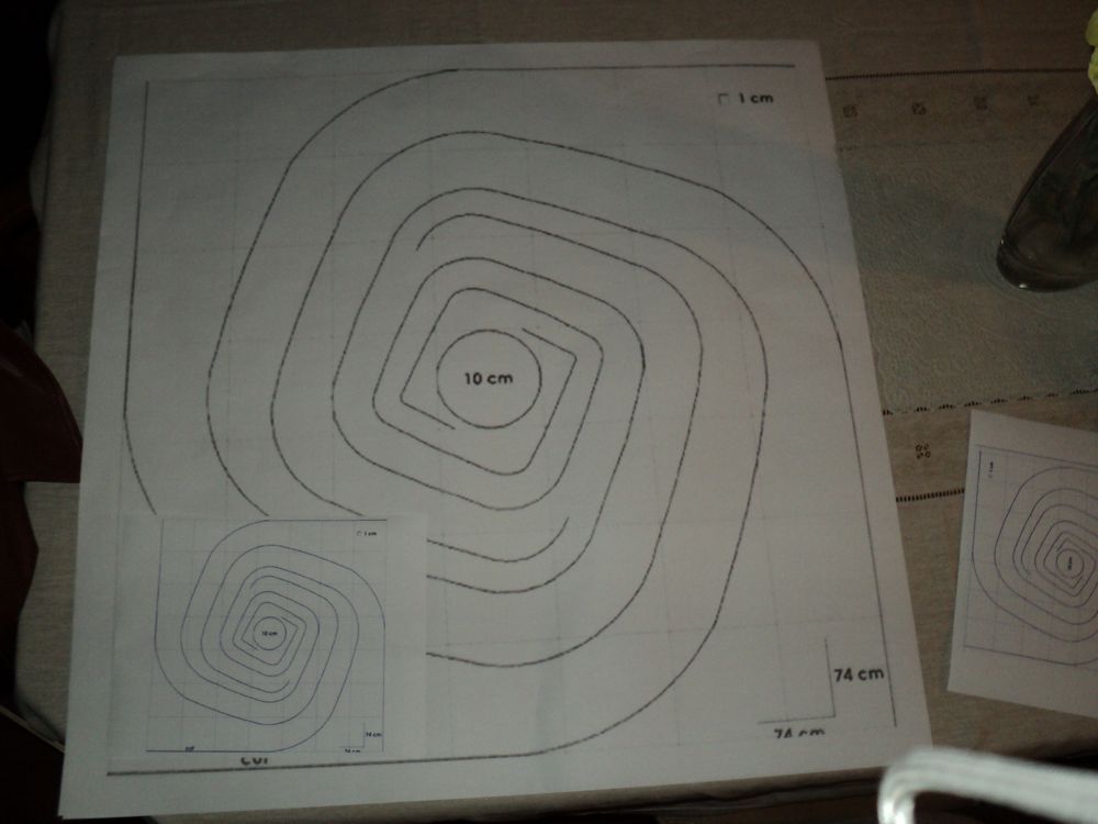

A scalable trace of the spiral
I found going to the repro guys was a real time saver. Full size made it easier. They had it ready in 15 minutes and charged me $6.05 for 2 copies. I didn't ask for change from my 10. 😉

Visaton B200?
BBIIIIGGGG!!
dave
Wow, they would be beeeeggggg! Simple math/scaling says that the original design is for a 4 inch driver, the Visaton B200 being 8 inch, everything doubles. So the dimensions of the box are 150 cm square and about 10 in thick. You would need a double sided Cornu for 8 horns per driver. The sound with 96 dB of sensitivity would just be mind boggling if you think how big the mouth area is. The effective piston area of this driver is 214 cm square cm, the expansion ratio is about 24x this means the total mouth area is about 800 square inches! Oh, and I forgot to mention that bass freq would reach sub-audible to about 18 Hz. This would be something to see and feel.😱

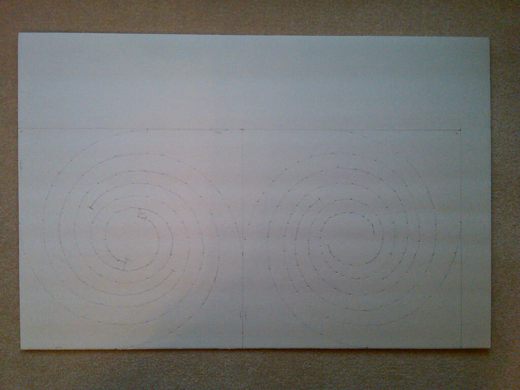

I am starting on the Son of Cornu (14 in square desktop horn for 2 in pc speakers). I just laid out design on foam core. I am making all walls curved to extract as much sound from these tiny drivers. The channel depth will be 2.0 inches.

Do you have any recommendations for a good 2 inch full range driver? I am trying this next to make the desktop Son of Cornu. It's really an experiment to see what the limits of the size/scaling is. I am not expecting it to work well but I may be pleasantly surprised. The earlier poster may go the other way and make the 8 inch monster Mother of Cornu with the Visaton B200.
Argh! Could be a problem to "hide" the monsters in the living room. I don't mean to bug you guys with noob questions. Can you point me to a simulator or formulas that would help me test ideas? For instance, given that I wouldn't care for such low(18Hz) bass, what if I use the B200 with smaller/shorter spirals?
BTW, found an easy way to draw perfect spirals of any size.
To calculate the lowest fundamental 1/4 wave freq, divide speed of sound (about 342 m/s) by 4 x the path length of the longest channel in meters. For example, for a 1.5 m path, 342/6=57Hz. Use current design but modify by putting bigger central box for speaker chamber, this will only add 4 in to your overall dimensions, but the depth still has to be like 9 or 10 inches to let the driver have enough room to breathe.
