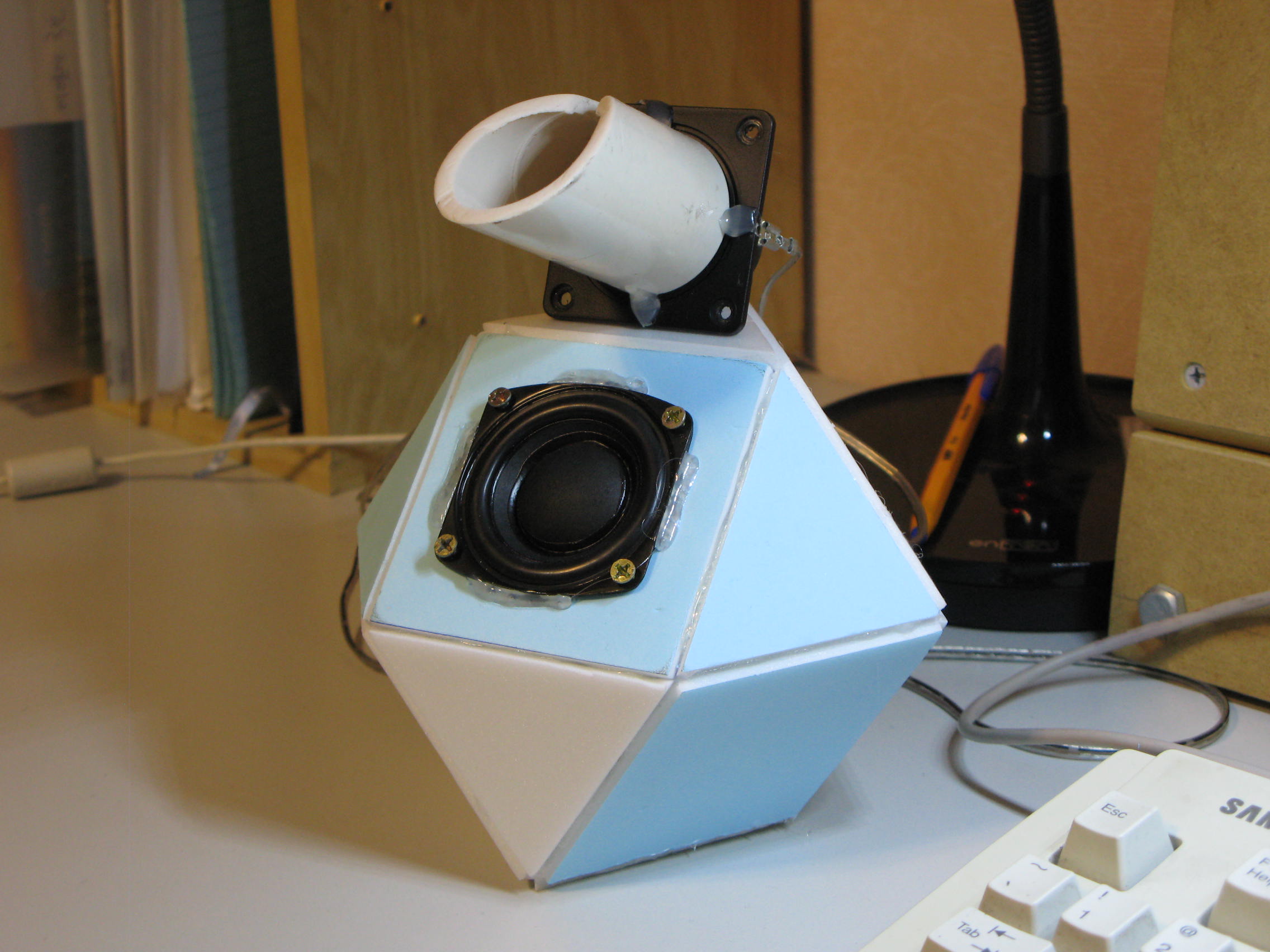

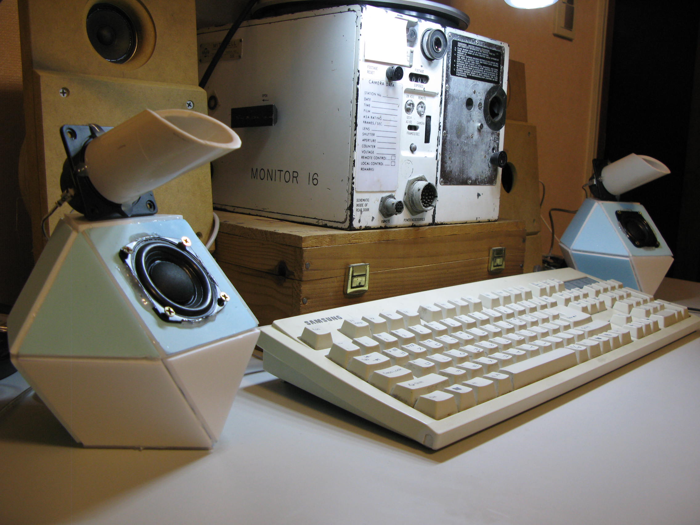

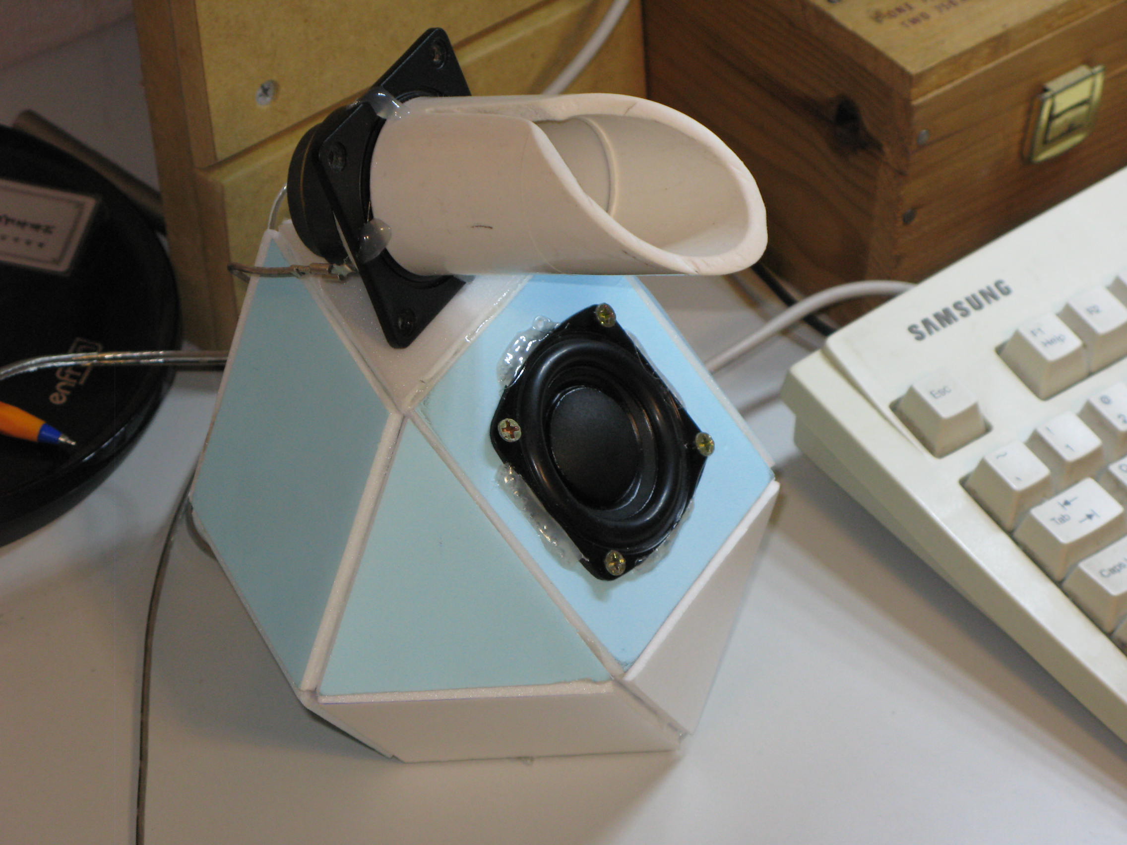

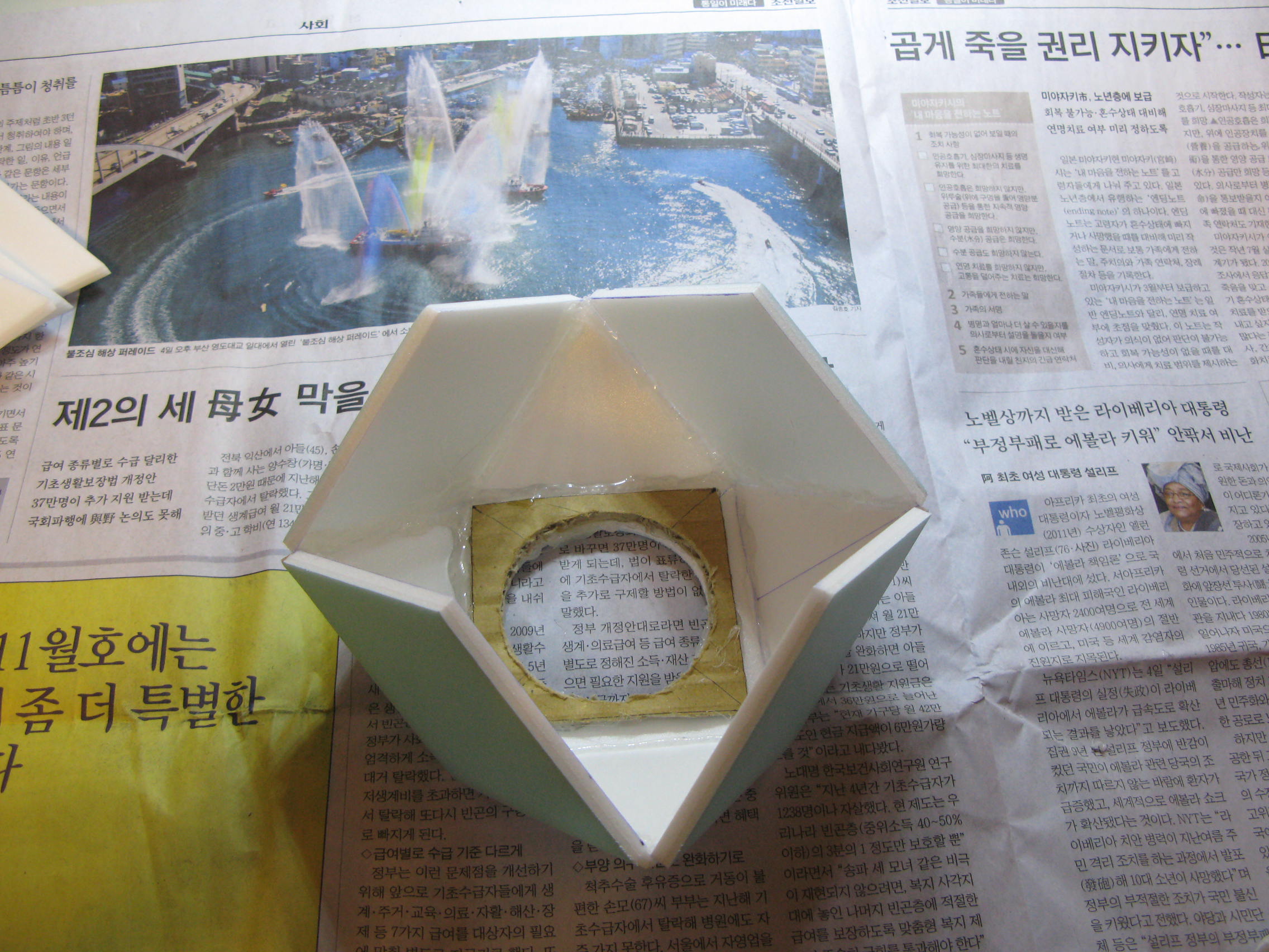

Hypercube speakers made with foamboard.
Karlson tubes glued to couple of tweeters sitting on top.
Sounds great considering the cheap 3" FR drivers used.
(costs about 3-4 bucks each? 😀)
Anyway, thanks to all those at the hypercube thread for the information, inspiration and guidance!
Great work bolexsbm ! Neat to try a Karlson tube (what are you using for XO?) but a 3in full range probably doesn't need it. What are you using for the tweeter?

Outstanding work, bolexsbm. (I'm going to have to learn more about Karlson tubes.) I'm always to see someone willing to try the Hypercube design.

The drivers are actually no-name 2-inchers, not 3 inch ones(my mistake).
So the tweeter with Karlson tube helps a lot.
(Not the Hypercube's fault, I might add)
The tweeter is a Korean brand driver. A cheap one.
When I found out that the K-tube really sounds great, I started using the tube in almost every project. But I guess that's for another thread.
(It sounds almost as good as the QSC waveguide Patrick Bateman raves about- he says that the QSC measures best in the group of Econowave waveguides, and the K-tube comes very close - A close second?)
The XO is just a resistor and a capacitor that was from another project,
but it seems to work, so I'm just using it for the time being. 😎

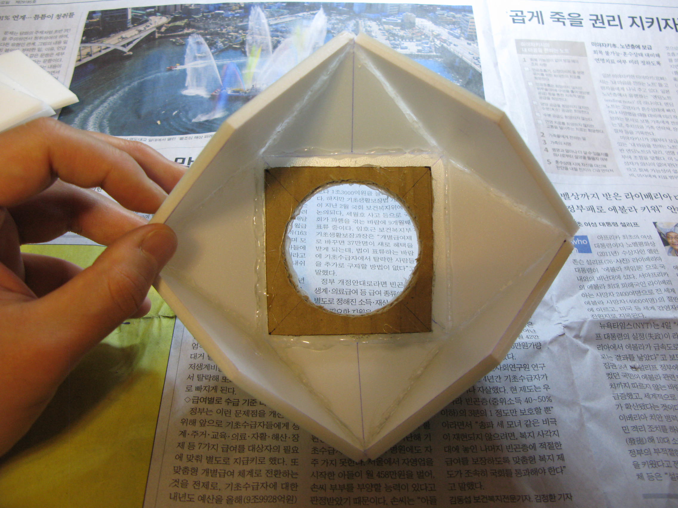

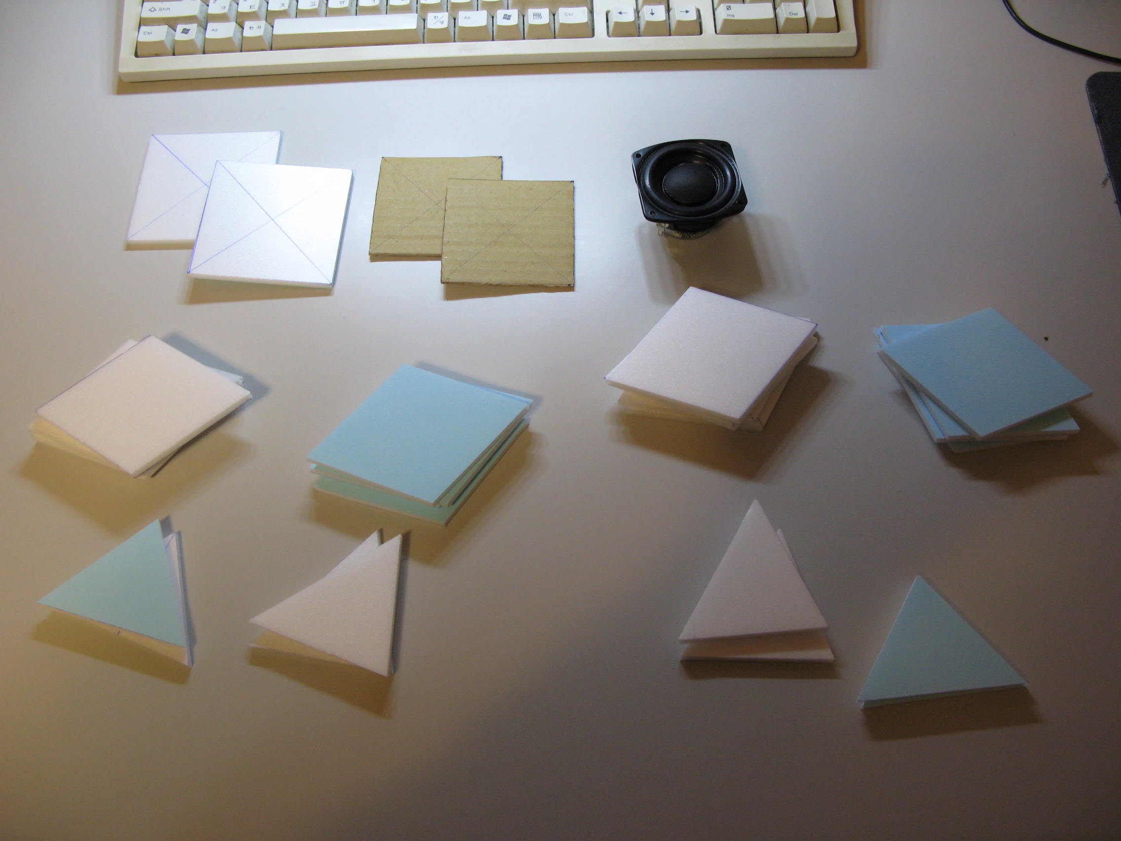

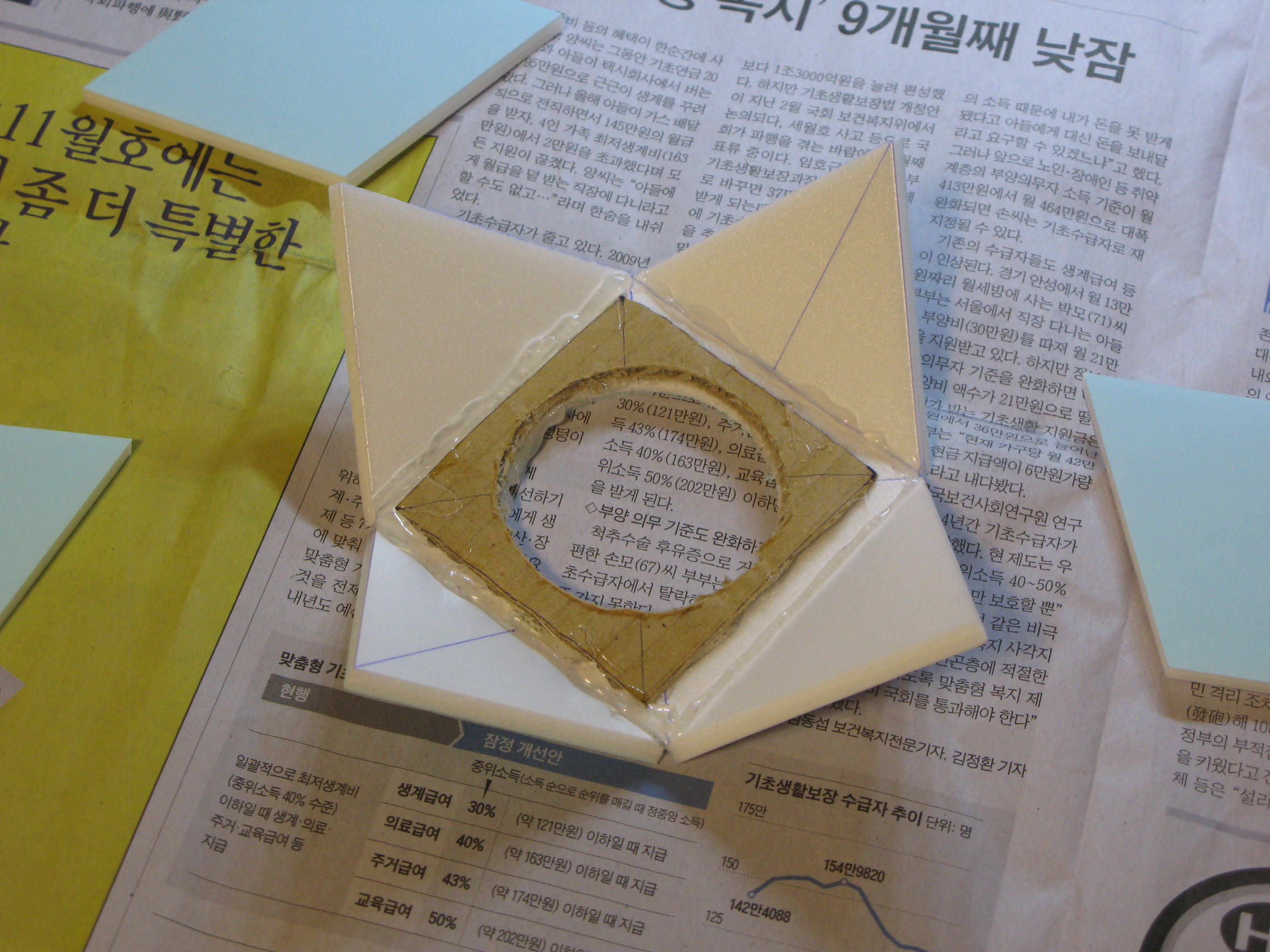

Tesserax,
Thank you for the great design!
Building the Hypercube was a fun and fast project with outstanding results.
I don't understand all the technical discussions you guys are engaging at the other thread, but having made a pair, I feel that the Hypercube concept is very cool, and I'm looking forward to build some more in the near future. 😀
(I hope with better drivers and wood this time - and I'd also love to try 2-way, like xrk's version)
The speaker sounds very natural, and non fatiguing even after long periods of playback. Great for nearfield listening.
Thank you again for sharing your knowledge and design! 🙂
