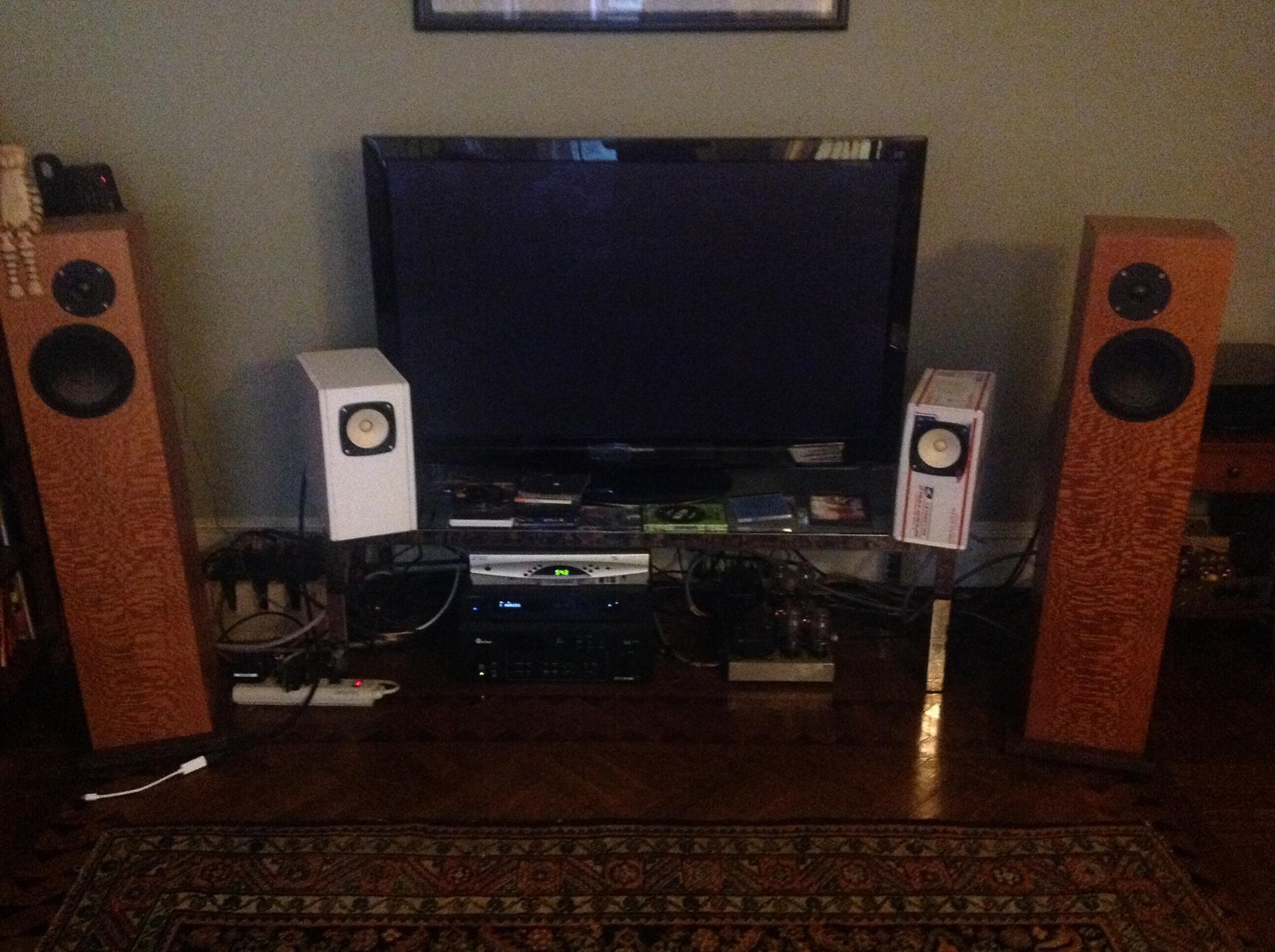

I just finished a small 12" square sided folded horn for FE126e drivers in foamcore. I kept hearing that you need a big horn for these, but I'm getting plenty of bass in a pretty small size. I only have one, the other is cardboard but the same design (a USPS box 12x12x5.5), so now I have to make another foamcore box.
Of course, the first thing I played was "Stairway to Heaven" just to prove they can rock. I've switched to jazz vocals on Pandora now. I wouldn't want to overwork them.
I'm sure if I really knew what I was doing this would never work. 😉

I've checked my sub more than once already since I plugged this in. I can't believe the bass I'm getting.
Other pertinent info: 6B4G amp in push-pull, Aikido pre, Oppo 93 player, Rega Planar 3 TT. It just all goes together I guess.

Any photos showing the horn path? Cool that you are getting bass from the 126e's. They don't have much cone movement.
I was surprised to see that cone moving the way it did. Only the one in the foamcore moved, the other didn't. I'll get a few pics up later when I try them with my small class-D amp on a board. Ultimately, they'll be for my daughter's dorm room with one of those amps and a cord to plug in an iPhone/Computer. That's if I let her take them...
They are internally 12x12x6, with a diagonal running from the top/back to somewhere below center/center, with a vertical board running from the diagonal bottom straight up. The internal board was just another 13" board that I cut, so total length is that split between the two pieces. The driver is mounted 3.5" down from the external top, so 3" internally. The back is completely open. I have wires with clips just running through the back opening, no posts. I may or may not add them, but given there is no back I don't have the usual place to put them.
The boards were 13x13 for the sides, 6x13 for the front, and 6x12.5 for the top and bottom, and another 6x13 for the internal baffle, split as I said above. I used 1/2" foamcore. It doesn't get much easier than this.
I will have to wait for pics, you lost me with the written description. Not sure which plane the diagonal is on? Where the driver is mounted? I guess the driver is on a 6in wide edge.
