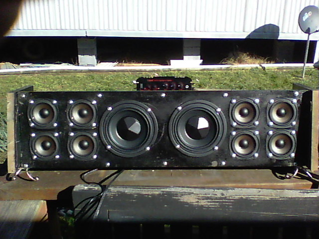

Those Vifas are getting pretty popular. My build has 8 of them and two Vifa mini-subs. xrk971, how about posting some stuff on Parts Express's forum? Might get some good feedback there.
You made a sub woofer with the Vifa TC9FD?!! Please share photos. 🙂

Aye, laddie, that they are, and a good eye on ye to be sure. The two in parallel come to 8 ohms, matching the 68W sub channel of the Lepai 2.1 amp on top. They do a creditable job despite the less than optimal enclosure (I was going for compact, not efficiency). It all currently resides in the middle seat of my minivan, fed by an MP3 player, as the selection of radio material here in central Appalachia leaves something to be desired. Twas supposed to serve as a portable guitar amp combo originally, but the Tang Band full rangers were still sounding pretty at warp factor 5 when I wanted them to distort. I gave 'em all we got Coptin, and I donna think they can handle much more, and *still* sounding pretty. Seriously, they're some fine woofer/subs. A bit heavy for foam board constructions maybe.

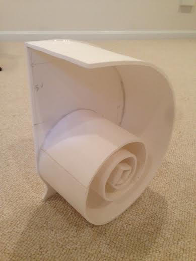

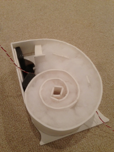

I always wanted to see what a sealed spiral TL sounds like - the famous B&W Nautilus being the inspiration. Supposedly it has very clean dynamics because there is very little back wave reflection to the cone. Anyhow, I thought I would give it a try with the trusty Vifa TC9FD. I think sealed TL's follow lambda/2 for setting the length. The total path is about 3 ft. I have no idea how it will sound and actually did not bother to model it - I just hand drew the spiral on a piece of foam and hot melted away 🙂
Here is what I have so far, now waiting for the PVA glue to dry on the capping operation.

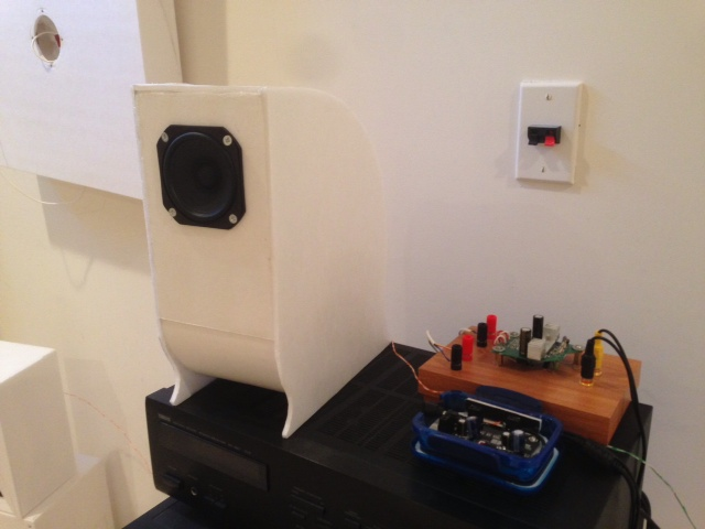

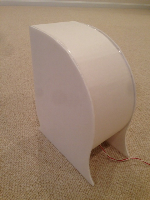

This things sounds great! I am surprised how much bass actually comes out of the direct radiator cone. The mids and highs are exceptionally clear - the transparency and detail are quite astonishing with the few test tracks I have listened to. I like how it sounds and I think when in stereo the sound stage will be very nice.
It is 12 in tall x 5 in wide x 9 in deep. Here it is sitting on top of the old Yamaha RX360 amp with a TPA3116D2 and a TPA3110D2 (in blue snap top lid box). Second photo is the back side so you can see the nice curves that the foam core can make.
Pretty neat! Do you have a mic for some quick measurements? I'd like to see a near-cone plot for that one. How does it compare to the small Karlsonator?

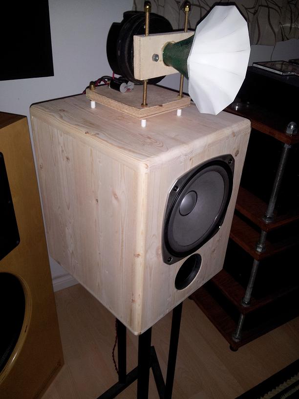

Yeah I do, tried it much yet? I've made a Tractrix of my own as well a while ago. Paper petal variety:

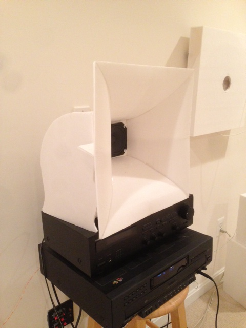

Cochlear w/ Tractrix
BP1Fan,
If you think that looks good, check out what it looks like with a front tractrix horn - now were cooking with fire! The sound is very wide dispersion and makes the driver appear substantially louder - although I detect some horn coloration as this was not at all optimized.
BP1Fan,

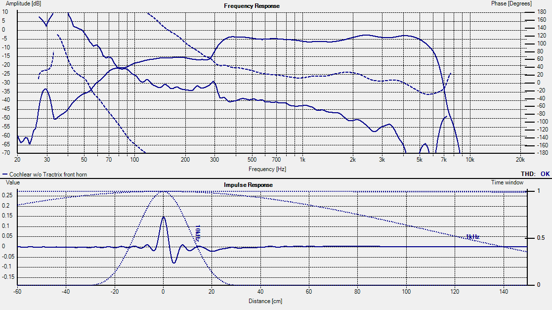

Cochlear sealed TL- near cone measurements
IG,
I have some near cone measurements (1 in from cone). My setup uses a Panasonic WM61A capsule and the built-in mic input on the laptop which was designed for video conferencing etc so I think it has a low pass filter at around 5kHz. I am pretty sure the speaker has plenty above this sharp falloff. What I can measure though is very flat - as expected from a cochlear spiral with stuffing. There appears to be NO reflections whatsoever and the response is amazingly flat. The bump at 30 Hz is the hum from the HVAC. The drop near 330 Hz probably corresponds to the closed-ended TL length of 36 inches (1-Lambda of 312 Hz)? Look at how clean the impulse response is, and the low THD of less than -40dB, and the nice -20 to 20 deg linear variation in phase.
IG,
