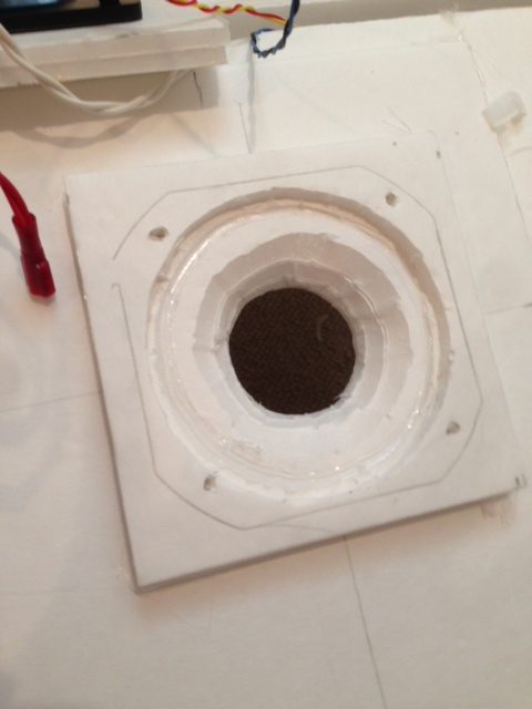

Thanks. I put a resistor in series with the tweet and it tamed it down. A lot better now. The 4 Vifa's will give 91 dB or so and the tweeter is 95 dB so probably needed to be padded. If you want the dimensions download Bwaslo's spreadsheet v5 and input 90 deg x 90 deg for horn angle. Put 4 in for the distance of driver port location to get the dimensions for the HornResp calcs or AkAbak calcs. If using a 1 inch CD then dimensions as is work. If using a horn like PH44 then truncate the throat section until it matches. DIY Synergy/Unity spreadsheet there is a lot of good info on the Unity threads in the Multiway forum.
I added a 25 ohm resistor in series with the 2.88 uF cap to attenuate the tweeter a bit. I removed some materials in the driver chamber to make a frustrum on the ports - this seemed to make it sound a little more open. Some Robert Cray sounds really nice - has a "live" feeling to it. Maybe that is because a lot of PA rigs use horns?
Here is a detail of the frustrum.

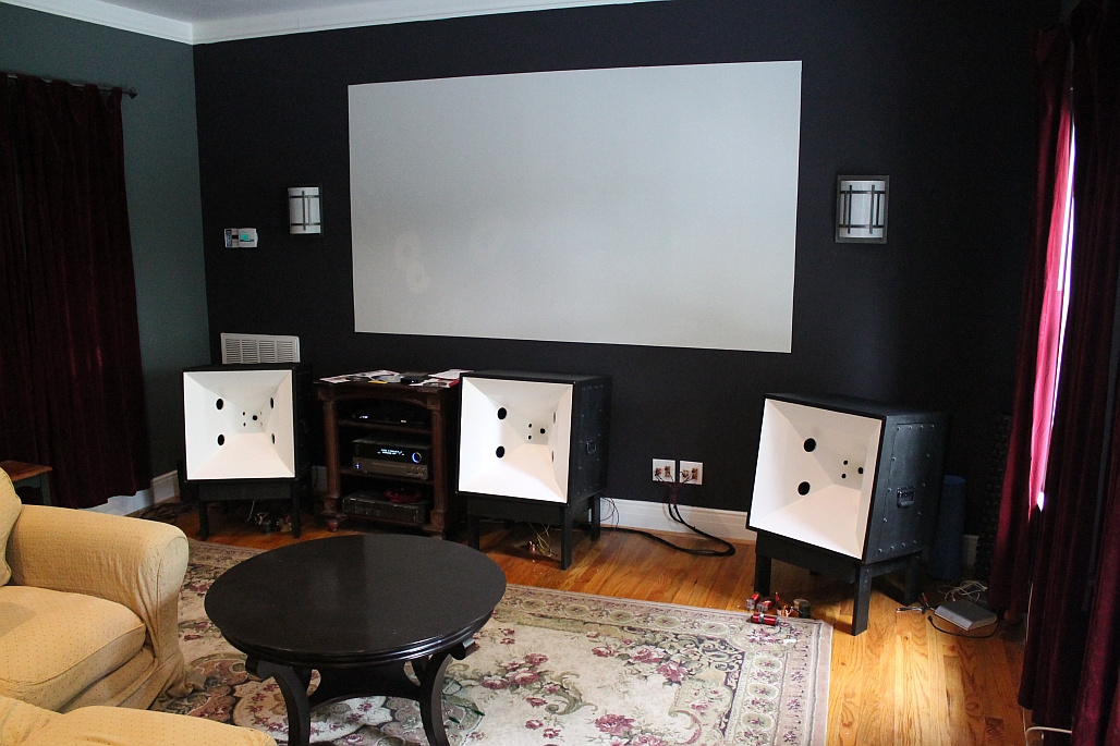

Impressive speakers! I like how the wall terminals are on display too!
