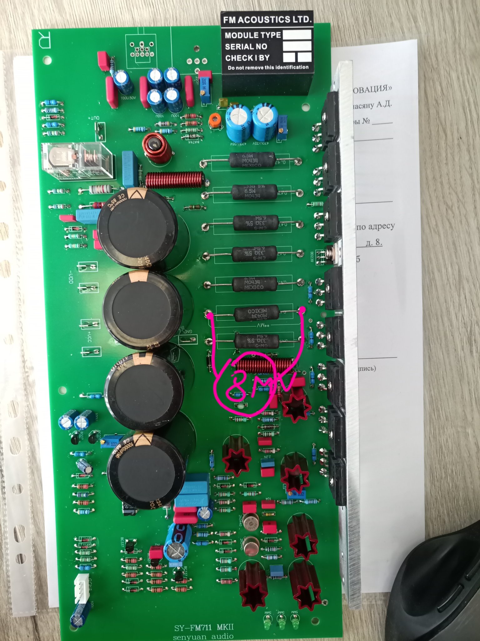

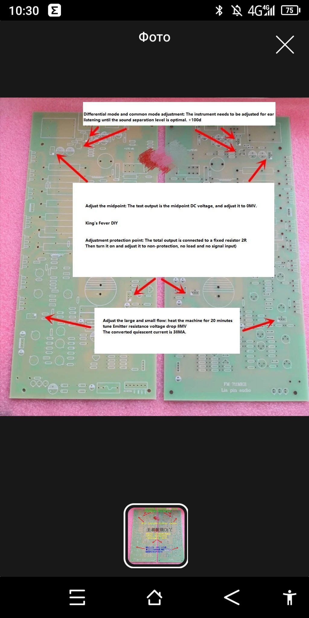

the input is short (potentiometer to zero), the output is connected to a load or speakersWhat are the testing conditions? At idle or playing a test tone? With or without speaker load?
I just tested. The right channel (that was fitted to the amp) was running at 9.7mv. The left channel (that was sent as a replacement) was running at 32.5mv. Both have now been adjusted to 8.3mv.the input is short (potentiometer to zero), the output is connected to a load or speakers
Try at 13 mV, at first I also listened at 8 mV, but it seems to me that 13 mV is much better, I now have 18 mV
Do you know where the midpoint voltage measurement points are located?Try at 13 mV, at first I also listened at 8 mV, but it seems to me that 13 mV is much better, I now have 18 mV

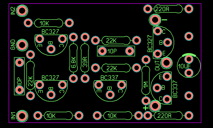

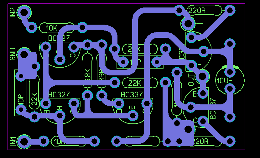

Does anyone have the schematic of the FM Acoustics 19202 modules or can show me some photos of the inside? Thank you
Moduli FM Acoustics 19202, qualcuno ha lo schema?
English please. We keep telling you.
FM Acoustics 19202 modules, does anyone have the schematic?
sorry, this doesn't seem like the diagram of the FM 19202 module above, can you send it to me, or do you know where to find them cracked? Thank you
