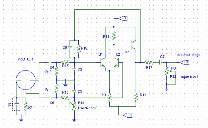

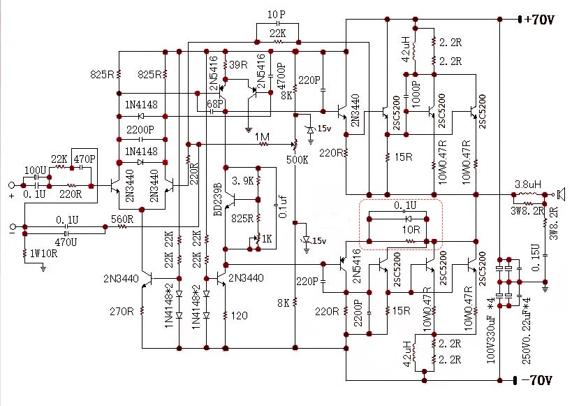

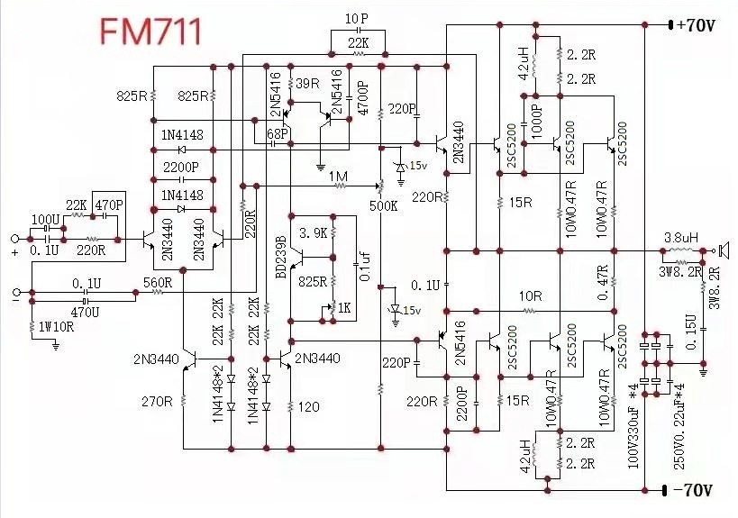

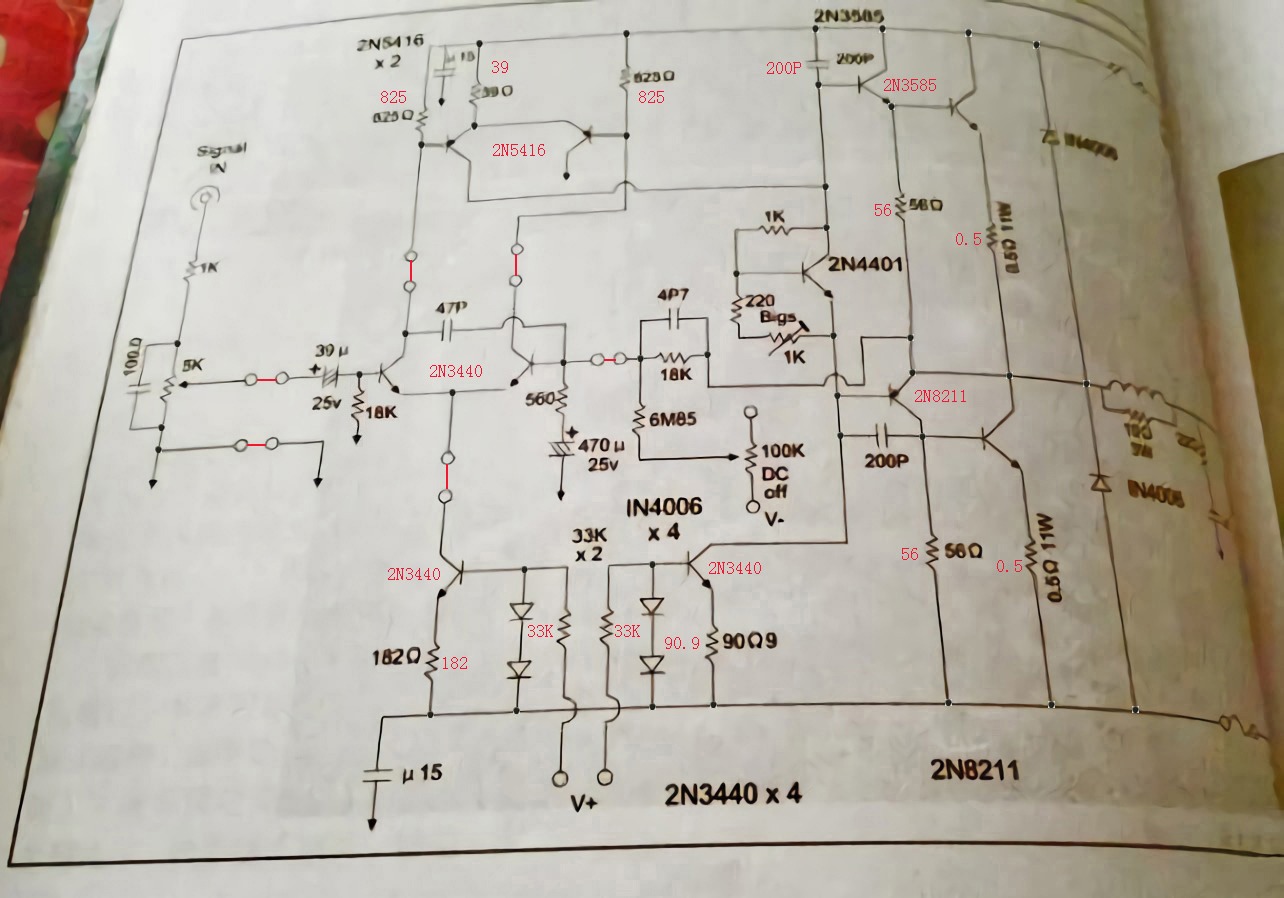

Thank you so much!!!! Now I'll compare to the schematic I drew years ago. Mine is an earlier version with the black input modules.

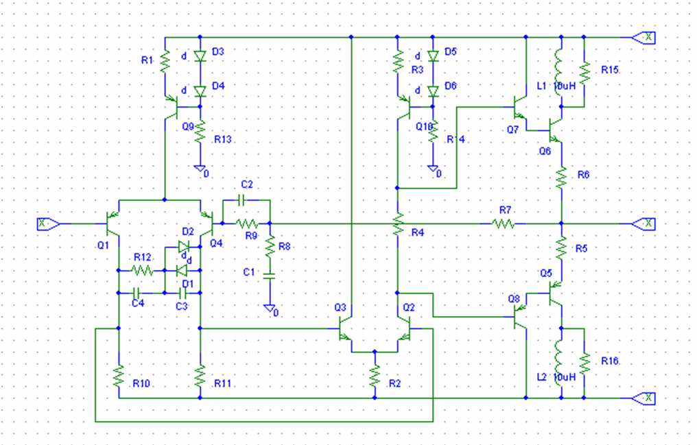

thanks for sharing the images and schematics.
i always wondered what general topology they used.
i have to admit i was a little surprised by the use of a quasi-sym OPS in this day and age ...
I was wrong about that feedback, I did not notice it was drawn alt the way up.
Anyway, interesting output. If the boards would be available, i would try it.
Some noticed an important side of FM Acoustics sound is about their main transformer and huge smoothing cap....
Fm acoustics is very ingenious circuit. Many diagram were wrong in some forum. If one could not understand its knowhow,it would be a very crappy push-pull amplifier. It needs to adjust correctly.
There are two "black boxs" in every Fm acoustics power ampifier yet, they are made of five transistors. Of course, Fm acoustics are very clear amp ,if it were made correctly.
Please explain the ingenious part cause it looks rather pedestrian to me.

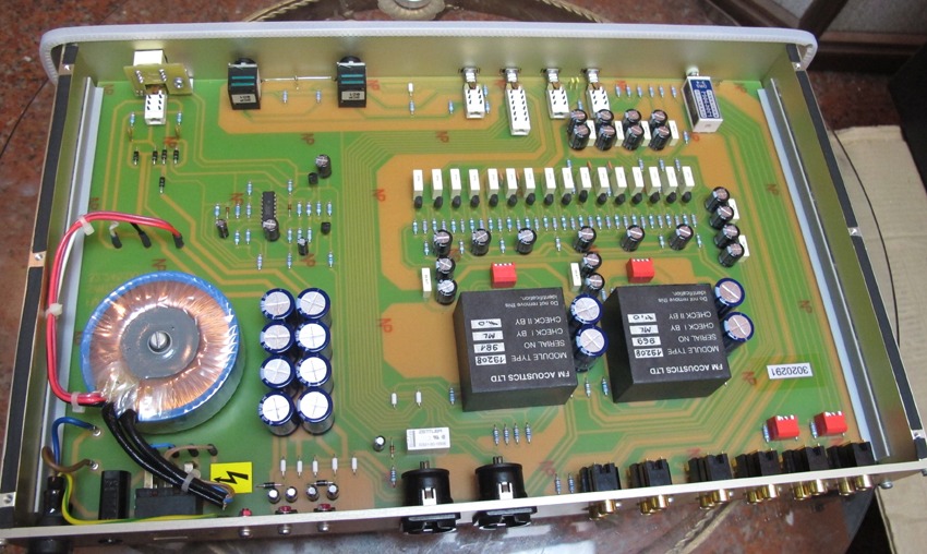

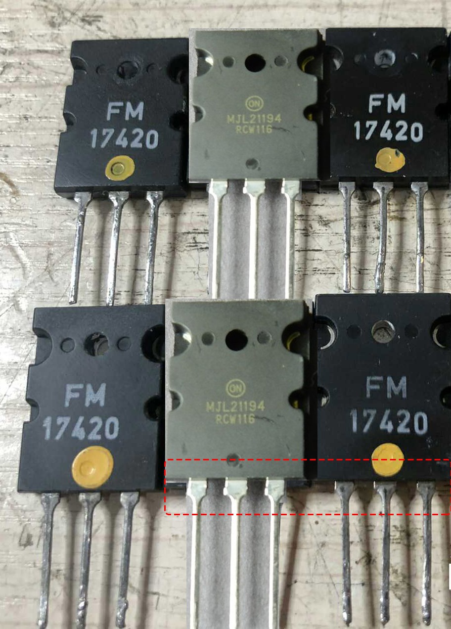

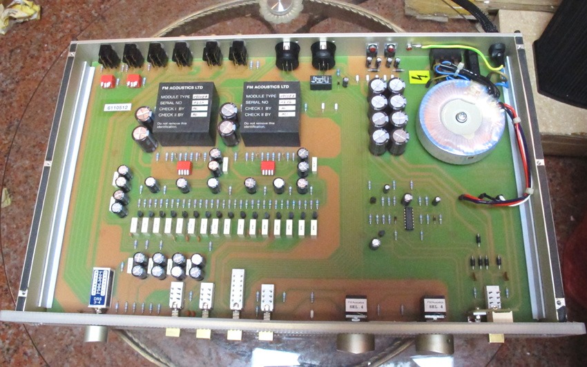

According some guys FM Acoustics provide outstanding sonic quality with their power- and pre-amplifier models.
Unfortunately, no meaningful test reports can be found anywhere (e. g. stereophile).

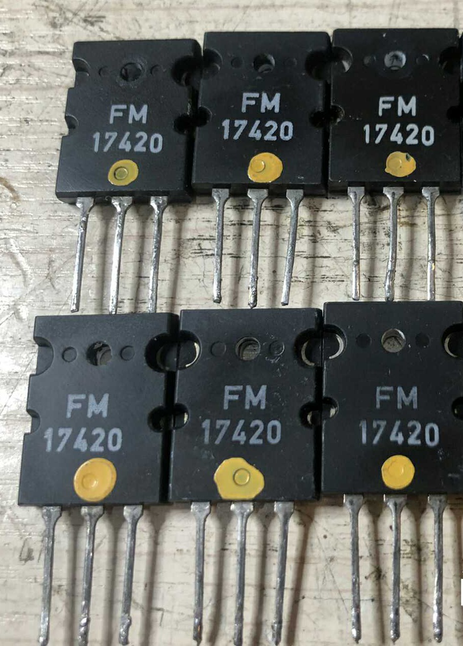

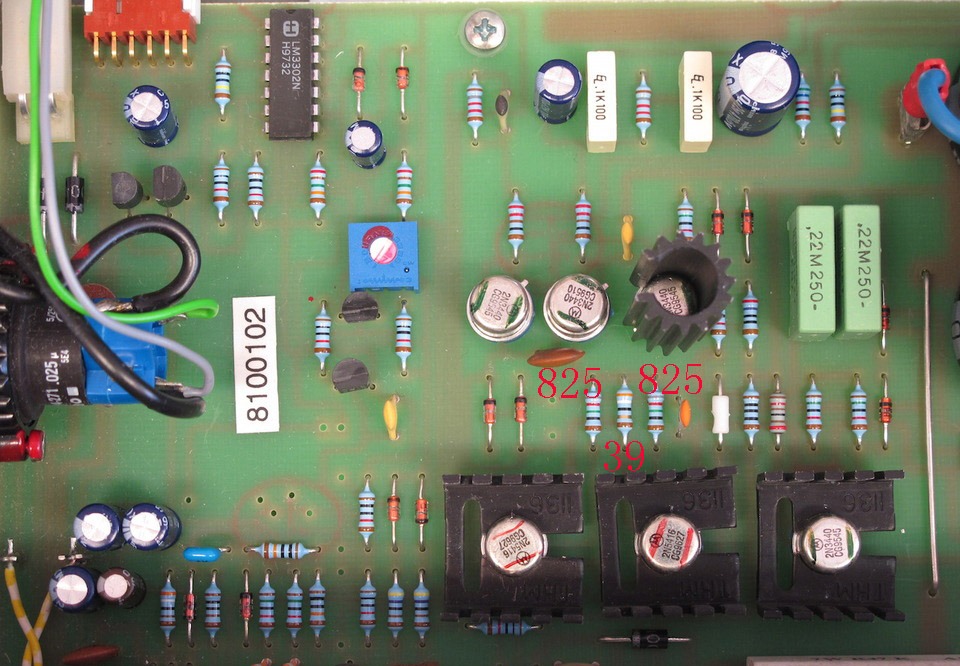

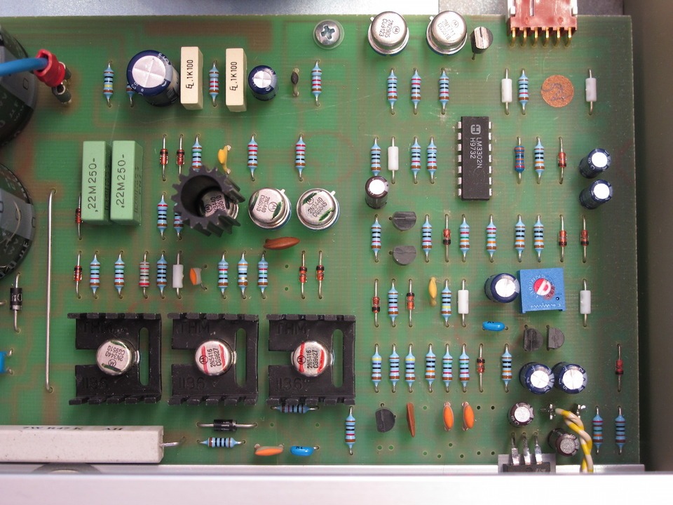

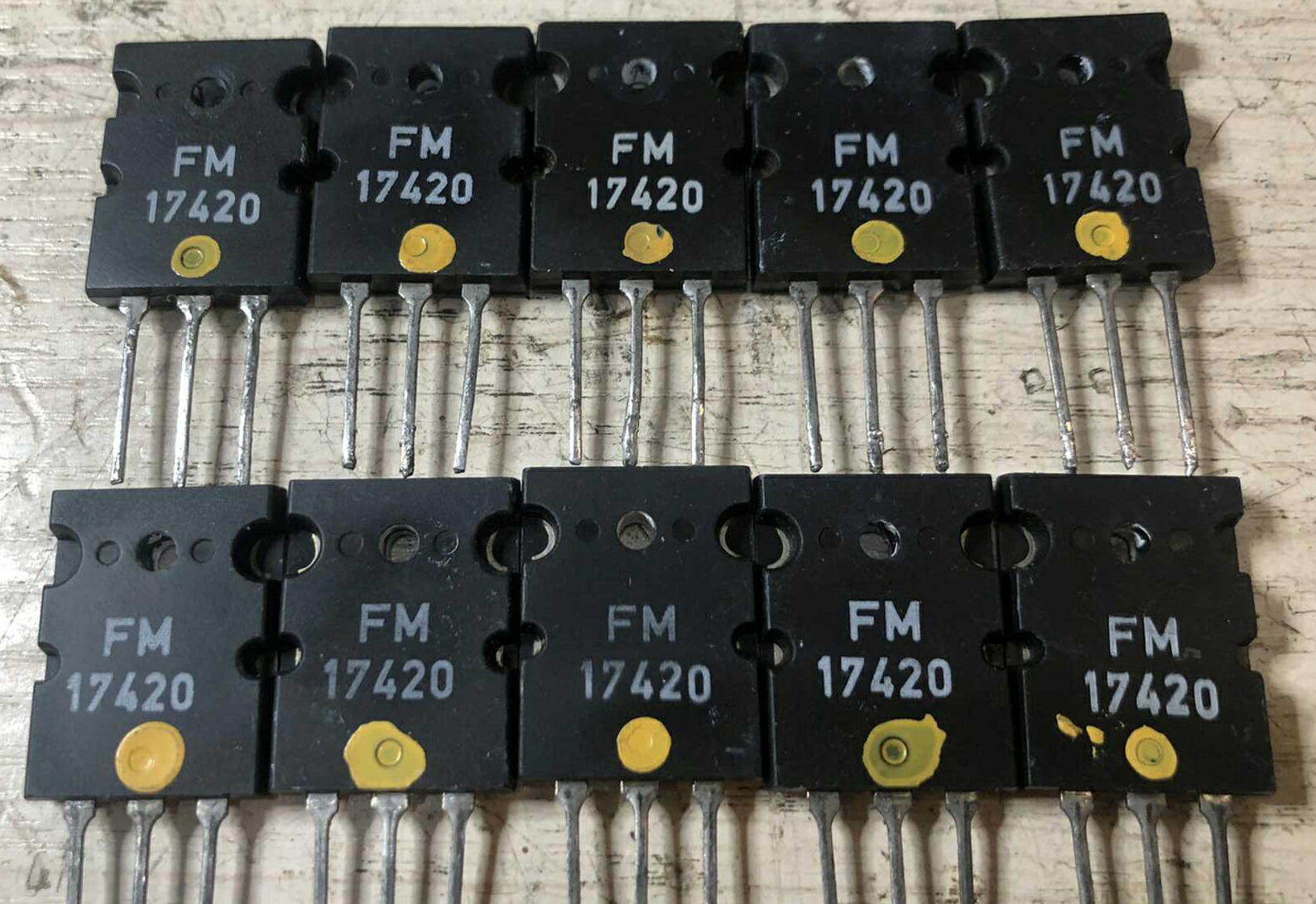

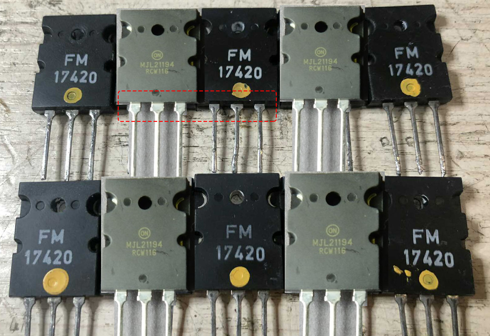

Several internal parts are special made for FM acoustics (e. g. potted modules and TO-3/TO247 power output devices), additional no service manuals and circuit diagrams are published - that means a repair service is only possible at FM acoustics itself.
check out the internals of this pre-amplifier under
https://audiodripper.jp/used-audio/prepower-amplifier/fm-acoustics-fm245-used-preamp
in the attachments.
Furthermore there are only cheap standard parts in use - particularly concerning electrolytics, volume control and selector parts (push button switches, relay).
Last image from post #4 show burned power amp front end PCB (FM-1000). This limits reliability and life expectancy.

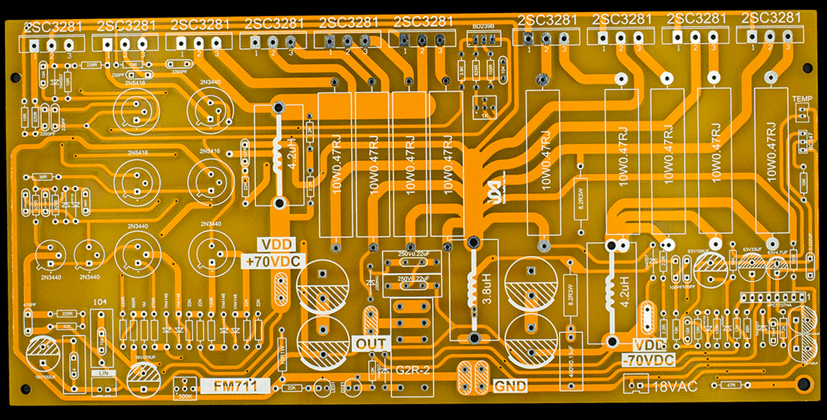

My friend got an unit from aliexpress, and he said it "sounds very similar" to the original unit.. maybe he really heard one somewhere, idk...
I have listened to it once and here's some of my honest opinion to it:
High : Soft high, not glare like some of the amplifiers
Mid: a bit on the recessed side, I am expecting a bit more body from il dilvo voices...
Low: You are not getting a solid punch bass like other high damping factors amp, But overall bass present in a very soft and relax manner.

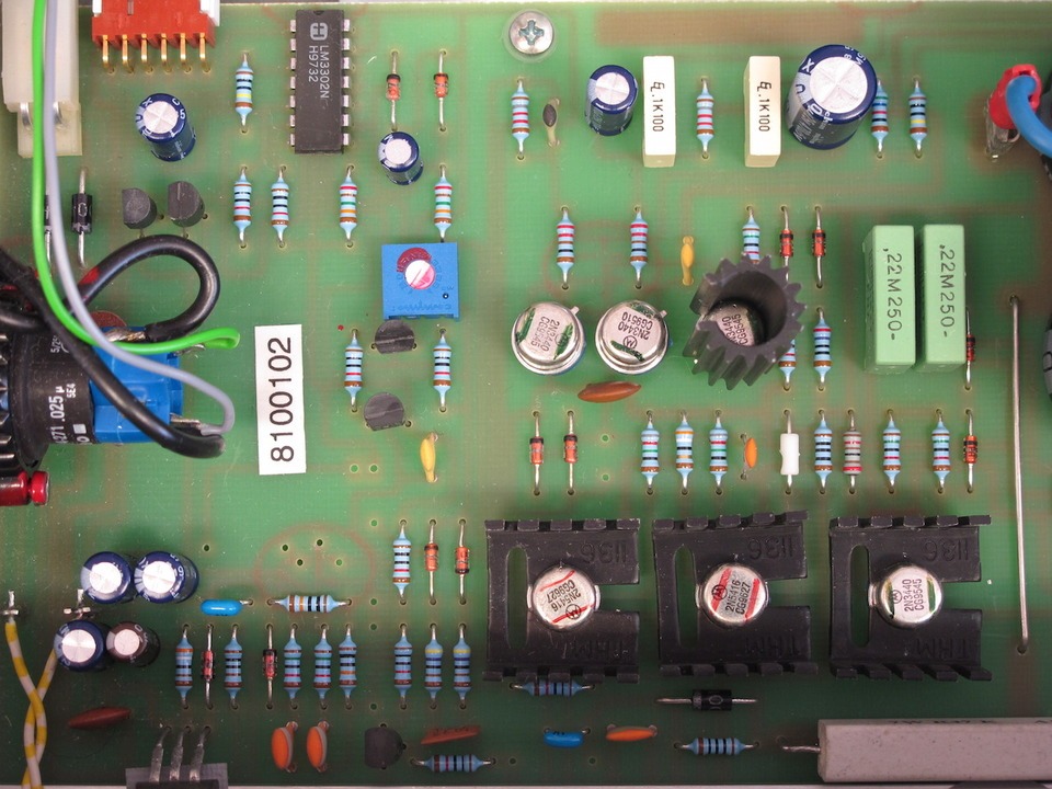

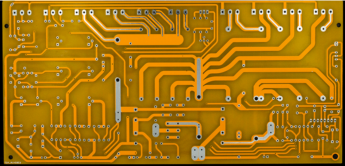

For my ears its a very good, comfort, relax sounding amp to live with, good for large genre of choices. But me as an electronics engineer myself, I can't stay with something with single layer PCB, it just look too 70th, I would rather get something else with better layout engineering efforts and better advancement of PCB fabrication works.
