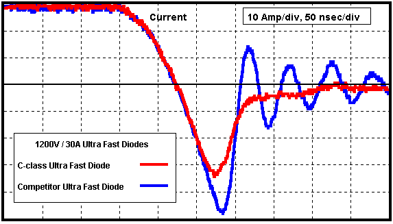

Just because a rectifier's reverse recovery transient lasts several microseconds, doesn't mean that it contains no high frequencies. It tends to end very abruptly unless the diode has been deliberately processed for soft recovery, and this sharp cutoff can generate as high frequencies as you like.
Exactly, Steve.
The attached picture shows (blue trace) a diode with ~ 250ns recovery time, but an obvious spectral component at ~20MHz.
The actual spectrum will depend on the parasitic inductance and capacitances involved.
