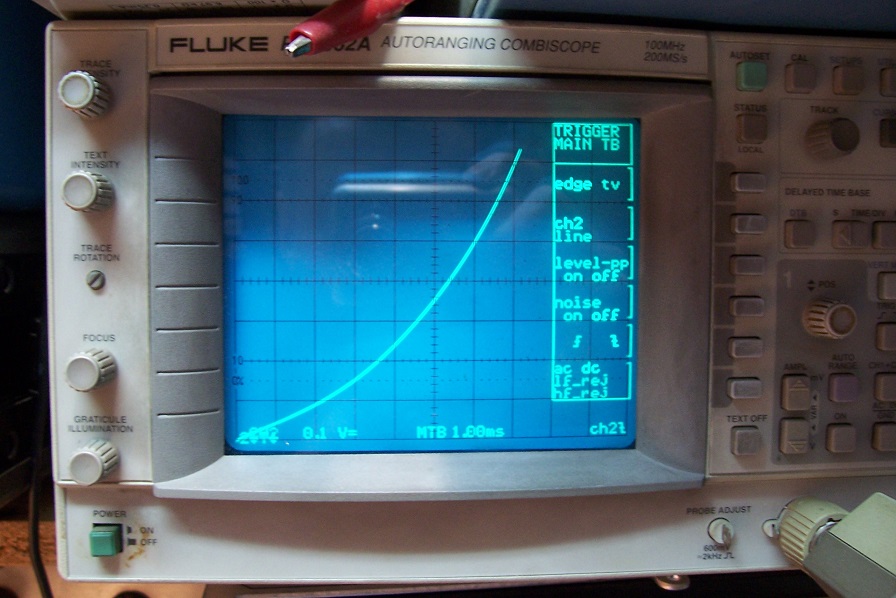

I use a special curve tracer, applying a calibrated voltage step (100V f.ex) to the DUT, and I measure the resulting current.
Thus, on the X-axis I read the V*s seen by the core (100V*ms/div in this example) and on the Y axis the current (100mA/div).
An ideal choke would display a straight line, with a slope inversely proportional to the inductance value.
A real inductor has various curvatures, due to saturation, RI drops, etc.
The curve gives a lot of information about the type of saturation (very gentle in this case), the different values of inductance under a power regime, amplitude, incremental, etc by looking at the local slopes, the intercepts, etc.
I extract the parallel capacitance from the self-resonance frequency

Elvee's test he described in Post 26 is insteresting, but it's not testing the choke in a way that lets you determine just what it will do when carrying continuous DC.
You seem to have a mental block regarding DC and inductors.
DC is nothing special for an inductor; problem with DC voltage is that it can lead to unpredictably high currents after a sufficient length of time, but when the current is imposed, no such thing happens, because the current governs directly the magnetic condition of the core, and in this case, only the instantaneous value is relevant (OK, hysteresis and eddy currents also intervene, but they are only second order effects).
From the graph, I can easily know the behavior of the inductor at any DC current, for example, just in the middle of the screen, the current is 350mA, and the local slope is 600mA/500V.ms.
The local value of inductance is simply the reciprocal of that slope: 500/600=833mH.

Elvee, out of curiosity only (as it plays no part in the main thrust of this thread) I thought it worthwhile to go through the difference in measured inductance between your V=Ldi/dt method, and the method I use.
Your method measures inductance along the initial BH curve excitation locus when starting from zero BH. You can simply and safely push a choke deep in to saturation and see the inductance change in one visual sweep. To my mind, this technique is identical to a DCM flyback type operation.
The technique I use measures the incremental inductance around a small BH loop when a large standing DC current is passed. The measurement technique is then pretty close to how the choke is used in a smoothing application. It doesn't exercise the BH curve as in a choke input filter type application, where the BH loop traversed is much larger, and it takes many single point measurements to build up a picture of inductance variation, and any high DC current measurements have to be done cautiously so as not to over-heat the choke.
