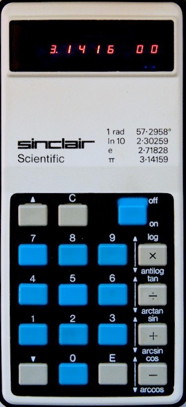

I wish LEDs back in the 1970's were as reliable as they are today
It depended who made them LED 7seg displays used industrially made by HP or similar were reliable, but the market was soon flooded by cheap consumer electronics, calculators, digital alarm clocks etc and the LED 7seg displays were not so reliable.
The magnified LED displays you mentioned were hand manufactured (you could see the wires) and as you say segments stopped working.

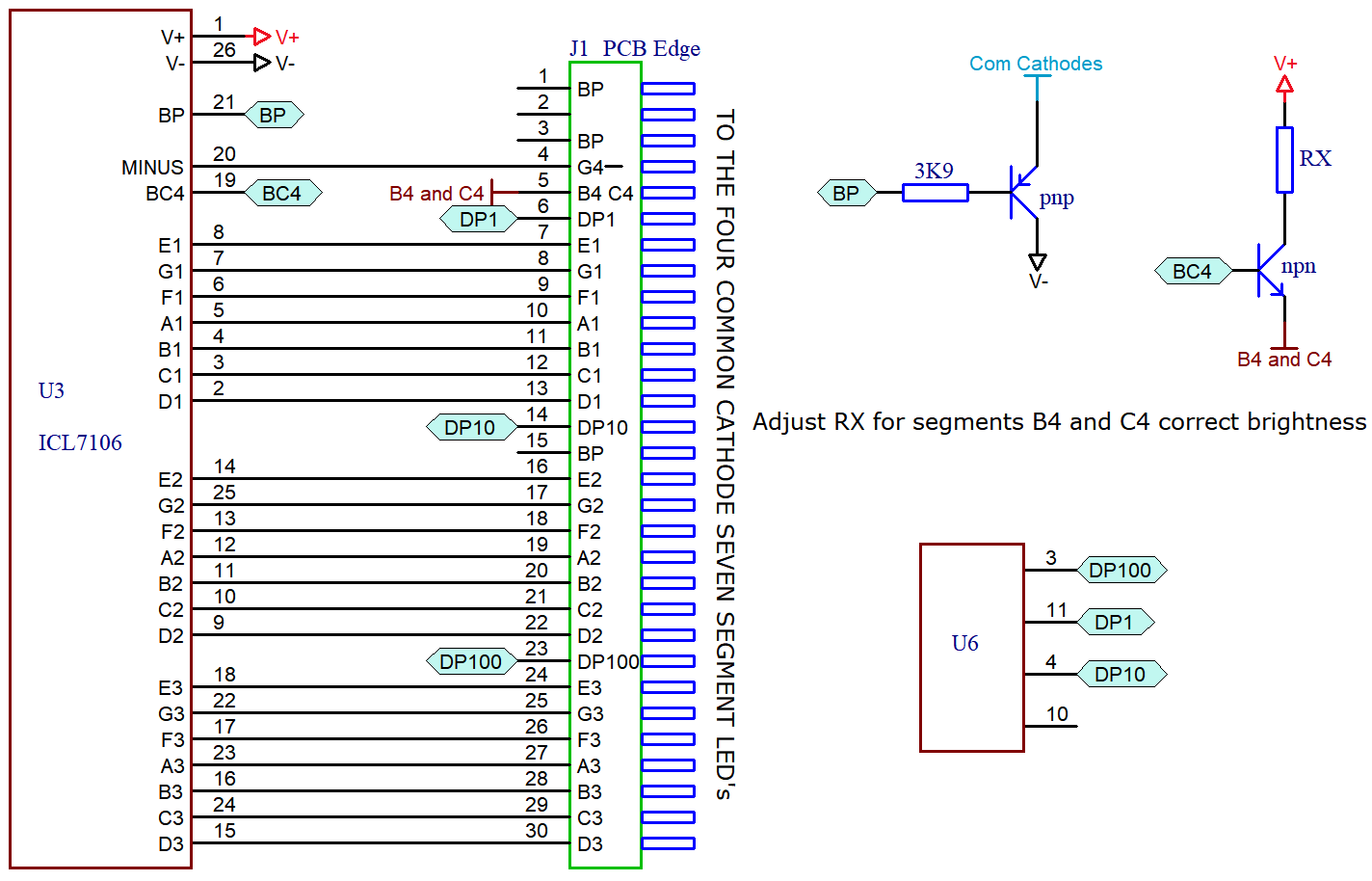

LCD compatible with 7106 are pretty common; just search for it.
And a really cheap DMM is like $2 here, a meter with needle reading volts can be around 50 cents here, you could salvage the volt meter from a car or truck, good enough for seeing what is going on in a solar panel...pretty rugged too.
The 7107 (LED version of 7106) is very much used in temperature controllers, gradually going obsolete. About $0.40 here, seems the pin outs are same for the two chips...
And meter modules are cheap, $2.50 here last I checked, they are supply powered, no battery / PSU needed. Smallest is about 20 mm, fits in holes for panel indicators.

Yes the 7106 and 7107 are very versatile and reliable chips. Glad you still have use for them.
Using a 7106 as a 7107:-
Absolutely, I still have a bunch of both.
They were the answer for an inexpensive meter option, you could use an external reference too.

I was designing voltmeters at the time and still have a bunch of different chips and chip sets. One big improvement was using an external voltage reference, especially for the 7107 LED version as the chip temperature can change depending on the display reading. Many other chips used an external display driver for that reason.
