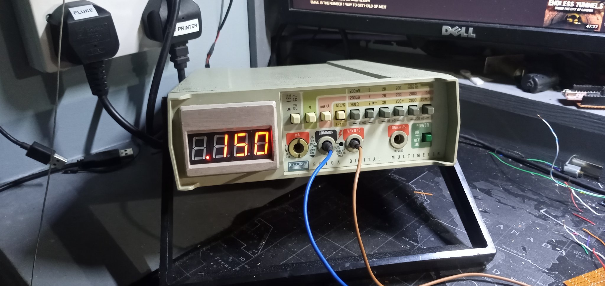

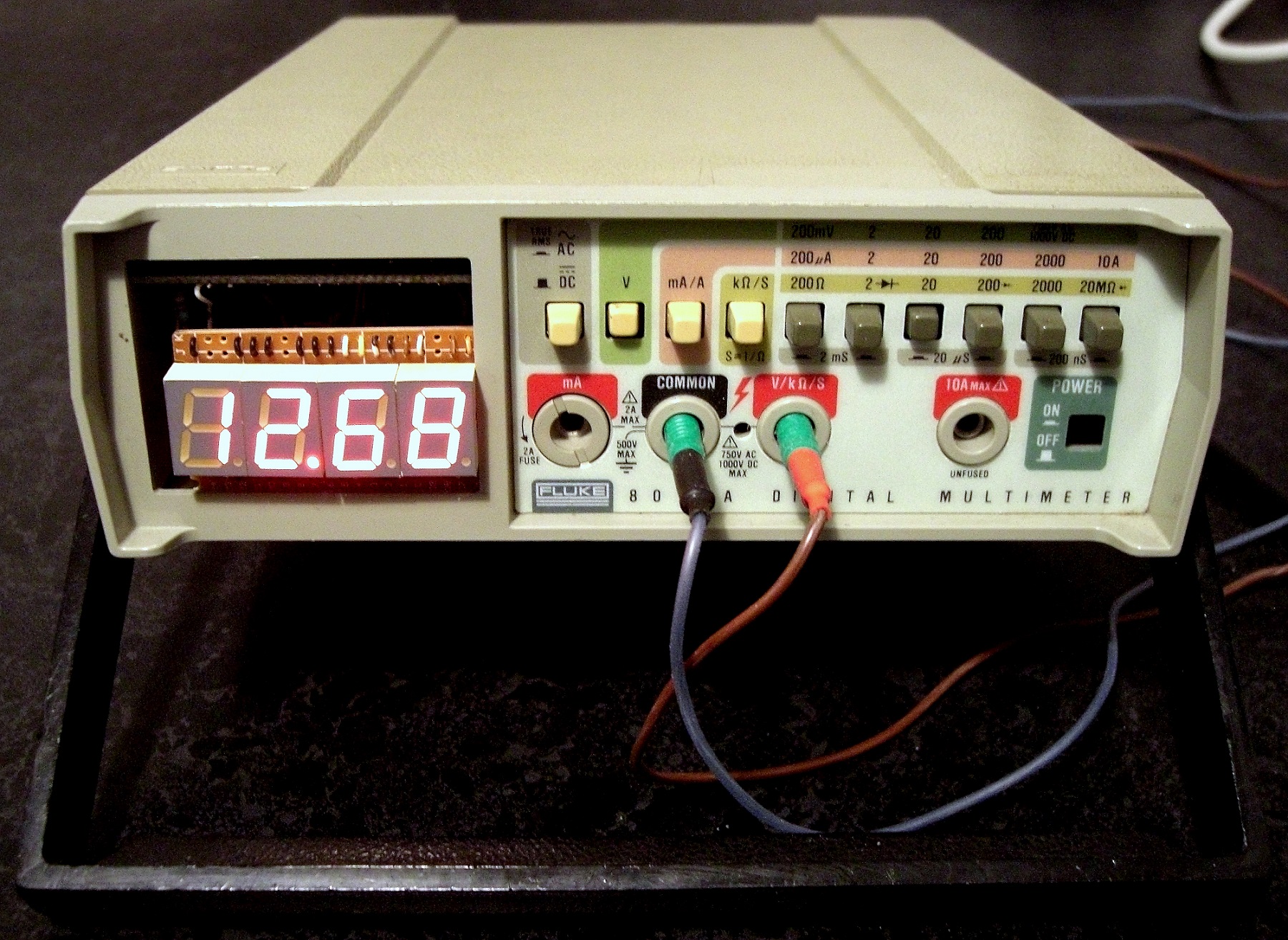

I had two Fluke 8010A Bench Meters both with broken LED displays (they go black). First time I looked at replacing the LCD with LED it looked impossible because the common BP (backplane) signal reverses phase constantly relative to the segment drive signals (that's what LCD displays need to work).

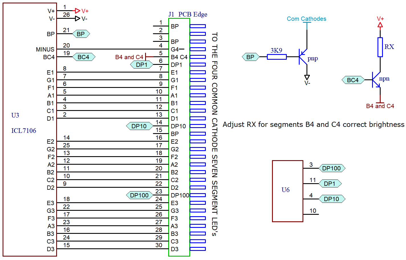

A few months later I had another look and realised that a pnp transistor could use the BP signal to strobe the right phase for four Common Cathode Seven Segment LED's by doing this:-
"Connect BP signal to base of PNP transistor via 3K9 resistor, Connect its emitter to all four LED common cathodes, connect its collector to - Vss
(Note BP drives U6 for the decimal points)"

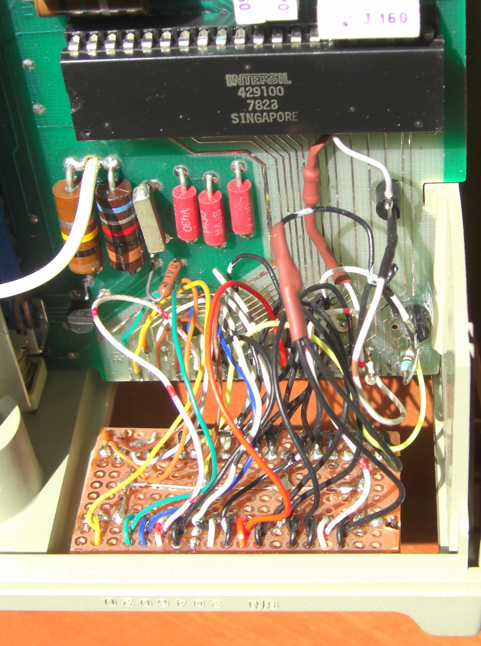

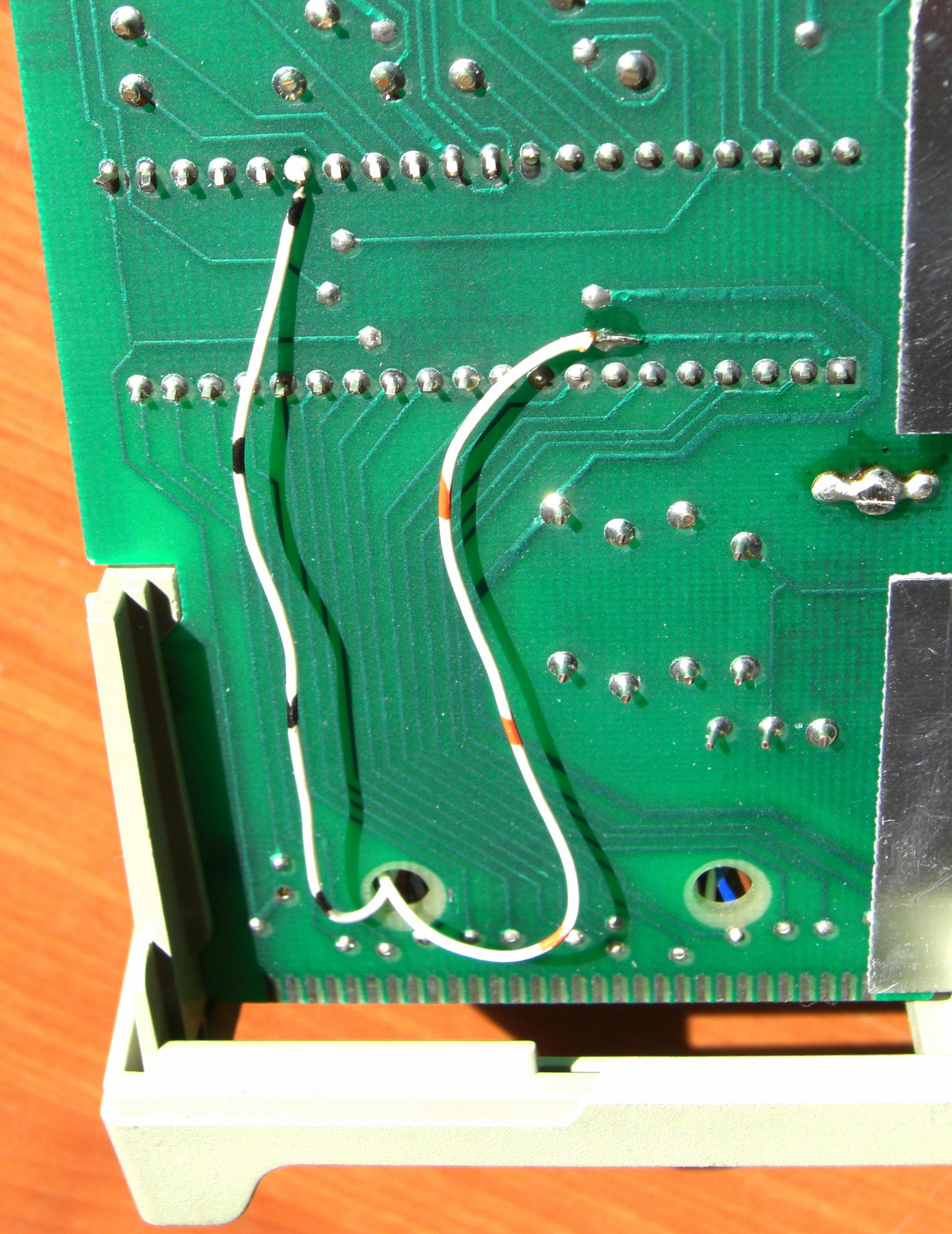

Solder wires from the previously LCD connector to your four common cathode seven segment LED's. See attached pinouts etc. Only three of the LED decimal points need to be connected to U6.
The ICL7106 doesn't have much drive but its enough to get a tidy LED display, don't include any series resistors. The LED's take a bit more current so its a good idea to increase the power supply smoothing capacitors (double the uF value)

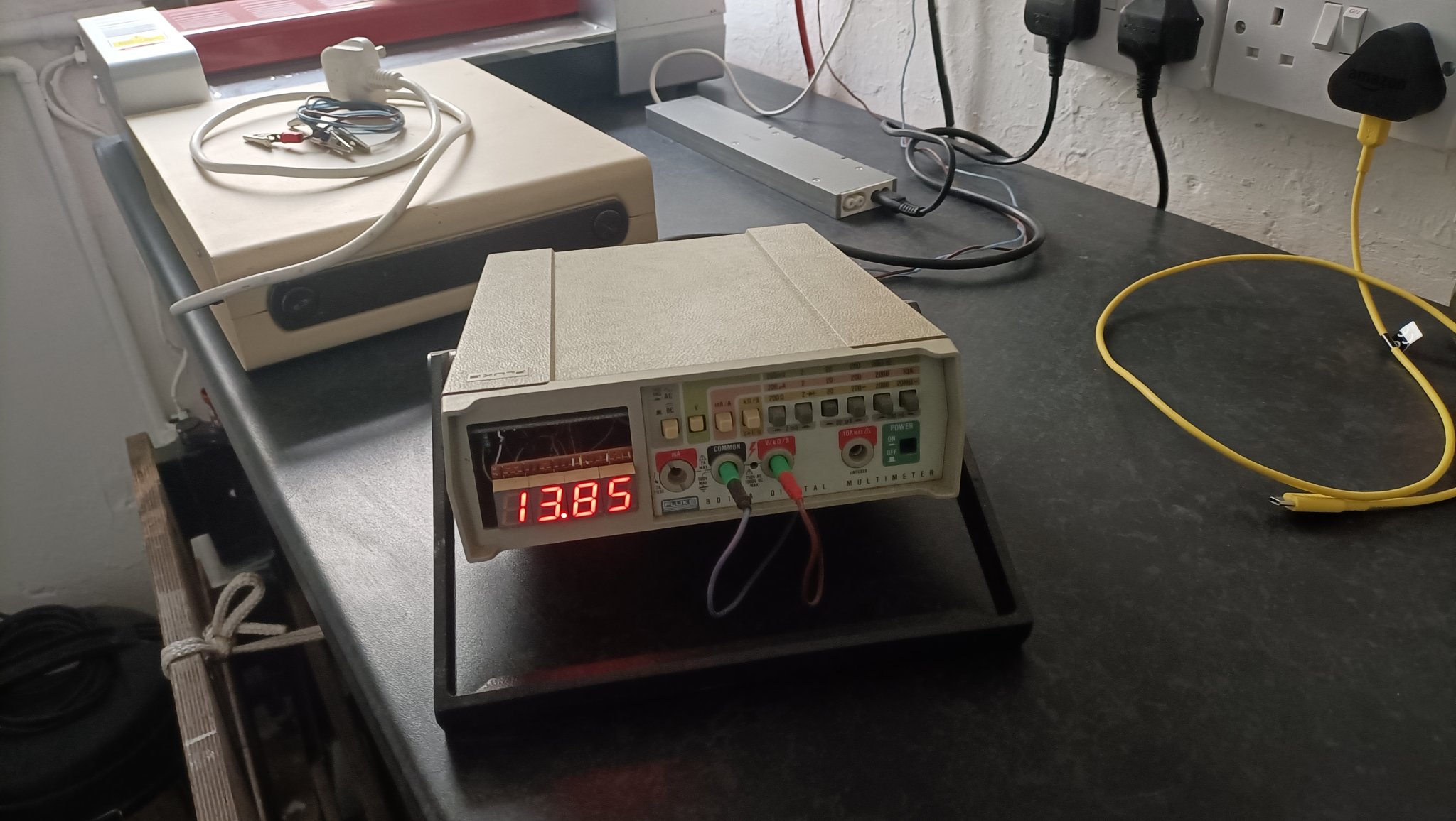

So end result is an excellent and accurate Fluke 8010A with four digit LED display (the MSD LED only displays "1" and the negative sign.
The Fluke 8010A has a very small supply transformer and only consumes a few watts. I have one of the 8010A's permanently on monitoring a battery voltage.

Now we just need someone to do it for Fluke 8842s, since the VFDs have become nearly impossible to get. Eventually I might get around to doing it myself. We'll have to see.
Excellent work, can read the display 24 hours in the day.Thanks.
Photo attached.
Sometimes there's static dust covering on the fluro display, due to high voltage. A wipe down may help.Now we just need someone to do it for Fluke 8842s, since the VFDs have become nearly impossible to get. Eventually I might get around to doing it myself. We'll have to see.
Many thanks.
The LED's I used were Red GaAlAs types, plenty bright enough. You reminded me about the leading "1" first attempt the leading "1" wasn't bright enough because one ICL7106 pin has to drive both segments B4 and C4.
I'm attaching a circuit diagram showing how leading "1" brightness was fixed.

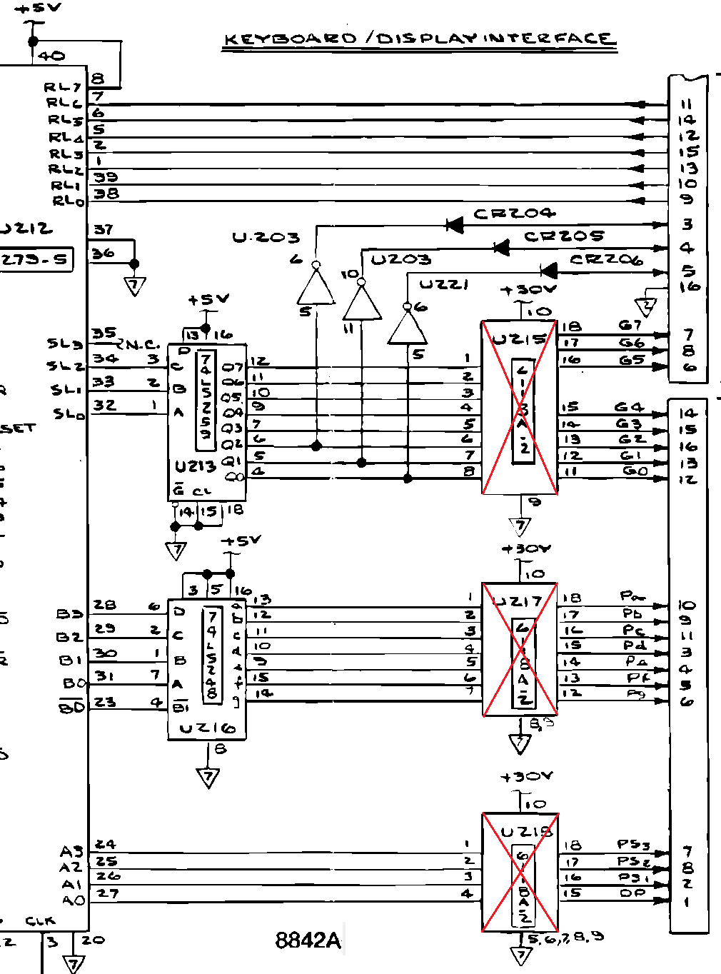

Converting the Fluke 8842A display digits to LED looks possible, the various indications would be more difficult mechanically.
Converting the Fluke 8842A display digits to LED has to be a last resort if the Fluorescent Display became obsolete/unobtainable.
Probably remove the three UDN6118A IC's U215, U217 and U218 and bridge the TTL signals across with resistors. The 74LS IC's will sink enough current to drive LED's. The signals coming directly from U212 should really go through an added 74LS IC. Add pull up resistors where needed.
Maybe use two modules of three LED's each for the six digits because the strobe signals G0 - G7 are provided.

Hi @anatech That's actually a good question. Logically I agree with you that a new LCD DVM module would have been fine. The sequence of events for me was as follows:-
1. I had a few old LCD Fluke bench DVM's and I wanted to get them working and I wanted to preserve them.
2. I had a lot of common cathode 7seg LED's but nowhere could I buy LCD's for the Flukes.
3. I modified four meters 2 x 8050A 1 x 8012A and the 8010A shown.

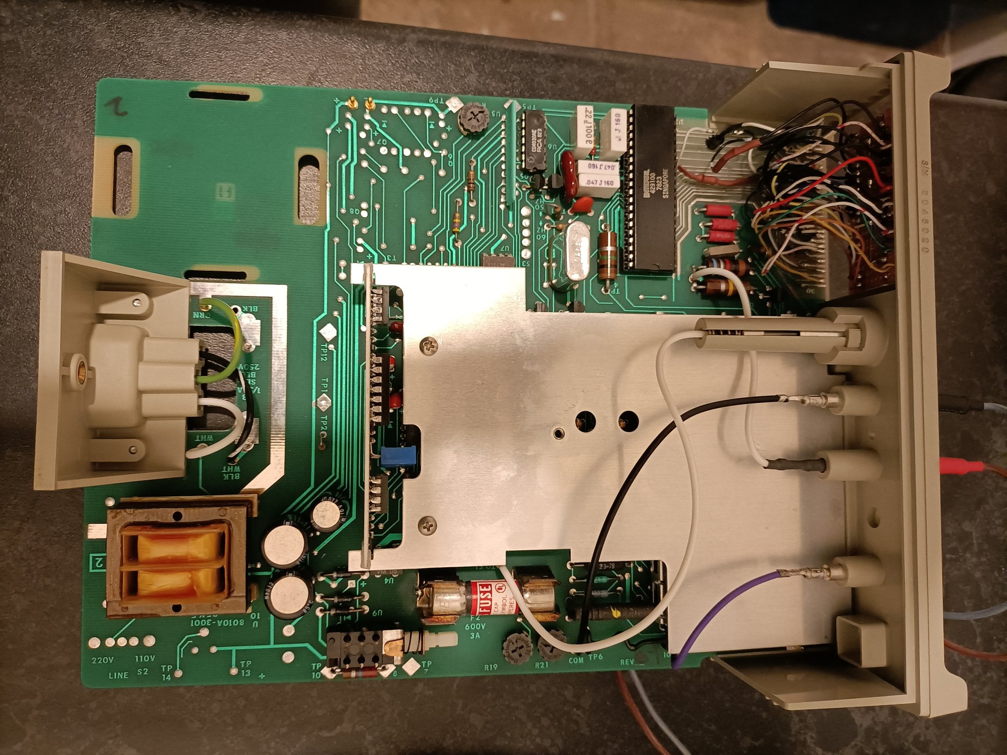

4. I needed to monitor the charge voltage of the solar battery, the Fluke 8010A is very low power, see photo of the line transformer below.
5. The LED display is clearly visible from a distance day and night.
6. I didn't have the idea of using a new LCD module.
In summary Fluke have an unequalled reputation for long life, accuracy, stability and durability so out of respect for Fluke I could not throw these old DVM's away.
The photo showing the very small line transformer and the LED connections:-

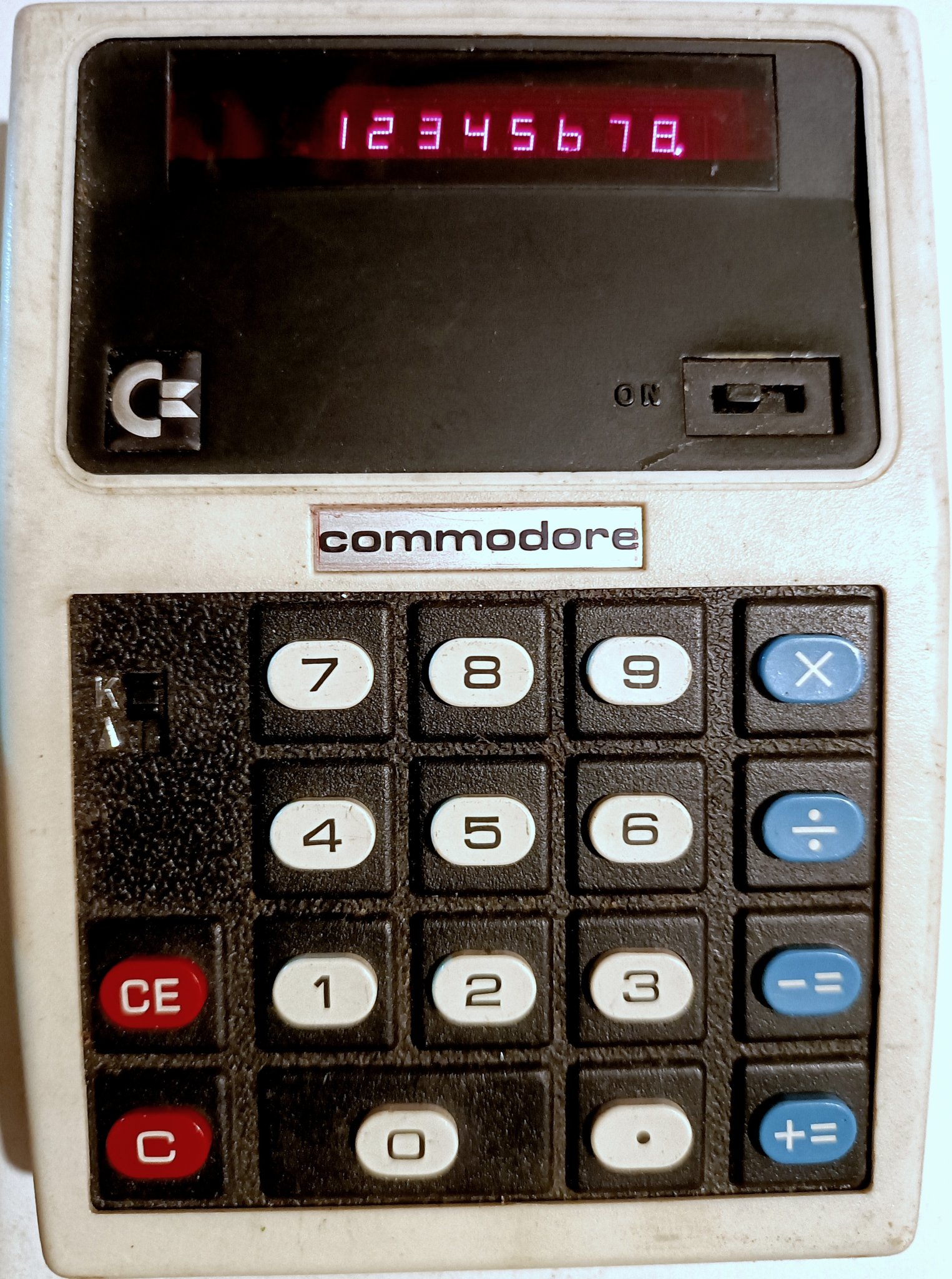

LEDs do age
Not sure about that, I have 7seg LED displays here that go back to the 1970's and they still work fine. In my experience LCD displays are sometimes unreliable after a long enough time.
Here is an old Commodore calculator from the 1970's and the tiny LED display still works fine!
