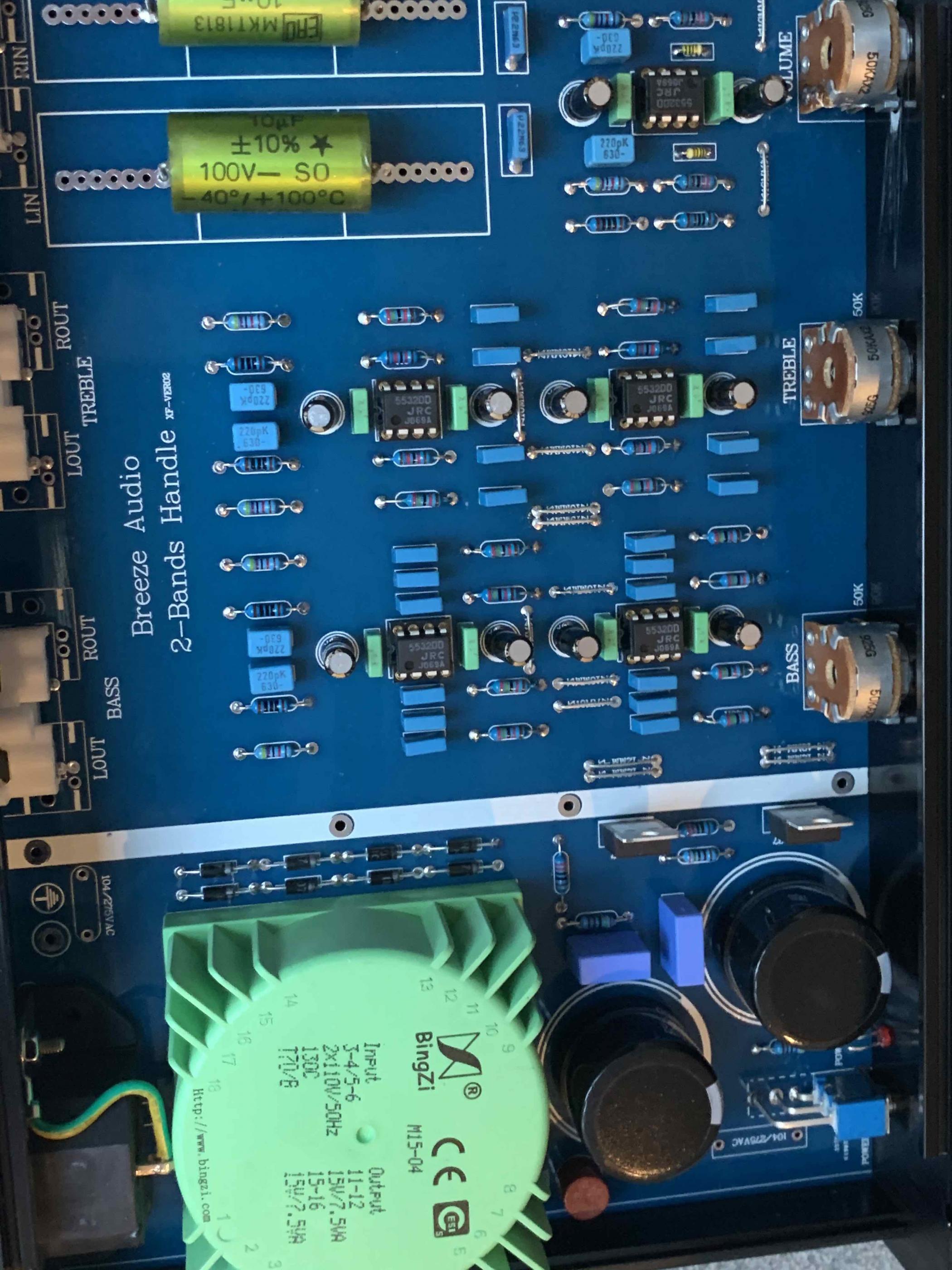

Here's a picture; there's no chokes as far as I can tell, and the PSU section isn't separated from the rest. Do you think a simple steel plate around the PSU could help?

Yes if it is not self-oscillating. Plate has to be bonded so it is connected electrically to the safety grounded case. Transformer can stop RF but the wires to it from line cord have to be short so they don't act as transmitters. There are IEC sockets with RF trap in them if this has unprotected one of those to the line cord.
I tack the 33 pf caps right on top of the feedback resistor with short leads. I don't see them. 22 or 47 could help too.

If you look at the picture there's a thick white line on the board; it looks like it was meant to accept some kind of shield, there are even pads... I should check if those pads are connected to ground.

Your line cord acts as an antenna. Inductive trap for RF has to be near the entry of line cord to enclosure.
There are packaged coils you can buy, dead flat screen TV's & switcher power supplies are full of them. About 8 turns standing up. The ones at the exits of PA amps are about 10-14 microH - or 11 to 14 turns 1 cm diameter.
Yes, the line between power supply & quiet zone looks like good place to put a steel bulkhead. Stainless star washers on scratched paint can bond a steel plate to another plate (like the grounded case) if held tight enough. Realize when steel case top is off shielding bulkhead is only effective against hum, not RF.
Whole pcb will act as antenna if RF is not kept out of the case.
