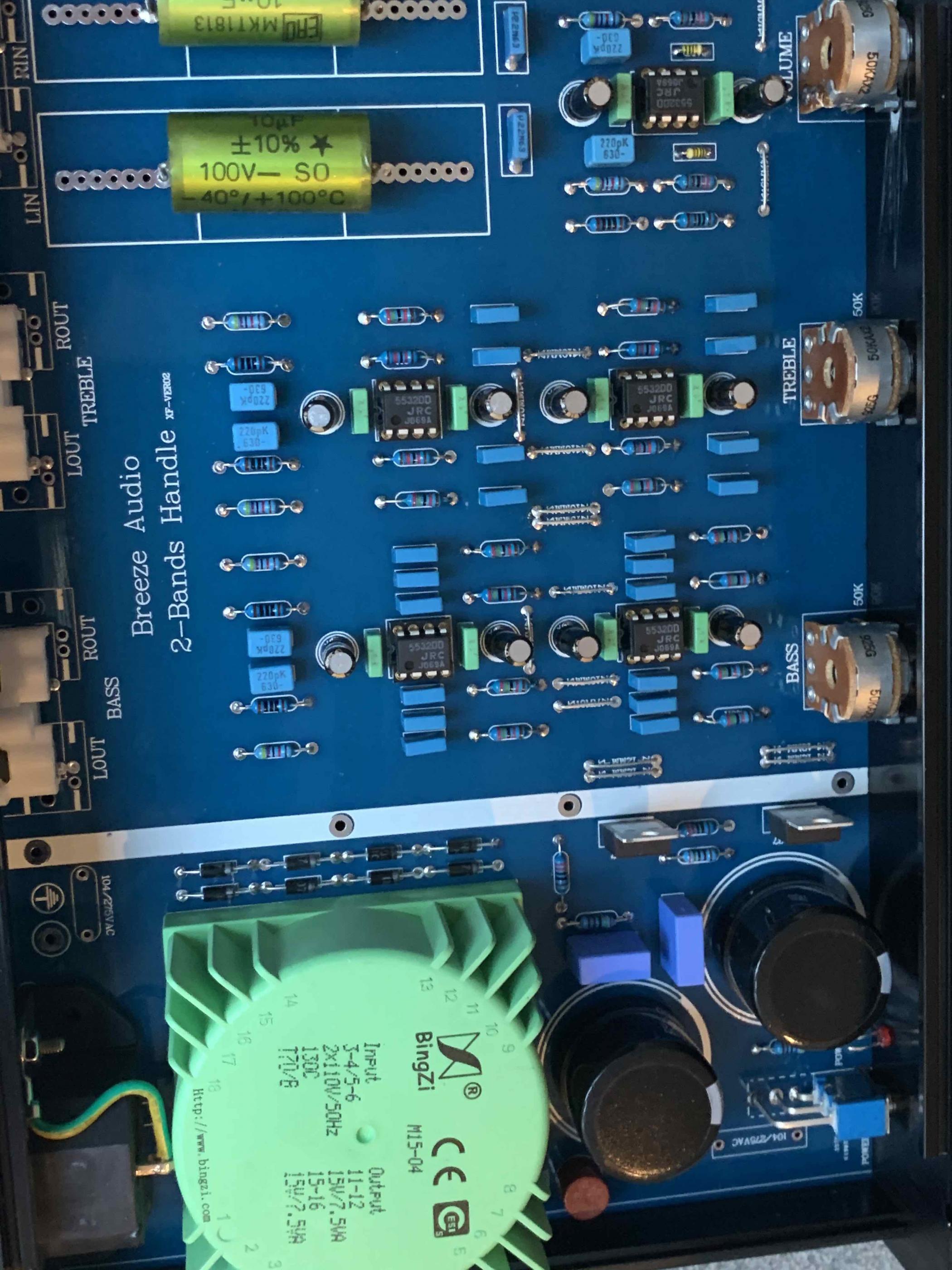

Hi all,
So I'm currently playing with this cheap but neatly built active crossover from Breeze Audio (China cheapie).
Ever since I've started using it I started hearing fluctuating high pitch noises in the tweeters, like a whistling sound that comes and goes; it is fluctuating in level and in position, going from one channel to the other like a UFO or just in both; then disappearing. sometimes a lower frequency buzz comes along.
My speakers are 104dB horns and compression drivers, I think it would be much fainter on regular cone/dome speakers, probably barely audible.
I've been experimenting with cheap Chinese discrete op-amps wich went quickly out as they had very bad DC offset; I now use OPA2132 but with all op-amps tried I was getting these interferences.
At first I've been using this device with ultra cheap, unshielded interconnects and I thought they were the reason, but now with shielded interconnects the noise still comes and goes, although it is maybe fainter? (not sure here).
I have a wi-fi modem just a meter away from my stereo equipment; not an ideal situation but I didn't have any issue so far. There's also an office with about 6 computers just above my head. Parts of the electric circuit are shared as this is an old house.
The crossover itself is enclosed in a nice, all aluminum, thick box that should provide some protection against RFI...
I've received yesterday some bag full of cables and tweaks from a friend; there are some ferrite beads to clip on cables, various sizes, I've tried few locations but while it seemingly improved on some stuff (probably placebo!) it didn't help with the noise so far.
Is what I'm hearing really RFI or are my OPA2132 oscillating (but I've never ever had an OPA2132 oscillating...)? I could add some 0,1uF MLCC cap under each chip and see if the noise goes away... but its fluctuating nature makes me think more of interferences...

It does sound like you are describing RFI from the wireless.
Simple test... move the wifi somewhere else, a few meters away and see if the problem persists.
The aluminum cases on these gadgets are nice and sturdy and they look nice, but they are seldom grounded. If not grounded, they tend to act like antennas and can actually make an RFI problem worse. If you can add a ground lead from the case to the outer ring of the RCA connectors, you might solve the problem.
Also, adding low value capacitors in the 10pf to 50pf range across the audio hot lead and ground right at the RCA connectors might knock it down. At least it would stop your cables from acting as antennas.
Also make sure your input and output cables are well shielded and the shield is connected to RCA ground at both ends ... You should note that a lot of the really expensive "audiophile" cables are not.

Actually I looked closer at the circuit and couldn't find any local ceramic decoupling capacitor close to the op-amps (the circuit came with NE5532). There is 22uF silmic and a small plastic (?) cap of unknown value on each supply rail to ground, near each op-amp, but not nearly near enough for a faster device.
So I added 0,1uF MLCC under each chip between pin 4 and pin 8 and the noise is gone, all I hear now when I put my ear very close to the tweeter is the very very faint hiss inherent to all active circuit, but nothing weird.
Looks like the OPA2132 were oscillating like crazy!
It also sounds better, more focused and quiet, less fuzzy.
The enclosure is grounded!

Excellent. I would still ad the low value caps on the input jacks just to play it safe. They should not affect the sound, just take RF off the input cables to ground.

Its not widely appreciated enough that modern and even not so modern high performance opamps need proper decoupling with ceramic low-inductance capacitors between the two rails to behave. Lack of decoupling can lead to very subtle effects sometimes (measurably greater distortion than the datasheet without audible oscillations - hard to spot).

Okay so I've changed my decoupling scheme.
Now I've put 0,1uF MLCC from each power pin to ground - instead of between V- and V+.
But now they are paralleled with what was originally in the circuit: some 22uF (those will stay or be replaced with 100uF), but also some 0,1 (apparently) plastic (?) caps that are between each supply and ground but just a few mm farther.

Put 33 pf disk caps parallel the op amp feedback resistors. Pins 1 & 2 and 7 & 6 usually.
I had to do that to my 33078 when I replaced the 4558 the mixer came with. In addition to a .1 uf between supply rails for every 2 packages.
When you replace a 6 v per microsec slew rate amp with a 20 v per microsec amp, make sure the high freq gain is killed by shorting it out with the feedback cap.
