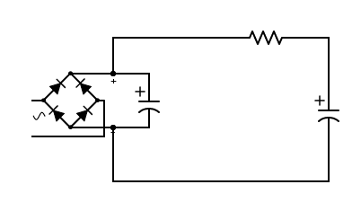

I've read veterans here advising us non experts to think about circuit flow, avoiding sharp corners, and maximising reference to circuit ground. So I'm wondering about the following scenario where one is wanting to add a CRC filter to an existing PCB where there is only connection for one filter capacitor. My gut says that the lower circuit with outboard filter tied in at one place will work because the circuit still sees the whole CRC filter, but that performance will be better if done 'properly' as per the top example where impedance and flow is better. Is that right or am I missing it completely?

Neither, the first capacitor should go directly to the rectifier. From there, bring out the
two +/- connections to the rest of the filter.
Large current pulses go between the rectifier and first capacitor. You don't want to comingle
those pulses with the rest of the filter.

I'm slightly confused. So my bottom option of post 3 was wrong because it has both caps seeing the rectifer at the same time so there is effectively no "first cap" to take the rectifier current pulses.
Yet, I'm unclear on how the example in post 2 is any better. The classic arrangement would seem to be something closer to this.
...As I said, slightly confused.

The rectifier and the first capacitor are the first subcircuit. The remaining parts are the second subcircuit.
You don't want those subcircuits to interact, any more than is unavoidable.
Ground noise, comprised of 120Hz pulses from the ohmic voltage drop due to the rectified current pulses,
is present in the connection between the first capacitor negative terminal, and the rectifier.
This noise must not be coupled into the second subcircuit, or there can be noise in the regulator output.
The way to avoid such coupling is to connect the second capacitor's negative terminal directly
to the first capacitor's negative terminal, but do not connect the second capacitor to the rectifier,
or anywhere else in between the rectifier and the first capacitor.

Maybe part of the confusion has to do with the fact that in post #1 and post #3 the "bottom examples" are not equivalents of the "top examples". In both "bottom examples" the first resistor and second capacitor get paralleled to the first capacitor and the positive terminal of the bridge rectifier gets connected straight to the third capacitor and regulator (so the resistor is no longer in the path from the positive terminal of the bridge rectifier to the regulator).
Hmm. All right, I'll abandon that. I'll use a rectifier & filter board and attach it to the other power supply board at its filter cap connection.

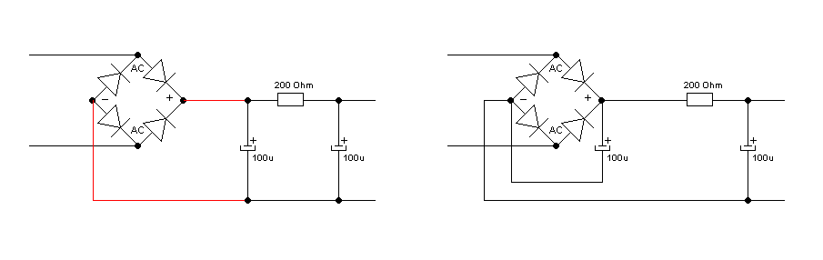

Maybe this helps showing what I think others in this thread were trying to make clear to you.
In the situation on the left side the red coloured leads will be shared by the first capacitor and the rest of whatever the power supply would be feeding. In the situation on the right there are no leads anymore that are being shared by the first capacitor and the rest (except for the tiny bits of lead in the bridge rectifier itself).
The situation on the right is better than the situation on the left.
OK, so if they are separate sub-circuits what makes one the 'first' capacitor that handles the large current pulses? Is it just the shorter leads and thus lower resistance?

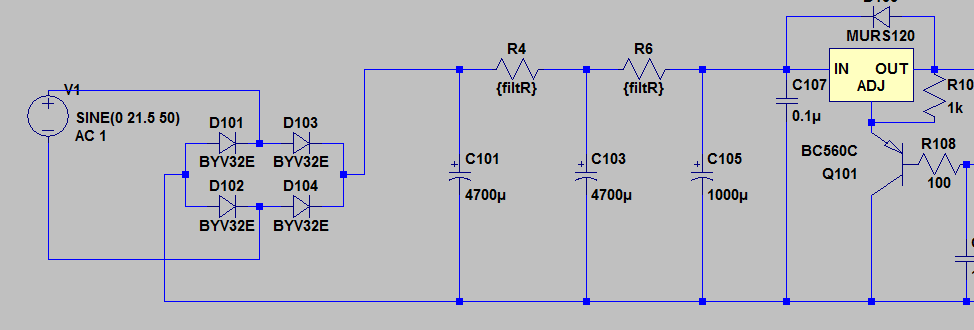

Somewhere above I saw a sim circuit with small resistors in the wiring between the caps to simulate wire resistance.
That's very good, but it should also be done in the ground wiring between cap returns and bridge return.
