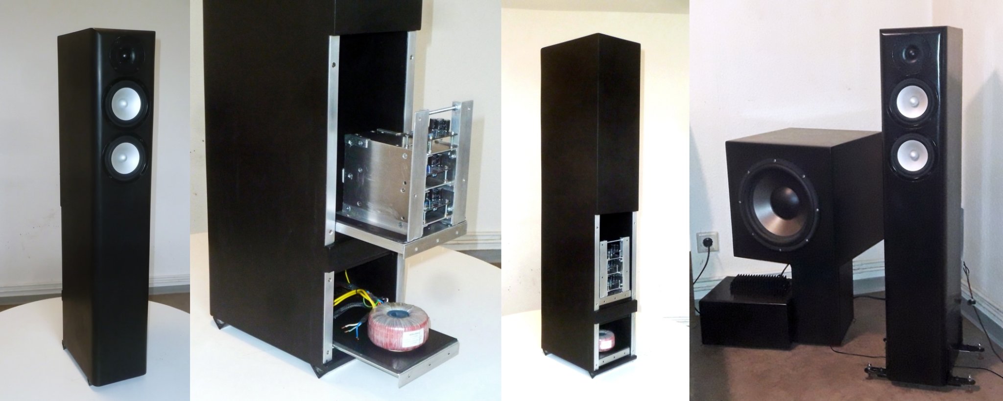

P.S.: these are my actual speakers & my first try in DIY
