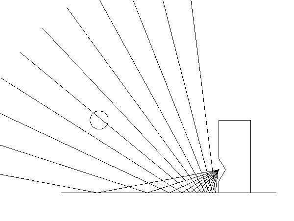

It's not an average, just the specular reflection point.

Yeah there is six boundaries in a cubicle room, and one first specular reflection from each, a lot of 2nd order reflections could also arrive about at the same time as latest 1st order reflection, and so on. Floor is about the earliest one to arrive as both driver and listener are quite close to it. A sidewall could be very close, or back wall if your sofa is other side of the room. Front wall, the one behind speaker, is surprisingly far away in terms of sound travel, as it is a round trip. Now, depending how all of these combine could make audible suckout.
If you put woofer closer to floor decrease path length difference to direct sound and get interference higher in frequency, then path length through ceiling would increase, so it's a balancing act best handled by speaker positioning.

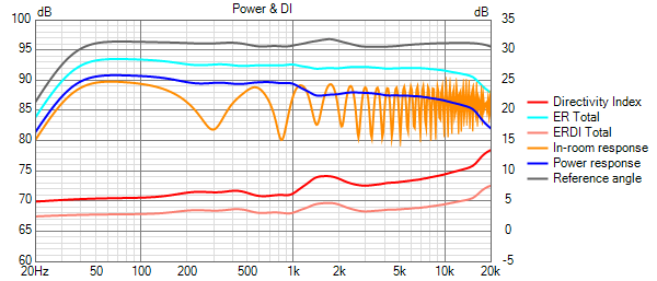

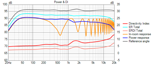

I'm modeling a 12" OB coax just above a 15" Uframe woofer. First attachment orange trace is in-room response with floor reflection enabled with floor set 900mm below coax center. This leaves room for a subwoofer below the Uframe. 2nd attachment is with the floor set at 600mm below coax center. Floor null moves up in frequency and doubles in depth. I've played games with multiple drivers overlapped in the floor null region and got even more suppression of the floor null but abandoned those solutions when I realized the suppression in these cases was highly position dependent.

The nulls can be less sharp because the cone is larger
Little addition to this, very often the resolution of either the graph or the measurements (or both) isn't high enough to really show the deep nulls.
- Something a lot of people (incl expensive measuring gear) often forget.
Keep in mind that both sources need to be perfectly aligned as well to make this happening.
So being ever so slightly off, is enough to not get a full null.
