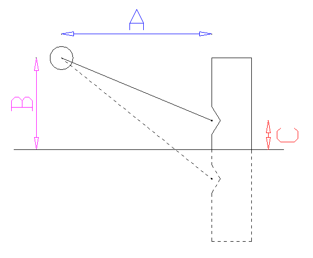

Calculate the distance from the woofer to your listening position both directly and via the floor reflection. Find the difference in distance and see where that causes a cancellation by being a half wavelength. Adjust the height and repeat until it's out of band.

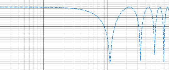

The comb filtering usually looks like this with summation below a certain frequency, and nulls above. The nulls can be less sharp because the cone is larger, the reflected distance is further and it's at a different angle to the woofer, so the relative SPL can vary.What is the frequencie(s) cancelled ?
Reflected path distance =try to understand Allen's shematics and involved waves lengths ?
SQR(A2+(B+C)2)
and the direct path distance =
SQR(A2+(B-C)2)

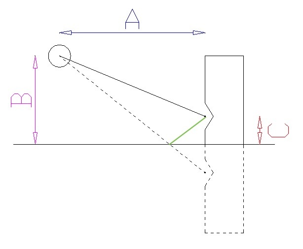

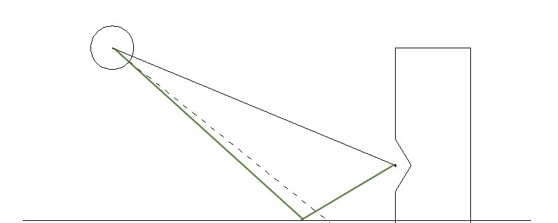

You are correct, it's the same thing drawn differently.I was thinking you meant

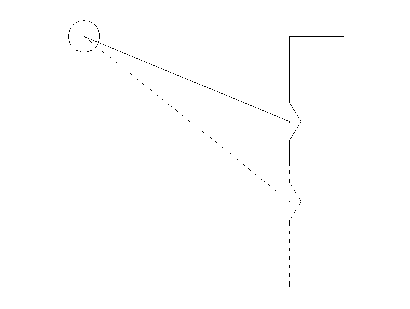

I was just about to post "I don't understand why you show the mirror image below the floor." with this image when you posted above. : )

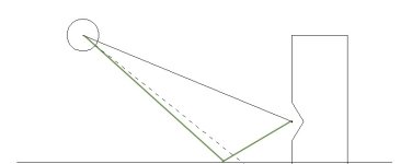

Measured with a ruler on my screen , the green length and below floor length are the same. OK. So then why / how did you choose that particular bounce point as an average?
