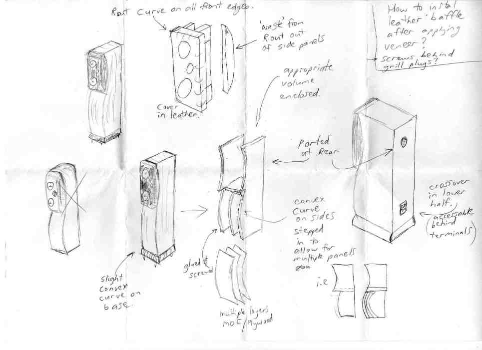

Now am set on a course to build an MTM based on Dr. K. build but using the crossover designed for Natalie P design.
As for the cabinet, I've been doing some drawings. Any feedback much appreciated of course.

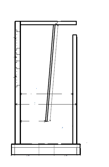

Neither. It starts at the beginning of the line 😉 i.e the top of the cabinet. Zdriver on the one you refer to (distance from the throat of the line to the centre of the tweeter) is 9.5in. In an MTM configuration, the drivers behave ~ like an oblong source, so you take it from the central point, in this case, the tweeter.

Also, I don't understand the logic of how your statement can be true. Why should the 'start of the line' start at the top of the cabinet for one midwoofer driver, but be between the drivers for a dual midwoofer setup? It seems counter intuitive.
A TL is a 1/4 WL resonator, so the closed end is the beginning of the line regardless of where the driver(s) are. Their location along the line will determine how much TL action (pipe gain) they 'feel' with max loading if mounted at the closed end and least (virtually none) at the open end.
GM
As GM said. The 'start of the line' is always at the sealed end of the enclosure, irrespective of the taper of the line, the number of drivers used or where they are positioned along it. Perhaps the attached rough digram will help give you an idea of the layout that would be used for the 2nd & 3rd TL variations I did for Zaphs BAMTM above.

I like the curves you are working with and encourage you to see them through.
The leather baffle can be done...stay with that as well...if you aren't comfortable with gluing the baffle in place, you might find long screws to insert from the back...

Okay,here is what I did based on what has been said:
On the original plans of the BAMTM, from the top of the cabinet(internally) to the tweeter is 5.50" minus the .75" MDF thickness plus 5.50" equals 10.25". I didn't get the 9.5". So I am confused. That's why I asked for a sketch of the layout, which Scott you gave, but without the numbers to show how they apply.
You've lost me. What has the distance of the tweeter from the top of Zaph's original box got to do with the TL I did?
It's quite simple: in the TL, position the centre of the tweeter 9.5in down from the internal top of the enclosure. The upper driver should just squeeze in. I'm sorry I can't provide detailed dimension drawings, but my main PC has been dead since last Wednesday, so I'm on a laptop, and I figured that the dimensions given were easy to convert.
So: assuming 3/4in build material, what you require is a cabinet 44in x 7.5in x 13.25in (internal HxWxD -I've included the thickness of the sloping internal baffle in that depth dimension), using the internal layout of the box I posted above. The sealed end (i.e the bit in front of the sloping baffle) is 10in deep; the open end (i.e. the bit behind the sloping baffle) is 2.5in deep. The centre of the tweeter is mounted 9.5in down from the internal top of the line / cabinet. Stuff the entire cabinet with 0.65lbs ft^3 of hollow-fibre stuffing for the response indicated in the 2nd FR attached to my original post, for the ~ +/- 1db FR ripple, and then adjust the quantity to suit your own taste / requirements from there.

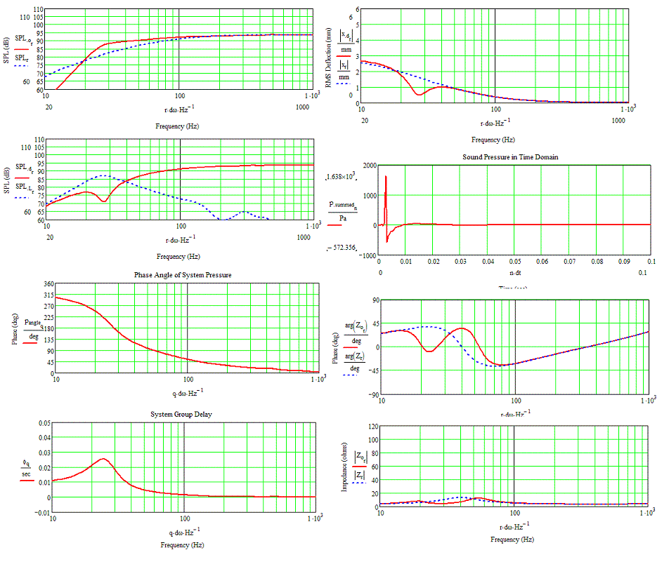

Well, here's one possible MLTL for twin RS180s in an MTM configuration, based on Zaph's measures, & reduced as far as I'm happy. 42in x 7.5in (so existing XOs can be used: if they don't have step compensation built in, don't blame me. I've included a goodly selection of plots on the off-chance) x 11in. Zdriver (tweeter centre) 10.5in, Zvent 38in, vent 2in diameter x 3in long. Line with 1in acoustic fiberglass or stuff 0.53lbs ft^3 from the top 35in down.
