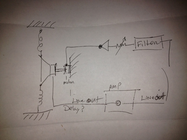

Not sure where you are going with this, but...
I new and am willing throw ideas out and don't mind the critical feedback.
I am not sure what you are trying to accomplish. But if you desire to hang a speaker loosely to isolate from vibration, I wonder is active feedback would help keep it at a fixed point.
Idea:
The speaker hanging out there is physically connected to a light but rigid structure that is moved by a speaker voice coil or something that can move fast enough. The motor moving the light but rigid structure is attached to speaker wall. An opposite signal than the music you wish to hear is driven to the attached motor. It can be attenuated, amplified, filtered to the band freq of greatest concern. A fudge factor can be added for delay, acoustic impedance, etc... (always need fudge factor)

Try here for a start. Though, as pointed out numerous places in this thread and the rest of DIYA, the difference between ~2 microns and ~7 microns of magnet reaction motion per millimeter of driver excursion is pretty well negligible. Not that things being non-problems has ever stopped DIYers from trying to solve them. 😛
