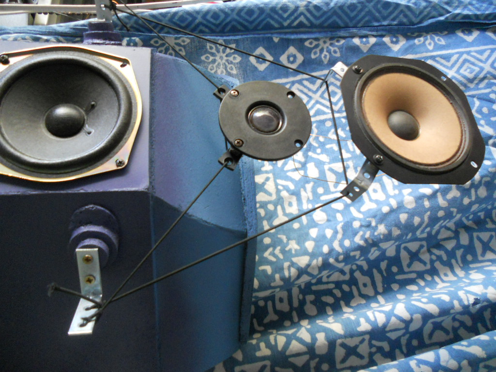

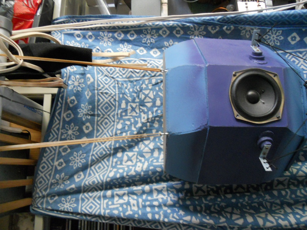

I'm in the making of a spring suspended 3 way, very easy and also OB.
Not springs but rubber bands because the springs introduce some mechanical noise;
and not OB but some U-frame to let the back wave estinguish slowly without making
too much harm ....

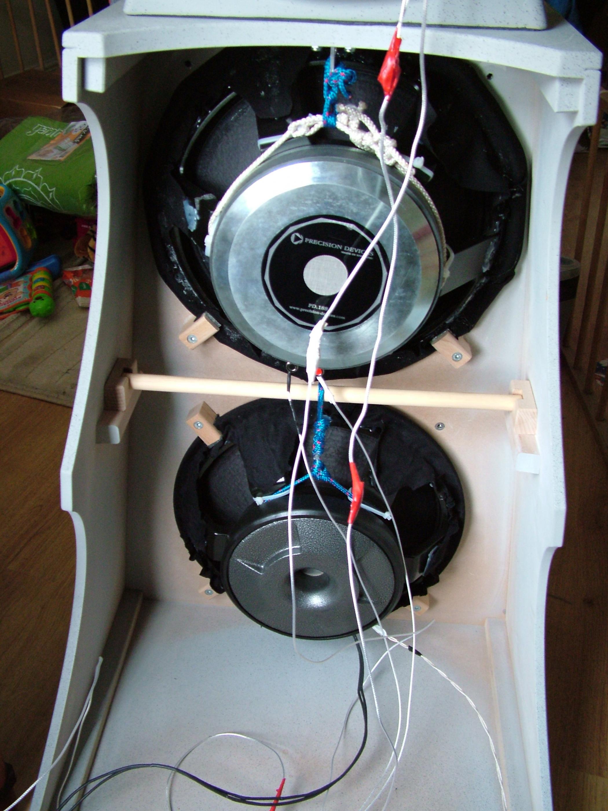

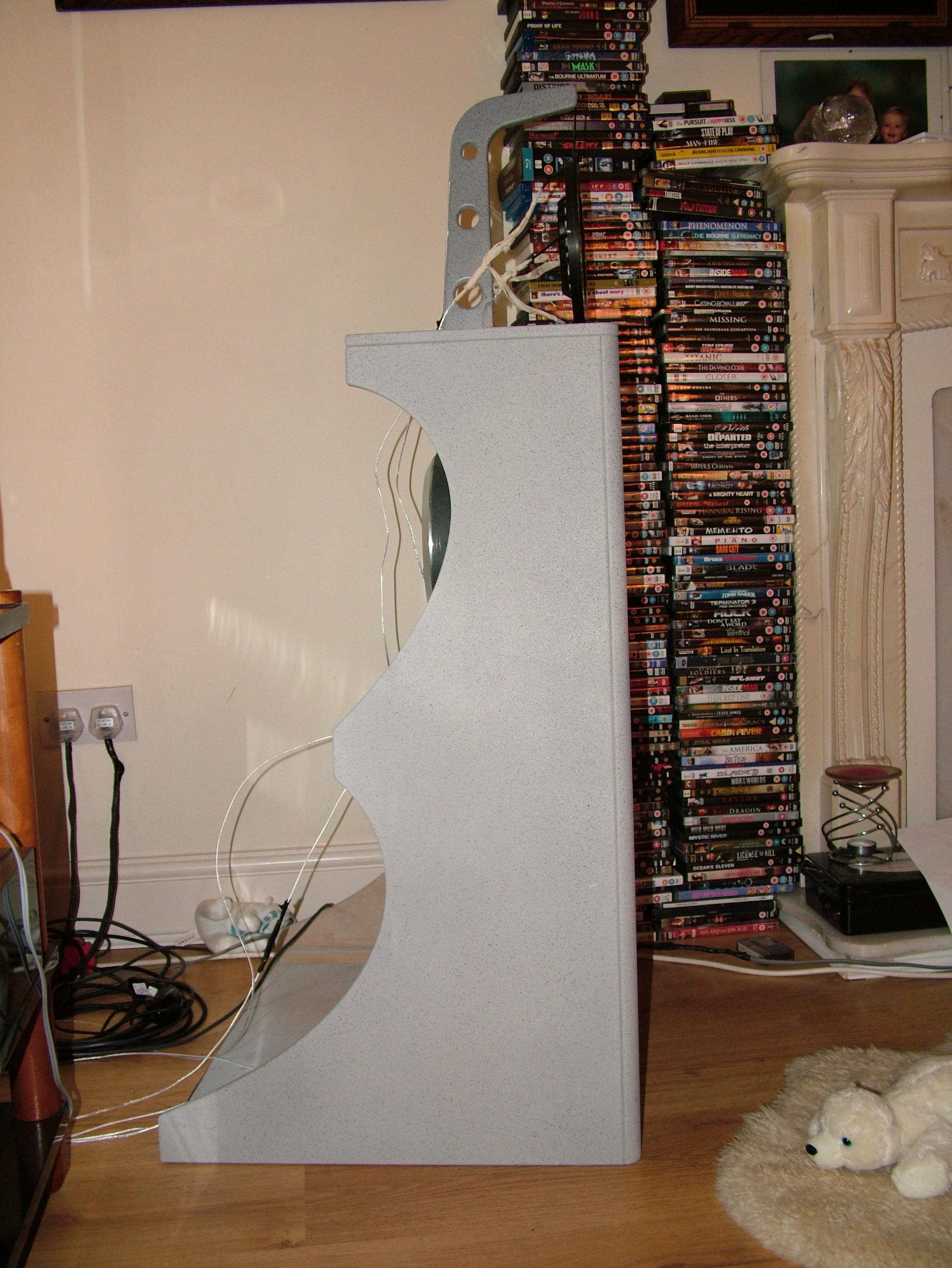

Hi Guys,
I made these in 2010... Still love the sound but not got the space anymore.
I think suspended drivers work best in open baffles.
The attached used a Beyma SM115K 15 inch bass, Precision Devices PD 158 15 inch low midrange and the Manger driver above 500Hz.
Battery powered DEQX run all Eq and crossovers.
The 15 inch drivers were suspended on soft polyprop cord from wooded dowels.
The drivers were not bolted in place, they were suspended a few millimetres away from the rear of the baffle and then pushed gently against the baffle via Sorbothane blocks. Large sorbothane gasket in front of the speaker chassis and Sorbothane blocks behind it, the driver itself never touched any surface of the baffle.
The baffle was birch Ply and MDF, the front baffle was CNC'd out of 75mm thick MDF, the rest was all cut from 12mm birch.
The 15 inch driver are both rather special, really effortless and natural and also capable of filling a large room with powerful music...110dB peaks at the (4meter) listening position!
Even at max party volumes the cabinets were inert, no nasty panel vibrations induced from the drivers. Its hard to more definitive because every surface in the room was being energised by the sound energy i.e. sofa tables, walls etc. but the sound stage remained stable.
Bottom line is this method ( or similar suspended & open baffle combo's) is the only method I am aware of that TOTALLY eliminates all cabinet resonance and effects.
You can eliminate cabinet resonance by CNC' ing cabinets from solid blocks of alloy / phenolic resin / synthetic stone etc and get 200Kg non resonant "containers"...
BUT you still have all the usual internal reflections bouncing around and then emerging out through the cone ( out of phase) sonic problems...
You can go open baffle and get rid of the internal resonance, but you still have cabinet resonance....
Only combining Open Baffle and fully isolated / suspended drivers will let you hear the drivers and crossovers without and cabinet distortions.
Cheers
Derek.

And how do you achieve that ?
Ps. And 'bouncing' is the key ...
I did it this way. Stig Erik's build may also be of interest, though neither his build or mine is optimal in that no real effort's made to obtain torque balance---if one seeks to minimize parasitic vibrations the ideal motion is purely linear translation in response to soley cone thrust, which requires zero net torque in order to avoid any rotational components. This is why all my hangs are pantograph-like. I can't really say if the likeness is good enough but neither is it poor; THD is below my -50 to -55dB measurement noise floor. The distortion increase from decidedly off balance configurations is measureable easily enough.And how do you achieve that? 🙄
With a full range some sort of rear wave control is required for adequate SPL, which in turn means some kind of baffle, box, pipe, or what have you. Full range implementations tend to be better about avoiding box pressurization and associated internal vibration sources than multiway---more BVRs, horns, TLs, and such in full range with more attention paid to stuffing, compliance volumes, and other forms of resonance control. If one, for a moment, assumes panel vibrations and such aren't an issue, this leaves the problem of the driver axis is rarely aligned with the enclosure's center of mass. This produces a torque imbalance and so the speaker will tend to rotate when hung. I rather suspect the resulting distortion will generally be negligible, though, most enclosures being heavy compared to the few grams of moving mass in a typical full range driver. Given the smallness of the angular deflections and compliance of typical speaker supports (flooring or shelves) it wouldn't surprise me if it turned out there's no measureable difference between hanging and normal placement in this regard. Similarly, it would surprise me if hanging did anything to mitigate cabinent vibration caused by pressurization.
There does seem to be benefit in providing low order modes which accomodate driver thrust. Linkwitz and others have found supporting a driver near its center of mass rather than from its mounting flange reduces basket and enclosure vibration. My own experience is similar, having been able to produce measurable acoustic artifacts from support structures which seemed solid but turned out to have resonance problems until the drivers were decoupled by hanging or other means. It is my hunch the majority of cabinet vibrations are produced by mechanical coupling to the driver rather than acoustically generated but I've not seen data on this.
Since most full rangers use unsealed cabinets there's no strict requirement for a tight seal around the driver. mige0 did a hanging dipole build a few years ago with a 300mm driver hung such that it was centered in a 305mm hole in baffle which was also hung, yielding a small air gap all the way around driver. One could easily bang out a couple simple full range MLTLs and try something similar; attach the driver with screws as usual one as a control and hang the driver from within the enclosure to align with its hole in the other. Measure the two and see if there's a detectable difference. If anyone had an old MLTL pair lying around they weren't using and didn't mind modifying that would make the experiment super easy.
I didn't explain how it works ( apart from those silly experiments that you mentioned about placing the speaker very near to the hole and such things like OB that don't take into account that what the driver produce with the back radiation is the negation of what it emits frontally....)
the trick is to make the speaker ( or sub-part of it, since each driver works in a dedicated-specialized band) able to move but out of working band.
That is achieved with rubber bands, which are springs, and they must be tensioned till the load ( the speaker, or the cabinet as a whole) can oscillate at subsonic frequency. This basic principle might (....) be extended to the whole system.
