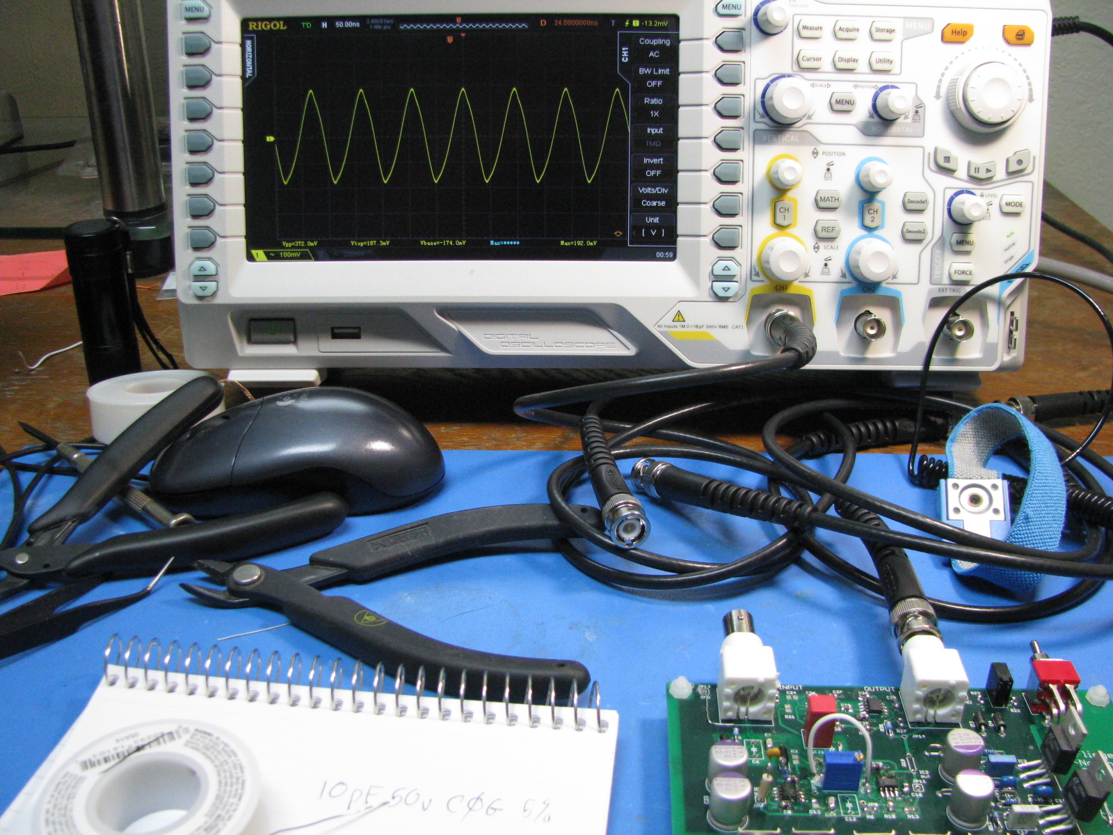

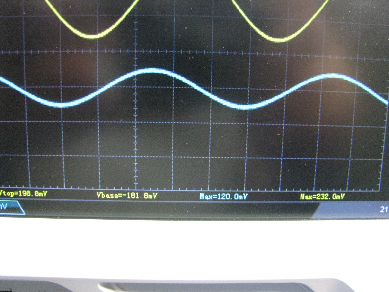

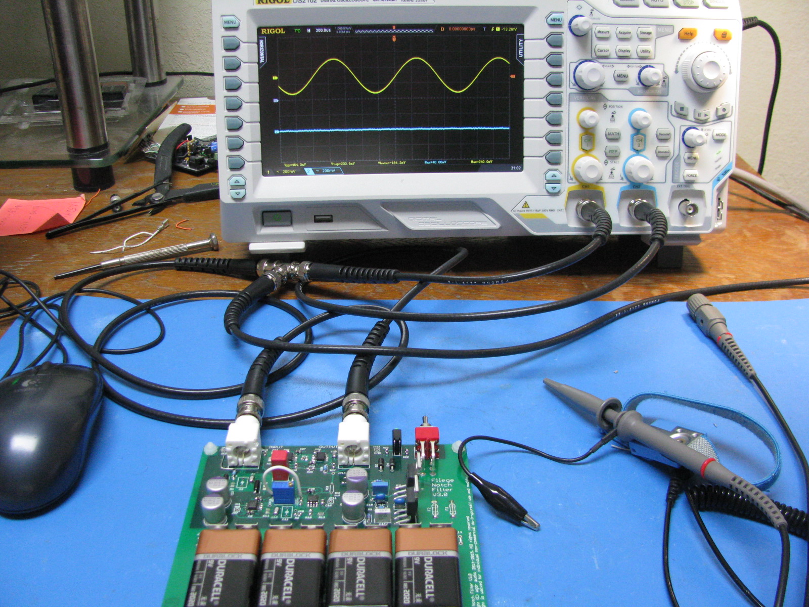

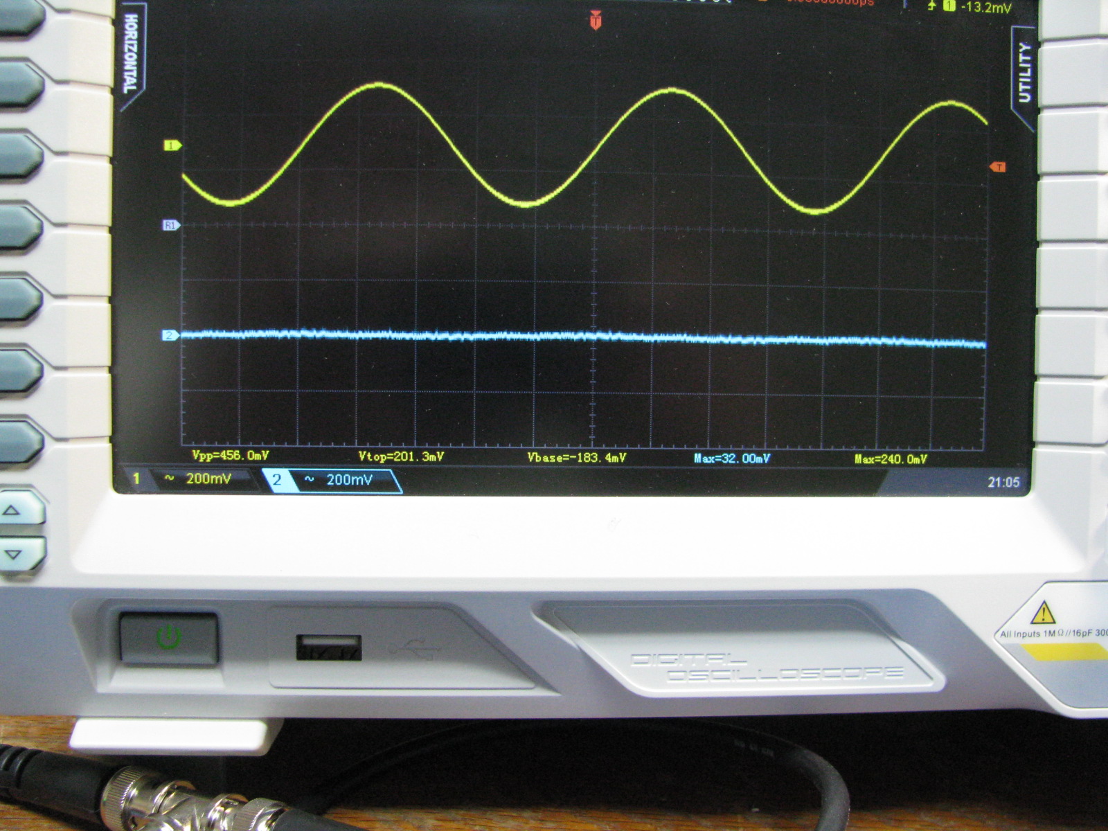

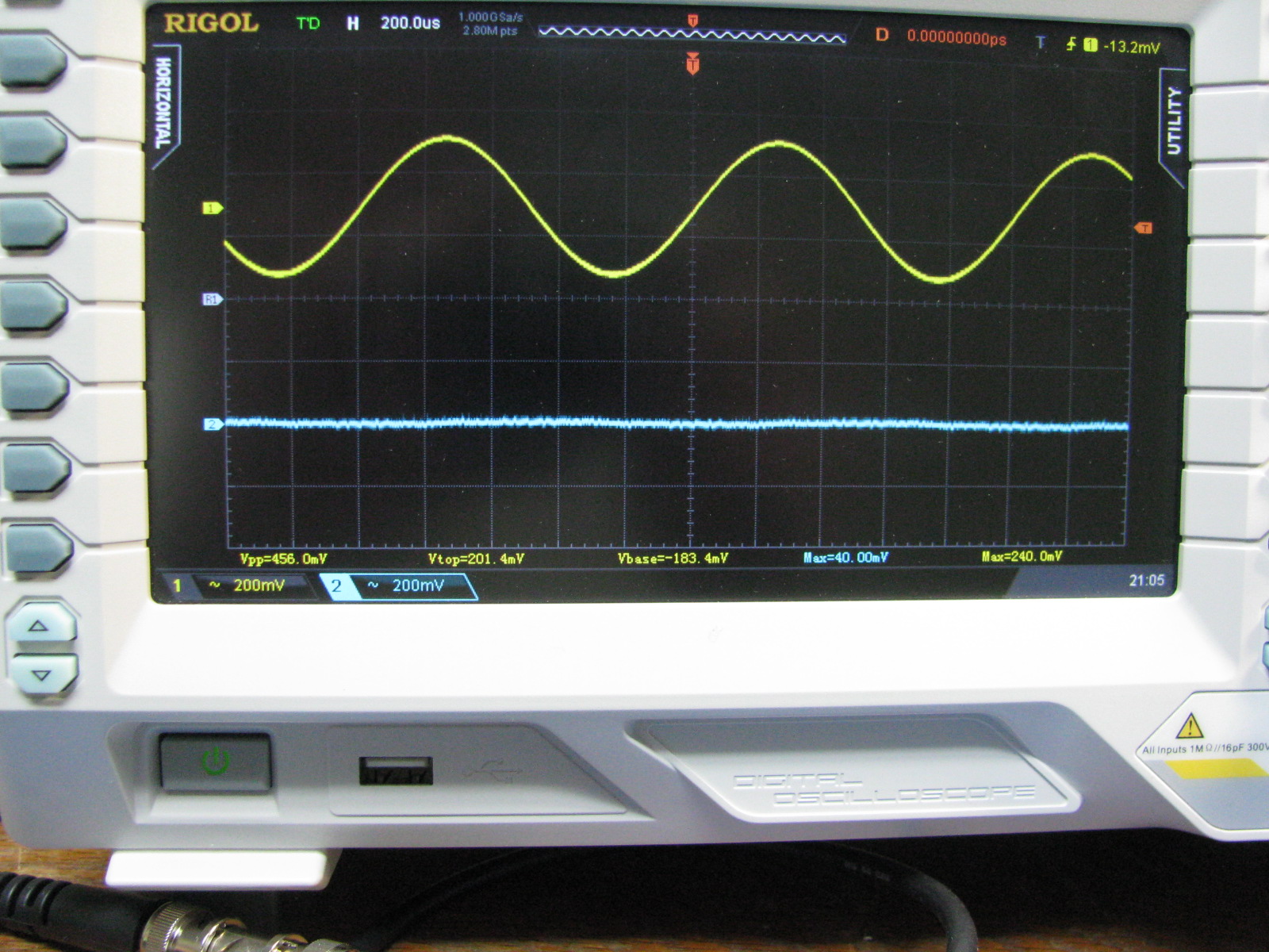

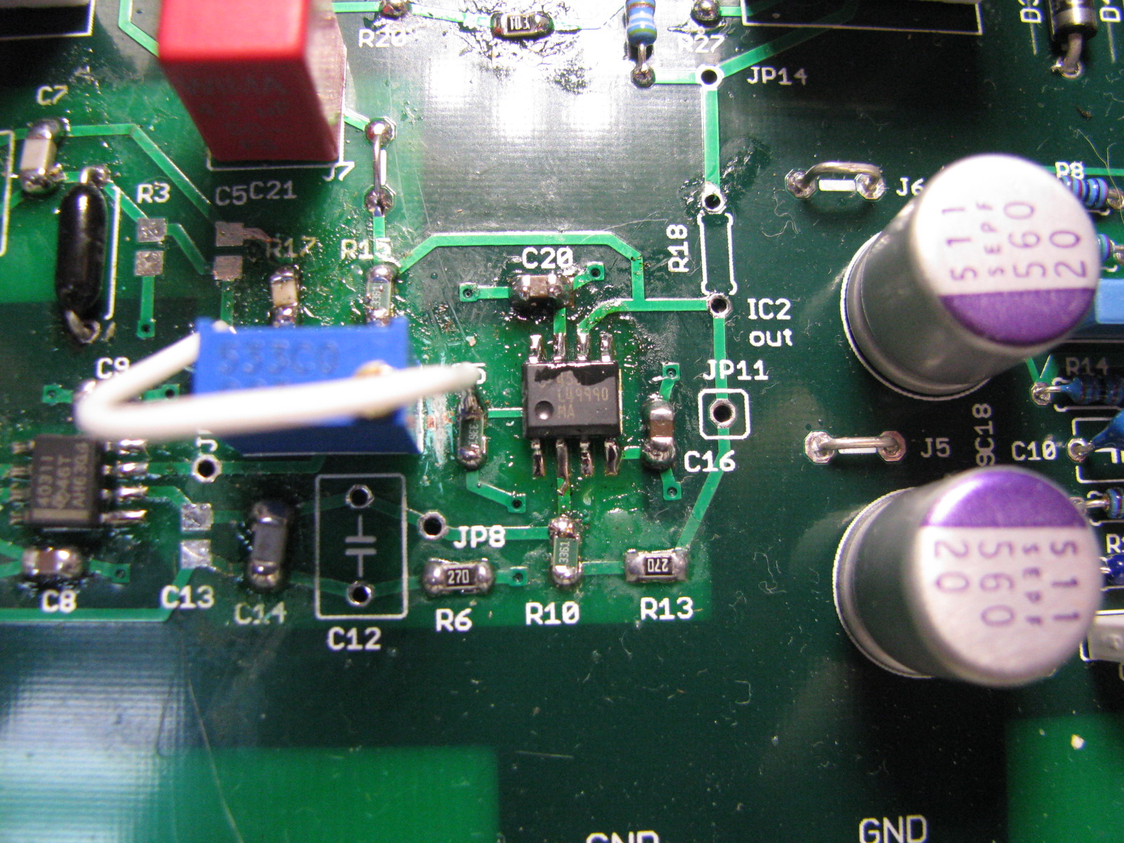

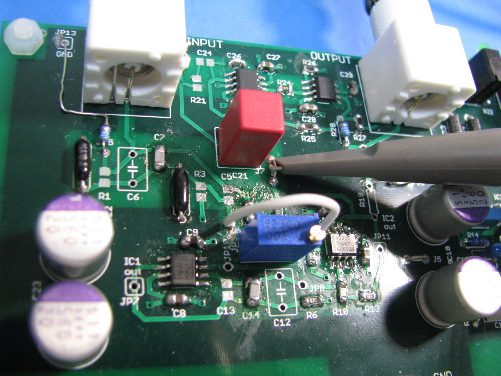

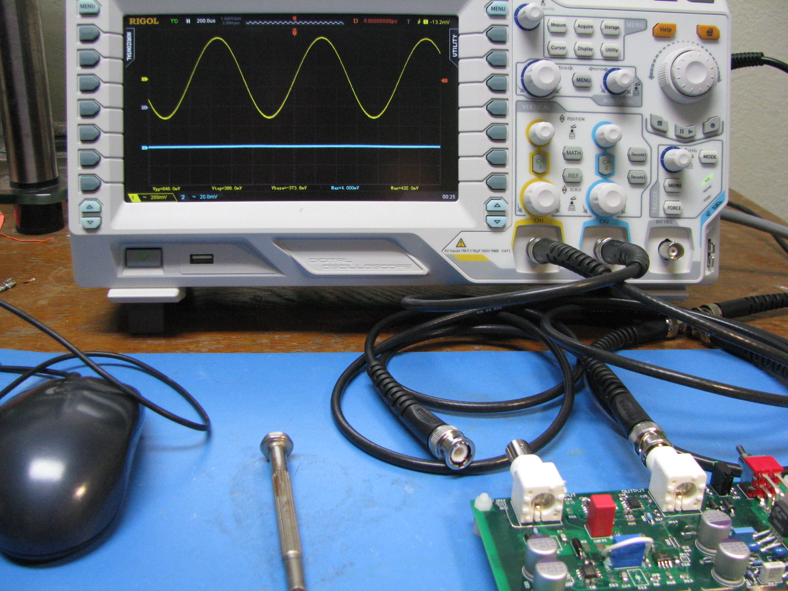

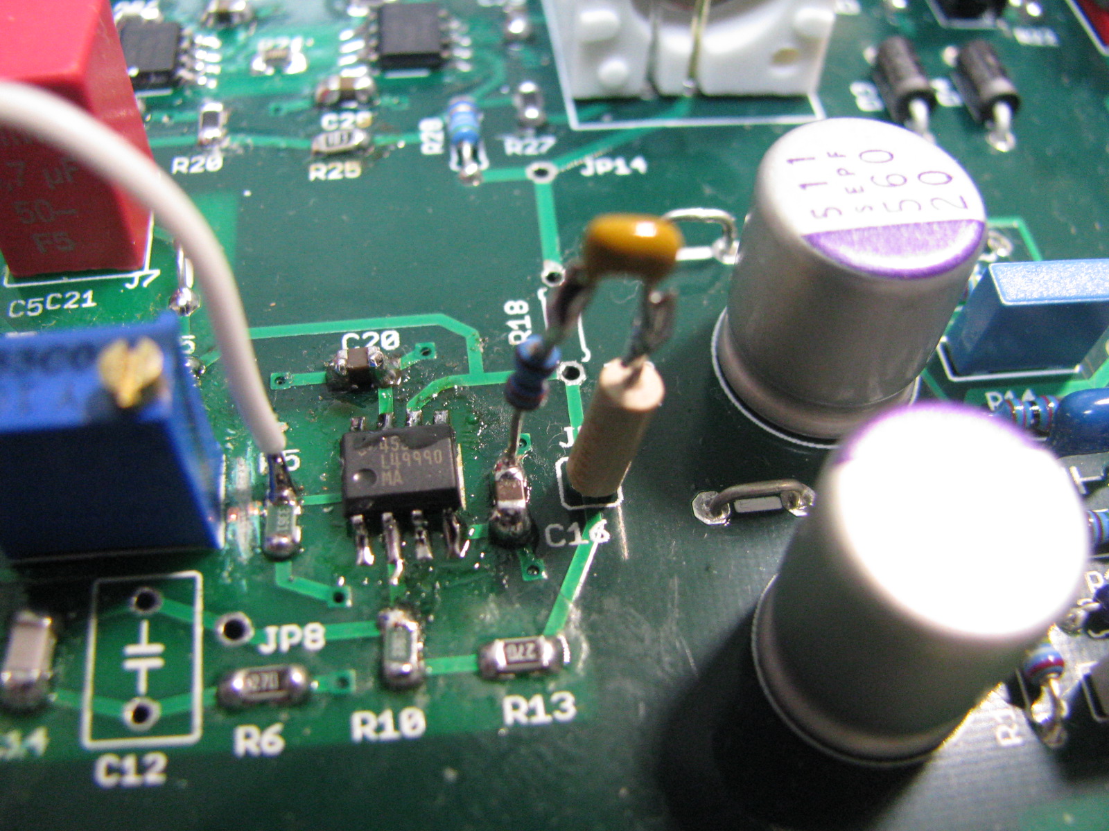

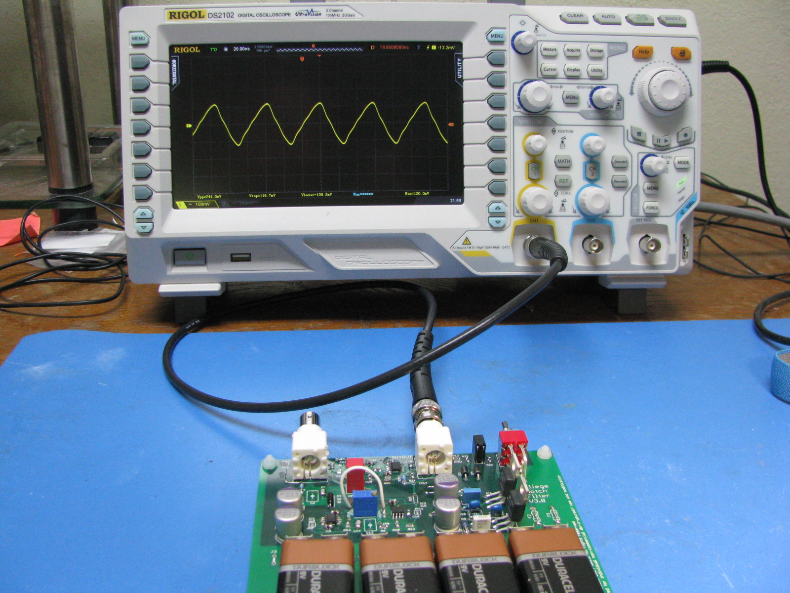

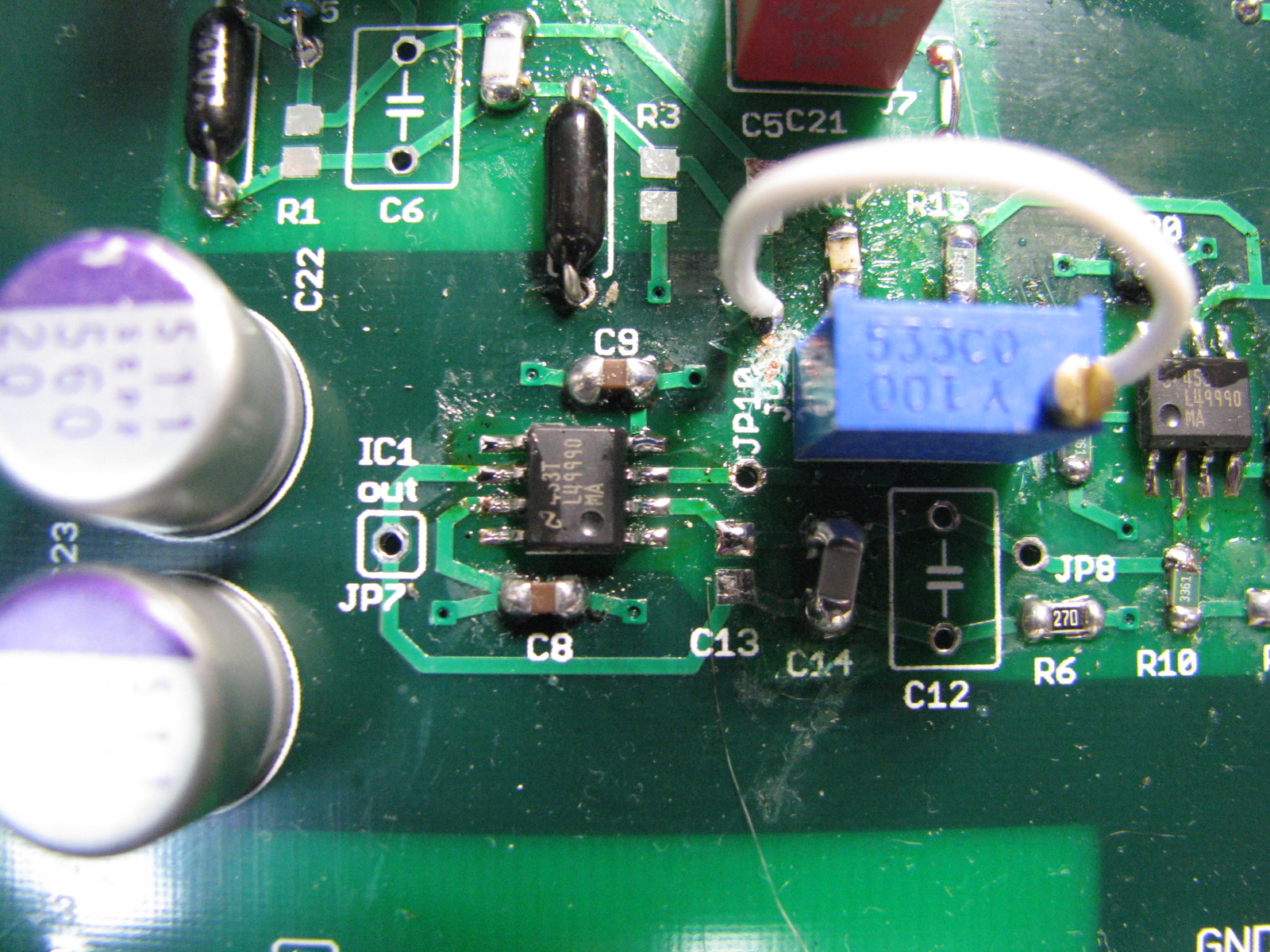

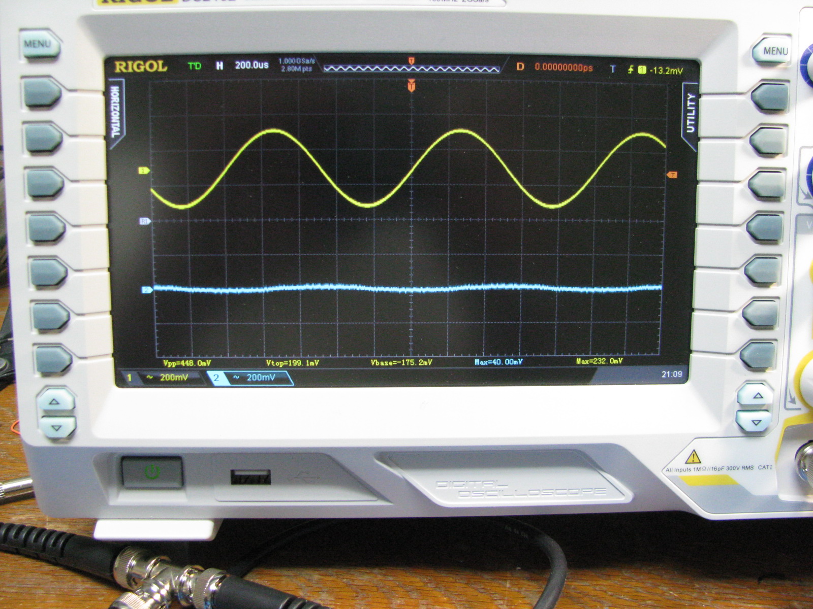

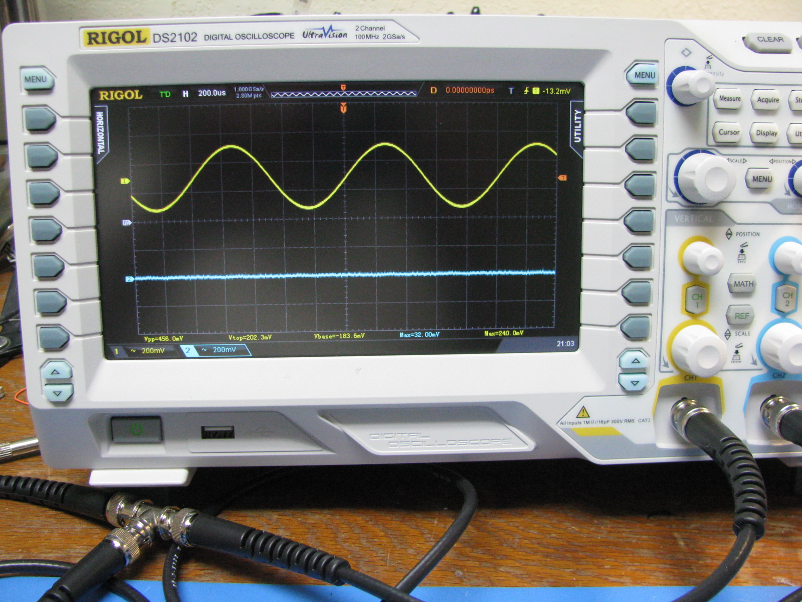

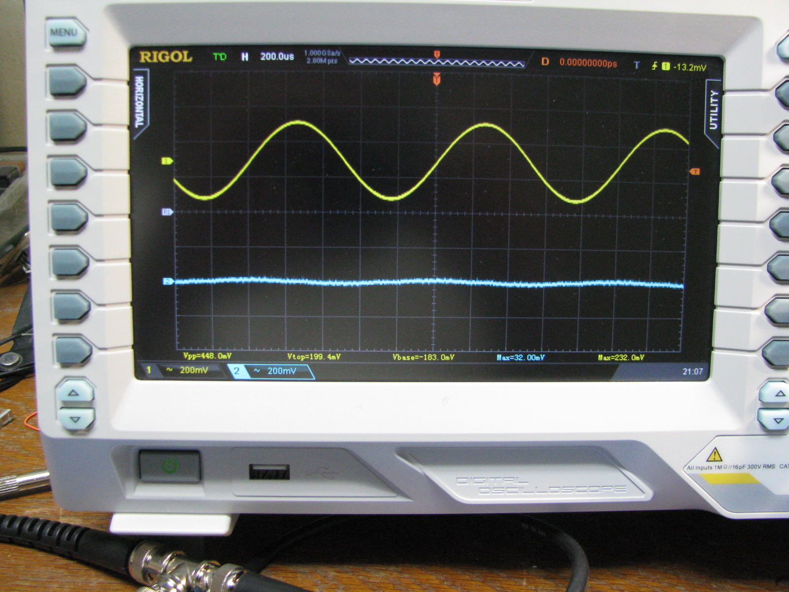

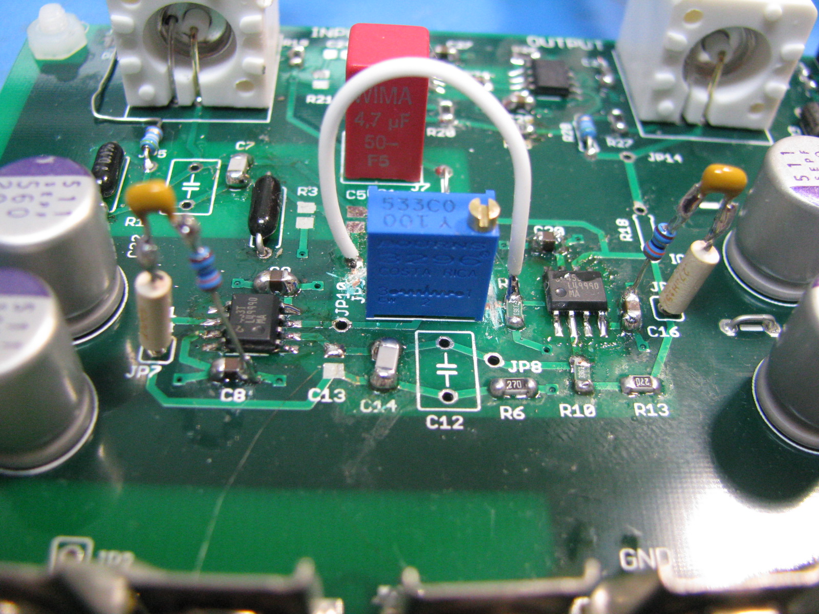

10R trimmer, 5x and 20x post-amp, -54dB notch part 1
I had some time today to mess with the V3.0 board with the two single op-amps a bit more, still with the THS4031's in place.
I swapped out the 50R trimmer for a 10R trimmer to give more fine-adjust rangle. Works great. I now am able to go about a full turn in each direction back and forth at the bottom of the notch (25 turn trimmer) to fine-tune the notch.

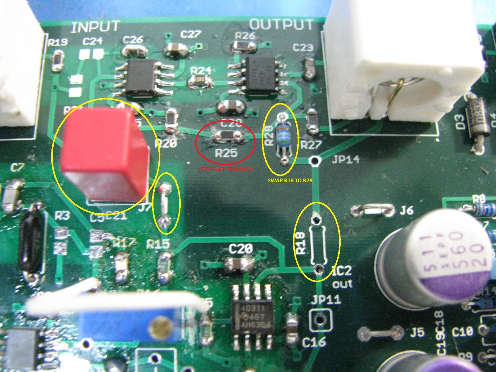

I've hooked in the post-filter-amplifier to boost the notch filter output and help find the exact notch depth through the scope noise (and EMI, the board is still not in a shielded box). That also worked great. From the photos below, with a 20x voltage gain after the notch filter, it now appears the notch is actually -54dB real-world, vs. the sim of -73dB. If the AD8397 adds to that (sims at -92dB) that may be somewhere around -70dB!
* The first two photos 3932 & 3933 are the test setup. The signal generator is the top yellow trace again while the notch filter through the post-filter-amp is the bottom blue trace. Turns out the generator can do 1/10Hz and 1/100 Hz increments. The trace in this photo is with 1.00000KHz and 200mV/div on both scope traces.
* The next photo 3935 shows what I did to hook in the post-filter-amplifier. The 49.9R resistor R18 that was in series with the filter output to the out BNC connector is moved to previously-blank R28 position, which is the output of the amplifier. This breaks the direct link from the notch filter output to the output BNC (R18) and connects the amplifier output instead to the output BNC (R28). This is why I used through-hole for these two resistors, just makes it easy to get them out with the vacuum desolderer.
On the input side the jumper J7 and blocking capacitor C21 are installed to forward the notch filter output to the amplifier input. Jumper J7 also makes a handy place to hook a scope probe, as shown below, when verifying amplifier gain. 🙂 The OPA140 + BUF634 non-inverting amp has 2.49K and 499R gain set resistors (2.49K is the feedback resistor), so 2490/499 = 5x voltage gain to start. Later in the photos below I swap out the 2.49K R25 for a 10K to give 20x voltage gain. With C21 in now the resulting output has just the 30 microvolts or so from the OPA140 + BUF634 combination. Completely eliminates the mV level offset from the notch filter's THS4031 chips.

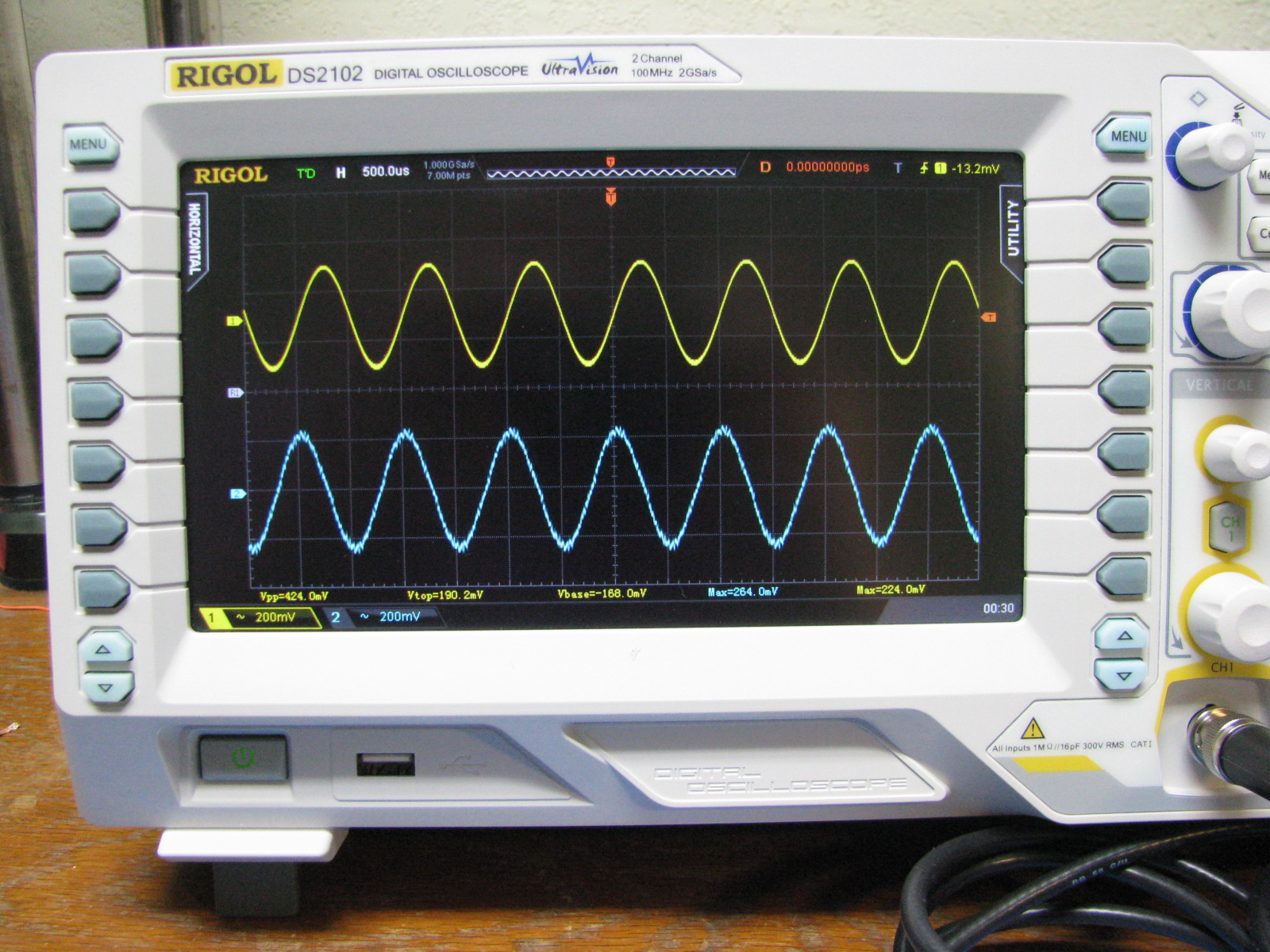

* 3936 and 3937 are 1.00010KHz and 0.9999KHz. This answers the good question that came up previously about what happens with 1/10Hz variation, rather than the 1Hz minimum I did previously. I also tried 1/100Hz variation, but it was just too small to record any useful visual change in the notch. The 1/10Hz here is visible though. Kind of hard to tell in the photo, but in varying the generator frequency back and forth from 1.00010KHz to 1.00000KHz the slight sine wave is definitely there. Glad that suggestion came up! So moving +/- 1/10Hz off from the notch center frequency does start moving you out of the notch well bottom, but +/-1/100Hz doesn't to any (visible) significant degree.
* 3938 & 3939 are 1.00030KHz and 0.99970 (+/- 3/10Hz).
* 3940 * 3941 are 1.00100KHz and 0.9990KHZ (+/- 1HZ). Now this is the same frequency variation I posted photos of previously in post #10 above, the 4th and 5th photo. BUT... here the notch output is going through the 5x voltage gain amplifier. The scope in these two photos (blue trace) and the one previously are on 200mV/div. Compare the two pairs of photos and the 5x voltage gain shows right up.

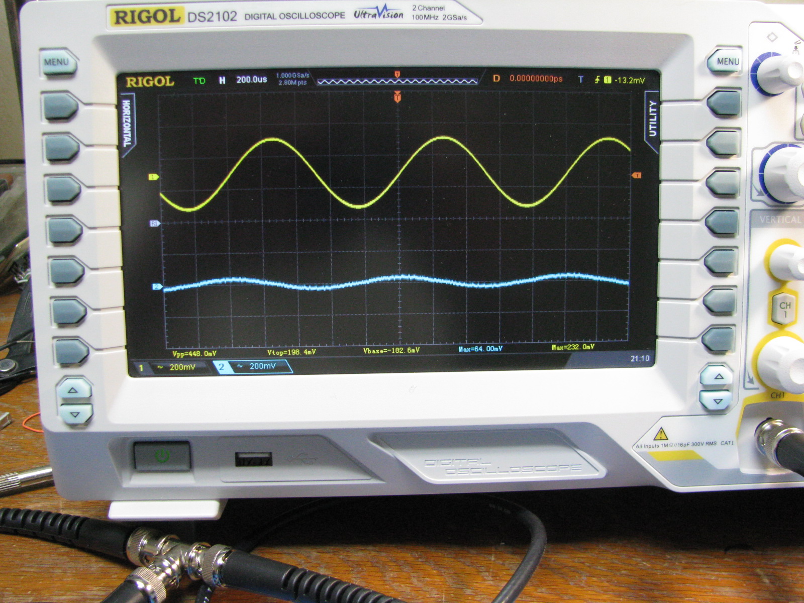

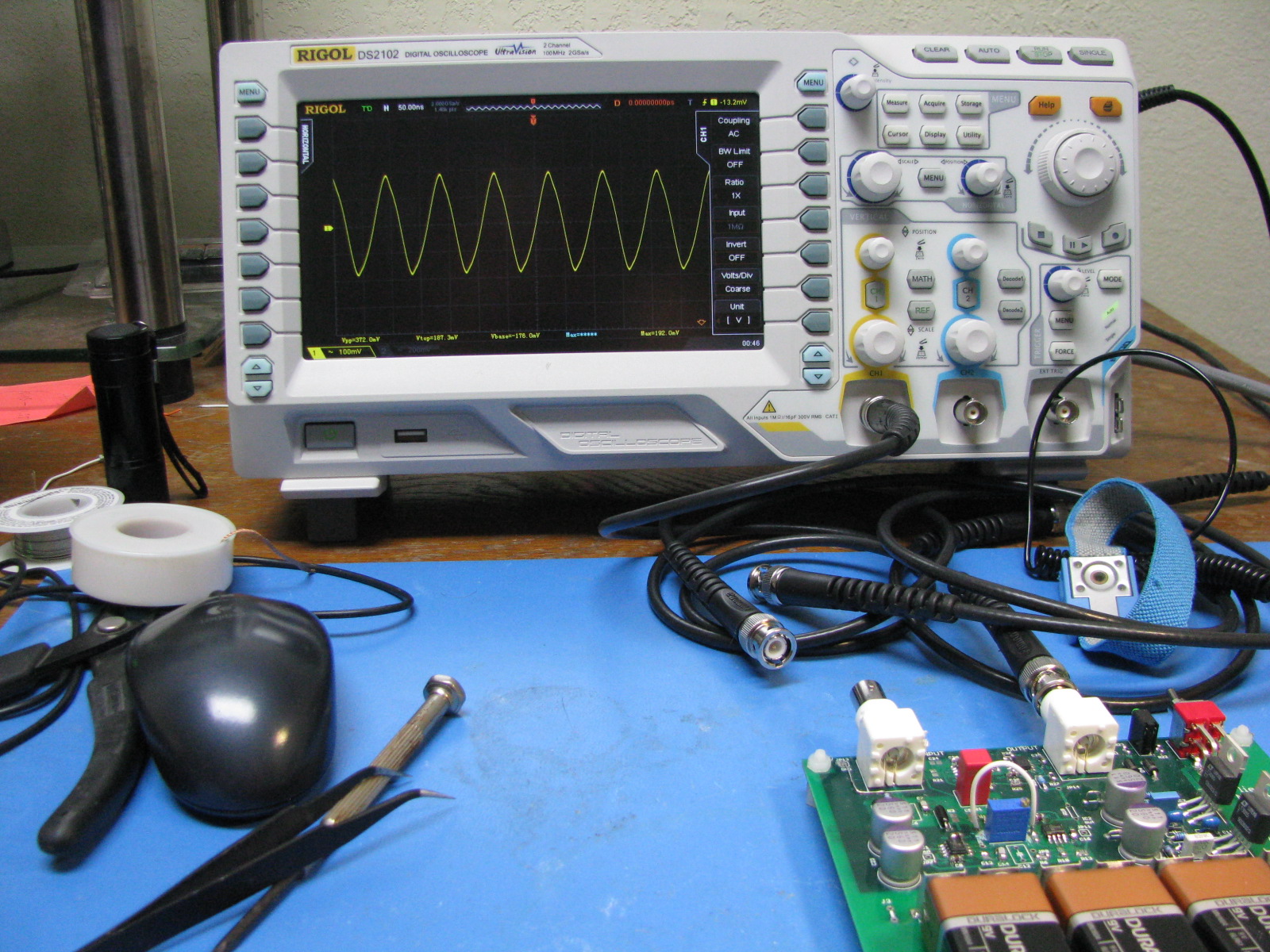

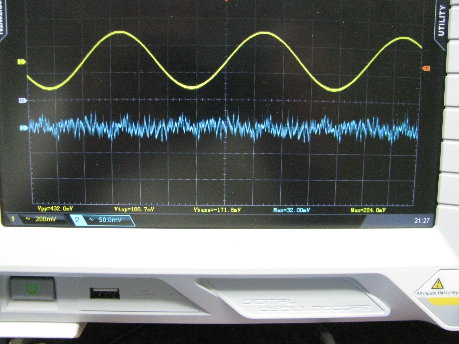

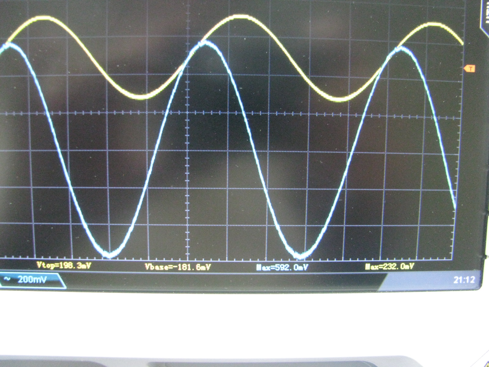

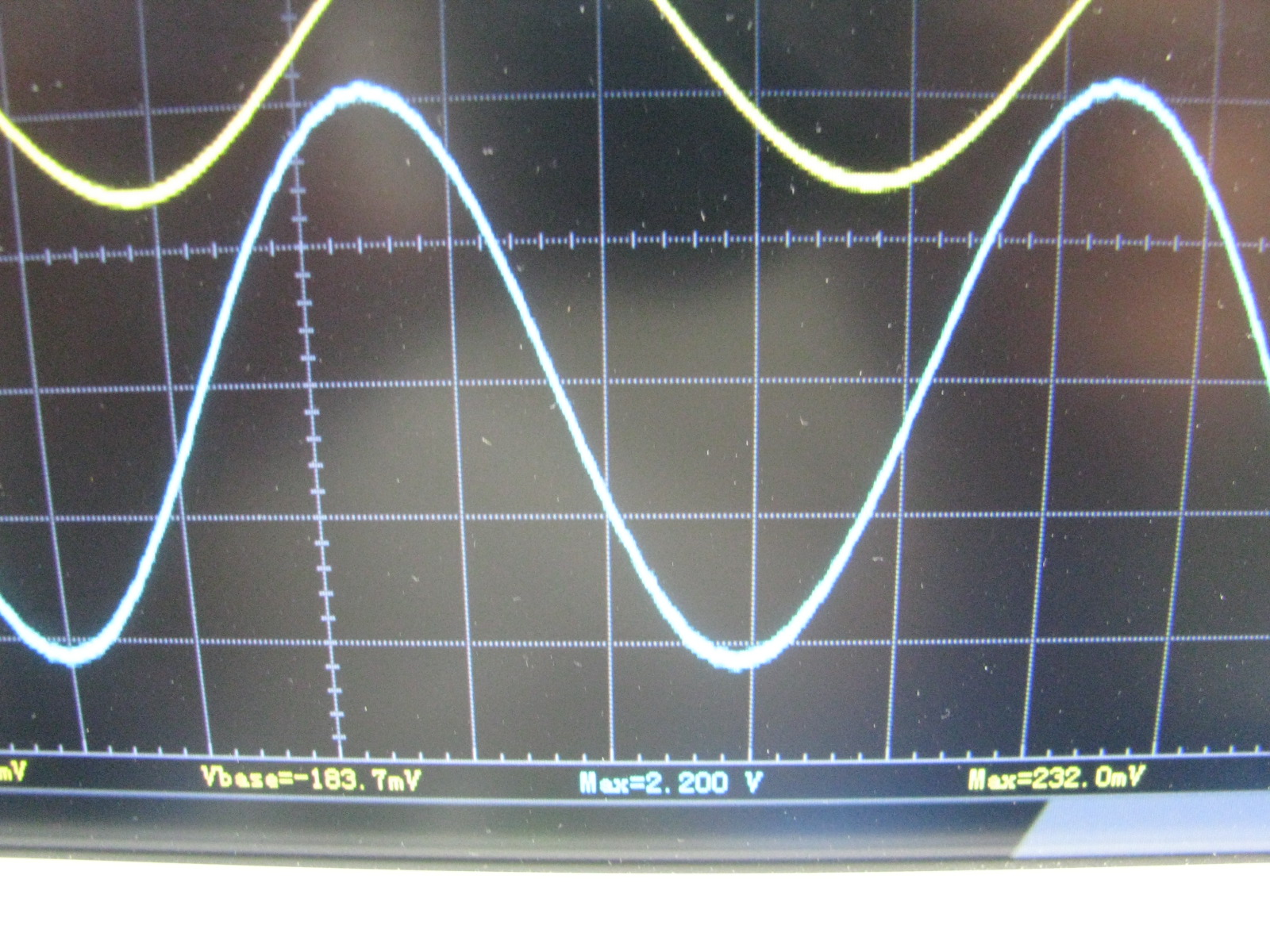

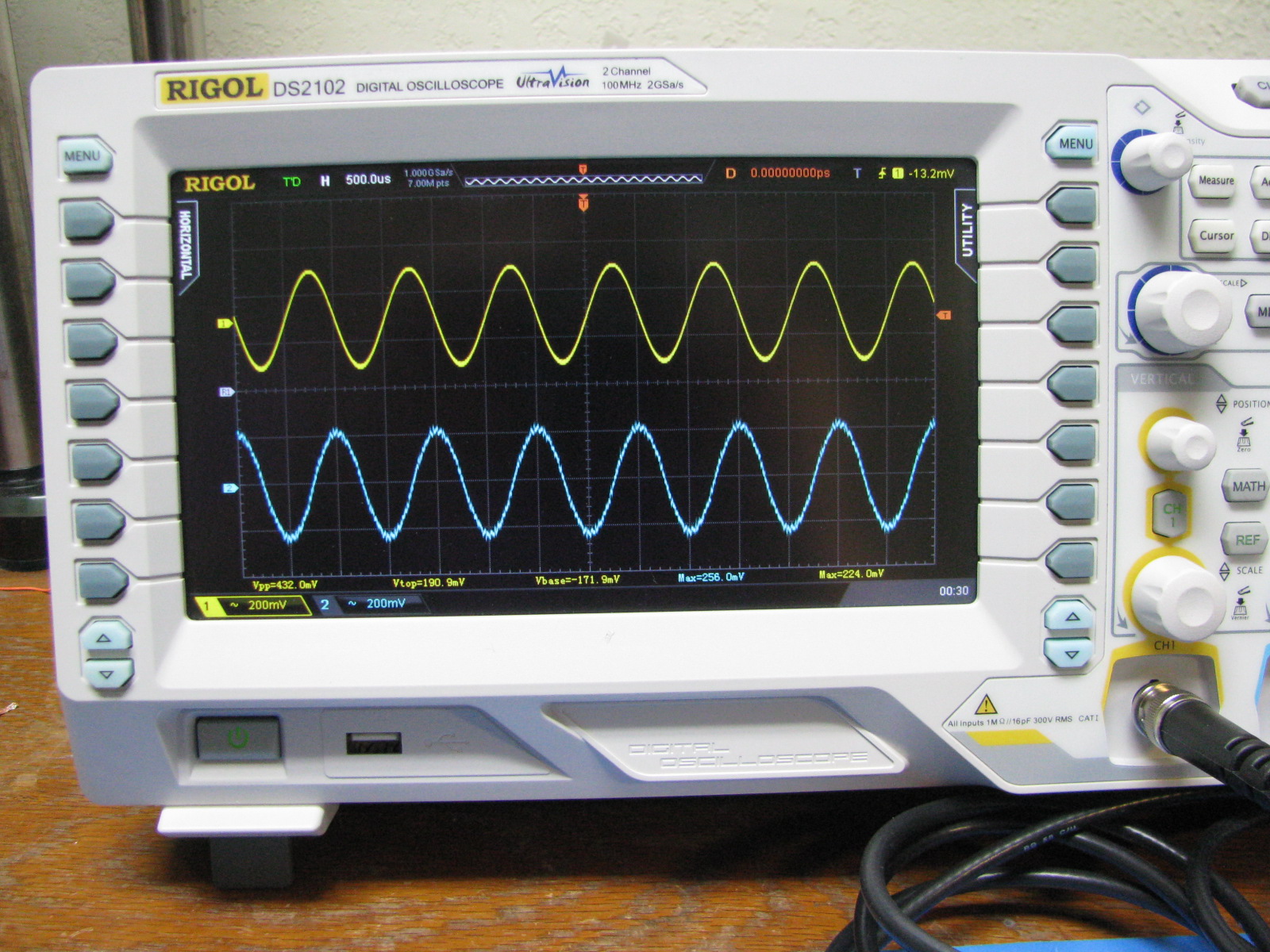

part 2, 18.3x gain -52dB notch
I ran out of photo slots in the post above. 🙂 Part 2. Above I assumed 20x voltage gain for a -54dB notch. Here it measures to be 18.3x, which calculates to a notch depth of -52dB.
* The first three photos show a measured confirmation of the voltage gain of the OPA140 + BUF634 post-notch-filter amplifier. The first photo is the output of the amp (blue trace), what is on the board's output BNC jack going to the scope. In blue, below the blue trace, you can see the scope has measured a peak of around 592mV. It actually bounced back and forth between 600mV and 592mV, so I'm going to use 600mV here to make things easy. I've changed the signal generator for these photos to 1.02000KHz to allow a sine wave to show up for the voltage gain measurements.
In the second photo I'm measuring the input to the amplifier, which is the output of the Fliege notch filter, at the point on the PCB shown in the 3rd photo. Here I've just replaced the second scope input with a probe and latched it onto J7. The scope now calculates 120mV peak. Doing the math gives 600mV/120mV =5x voltage gain, as expected. At at this point I've just realized I said the wrong thing in the previous post, the feedback resistor I built it with here is 2K rather than 2.49K. (1 + 2K/499R) = 5x for the non-inverting stage. 2.49K is R27 the minimum load resistor (to ground) on the output that I like to have on these op-amp plus buffer loops.
* 5x voltage gain turned out to still be insufficient to see the bottom of the notch well while vaying the generator frequency back and forth +/- 1Hz (and +/= 0.1Hz now). So I bumped it up to 18.3x in the next photo. 2.2V / 120mv = 18.3x .
* In the final two photos I've set the signal generator back to the 1.00000KHz notch frequency, now with the 18.3x voltage gain applied tothe Fliege notch filter output. The first photo is with 50mV/division on the scope while the second is with 20mV/div. It is hard to tell from that 20mV/div photo, but by varying the frequency trimmer back and forth the minimum notch bottom output I can obtain appears to be around 10mV peak, with the 18.3x voltage gain applied. With the 220mV peak input signal from the generator (still the yellow trace on the scope) that should give somewhere around (10mV/18.3)/220mV = 0.002484 which is -52dB.

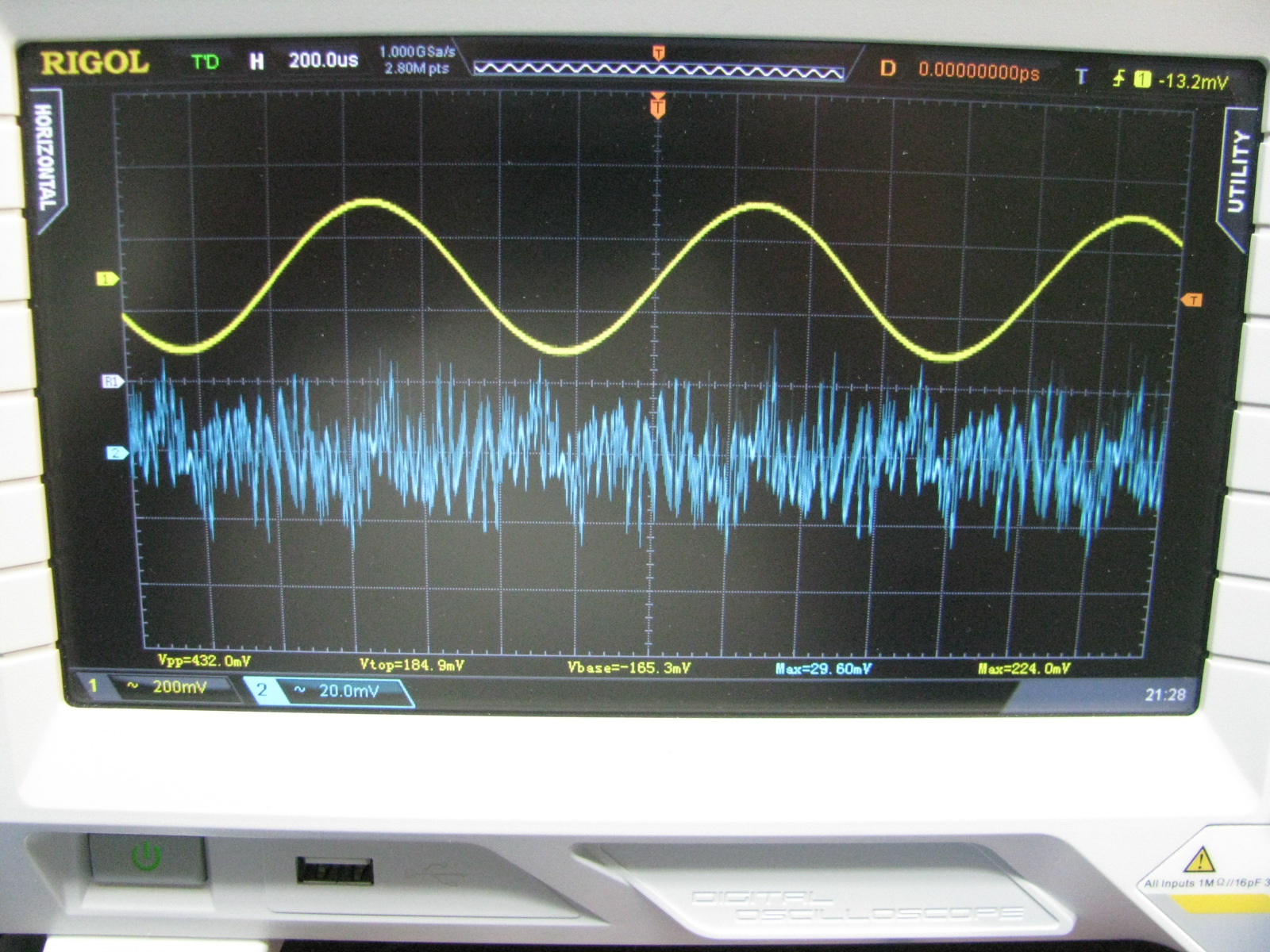

LME49990 swapped back in, plus datasheet output comp network
Hey guys, thanks for the comments! I'll read through tomorrow (midnight here now). 🙂

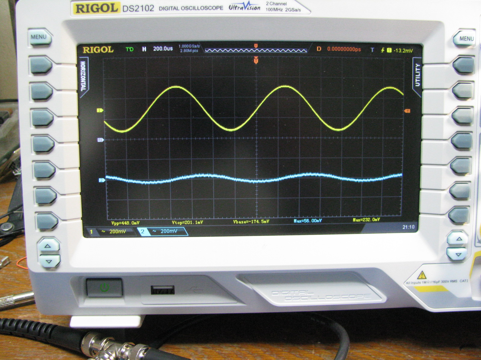

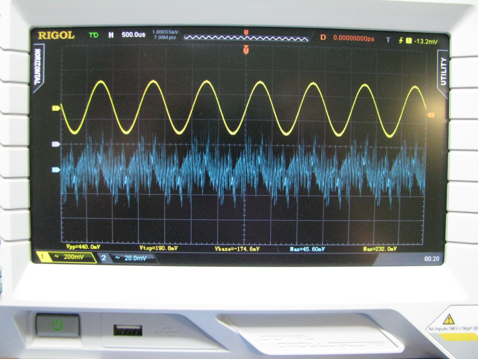

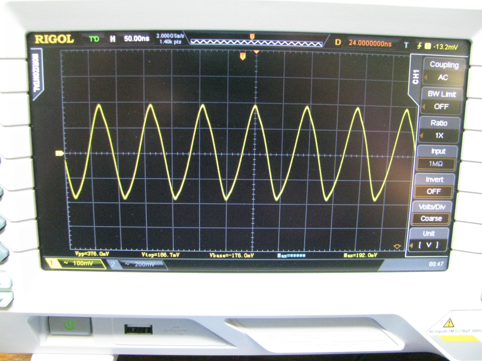

So now that V3.0 works well with the THS4031 chips I couldn't resist swapping the LME49990 back in, one at a time, to see what happens. I also wanted to try out that LRC output compensation network the LME49990 datasheet shows.
The results: swapping out IC4 in the schematic (the rightmost Fliege notch op-amp, the one driving the trimmer pot) from THS4031 to LME49990, it (still) works! Pictures below. No oscillation, but no change in notch depth either. No worse or no better. I've been hoping the LME49990 would be slightly better than the THS4031, in notch depth and/or THD.
Then I tried swapping out the other Fliege notch op amp, the leftmost one with the 0.047uF from output to inverting input (both Fliege op-amps now the LME49990 again). Oscillation! Boatloads of it, photos below. About 375mV p-p at 11.1MHz. Then I tried adding the datasheet LRC network (33R + 10pF + 0.27uH) first to the output of the leftmost op-amp, then another to the rightmost one. No change in the oscillation at all. Same amplitude, same frequency. National's "mystery" output compensation network, whatever it was intended to fix, doesn't fix this problem.
Photos:
* The first photo 3951 shows the rightmost THS4031 removed and replaced with a LME49990 again.
* The next 3952 shows the result (notch well bottom), essentially the same as before with the two THS4031s installed. This is on 20mV/div again on the scope with the notch filter output going through the 18.3x voltage gain stage, as per the post above.
* The next 3 are an oscillation check. Here the input to the Fliege notch filter is disconnected (that leftmost BNC unhooked), leaving the on-board 49.9R to ground on the input. The bottom blue trace is still the output of the notch filter, run through the 18.3x voltage gain stage. The upper yellow trace is the signal generator, but that isn't going anywhere right now. It is just the bottom blue trace here that matters, looking for oscillation.
All 3 photos are with 20mV/div vertical on the scope. The first photo 3954 is with a 200uS time base, the second with 10mS, and the third with 2uS. No oscillation anywhere. Again, this is a THS4031 for the left op amp and a LME49990 for the rightmost.
* The next two, 3958 and 3959 just show the notch filter still works correctly with the THS4031 + LME49990 pair. This is 2Hz off the notch center in each direction (one is 999Hz and the other 1002Hz), plus run through the 18.3x voltage gain stage.
* The next one shows the leftmost THS4031 now swapped back to a LME49990. Then the next two show the result (bottom blue trace) - oscillation! 🙁 In that last photo I've now switched over to using just one channel on the scope to get a better look at the oscillation, with the notch filter + 18.3x gain going to the single yellow trace. On this particular scope going single channel doubles the sample rate. 376mV p-p according to the scope, and 1.8div * 50nS/div = 11.1MHz.

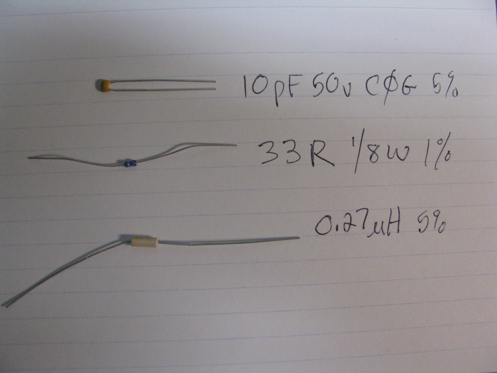

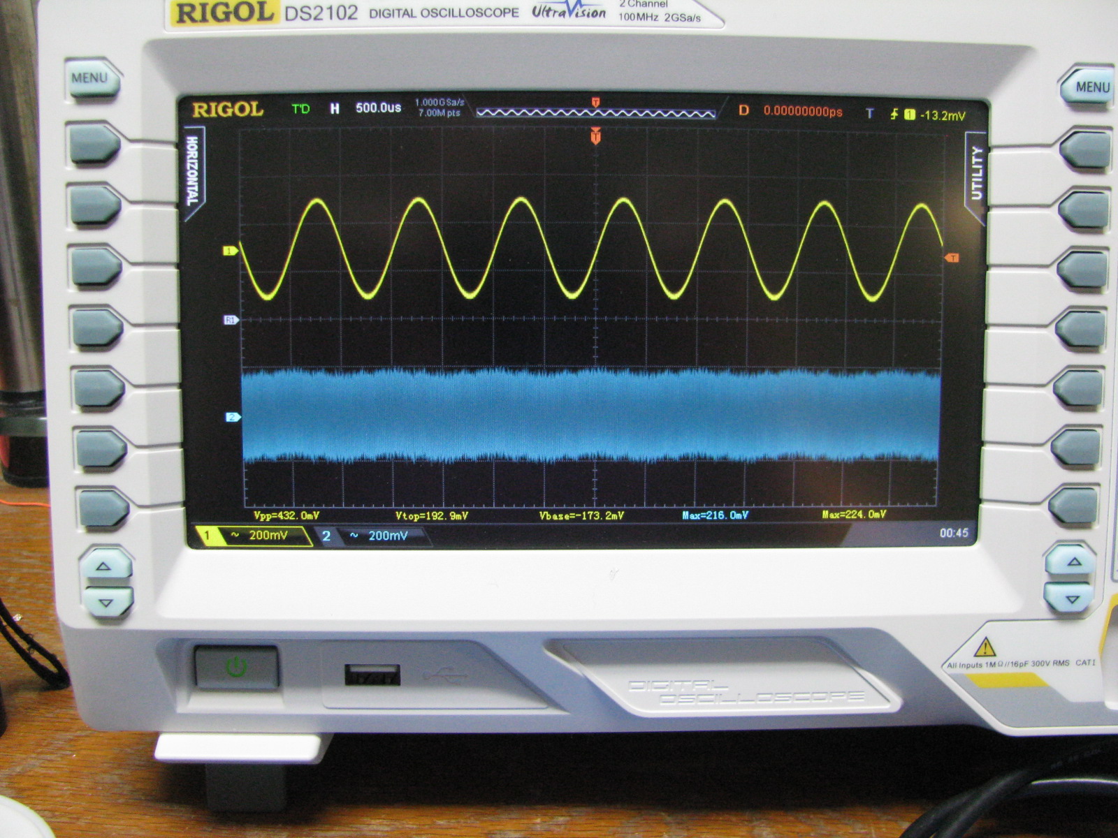

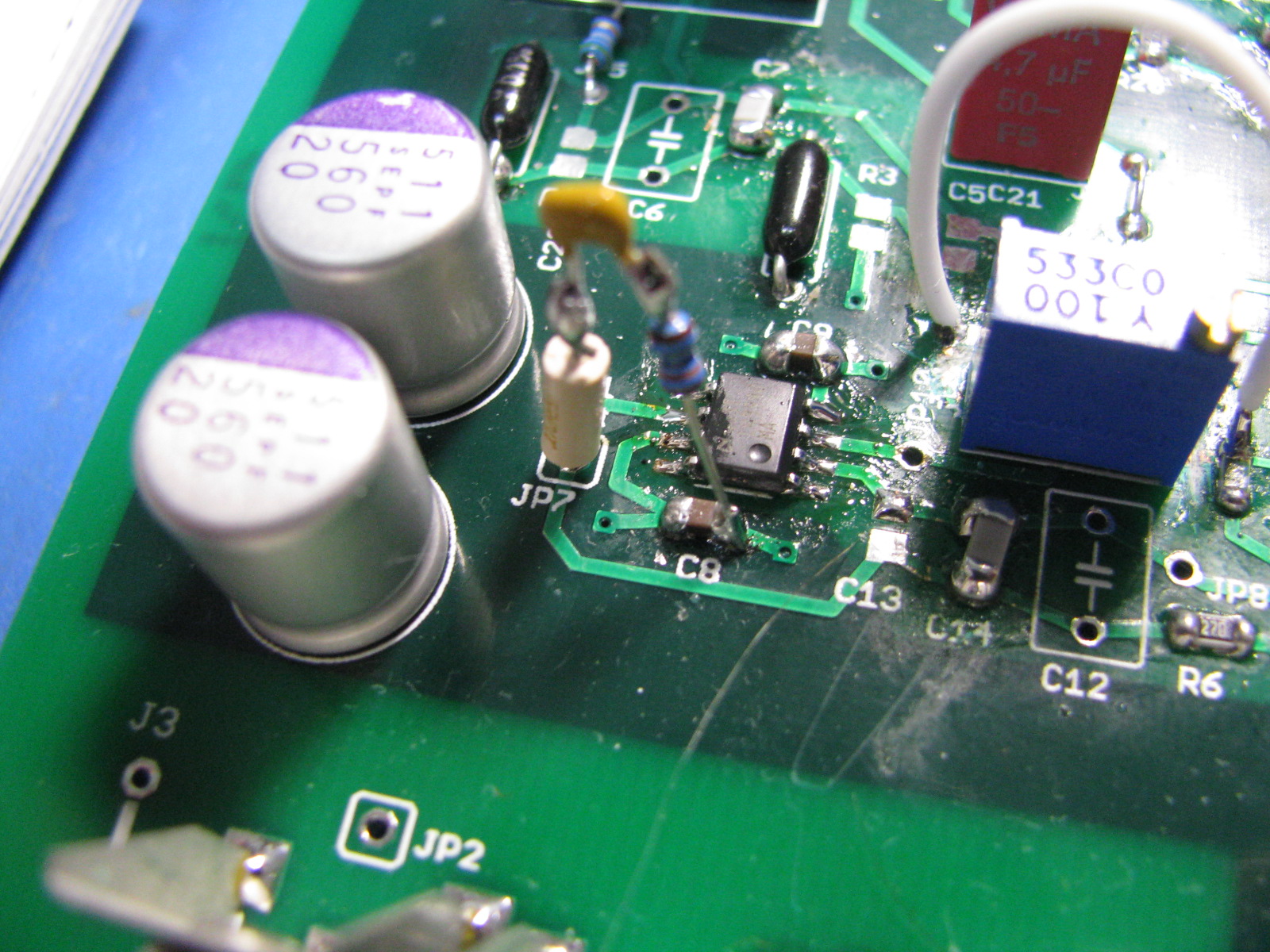

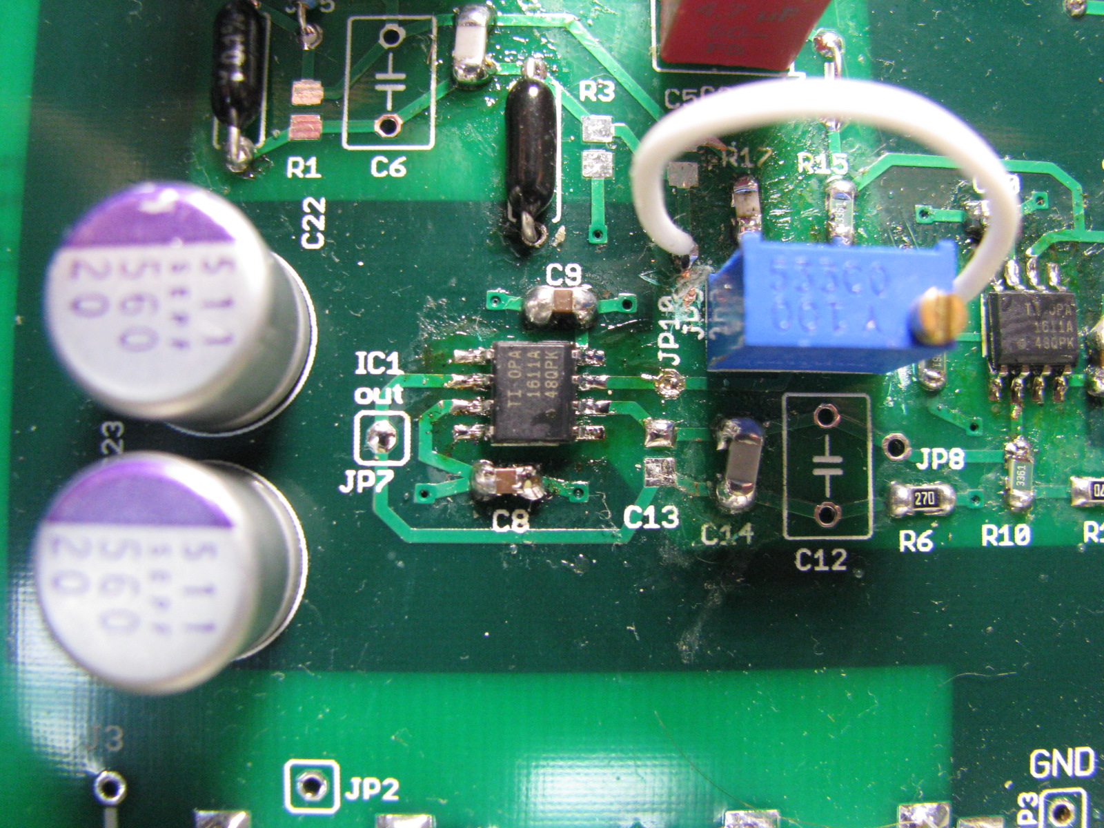

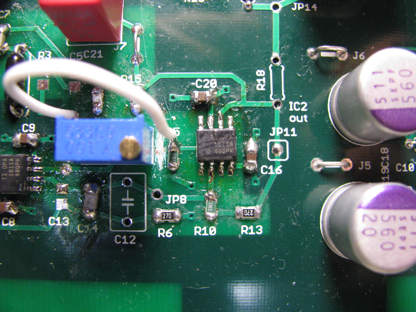

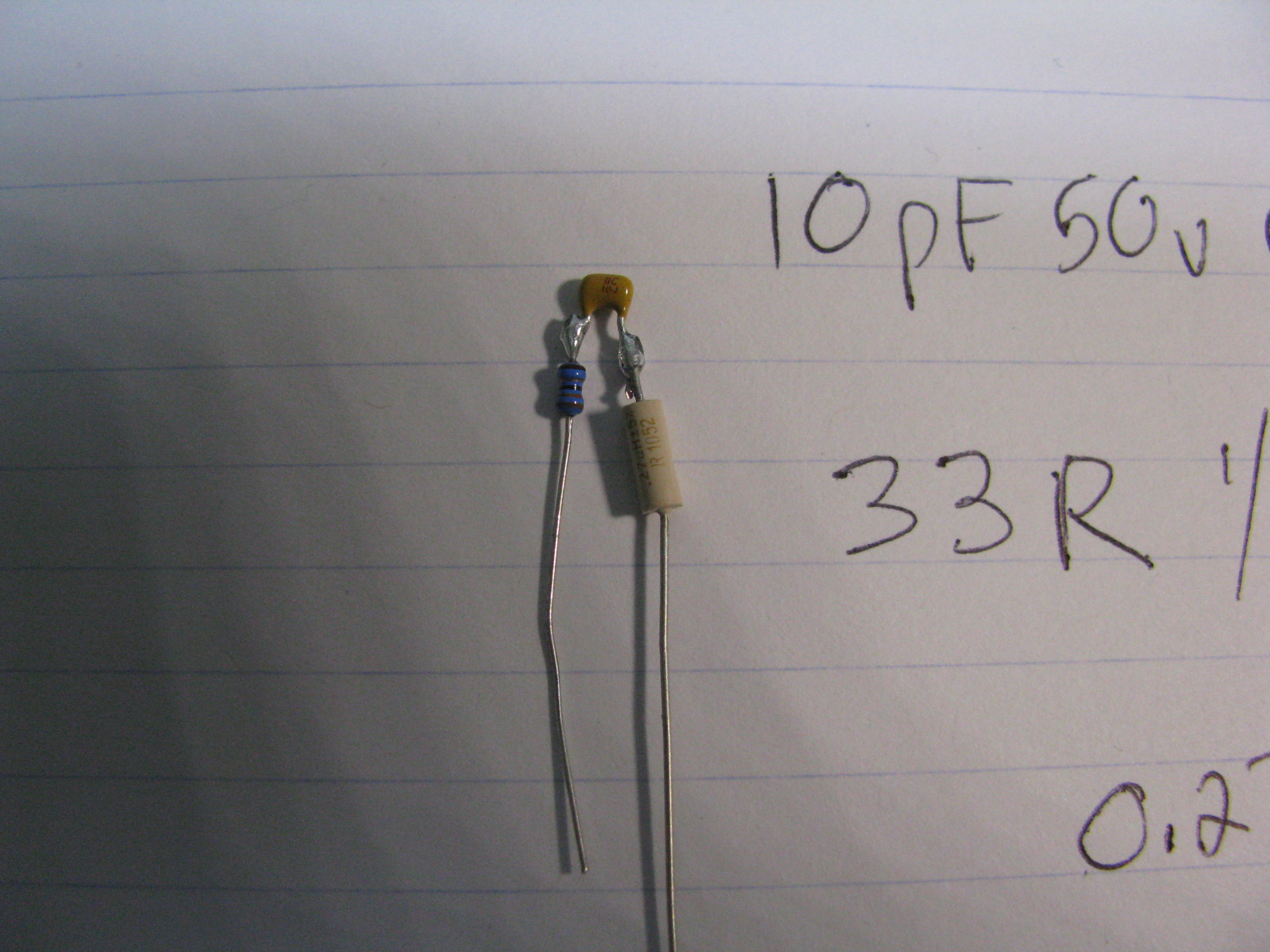

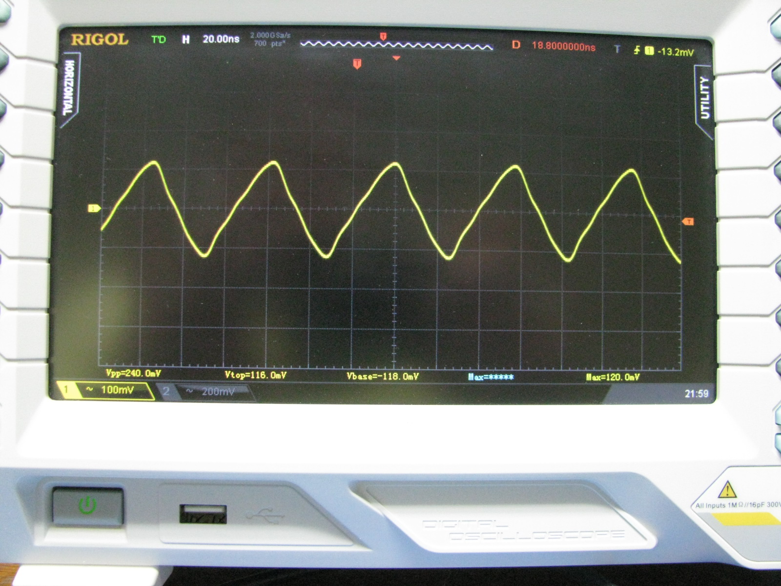

LME49990's swapped in, plus National's output compensation nework, part 2
Part 2 of the above post, ran out of photo slots again. 🙂
* 3965 is a close-up of the oscillation. A somewhat-distorted sine wave.
* 3966 and 3967 show building the ouput compensation network. These are the exact values that National shows in the LME49990 datasheet. 3968 shows the network installed between the output and ground for the left-most Fliege notch op-amp. Lol, when I put that hole JP7 on the chip output line this test is what I had in mind.
* ...and the result in 3969. Same oscillation. No change at all in amplitude or frequency. That compensation network didn't hit a nerve. You can see the compensation network installed in the photo. The notch filter input is still disconnected, of course.
* The next two photos show another copy of the network installed between the output and ground for the right-most op-amp. National's network is now on both op-amps. The result is in 3972: same oscillation. No improvement of any kind.
So.. I'm back to having no idea at all why the LME49990 op-amps here don't work in the Fliege notch filter, but the THS4031 do. Interesting that one LME49990 + one THS4031 did work, but two LME49990 didn't. Either the leftmost op-amp position is the one with problems or there is some odd feedback/oscillation going on between the two LME49990 chips, when both are used.
I guess if I was going to mess with it further the next thing to try would be adding 20R to so in series with the output of each op-amp, to help isolate output capacitance, figuring that might be a likely cause. But series output resistors may affect the notch frequency or depth (haven't tried to simulate it yet). Since the THS4031 works there isn't much reason to continue trying to get the LME49990 to work, especially since it is now officially discontinued by National.
The thing I would like to see now would be the results with that AD8397 dual chip. 🙂

OPA1611s oscillate the same way the LME49990s do!
Well as luck would have it I had some OPA1611s on hand. I've just swapped out the two op amps in the V3.0 Fliege notch filter and... oscillation! Very similar to what happened with the two LME49990s in the circuit. Photos below. I removed those two LME49990 datasheet output networks before soldering in the OPA1611 chips.
OK, I think that I know what is going on here. It is simply a phase margin problem. The LME49990 datasheet is one of the few I've seen without an open loop gain/phase plot in it. But I've been studying the THS4031 phase plot vs. the OPA1611 and there is a huge difference. I think to make this thing work with op amps other than the THS4031 it may be necessary to develop a math model for the Fliege and potentially add a zero to cancel a pole somewhere, hopefully without messing with the notch.
At this point I would say go with the Twin-T! If I'm right about a phase margin problem here the Fliege notch filter may wind up being more part-specific to iimplement. The various posts I've seen about the twin-T don't seem to be running into these stability problems in using different op amps. Otherwise, if you are implementing a Fliege notch filter, stay with the THS4031!
Photos:
* The first two are the OPA1611's swapped into the Fliege notch circuit.
* The next two show the oscillation. This is with the filter input BNC disconnected, so 49.9R to ground on the input. The filter output is still going through the 18.3x voltage gain output amplifier here. The frequency appears to be around 16.7MHz. The amplitude is 200mV p-p / 18.3 = 11mV p-p.
Photos:
