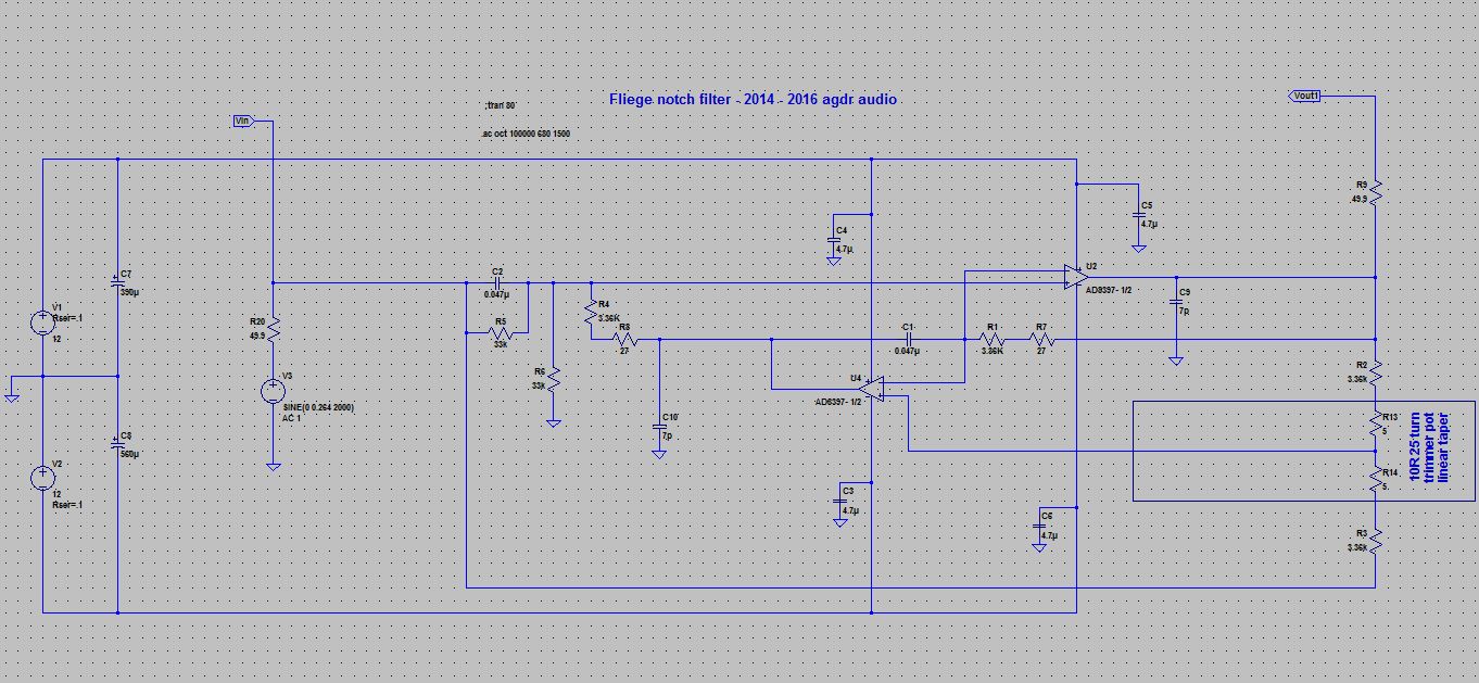

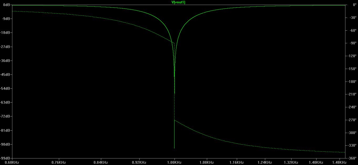

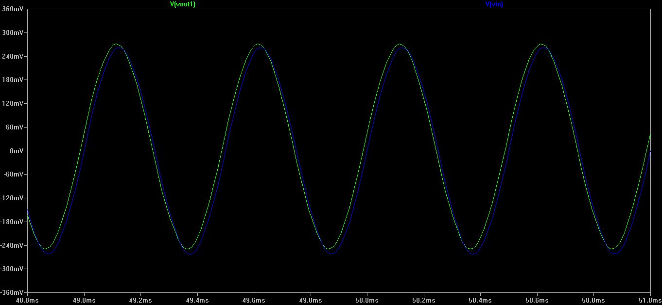

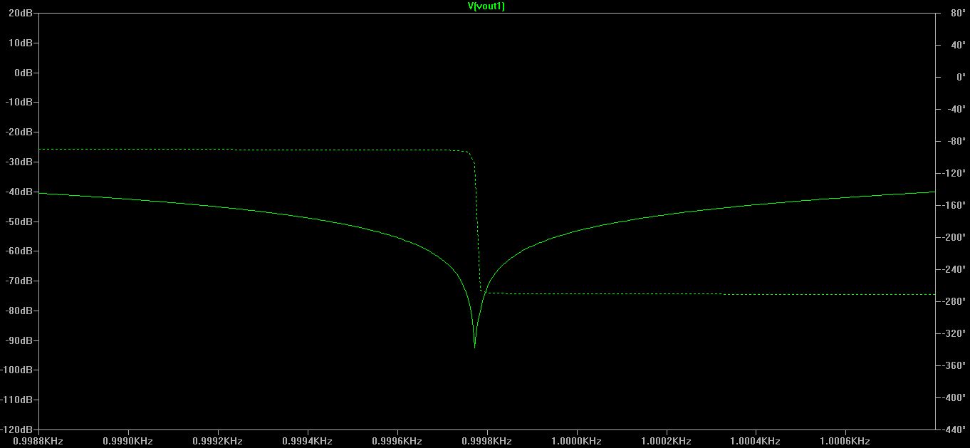

-92dB simulated notch with the AD8397 and +/-12Vdc
Here is an interesting discovery on this project.
The AD8397 results in a simulated notch at -92dB vs -72dB with the THS4031. The part is only 26V max, so the power supplies are reduced to +/-12Vdc. It is unity gain stable but the bandwidth is nowhere near 100MHz. 69Mhz for extremely small signals. The phase transition at the notch frequency appears to simulate as being much sharper than the THS4031/2.
This is a dual chip, so it wouldn't mount since the board requires 2 single chips. Just interesting results.

I ran out of edit time on the post above. I completely forgot about the frequency-adjust trimpot on the board. About 20 degrees of clockwise rotation (I centered that 25-turn pot before solding it in) it appears to have completely zeroed out the 5mV p-p output I was seeing at 1.0000KHz. So apparently the notch is even deeper than -40dB. Going up to 2mV sensitivity on the scope there is so much noise, without being in a shielded box, that I really can't extract anything useful in terms of notch output although it "looks" flat. So at this point I can't say what the actual notch depth is, other than "greater than -40dB"
Time to hook up the QA400.

But as I remember, I've build this notch filter before. The notch depth is good, but the THD seems not acceptable, only ~-90dB to -100dB in my bench.

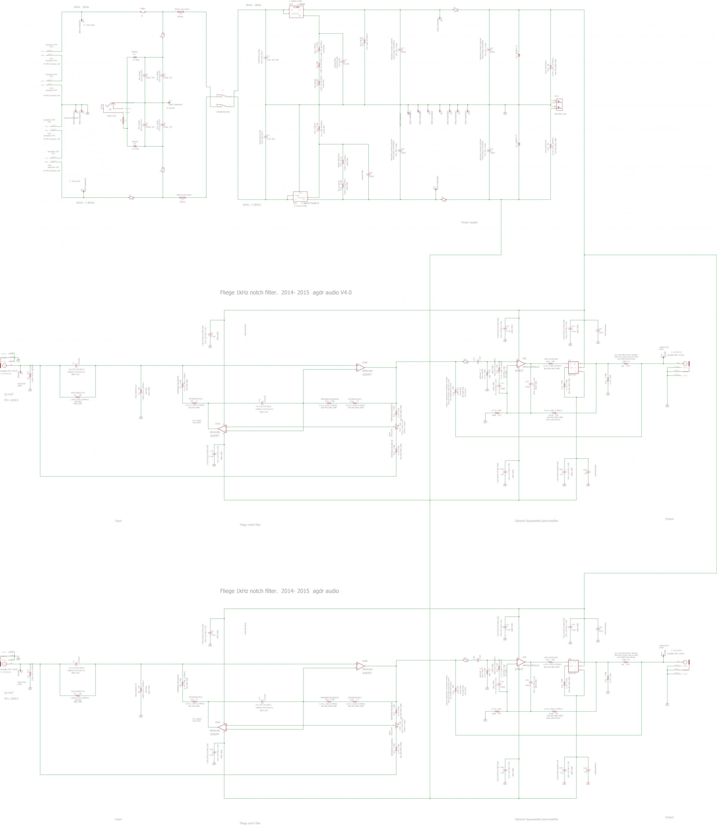

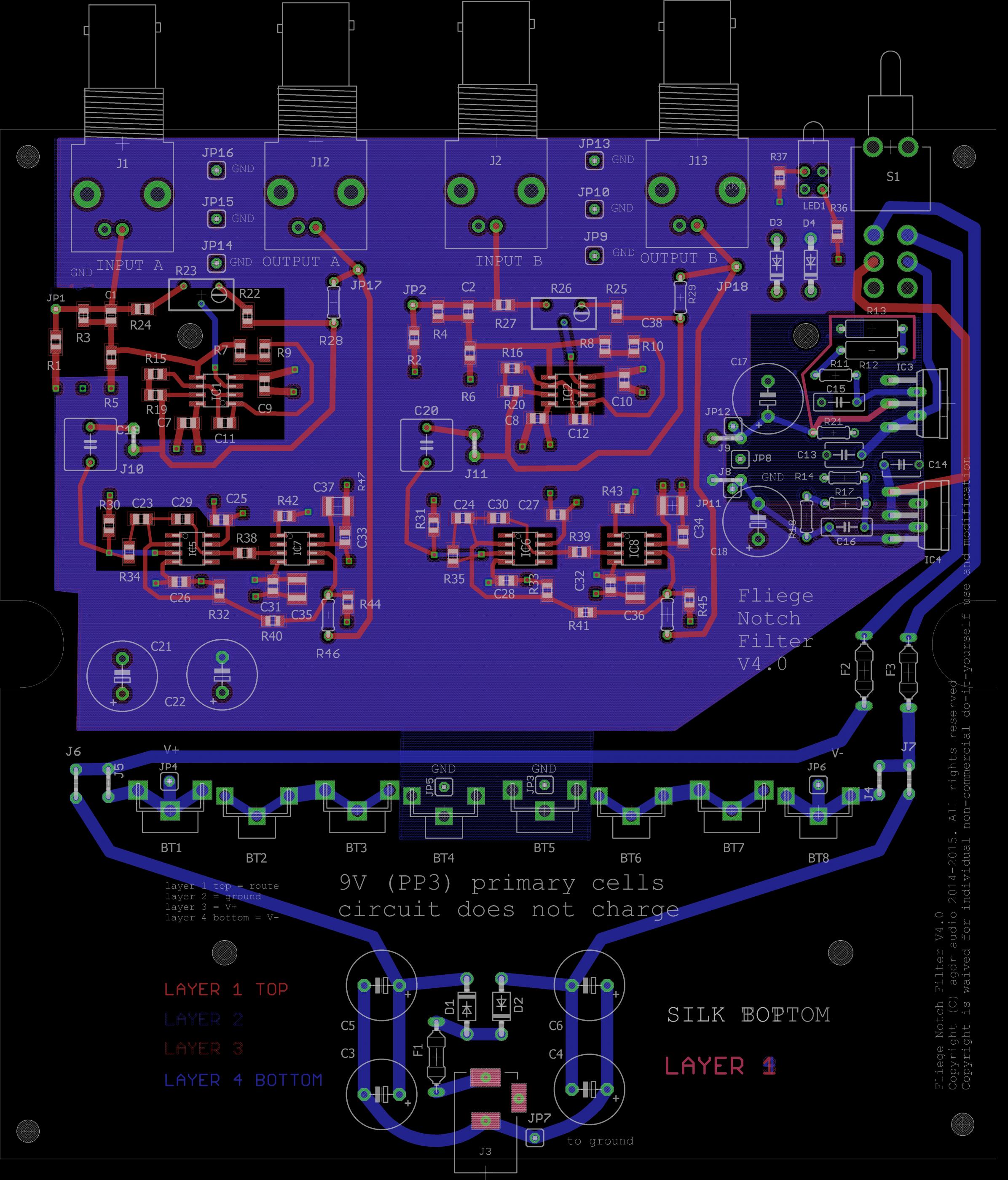

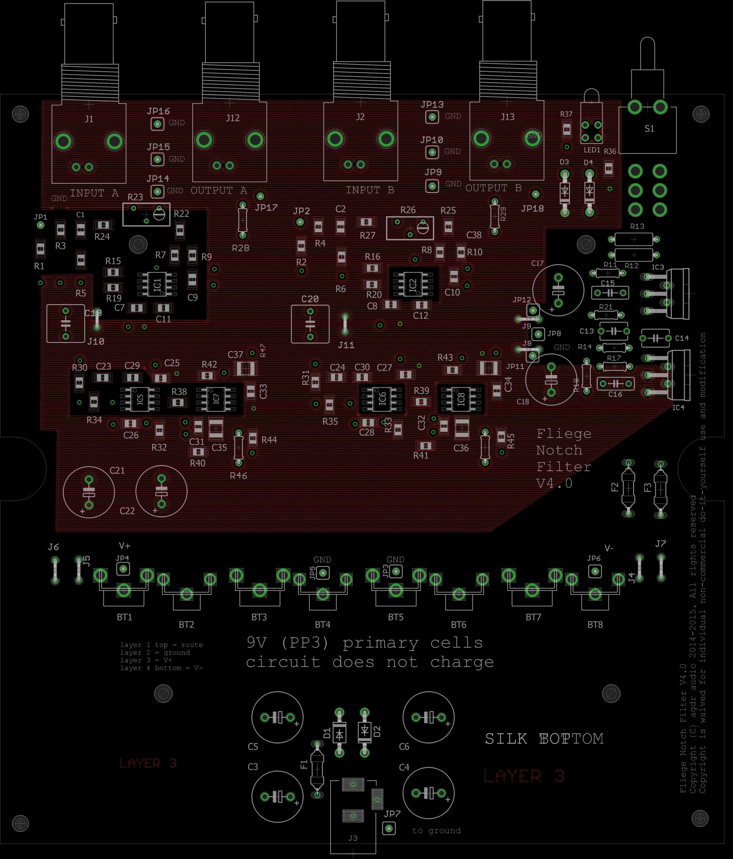

A dual Fliege notch filter PCB for the Hammond 1598EBK series case
Here is a rough-in of two Fliege notch filters on a PCB that fits the Hammond 1598EBK/1598REBK series case. They do fit!
I've moved the post-filter-amplifier from between the BNCs to below each notch filter circuit. This board is the exact size for the 1598EBK case series, complete with side notches and the four 3.5mm holes for truss head screws into the case mounting bosses. Much layout & schematic clean-up yet to be done through.

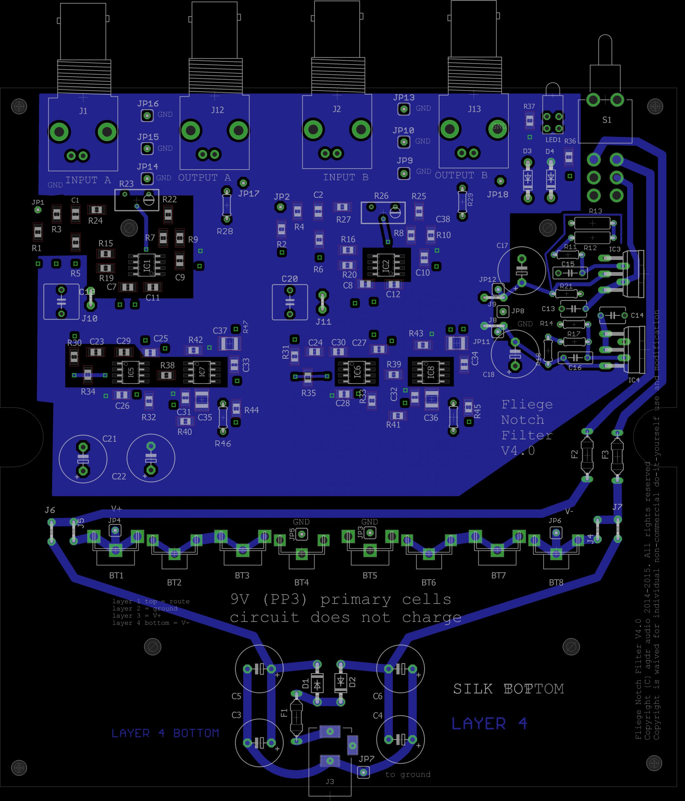

Back home so I will look in more detail. Again I would not cut the ghrtound plane from under any devices, it is not necessary and is bad practice DONT DO IT. Sorry to get loud but it is critical especially around high speed op-amps and for the best signal integrity (at all frequencies). I have more comments but rather than put them in words I am going to copy one channel to illustrate the points I want to make, so give us a couple of hours (Friday and Saturday are my weekend when I am working on customers site, drive down Sunday and do 4 10+ hour days).
From a drafting point of view your schematic is spread out a tad to much, it also looks like a BOM and schematic joined together in unholy matrimony, use a BOM for all the relevant component information, on a schematic limit this to values, voltage, etc. things that are pertinent when using a schematic.

Is it ok to use the same groundplane between the filters? No crosstalk?
Regards
Yes, don't start splitting ground planes it is probably one of the worse things you can do to a low level design. When I get chance I have a whole library of documentation from all your favourite IC companies and others on low level high resolution design practices.
On the M3 mounting holes add a 7mm diameter land top and bottom, this is the size of a washer or nut with a bit of a safety margin, then you wont short copper or traces out by accident if you get them too near.

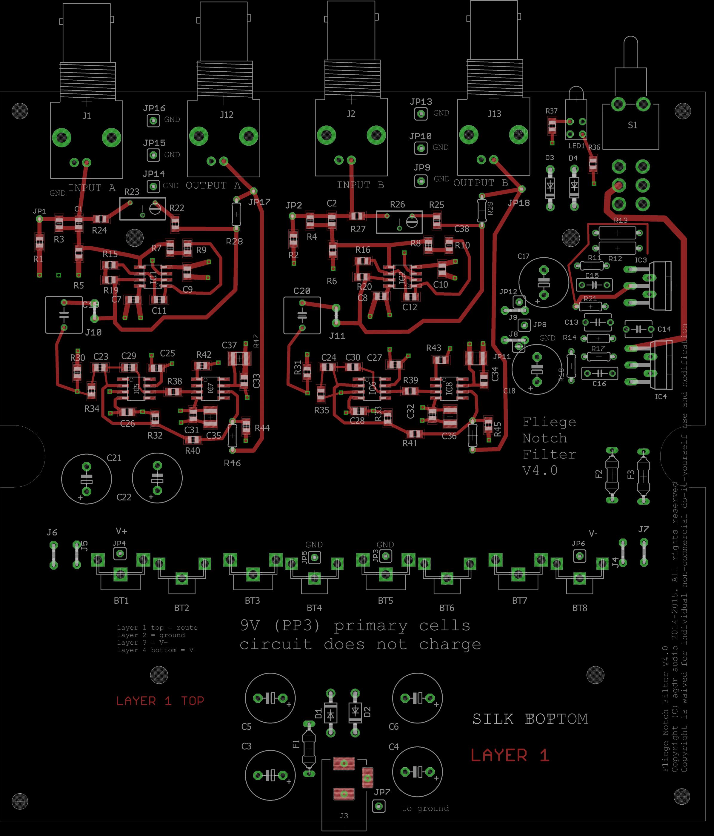

For a real illustration the librarys, base schematic and board I have just stripped all the stuff of to re-create the notch filter on had about 62 8 leg op-amps (mostly OP249GS) in numerous channels for the analogue interface to sensors etc. for control of a critical bit of equipment, the only split in the grounds was between the digital ( logic, processor, communications) and the above analogue section and the chassis (Case, what would be directly fastened to PE in domestic gear). No problems with any channel cross talk (Board is 475mm X 275mm 6 Layers). My preference for true isolation would be a real double mono design, but even here there will be some channel coupling somewhere in the total set up (everything that is plugged in) and often that coupling can be a major irritation (ground loops, we all know and love them). So trying to isolate on a low level design can cause more issues because you may create a coupling mechanism that is far more problematic than two circuits on the same ground plane. Keep the circuitry apart, and lay out as dual mono's and lay them out so that from input to output no signals cross. There are a few things and options, let me do one channel first then I can copy that and we can visually look at the various methods used throughout the analogue fraternity (all analogue fast slow etc) and also discuss why some things are important for EMC (especially RF) and signal integrity.

Schematic attached as well.
marce - WOW! I certainly appreciate your time and effort here. Very very helpful.
I'll take your suggestion and eliminate the cut-outs under the chips. I would trust years of experience over a couple of random datasheet comments any day! That will save a bunch of layout time too. Takes quite a while to get cut-outs for 3 layers lined up in Eagle.
Your discussion with Turbon has probably just prevented a mistake I was about to make. On the double-channel version posted above I had been playing around with the idea of making two copies of the voltage regulators, one for each of the channels, moved to the bottom between the batteries and the post-filter-amplifiers. Then splitting the ground plane in the middle between the channels, about 80% of the way down.
But marce you make an excellent point about ground loops here. If I split most of the that ground plane between the channels, it will simply get re-connected again at the BNC end. Worse still, these BNC housings are plastic so the grounds wouldn't re-connect at the front panel, they would re-connect inches away at the scope or wherever the BNC cables from the two channels meet up again. So back to just keeping the existing single power supply for the whole thing.
I agree with your comments about dual-mono 100%. To really make that work the power supplies & their grounds need to be electrically isolated too, i.e. what is feeding the voltage regulators (two transformers, or separate isolated windings). Then there would be no chance of front-end connections forming a ground loop.
I agree about a split between any digital and analog ground planes probably being the one big technically justified split.
Lol, good comments about the part spacing and part numbers on the schematic. The wider spacing I've done to help make it easier for folks to DIY hand-solder, but I agree that I've over done it. If it was going to be wave soldered I would definitely shrink it way down.
The part numbers on the schematic is a recent thing I started doing. I've found that when I design these things I typically go search for what's available at Mouser during the schematic stage, then forget which part I saw when it came time to put the BOM together and have to go back through the Mouser listings. So putting the part numbers on there helps assemble the BOM at the end faster. I agree though it does clutter things up. The part numbers tend to be long. Plus there is the problem about a part going out of stock or becoming obsolete - and now it is on the schematic forever. What I'll do here is delete those part numbers once I get the BOM finalized. Thanks again for the comment!
I'll study your layout! I can see a lot of helpful technique already. One question right up front is vias - and traces for that matter - under the ICs. So far I've avoided vias under chips, but I see you have used one. I guess my concern has been the IC laying flat for soldering (in the case of the via) and proximity capacitive coupling between traces in the case of traces under there. I'll bet traces under the chips is one of those frequency-sensitive things. For the frequencies involved here it probably doesn't matter.
Same with grounding the bypass caps, I see you've used a single via. That must be adequate, at least at these fairly low frequenices.

Its easier to illustrate graphical things with pictures than try and put it into words
Layout is 90% placement 10% routing from a skills point of view. If you have connections that rubber band when you are doing the placement look at the patterns that you create as you move the components, picturing the routes from the connectivity. The best way of learning this is trying one placement, routing it, trying another until you get the best result. There are rules that are defined by the devices function and the schematic, the schematic being your map of electrical connectivity. That is why I drew the schematic in what is almost a classic style, feedback loops are drawn clearly and stand out more, decoupling is clearly shown and signal references are used for power connections to minimise the connections that have to be followed.
So when you are laying out analogue sections, break the circuit down...
Start with input and output connectors, so you can determine the circuits flow from input to output. Then for the individual op-amps build up an initial block, place the decoupling caps first, second feedback loops and input resistors. When you have built you initial circuit blocks you can then move them about and again see the interactions of connections as you place the blocks. Eventually you'll have built up your complete circuit.
Doing a board this way is the best method, concentrate on getting neat basic circuitry blocks, usually an op-amp gate or several, minimising loop areas, especially when using high speed op-amps, then concentrate on putting the blocks together like a jigsaw, again going for optimum connection patterns between blocks.
Where you have sections that operate on different supplies, try and group the ICs and components referenced to a certain voltage in the same area. This is more critical with high speed digital as the signal is referenced to both positive and the 0V supply so both return paths should be considered; running critical signals between a contiguous GND plane and a positive supply plane seem to be the best option for ultimate signal.
Finally treat it as a challenging game and enjoy it. If a bit of layout is frustrating you, do another area or relax, then look at it again later.
No we don't worry about vis under IC's on many designs the lack of room dictates any available space is utilised. For very high speed analogue the rules do change a bit, but here we are going to be in the high MHz's low GHz's.
Having separate power supplies, but the same ground is an often used technique and may be worth considering. A main supply is provided round the periphery of the board (where possible, as bus bar routing (broadside coupled)) to local well filtered supplies for each section (the same 0Vs though) this has numerous benefits, the overall circuitry is better confined to a well defined area with decoupling caps and the local supply forming a localised power loop and crosstalk between the sections is reduced especially any noise the circuitry adds to the supplies.
Decoupling caps I must admit I was a bit tardy with and rushed the layout (otherwise I would have had no time, busy weekend and in a hotel Sun-Fri) and where possible prefer at least two vias either side of the cap and towards the centre of the device to minimise loop area, again low frequency is much more forgiving than high frequencies (here planar capacitance would be my first line of decoupling followed by small local decouplers (0402's or smaller).
I did think the spacing was for DIY, but people can DIY when the components are closer, better to develop the assembly skills than compromise the design in my view.
