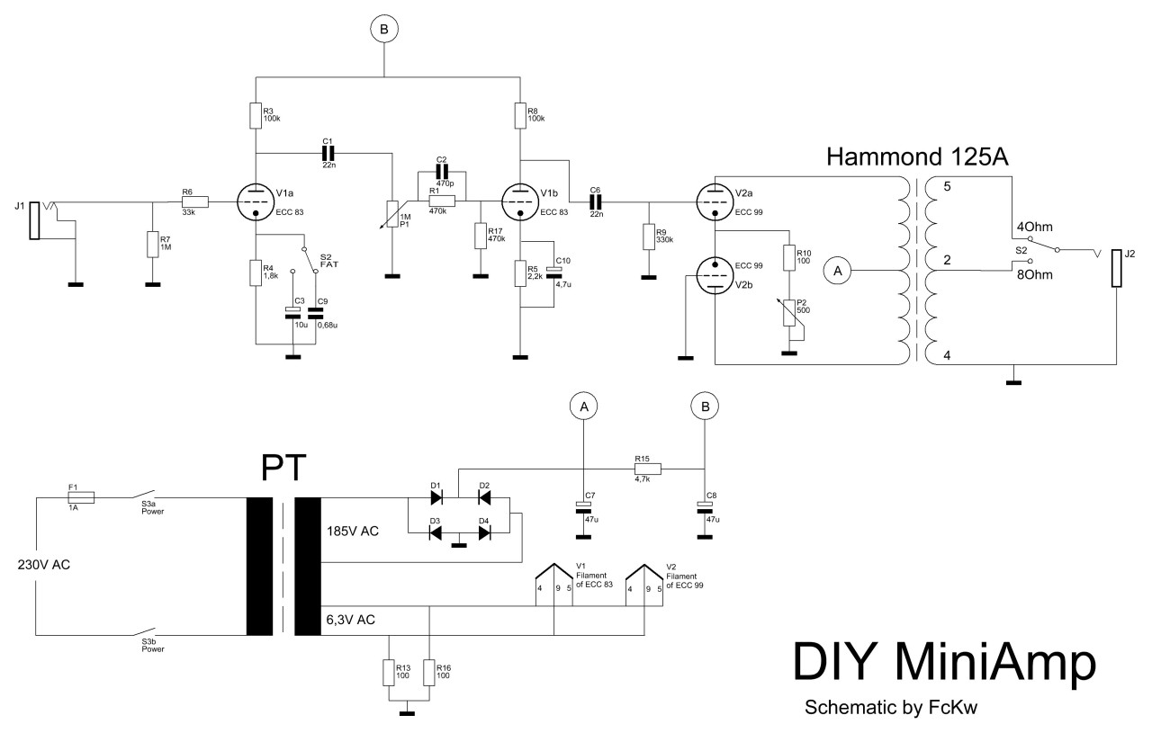

ECC99 is really very nice tube, and I would consider it as a waste to use for an output stage. But YMMV, however!
YouTube - MiniAmp Soundsample 12AX7, ECC99 😉
What is that choke doing in grid of first stage ?
Its a special low current choke made for that position
From I understood, it takes very good care of the the tube 😛
I have bought a bunch of 6C19N, enough to keep it going for many years 🙂

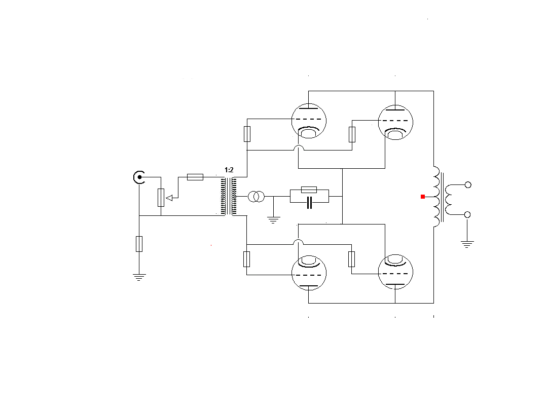

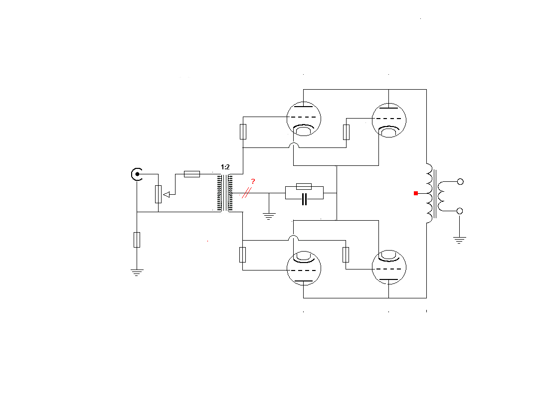

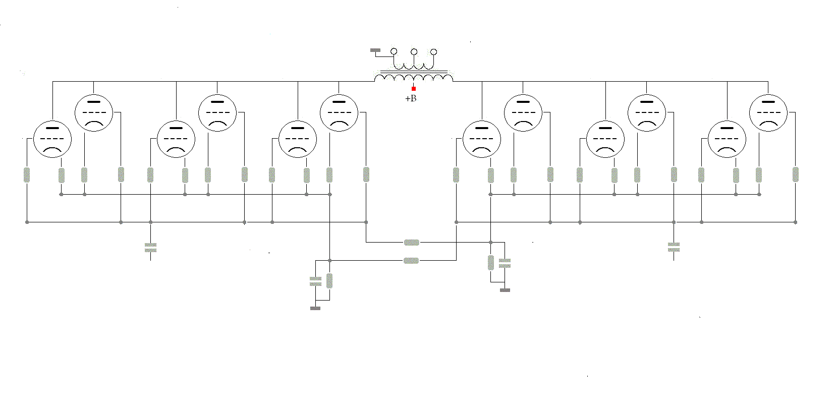

and... at the time i didn't know about the Blumlein Garter cross reference bias scheme
might make sense to use it for this

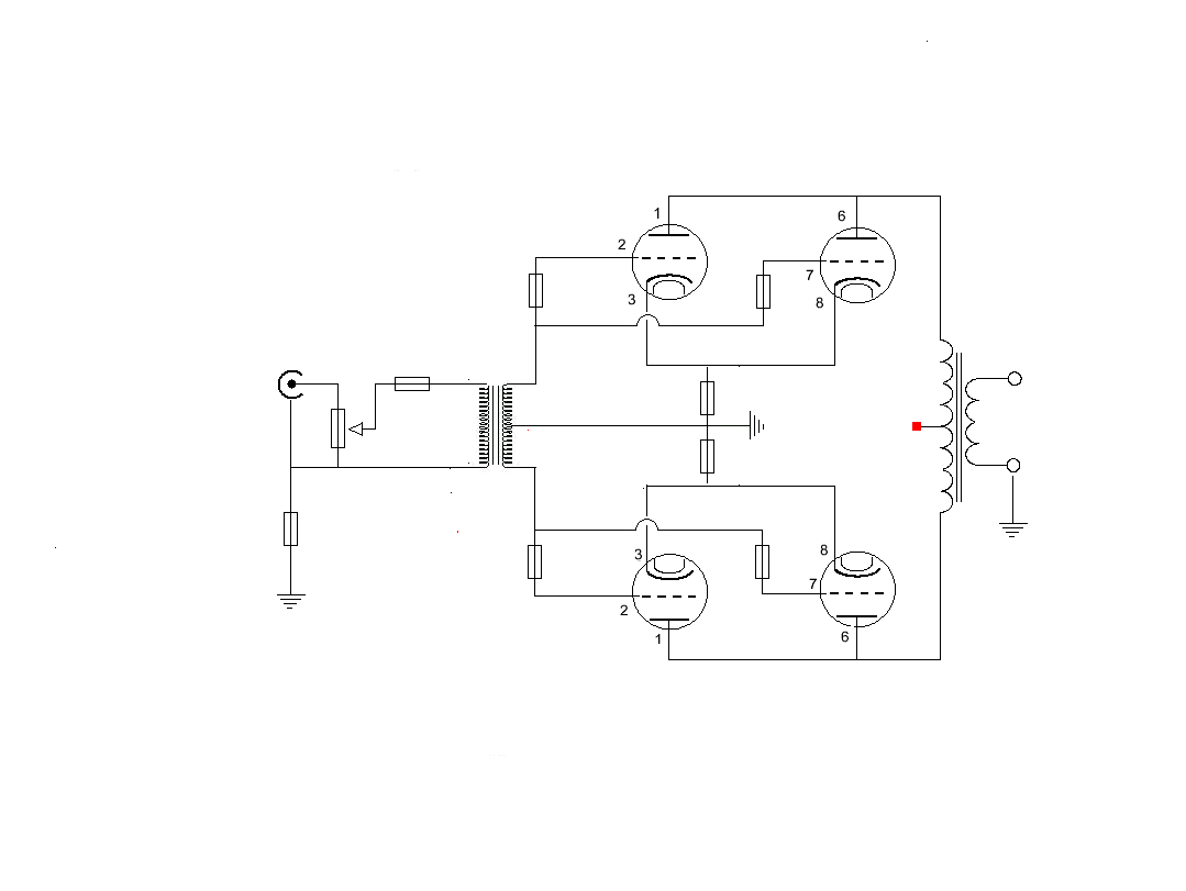

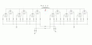

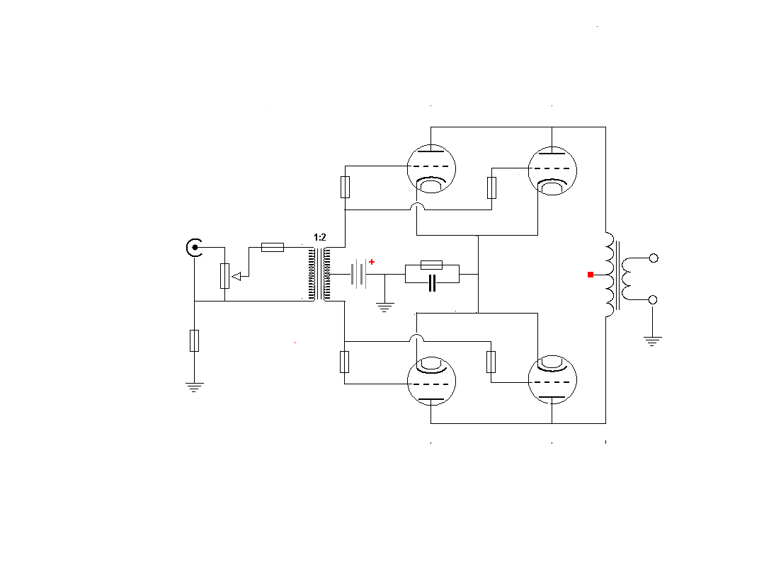

how many ECC99 or 6N6P will I need to us a 1K6 PP output trafo ?
my first guess is 6x ECC99 per mono amp
being double tubes means 6 tubes in paralel, in reality

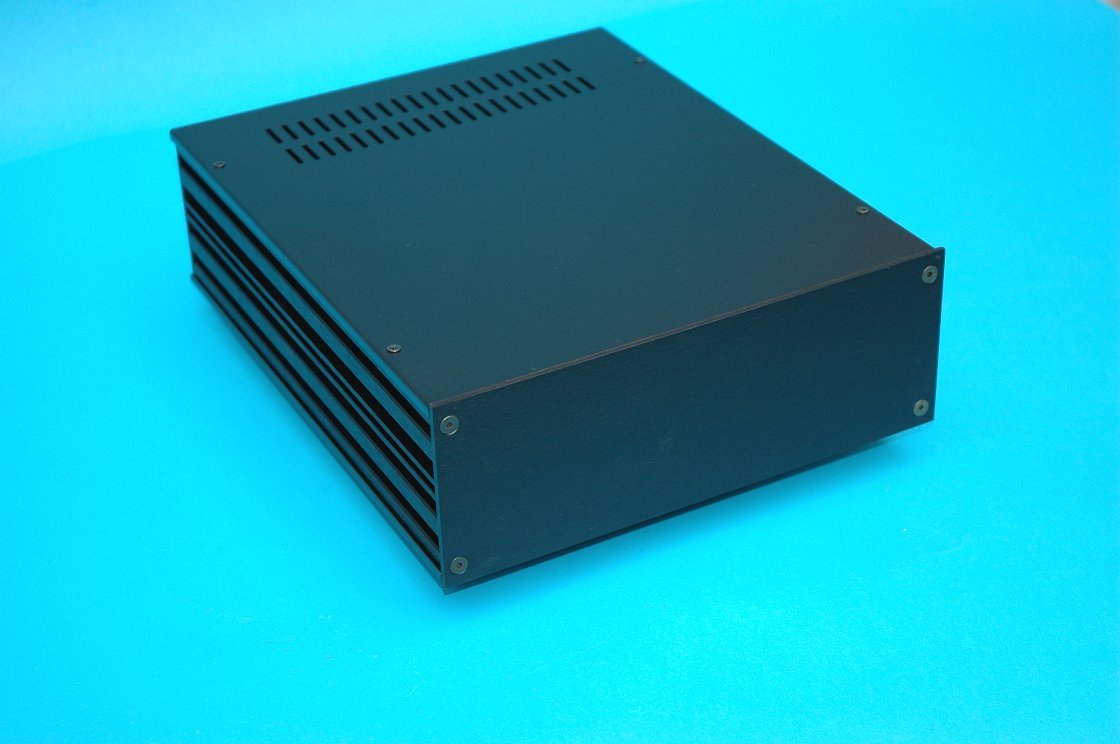

hey Arto
yeah, it's a neat box, and affordable
Galaxy series from ModuShop.biz, Italy
the other day I found that RS-Parts also have nice small extruded alu boxes
