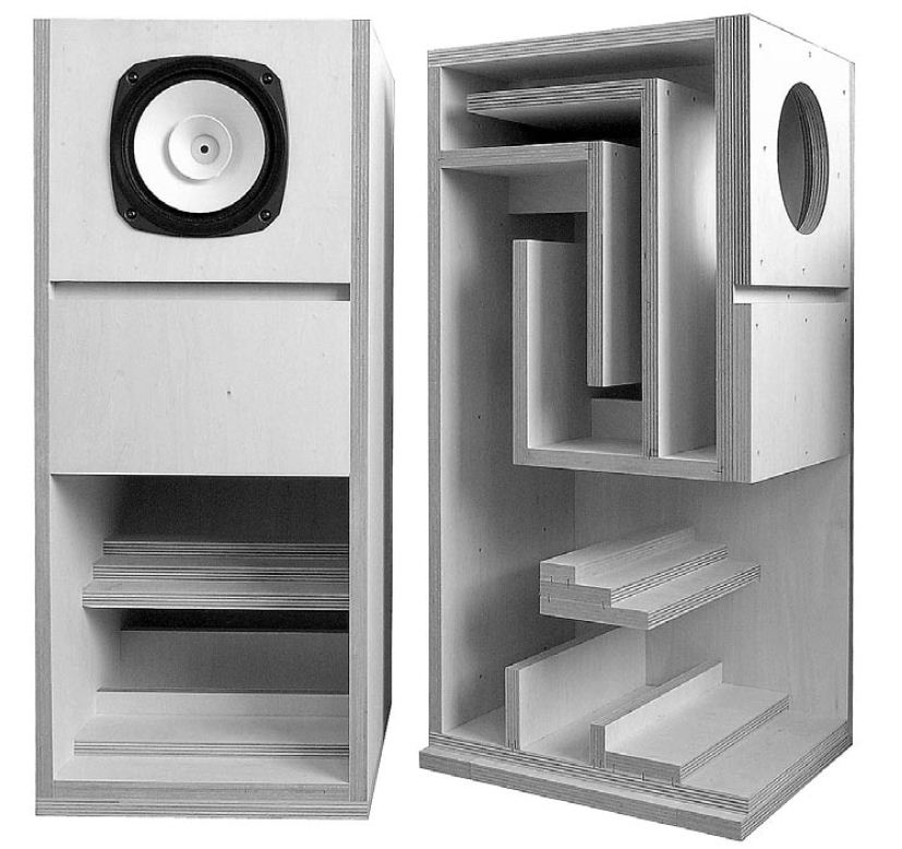

The best of the Fostex factory horns is mediocre at best, FExx6 series have all got better horn designs available. These drivers do need horns.
Dallas II, Kirishima, Vulcan for FE206. I prefer FE166. And the FFxx5wk more. Have a look at FF165wk if headed in that direction. All of these Fostex have some fairly easy tweaks that really helps with the speakers issues.
dave
... the cabinets for certain speakers are already calculated by the manufacturer, which is a great advantage in my opinion.
Except that they are often poor designs.
An example: FE126En Factory Reflex, a "cruel joke" - diyAudio

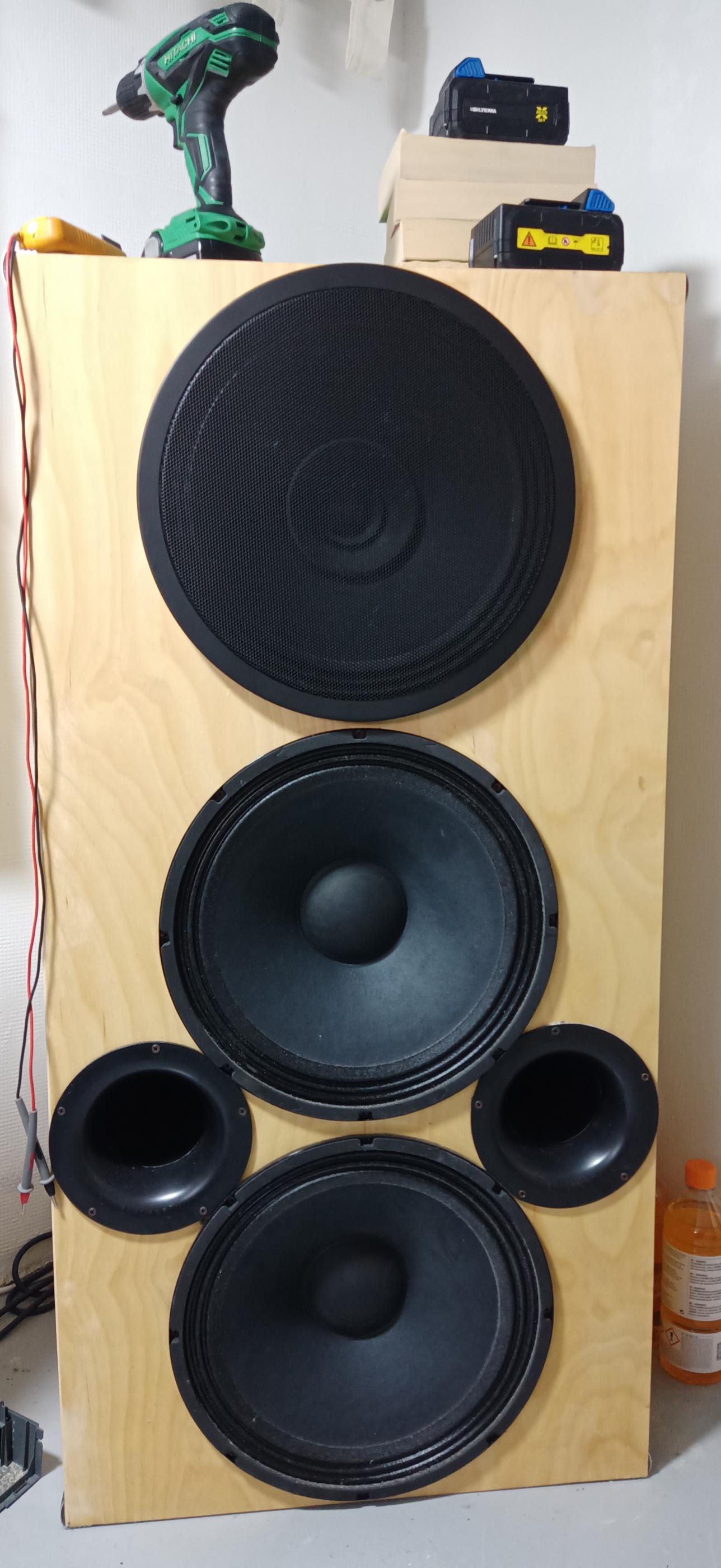

I typically avoid volumes larger than 240 liters or so because of this.
For me, I consider it somewhat a waste to make a volume over 180 liters per driver. If there are several drivers it's 240 liters per volume. Especially on a FR unit since it starts getting tricky to avoid internal reflections.
My closed volume for the 15-300TC is about 80 liters, internally the chamber is divided by solid walls at angles to help break and dissipate reflections. Nothing complicated, just some boards and various types of dampening material.
The only difficulty about this is the big size and the ammount of bracing that such a cabinet need to be strong enough.
