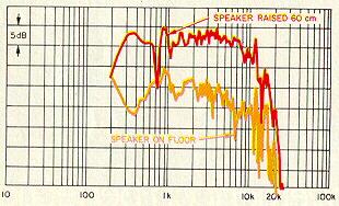

Those are all valid concepts in handling floor bounce.
In my designs i usually account for the floor as an
integral part of the speaker.
e.g.
Dipol 08 open baffle line array, Strahlerzeile mit offener Schallwand
A floor standing speaker is usually not thought to
be elevated, so i cannot even see the need for
measurements cancelling floor bounce.
For development of drivers (transducers) itself, this
is different. Since i also make bending wave transducers,
i want to know their impulse response without room
boundaries if possible.
But in case of a completed speaker ...
A speaker having proper impulse response on a fork
lift, but is suffering from floor bounce - floor standing
being its manner of operation - is good for nothing.
With the panel form bending wave transducers similar
solutions like with arrays or "bounce filling 2.5 ways" can
be found, since the propagation of bending waves
is dispersive: Above the coincidence frequency of the
panel, the bending wave can reach the floor faster
via the panel, than components radiated directly from
the exciter via airpath.
That means floor bounce can be dealt with by adjusting
the positions (height above floor) of the exciter(s) and
the coincidence frequency of the panel to mitigate floor
bounce.
Again the floor is seen as an integral part of the
speaker. I can hardly imagine a speaker performing
independently from floor elevation (and listening distance).
e.g.
http://www.quadesl.com/graphics/quadGraphics/quad63_frequencyresponse.jpg
So even measurement of complete floorstanding speakers
without floor does not really make sense to me, yielding results
which are purely theoretical.

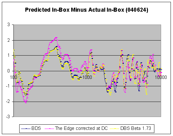

I think diffraction modeling tools are better than they're getting credit for, but they aren't great.
Here's a careful comparison of several free modeling tools, against anechoic measures from Seas. I suspect that the hash above 2 kHz is reflection of a tweeter off the cone in the box, but can't validate.
