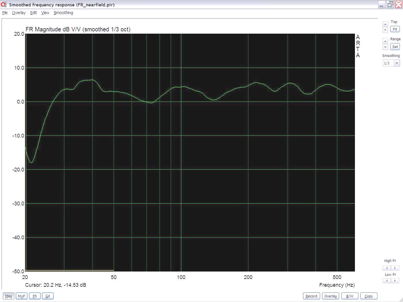

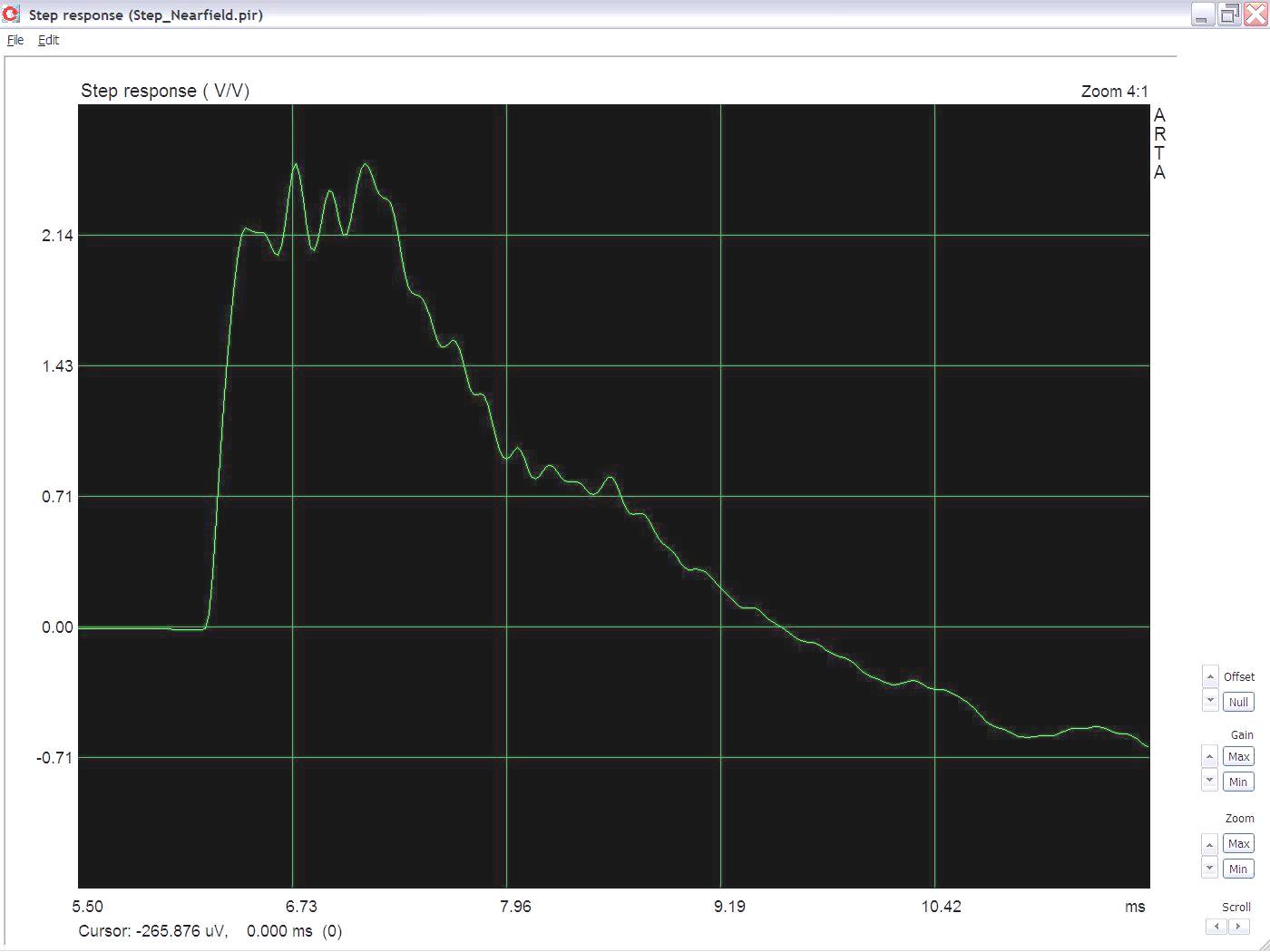

Please allow me a short comment on post #1010:
I usually do not like to post such preliminary results,
as they are still flawed. The step response shows some
ringing around 5Khz, this is partly due do the panel
held in a test frame with exciter having only a preliminary
bonding (which is more massive than the final glue), also
explaining the poor rise of the step.
But i guess from the falling slope of the step, the flat
group delay (which is virtually within the IRT Munich
recommendation for future monitor speakers of +/- 0.2ms
from 500Hz...10Khz without any compensation applied)
and the lower cuttoff frequency around 27Hz, you may see
that not all bending wave transducers are created equal ...

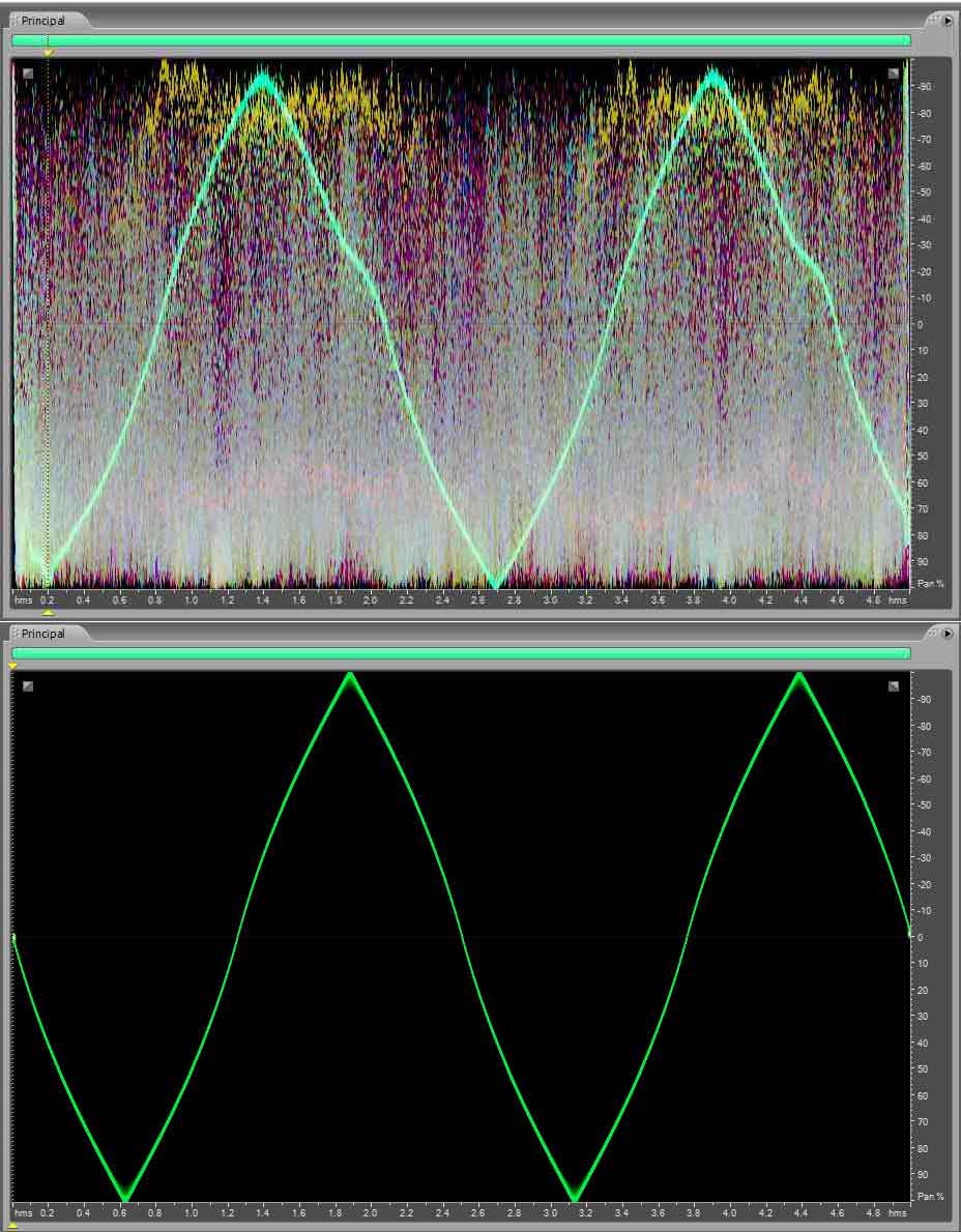

Hello,
Elias does this makes sense to you ?
It's not an impulse, but a binaural test showing the panoramic phase of a
1000 Hz sinus with a stereo field rotation of 180°, vs the recorded one.
The mikes where almost at the inter aural spacing: 17.2 cm, e.g. wavelength 1000 Hz/4 😉.
and 5 meters from the speakers that were in side firing configuration.
