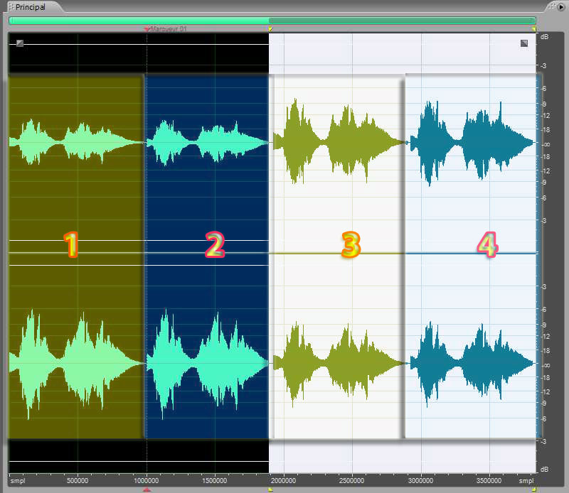

If some of you are still interested by demos, you can have a look here. It's about stereo localization mechanisms.
the same sample of cello (with strong artificial reverb) is played 4 times.
This primitive phase trick is about cheating our ITD process and the bandwidth of the cello is perfect for this.
But, (and maybe this is "on topic") : the phase relations between the speakers have to be considered.
joined pic : a view of the editor with the 4 samples (left channel on the top)
- original track : all on the right side, this is a stereo based on levels (panned, can see it in the editor), no phase shift.
- phase shift on the right channel of -180° : the cello is always localized on the right, but maybe a little bit more behind. I don't see any big cancellation issue
- original track, but after normalization of the levels R/L : the cello is now on the center, logic...
- this same normalized track but now with the -180° shift on the right : same levels, but the cello is back on the right.
