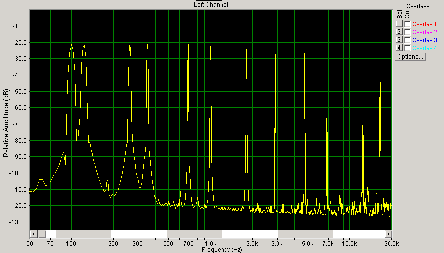

Ben,
This only matters if the system has appreciable non-linearities or is severely limited in headroom. This way, the stimulus excites these non-lins in a manner that is statistically equivalent to "typical" program material.
In telecom audio, we used artificial voice with the same long term statistics (frequency content) and peak/ave stats as typical speech:
http://eu.sabotage.org/www/ITU/P/P0050e.pdf
This was only useful in that the channel was non linear (A and u-law compression).
For distortion measures using multi-tones (PhiTone), it may also be useful to define the tones to have a spectrum mimicking the IEC 268-1, 1985 power density spec. I've attachment the measurement of a pre-amp I designed and built for my PC, where the stimulus was 12-tone and representative of the long term spectral density in the IEC spec.
But for linear systems, it doesn't matter what you use as a stimulus as long as you aaccurately capture the speaker o/p with the mic.
Dave
