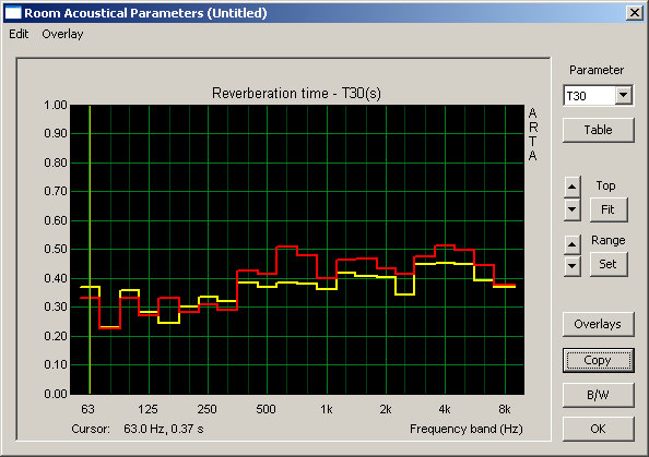

Out of interest I've just measured my current listening room - a fairly small, far from optimum listening room, 4.8 metres wide and 3.45 metres long.
There are two sofas, curtains to the left hand end, a rug on the floor between the speakers, some miscellaneous furniture, and a door on the rear of the right side wall. Without any treatment I found the room tolerable but a bit too reverberant.
The right hand wall and the right half of the rear wall straddling the door are both largely bare and there is a noticeable slap echo in the room because of it. Some time ago I decided to try hanging a blanket like rug over the right rear door in the middle of that very bare corner which covers about 2/3 of the door and noticed a big improvement in slap echo and overall acoustics.
In the attachment below the red curve is the untreated room, yellow is with the "blanket" hanging on the door. Quite a change indeed from one small change to the worst part of the room, and I'm quite surprised by just how flat the RT30 is, staying between 0.38 and 0.45 over most of the spectrum above 300Hz.
What's interesting though is despite being a small room and me perceiving it as being too live compared to previous listening rooms I've had, the peak RT30 was still only about 0.5 - well short of your 0.85, so I can only imagine what that sounds like...
I think I'd like to get the RT30 down to about 0.3 but I don't think it's going to happen in this room with "mutually acceptable" changes 😀
SNIP

I'm not familiar with the software you're using to take your measurement, so I'm not sure how any measurement options might compare to those in ARTA.
The measurements I took didn't have any explicit windowing enabled, I just had the start maker set to just before the first impulse. FFT size was 256k in Periodic Noise mode, (although I tried swept sine and the result was nearly identical) sample rate 96Khz, there isn't much else you can change.
I'm only using the Demo version of ARTA so you could try using it yourself in your own room to get a direct comparison with the other software you're using if you're curious 🙂
And then what about mic placement? Where should it go? I put mine right in the center of the room - center height, too.
The docs for ARTA suggest that for measuring Reverberation time the microphone position should be at least 1 metre from any reflecting surface, and also not be "too close" to any source (speaker) position, (giving an equation to calculate what represents too close based on room volume) and that the microphone should be omni-directional.
For a 2 channel set-up this suggests that the listening position is probably the best place to measure, but brought away from the nearest wall or object by at least a metre, if necessary. This is what I did - my listening position is of necessity only about half a metre from the wall behind me, so I set the measurement position 1 metre in front of the wall but otherwise at the same height and lateral position as the normal listening position.
The starting point was very bad. Bare walls and ceiling, nothing else but the speakers. There was carpet on the floor, which by ear was already a big help. I built my own room treatments - see here: http://www.diyaudio.com/forums/ever...ing-pegboard-acoustic-panels.html#post2449920
I prefer rooms with carpet for acoustics too, but although I didn't remember to mention it my current room is laminated wood flooring. Only about 40% of the floor area is visible though, due to a 1.5m x 2m rug and the footprint of various other furniture and objects.
Yeah, I remember reading that in the ARTA docs. Which is why I placed the mic as far from any surface as I could.
